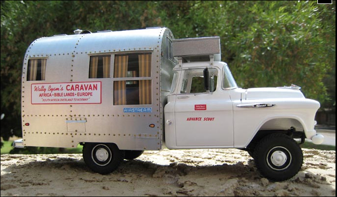

gasser59 Posted August 18, 2011 Author Posted August 18, 2011 (edited) I too have used a roll of that flashing from the big box stores to build the camper portion of the model below. It works great for this purpose but is a bit thick for all of the small detail stuff. Thanks for the kind words Henry. Opps. Is it possible to hijack your own thread? Now back to our regularly scheduled program... Edited August 22, 2017 by gasser59

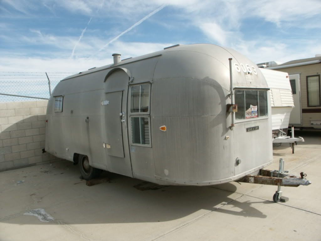

Romell R Posted August 19, 2011 Posted August 19, 2011 Job well done Brad, I really like the truck too, I had a Flying Cloud by Air Stream that was in the Wally Byam Caravan I sold it to a collector for a pretty penny, I thought you might like to see it. sorry about High Jacking your thread , just say the word and I'll delete this.
gasser59 Posted August 19, 2011 Author Posted August 19, 2011 WOW Rom, I'm impressed. Looks to be a '56 or '57 model? I have a '59 Aistream Tradewind that we redid and travel in it whenever we can. Maiden voyage was to Jackson, Michigan back in June of 2002. Check out my webpage at airztream.com f you're interested.

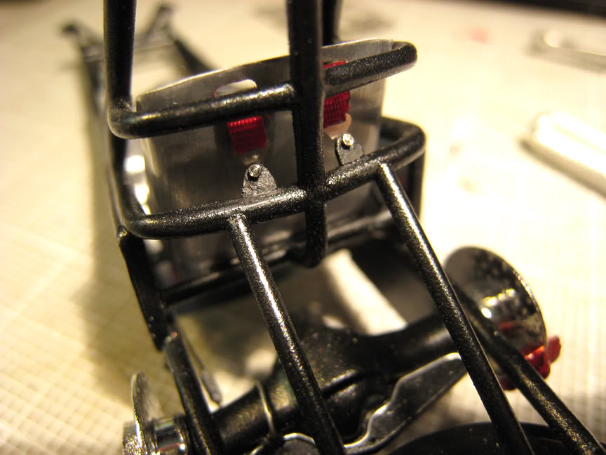

gasser59 Posted August 19, 2011 Author Posted August 19, 2011 (edited) Thanks for the compliment Mike. Looks like today's bench time is done as I've got to get ready for work so here's today's update. Almost done with the seat belts, just need a bit more work on the shoulder straps and the cam-lock buckle. Also made the frame mounting brackets for the shoulder straps which I'll paint next time at the bench.. Thanks for following along and again, comments greatly appreciated. Edited July 24, 2017 by gasser59

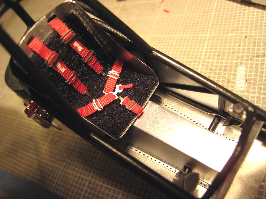

gasser59 Posted August 24, 2011 Author Posted August 24, 2011 (edited) Finally some measurable progress. The seat belt harness is done and before I could glue in the seat, I had to finish up the output shaft tunnel and wire in the brake cylinder. The tunnel needed some drawn-on rivets too. Also, the shoulder belt mounts needed to be reglued to an appropriate angle behind the seat. This is the most extensive seat belt system I've ever done and I have to say I'm really happy with how it turned out. Now it onto the steering components and the levers and parachute pull. Stay tuned and thanks for following along. Edited August 22, 2017 by gasser59
