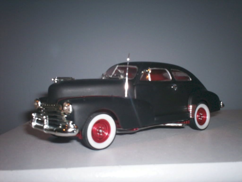

Haubenschild Posted March 11, 2012 Posted March 11, 2012 Tamiya TS-14 black without any clear Tamiya TS-56 orange without any clear Tamiya TS-26 white with a heavy coat of Tamiya clear

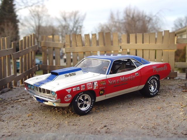

Eshaver Posted March 11, 2012 Posted March 11, 2012 Ever thing in picture #1 Ever thing in picture #2 Ever thing on picture #3 Yep, all spray can again............... Ed Shaver

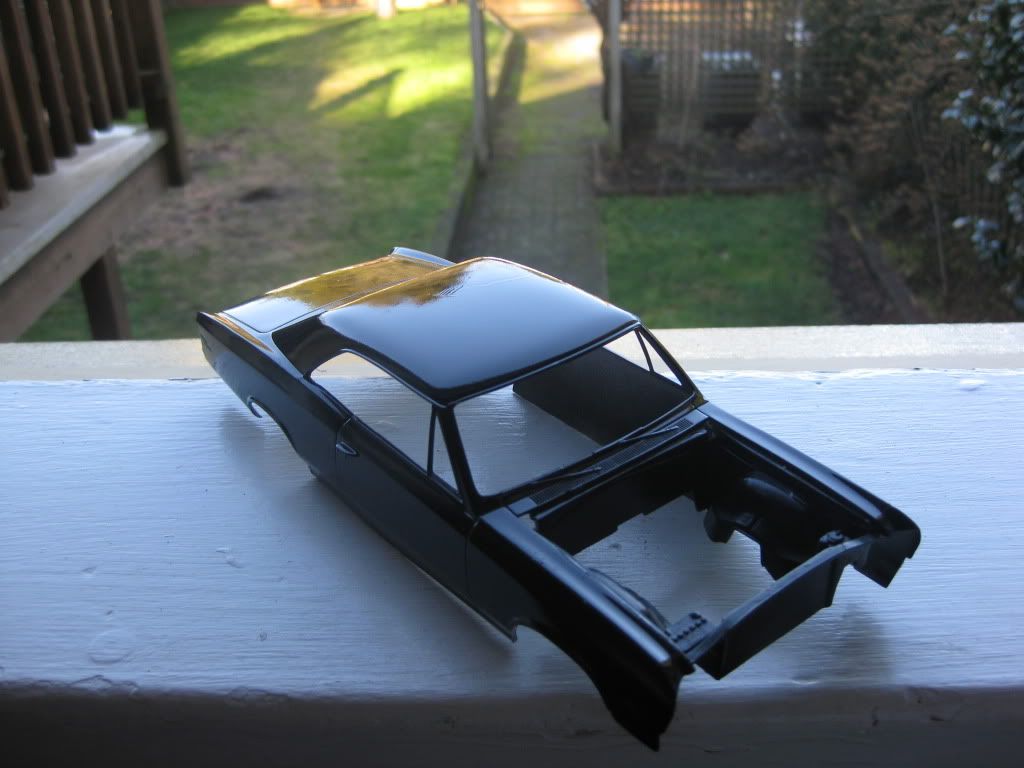

Jdurg Posted March 12, 2012 Posted March 12, 2012 Rust-Oleum Automotive Touch-Up Paint Medium Quasar Blue CC followed by a couple of wet coats of Rust-Oleum Automotive Touch-Up Clear. Then it was wet VERY lightly wet-sanded with 3000 grit paper, then a rubbing compound to remove any marks from the feather-light wet-sanding, then some 3M automotive polishing compound, and we get what you see here. Photo taken by my iPhone. I need to find my camera so I can take better pictures, but I think the overall quality comes out in this photo.
