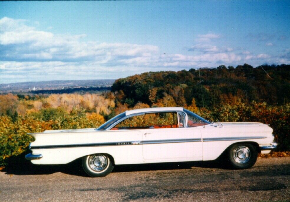

Foxer Posted January 20, 2014 Posted January 20, 2014 (edited) Right now, it looks like the one I had long ago ... is the body going to be white? Those carbs look busy! ... the greatest compliment I can give. It's also sitting very well. Edited January 20, 2014 by Foxer

MrObsessive Posted January 20, 2014 Author Posted January 20, 2014 Right now, it looks like the one I had long ago ... is the body going to be white? Those carbs look busy! ... the greatest compliment I can give. It's also sitting very well. Mike, it's going to be Roman Red-------I originally thought about painting it white with a red interior, but after seeing a red one on eBay Motors, I knew mine had to be that color. That's a beautiful '59 you have pictured there........whatever happened to it?
Foxer Posted January 20, 2014 Posted January 20, 2014 Mike, it's going to be Roman Red-------I originally thought about painting it white with a red interior, but after seeing a red one on eBay Motors, I knew mine had to be that color. That's a beautiful '59 you have pictured there........whatever happened to it? Red will look good. This was my 2nd car that I bought mostly for the dashboard ... my favorite dash of all time! My Dad sold it after I got drafted and someone up the street gave him an offer I couldn't refuse.
