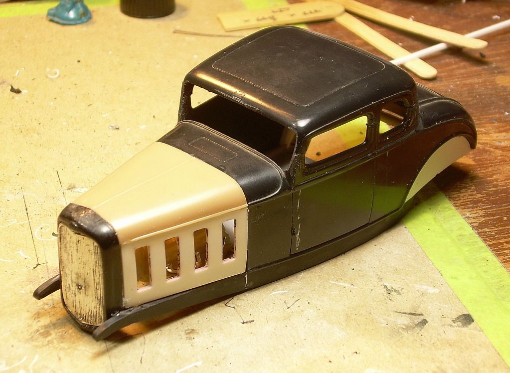

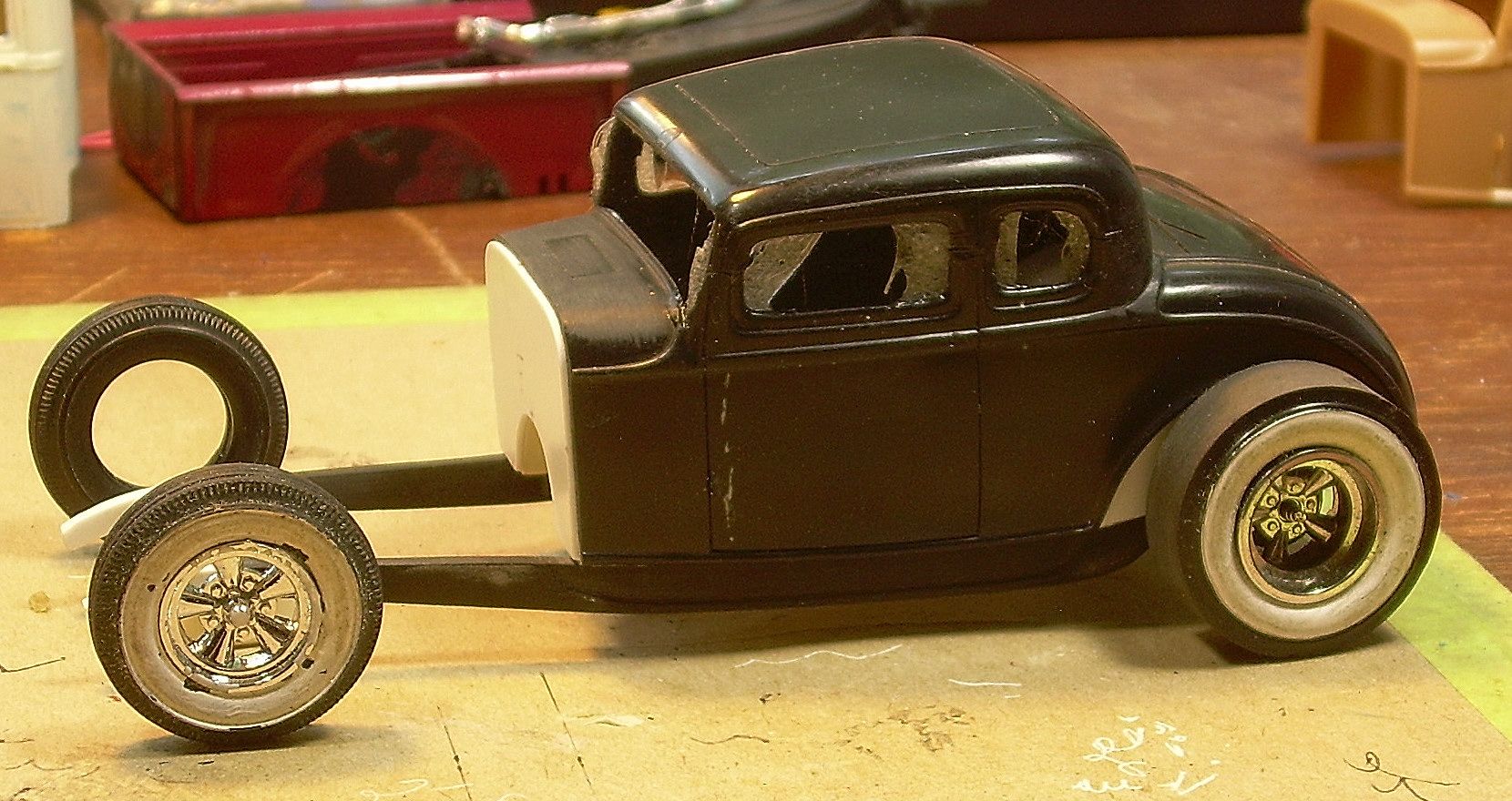

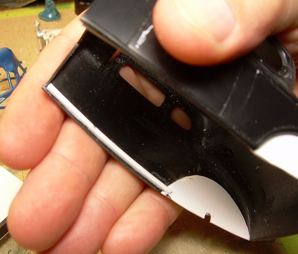

Ace-Garageguy Posted November 4, 2012 Author Posted November 4, 2012 (edited) .Thanks to everyone for the encouragement. ....Built a floor that keeps the rails out next to the body, where they would be in 1:1. Compare the width of the frame now to the earlier shot and you'll see what I'm getting at..... ...and built some clean new inner rear fenders.... ...then built some subrails to make sure the body goes back in the same position every time. Makes it easier to hit the stance dead on, etc. With the body sitting tight on the frame, and infinitely repeatable, I could go ahead and square up the hood and grille-shell fit permanantly..... .....mock up the front axle in the correct position to verify the stance..... ...and stand back and savor a little attitude. Edited November 4, 2012 by Ace-Garageguy

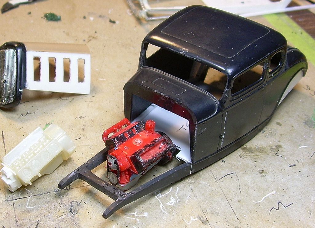

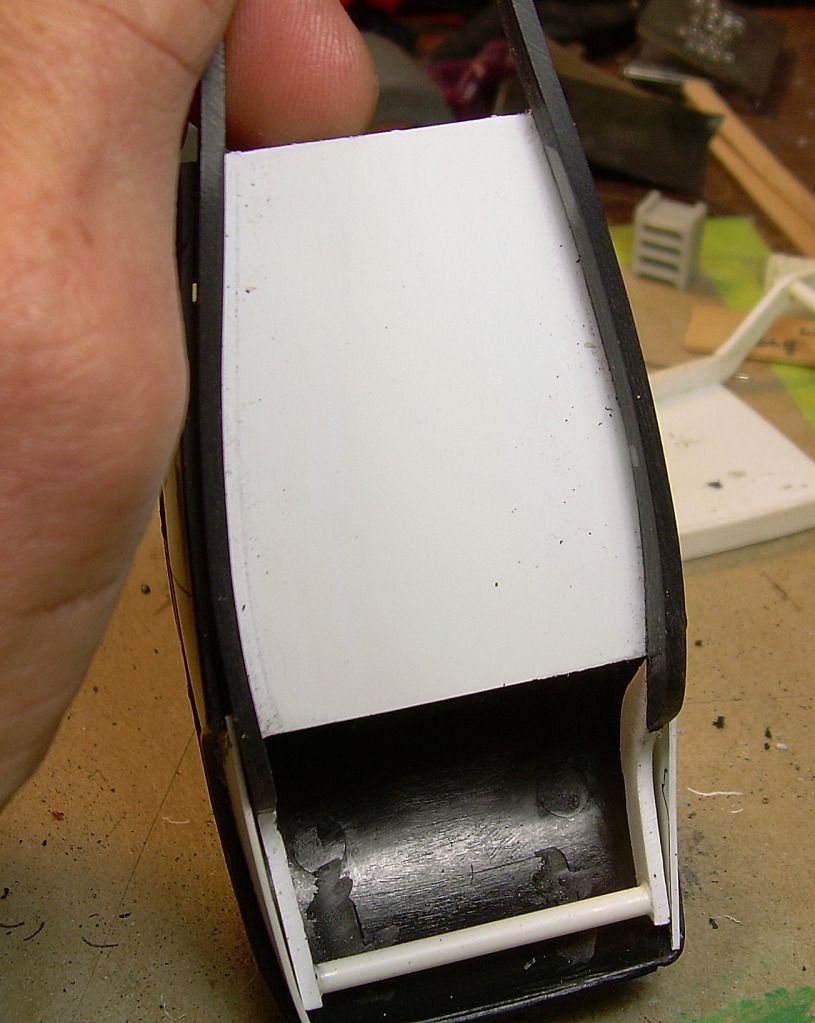

Ace-Garageguy Posted December 16, 2012 Author Posted December 16, 2012 Slowly but slowly. Extended the front frame rails out to the 1:1 dimensions, built a stepped firewall (stepped around the body seam to let the hood fit nice and tight) with an engine setback, and a rear floor... Firewall setback for engine, on floor, fits up nice and tight to firewall....can be taken apart and put back together without losing the fit. Using the extra material at the bottoms of the rear inner-fenders for a jig to hold the axle at the right stance-height, and having the engine / gearbox in place, now I can build rear suspension to fit, as well as a trans / driveshaft tunnel.....

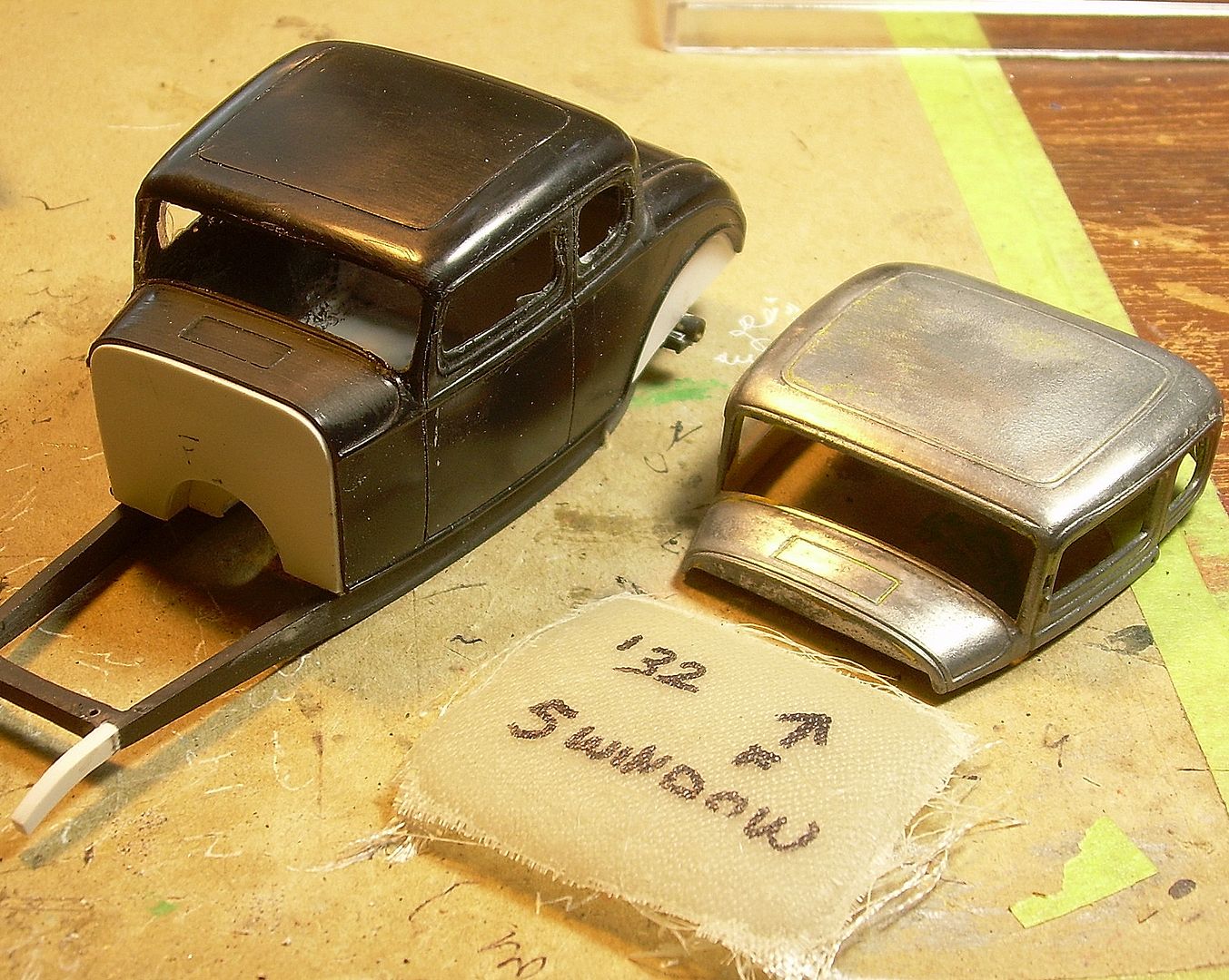

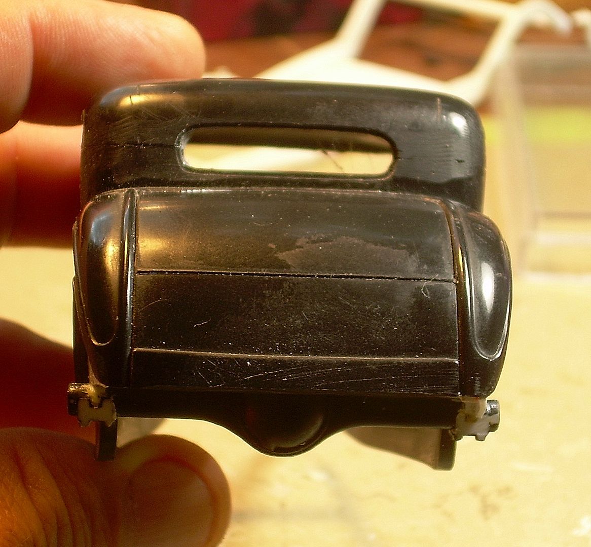

Ace-Garageguy Posted July 13, 2013 Author Posted July 13, 2013 (edited) So, this is about how much of the axle will show from the back. I'll probably do a rolled rear pan to hide it somewhat (like my black '32 roadster has now), because the old Chevy truck rear end isn't as pretty as a QC. With plastic stub axles, I've double-checked the rear ride height, before moving on to making the springs and setting up the front end. Subtle changes in ride height and stance can make or break a model, and have a LOT of influence on the first impression a car makes...real or in scale. I make fixtures as I go, to make the suspension parts in the correct, installed positions. That way, when everything goes together at final assembly, there are no surprises. I'm also doing a textured roof insert, from a mold pulled off of the AMT diecast '32 coupe. Edited July 13, 2013 by Ace-Garageguy
