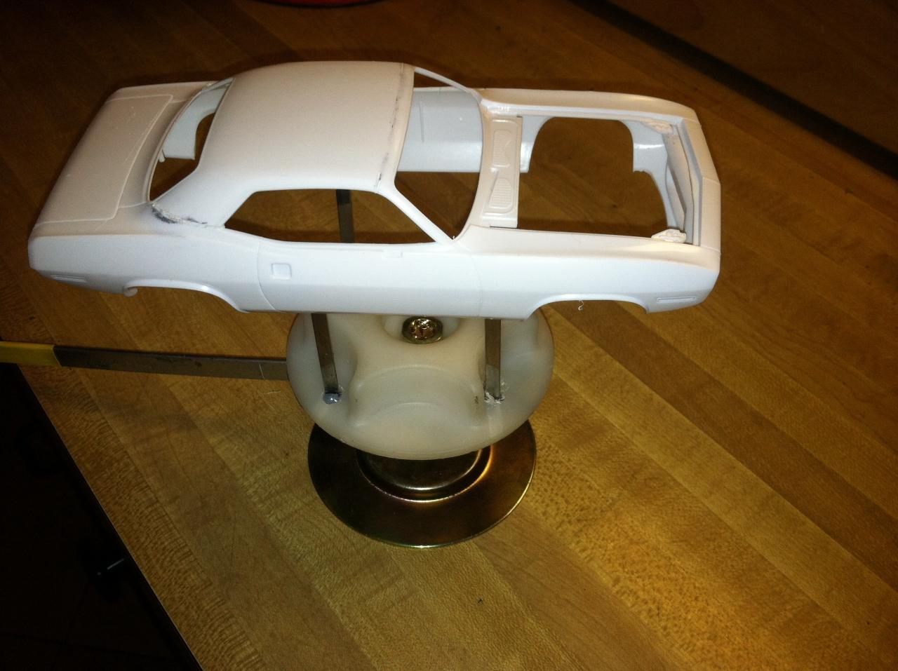

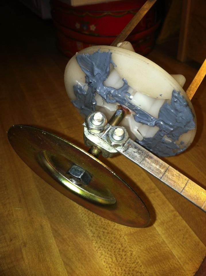

FASTBACK340 Posted January 15, 2014 Posted January 15, 2014 (edited) I'll throw a curve ball here…… How about a scratch-built paint stand? I recently made a stand that was too big for my booth, so I was on the look-out for "something" I could make a smaller & sturdier one from. Them I spotted my new stand. This is the spare tire hold-down from a late model Infiniti, but that was what I had access to to. I cut-down the stud that would normally secure the tire to the floorpan and reverse the metal "washer" and bolted it on the end. For the tension arms that actually hold the body, I used the spring steel found in a set of windshield wiper inserts. I cut two into a U shape and epoxied them into the plastic "knob" on the stud. For the arm I grabbed a small cable clamp and a piece of scrap metal bar. Check it out…… This is what happens when I get bored during my lunch break at work…….. After I posted I was looking at it and was thinking I should add holes around the perimeter. This way I can insert rods with alligator clips on the ends so I can paint small parts when not shooting a body. Hmm…. Edited January 15, 2014 by FASTBACK340

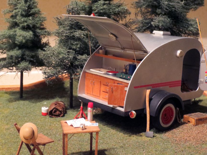

Crazy Ed Posted January 23, 2016 Posted January 23, 2016 On 1/23/2016 at 1:52 PM, gasser59 said: Here's a recently finished build. OK, That's a SnapShot of late '50's early '60's California "Camping". The only thing missing is the Tent for the Kids! While our Family was 1 Tent For All, those Tear Drop Trailers seemed to be everywhere from Big Bear to the Rouge River in Oregon.

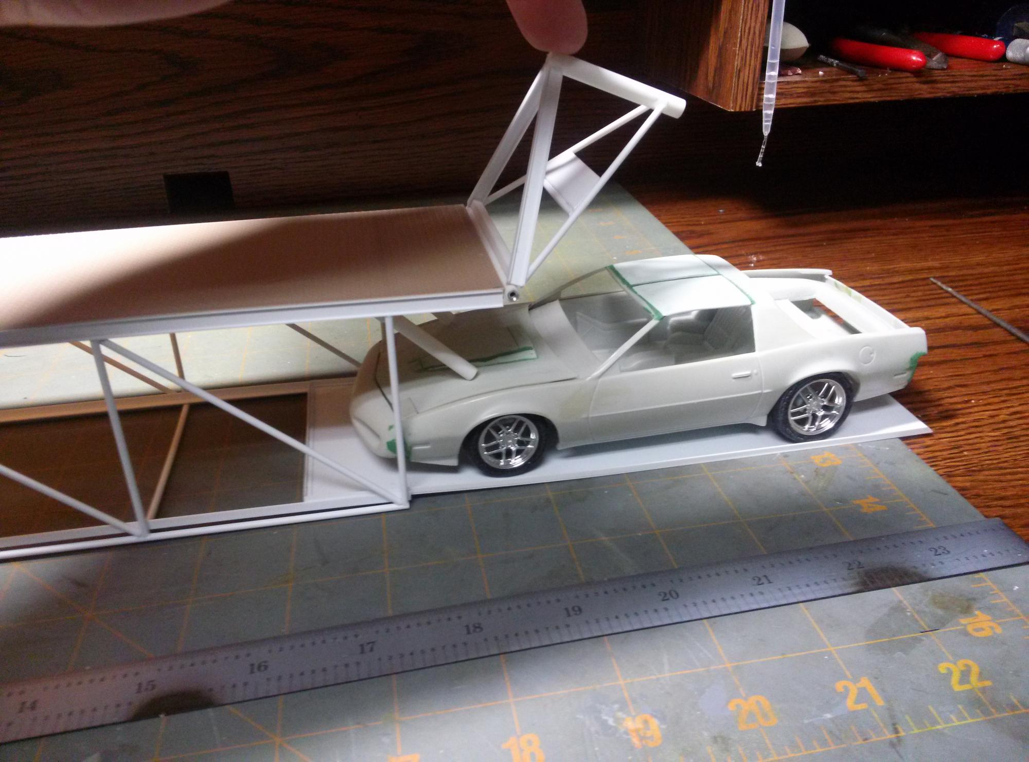

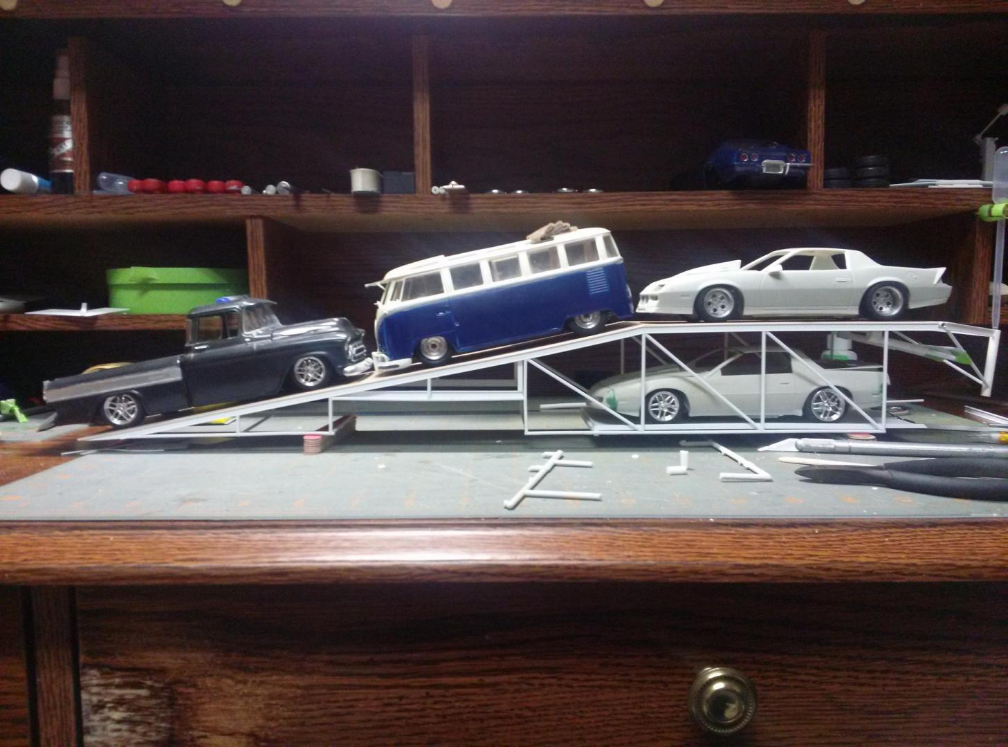

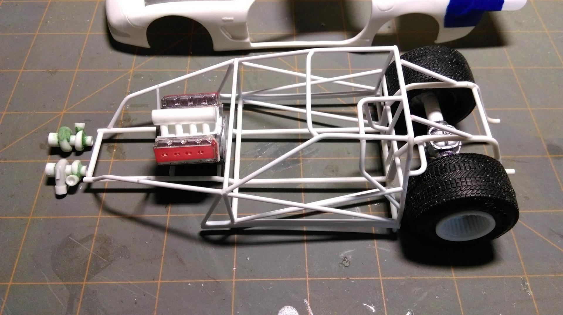

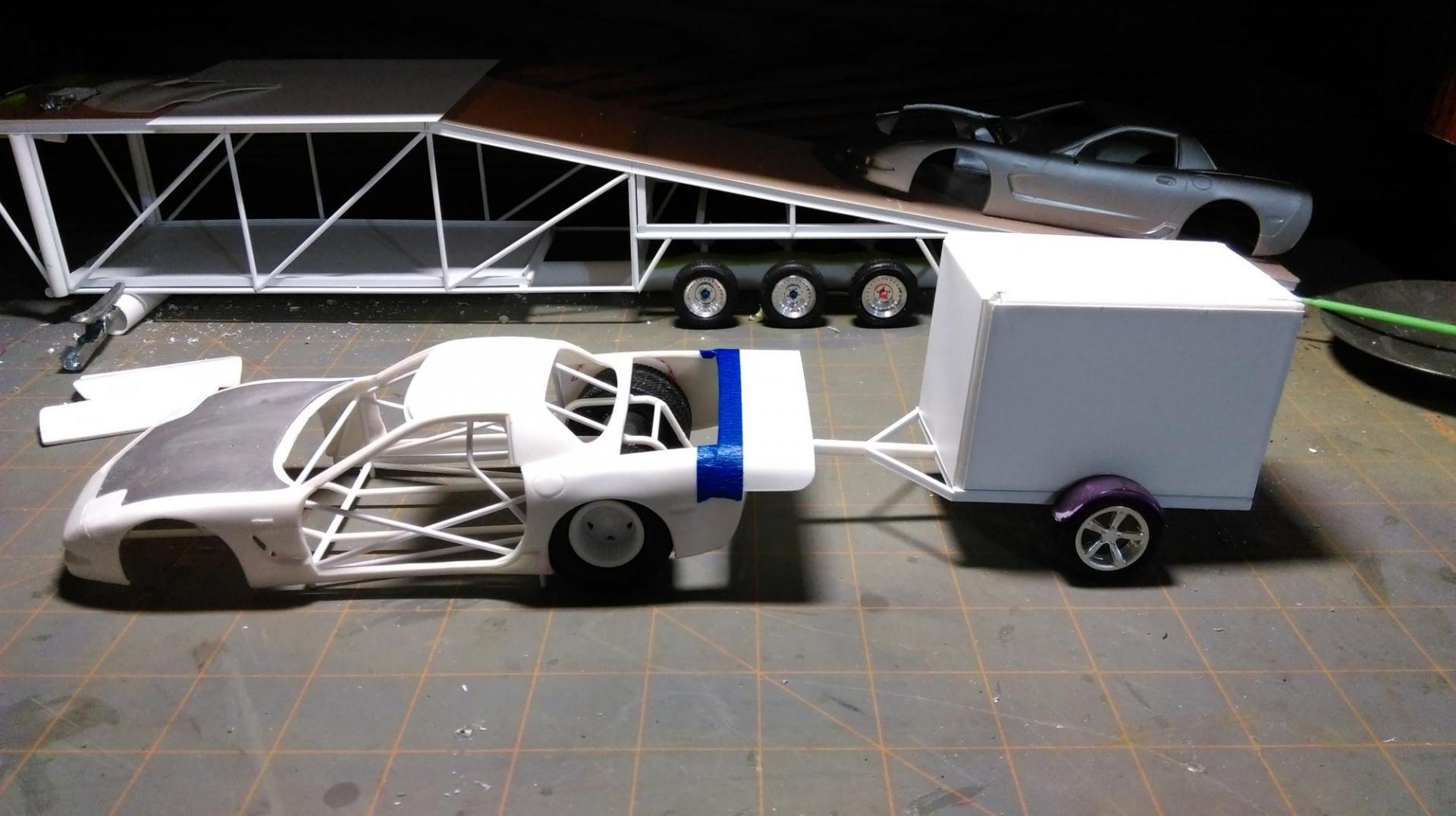

drummerdad Posted February 13, 2016 Posted February 13, 2016 (edited) You guys make me feel like an amateur. Here is some of my stuff. The trailer carries four cars, and the car on the bottom will ride on a platform that slides out. The tongue will lift to allow it to move. I also have to mod the main ramp, to allow one section to lift, because the angle on the top is too sharp to allow a car to drive over it. Here is the tongue, and the platform. Here is the start of the chassis for a drag week corvette. I have struggled with the engine trans combo, and still havent found one I like. I started the turbos, and they look ok to me (they are not finished in this picture), but I also made an F3 procharger, that could be installed as a direct drive unit. Im also not happy with the chassis, and might start over. Here is the corvette and trailer. I threw this trailer together in about 45 minutes, so It is crooked, and unfinished. Ill fix it before Im finished. I want to finish the vette first. Im working on my scratchbuilding. Im getting better, If I can keep interested. I think Im going to work on some motorcycles I recently bought, just so I can complete something. I wont modify them.....as much. Edited February 13, 2016 by drummerdad add information.

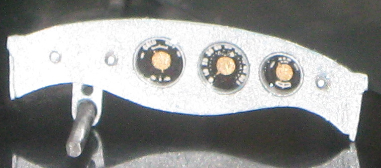

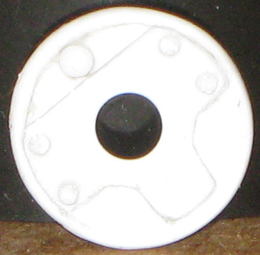

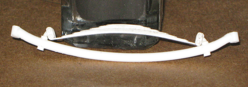

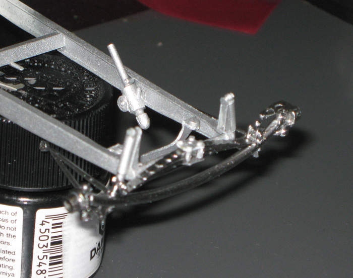

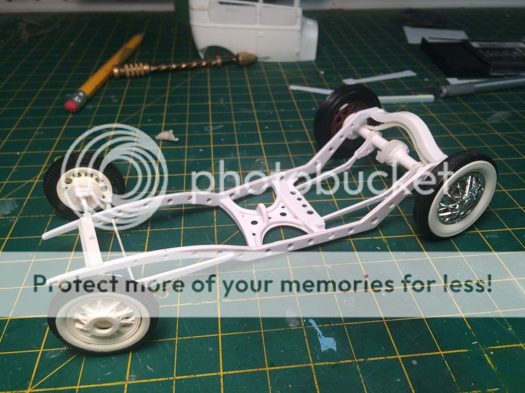

Richard Bartrop Posted February 14, 2016 Posted February 14, 2016 Some of the things I've scratched on my Neikamp roadster project. Here's the front axle and spring I built from various bits of Evergreen strip and rod: One of the spindles:: And here's the front suspension painted and installed in the scratchbuilt frame: Master for the brake backing plates: I wanted to build it the way it looked when Hot Rod did an article on it in 1950, and since nobody makes '49 Plymouth instruments in 1/25, I made some in Abodbe Illustrator, and had them printed on a sheet of plastic. The instrument bezels at aluminum tubing

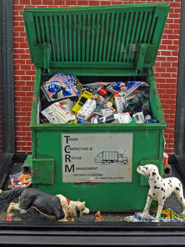

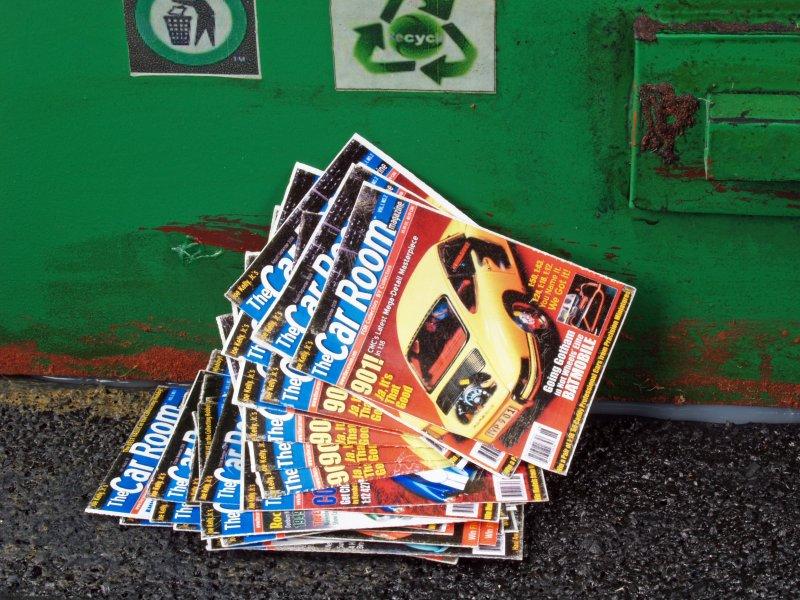

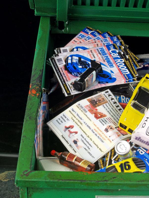

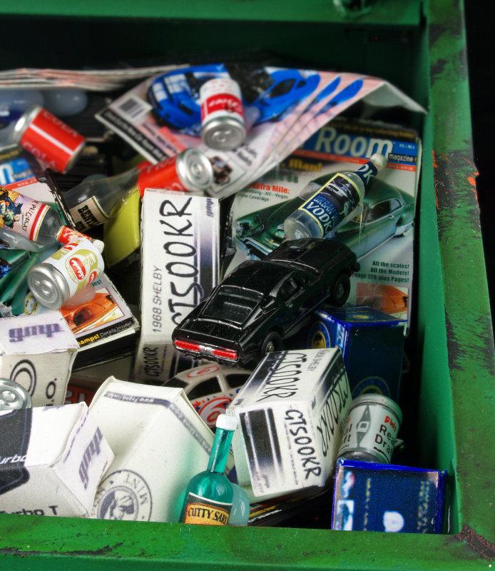

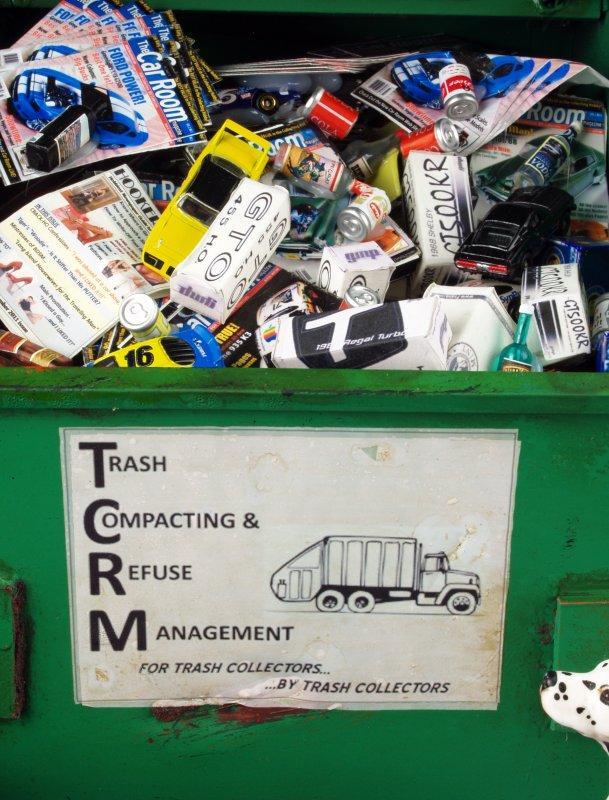

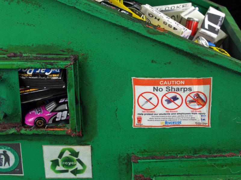

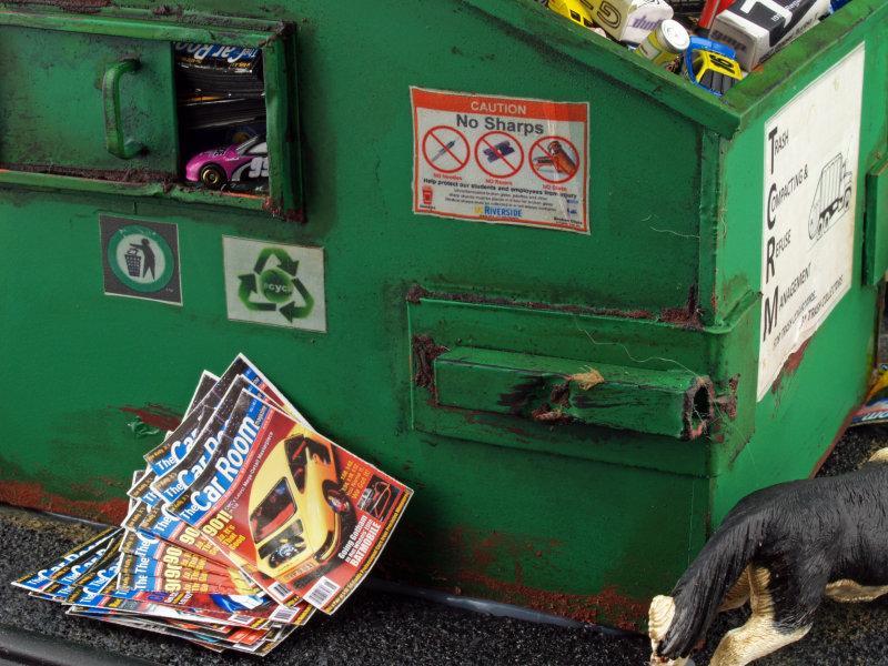

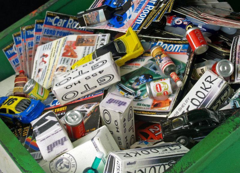

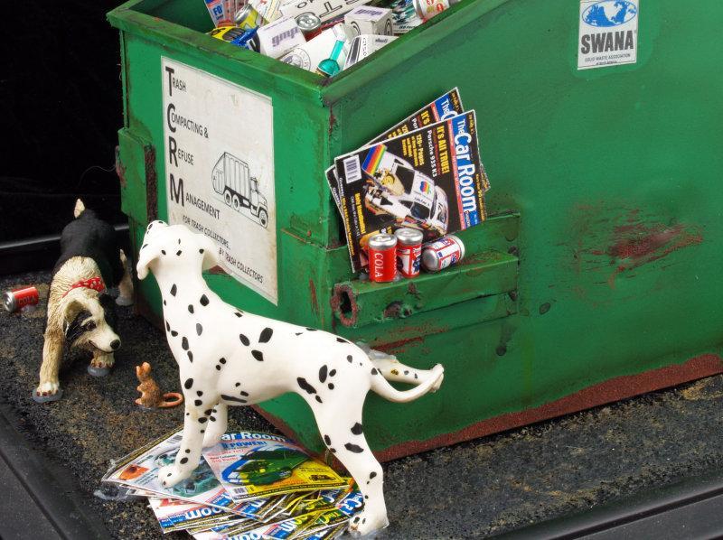

BDSchindler Posted February 14, 2016 Posted February 14, 2016 (edited) So many great things in the thread, makes a guy of my skill level go "who the hell was I trying to fool!" I have posted this in other forums but prior to getting back into this hobby again I was heavily involved in diecast collecting and reviewing 1/24th scale diecast. After an unpaid 3-year stint for The Car Room Magazine, I took a serious look at the hobby and created this diorama. It has a whole 4 page background story to it but the bottom line is that the dumpster is filled with items from different companies that were a part of the diecast industry/hobby that once had a dream before going out of business. Hence the name of the diorama..."Broken Dreams" Not everything is scratch built but the 1/12th scale dumpster, decals on the dumpster, diecast boxes and the Magazines are photo-reduced to 1/12th scale included in the trash are. Edited February 14, 2016 by BDSchindler

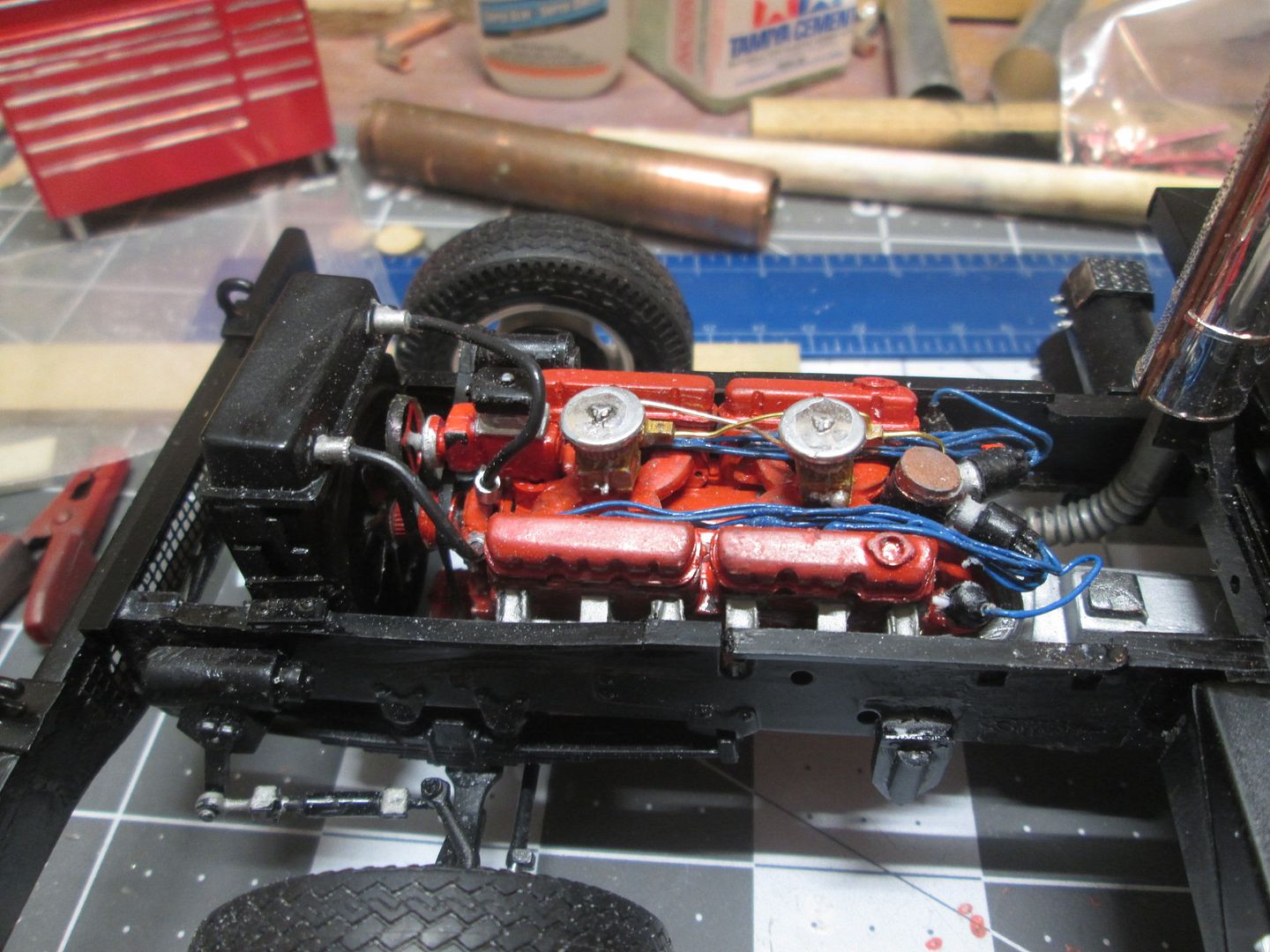

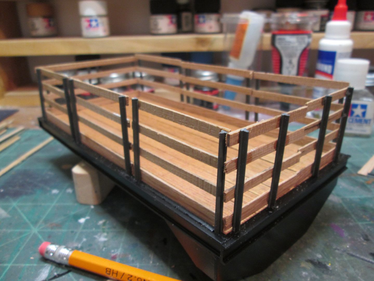

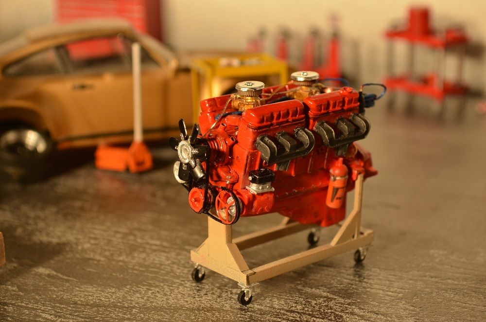

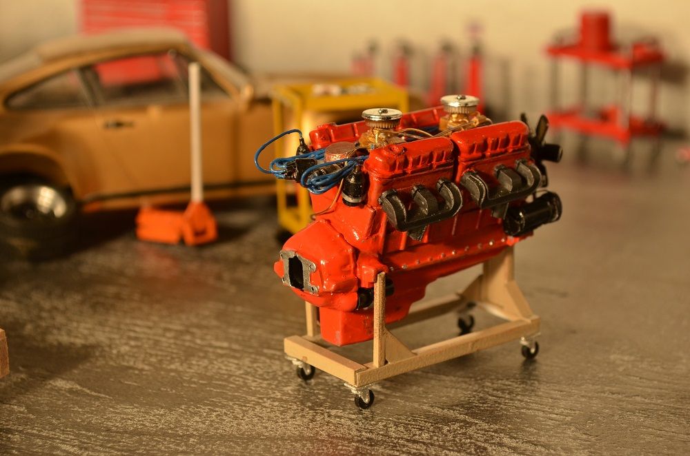

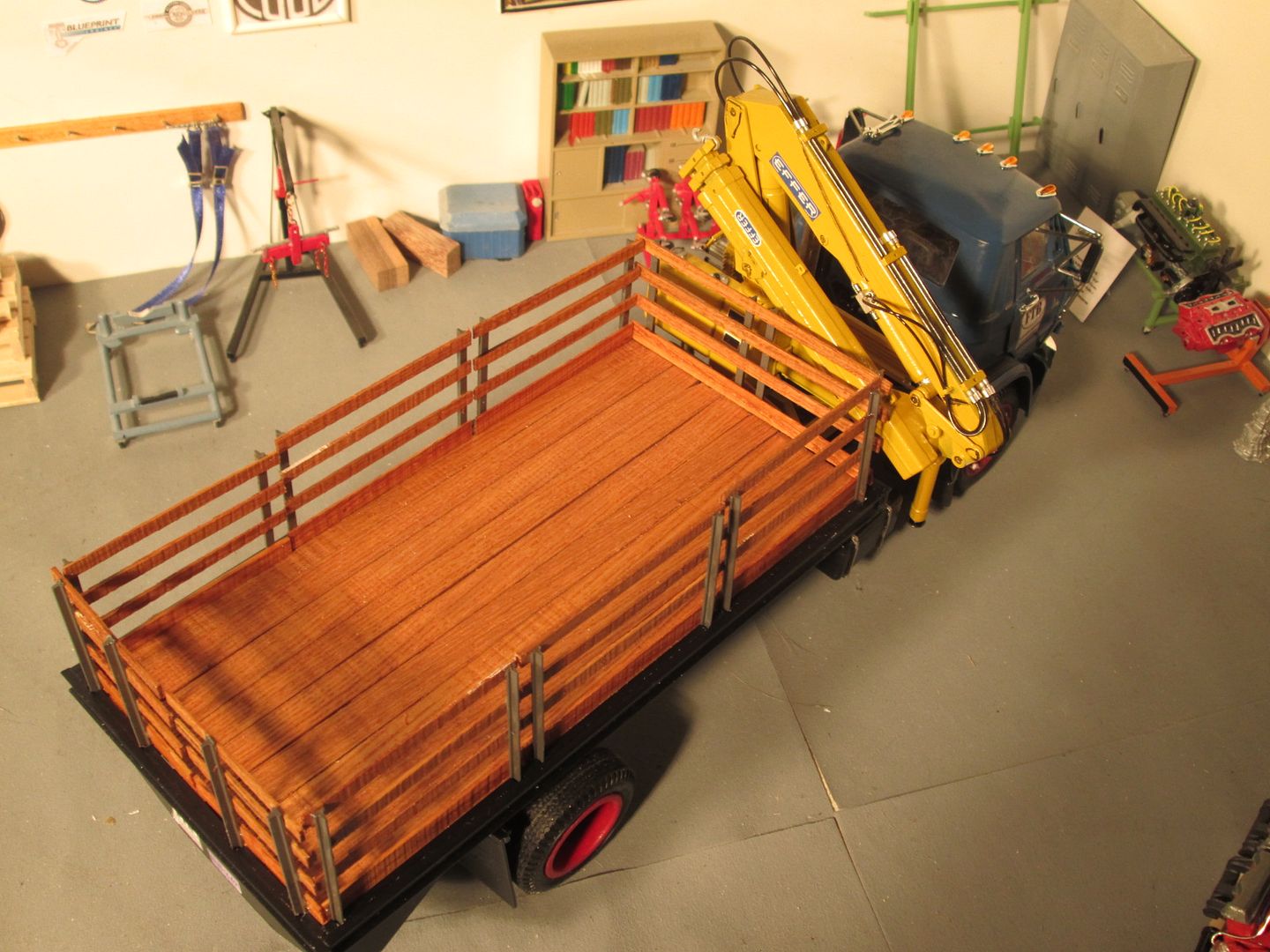

landman Posted February 14, 2016 Posted February 14, 2016 Wow! Here are a couple of my humble offerings. GMC 702 gas V12, 90% scratchbuilt. Stake body.

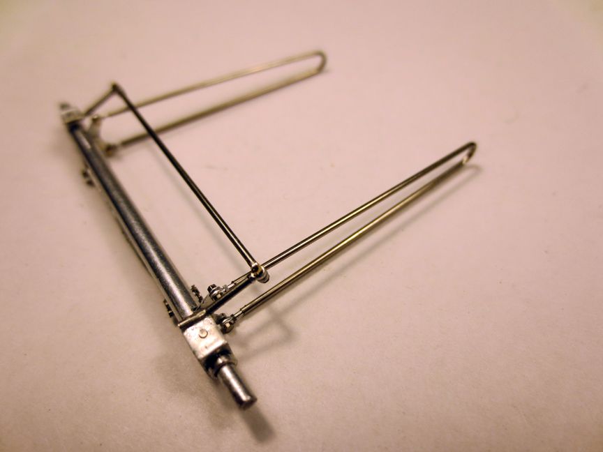

gasser59 Posted February 15, 2016 Posted February 15, 2016 I built an all aluminum functioning straight axle along with tie rods and linkage for my Walt's Puffer Too. Here it is sitting upside down while the glue dries

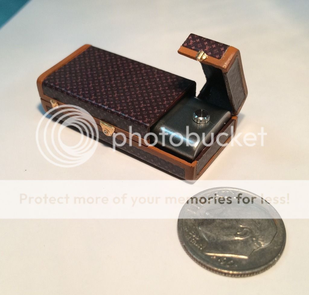

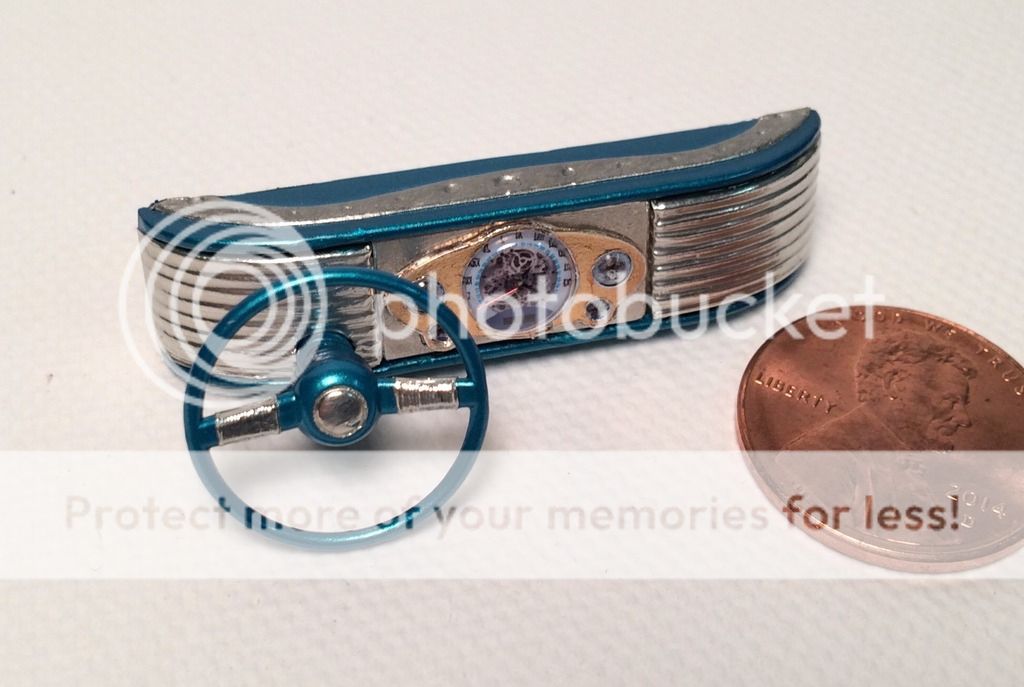

Impalow Posted February 15, 2016 Posted February 15, 2016 holy moly...this could be my favorite thread ever!! Ill chime in with a few things from my "rat" rod build
gasser59 Posted February 15, 2016 Posted February 15, 2016 Oh man Eric, that is some really cool stuff. Love the gas tank in the suitcase.
