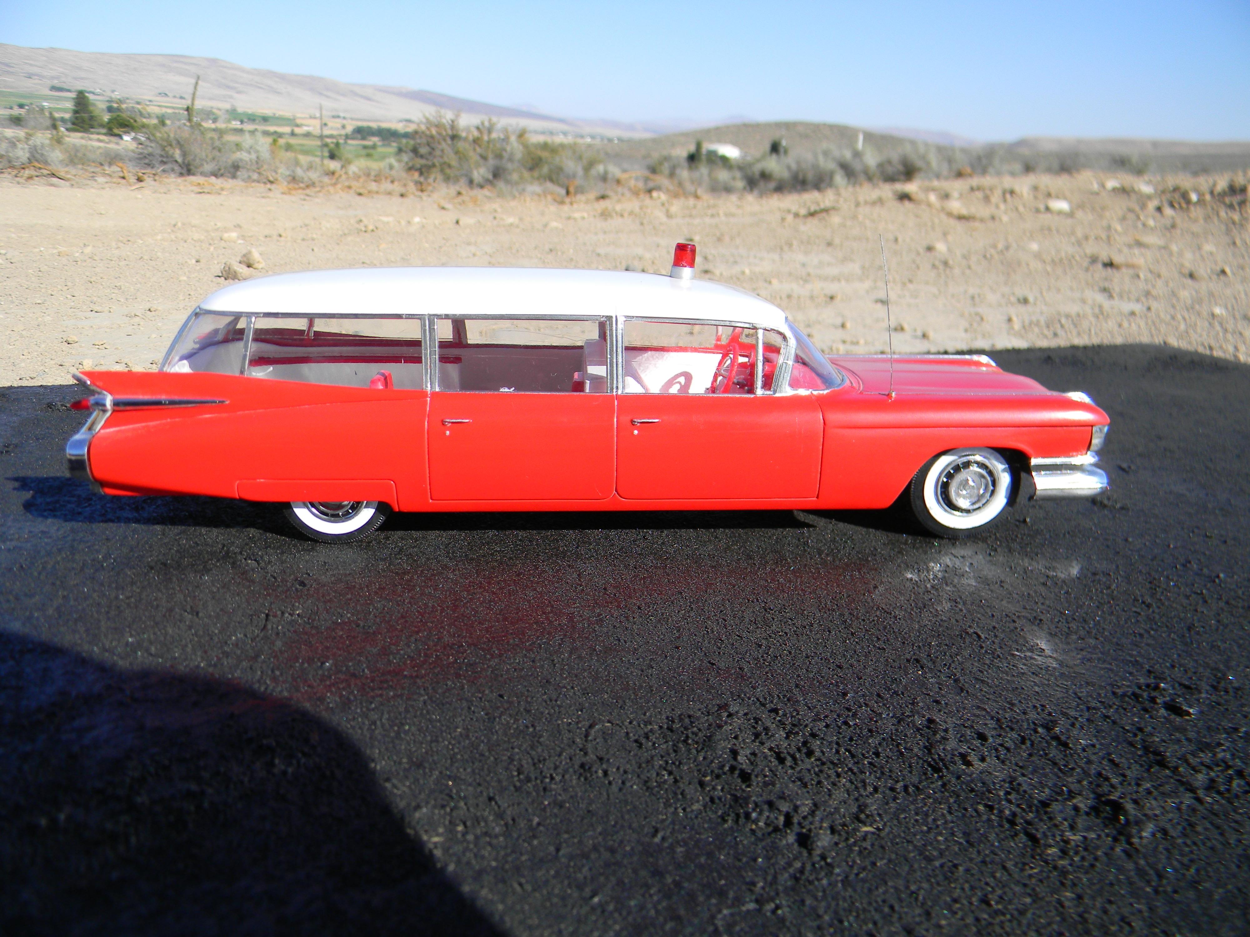

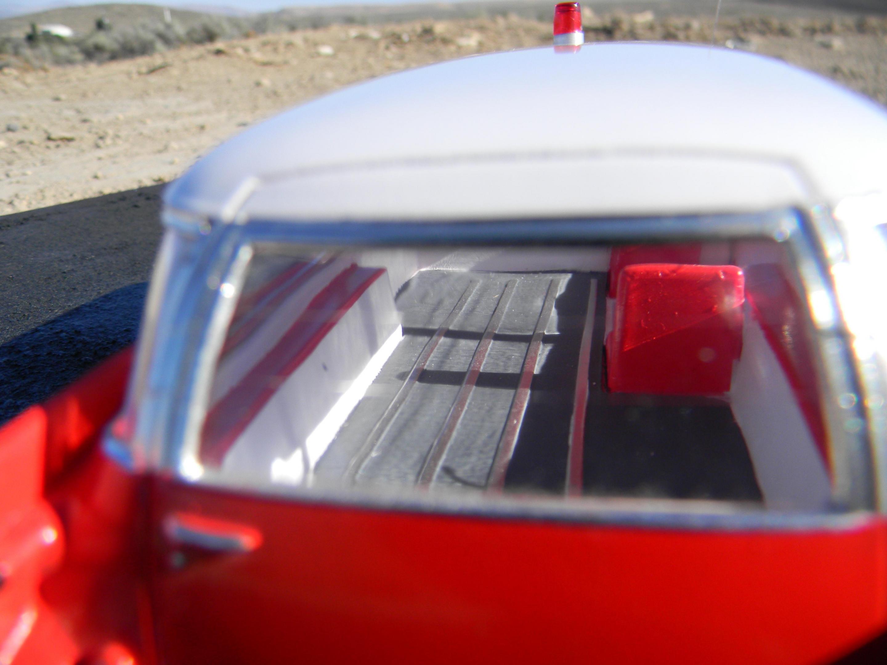

Spottedlaurel Posted March 31, 2021 Posted March 31, 2021 Great to see this thread David. I like what you've done so far, good luck with getting it finished this time around. It took me over 25 years between starting and finishing my Ecto-1A to hearse conversion, and mine was nowhere near as thorough as yours! I kept mine super-simple by using the original chassis, front seats, bumpers etc as I didn't have the Monogram donor, and I started it in pre-internet days so had very limited reference. I built mine with rear side windows, as that's how hearses tend to be here. 1:25 AMT 1959 Cadillac Hearse kit by Spottedlaurel, on Flickr 1:25 AMT 1959 Cadillac Hearse kit by Spottedlaurel, on Flickr The racks inside and out were made from brass rod and boat fittings. I look forward to seeing yours progress.

Spottedlaurel Posted March 31, 2021 Posted March 31, 2021 (edited) 10 hours ago, David G. said: Thank you for your kind comments encouragement Nigel. You did a great job on your conversion, thanks for sharing the photos. Converting the Ghostbusters equipment bay back into a casket-accommodating cargo area is the main reason I put this project back in the box. This is where my ambitions outpaced my skills of the time. Your solution is interesting and something I hadn't considered. As far as window vs landau, I still consider knocking together a couple of panels and making mine a landau but the Ecto-1 looks to be a Miller-Meteor hearse and those were just as likely to be either. Besides, I'm hoping that the cargo area will be worth showing when I'm done. I'm quite interested in the roof rack on yours. Is that something that is done in the UK? I've driven hearses here in the US for more than twenty years and I've never seen one with a roof rack. Are they actually used or are they vestigial coach remnants like the lanterns and landau bars? Regards, David G. Thanks David, I hope you didn't mind me dropping a couple of photos of mine here. My version was pretty crude, much of the work was done in the '90s and it was only when I got replacement glass last year that I was able to get on with it again. For the interior I simply choppd the back off and replaced it with a piece of varnished plywood. I glued it in place at the line formed by the underside of the windows. As much as anything, I added the roof rack to break up the big expanse of plain black bodywork complete with my less-than-perfect filling. Also it was an enjoyable little exercise to see if I could scratchbuild something and make it look vaguely realistic. I'm in the happy position of not having had to attend too many funerals so it's not something I've sen in person, but occasionally the rack is used for flowers (we don't tend to have separate flower cars here). I also wonder if it's to add an extra air of formality? Seems to have been a feature on old and newer hearses: Humber Hearse by Spottedlaurel, on Flickr Ford Granada Mk2 Hearse (Duffy?) by Spottedlaurel, on Flickr 1996 Vauxhall Omega Hearse, P34MLA by Spottedlaurel, on Flickr Some of the really swoopy modern ones I looked at when I did a search seem to be doing without it. Edited March 31, 2021 by Spottedlaurel

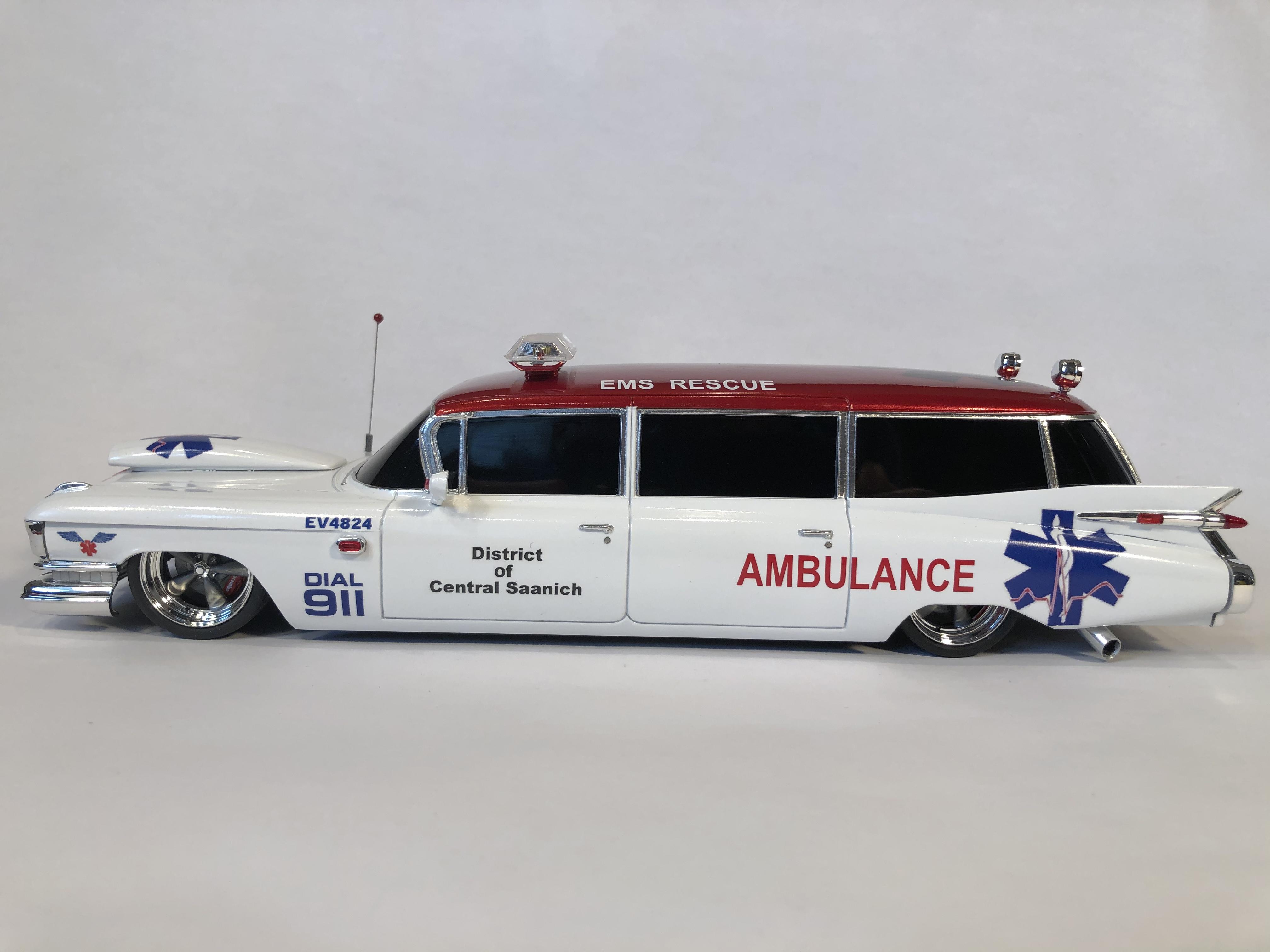

David G. Posted April 2, 2021 Author Posted April 2, 2021 7 hours ago, Steve H said: Hi David, keep going! Here is my version... Cool, thanks Steve. Love the low ride height, that should make loading the gurney much easier. I'm guessing that you had the decals custom made, right? David G.

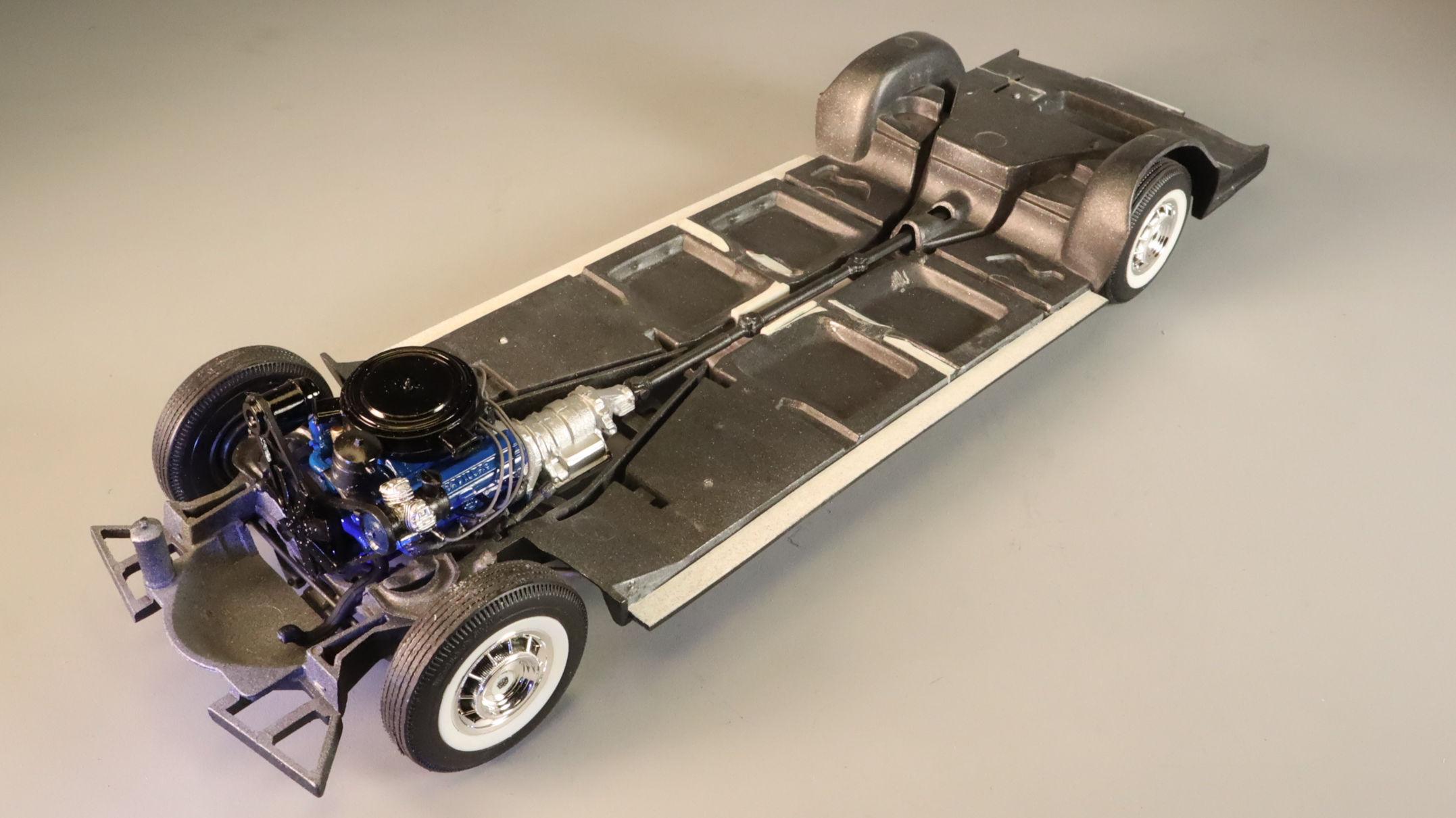

David G. Posted April 2, 2021 Author Posted April 2, 2021 (edited) While waiting for the paint to cure on my Joker-Mobile, I've been able to get some work done on this monster. I've also gone back and re-edited the old photos in this thread so they are a little easier to look to look at. Wheels Down! With the chassis mostly completed, that should give me a stable platform for building the interior... the main task that arrested my progress before. I still have to dab a couple spots of flat black in the tailpipes. As always, thanks for taking the time to look and please feel free to comment. David G. Edited April 2, 2021 by David G. typo
Steve H Posted April 3, 2021 Posted April 3, 2021 15 hours ago, David G. said: Cool, thanks Steve. Love the low ride height, that should make loading the gurney much easier. I'm guessing that you had the decals custom made, right? David G. Hi David, yes, I made the decals. By the way, love the chassis extension. I did similar work on a Johan hearse using 2 Impala chassis, I did an ok job of it, but not quite as nice as yours. Cheers, Steve
bisc63 Posted April 3, 2021 Posted April 3, 2021 Looking good so far! If I could make a suggestion, it would be to cut out the gas tank area between the rails, and replace with that area from an AMT 59 El Camino. The Elky has an incorrect gas tank setup, in that it is the station wagon type; being shaped to fit around a spare tire. You could even swing a spare tire under there for added detail.
David G. Posted April 3, 2021 Author Posted April 3, 2021 4 hours ago, bisc63 said: Looking good so far! If I could make a suggestion, it would be to cut out the gas tank area between the rails, and replace with that area from an AMT 59 El Camino. The Elky has an incorrect gas tank setup, in that it is the station wagon type; being shaped to fit around a spare tire. You could even swing a spare tire under there for added detail. Thank you Rusty, I'm glad you like it. I was not aware of the difference between the El Camino and station wagon gas tanks but after doing a quick search, I can see what you mean. I also located an illustration for the Cadillac professional chassis which I assume that Miller Meteor would have used. The illustration shows a tank similar to the one on this model. I can be happy with that. There is one thing that I know is incorrect that I may fix and that is the filler neck location. On my model, it feeds to the center rear of the tank while on every hearse of this type that I've seen it feeds from the left. I'm considering correcting this, but haven't made a final decision yet. Thank you for your suggestion Rusty, I always appreciate help when it's offered. David G.

bisc63 Posted April 4, 2021 Posted April 4, 2021 14 hours ago, David G. said: The illustration shows a tank similar to the one on this model. I can be happy with that. Cool reference. It makes me wonder, though, IF and WHERE does a hearse carry a spare?!
