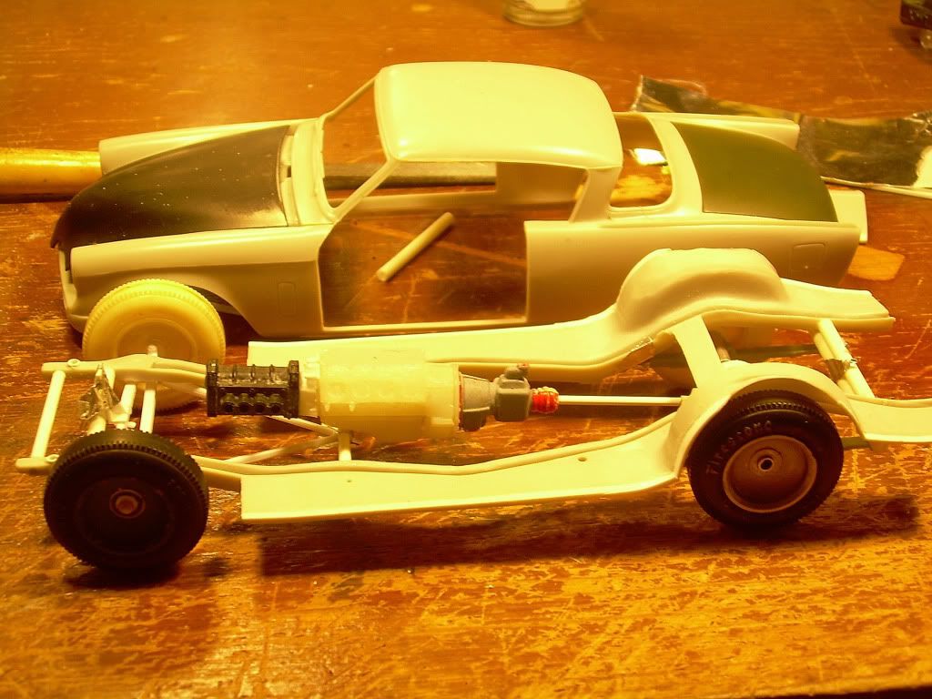

Inspired by the Cagle-SanChez car of the mid '50s, this one's going to be front-blown Cad powered. Lotsa engine setback, two-speed champ-car gearbox, long housing for multi-plate clutch. Maybe.
Had to open all the panels to show off all the guts. Fabbed firewall (not shown here) to clear the extreme setback, and support door hinges. Still have to do the B-pillar Starlight Coupe mod, and I MAY chop the top a little.
Front suspension is copied from the original: independent stuff removed and a '40 Ford I-beam setup substituted. She'll run heavy leaf springs in the rear and a big QC champ-car center section with a live axle and disc brakes.

Where did you find those wheels and tires?
They are the front wheels/ tires from the old Monogram Kurtis Indycar kits. Monogram%206715%20Indy500.JPG

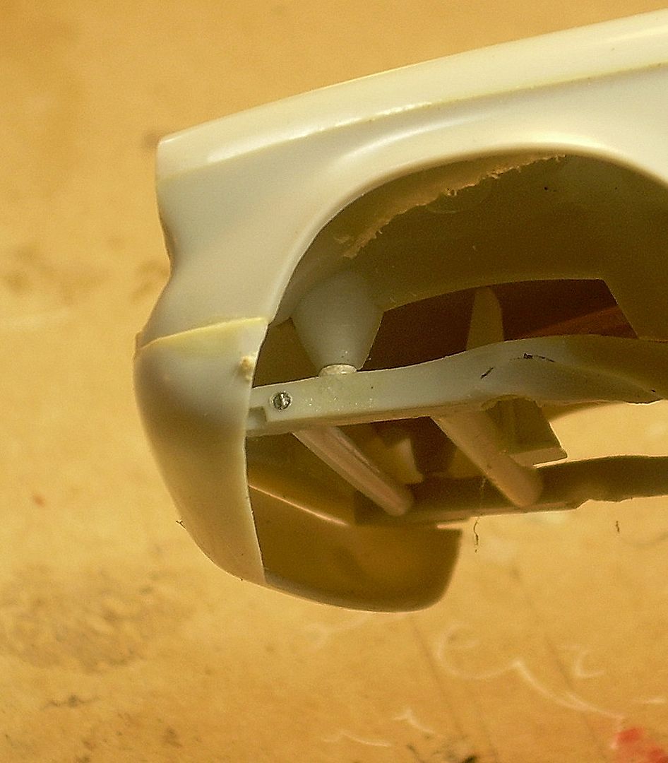

Fitting the nose closeout panels. Hood orange peel is actually crazing, the result of trying a hot self-etching primer in the hope of killing ghosting where I removed some trim.

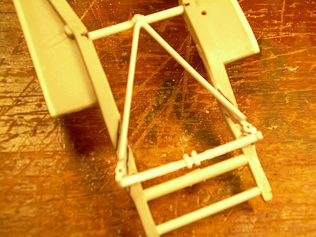

This is an adjustable front spring perch identical to the solution the 1:1 Cagle-SanChez car used. The object was to be able to tune the angle-of-attack to balance lift and drag.

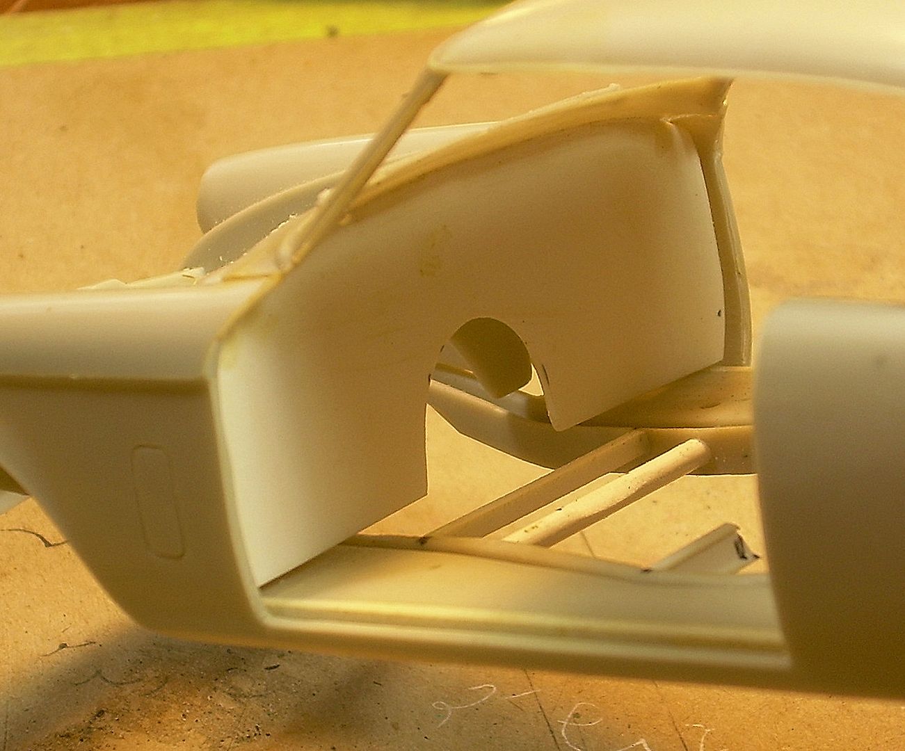

Fitted firewall that will replace all of the original engine compartment sheetmetal.

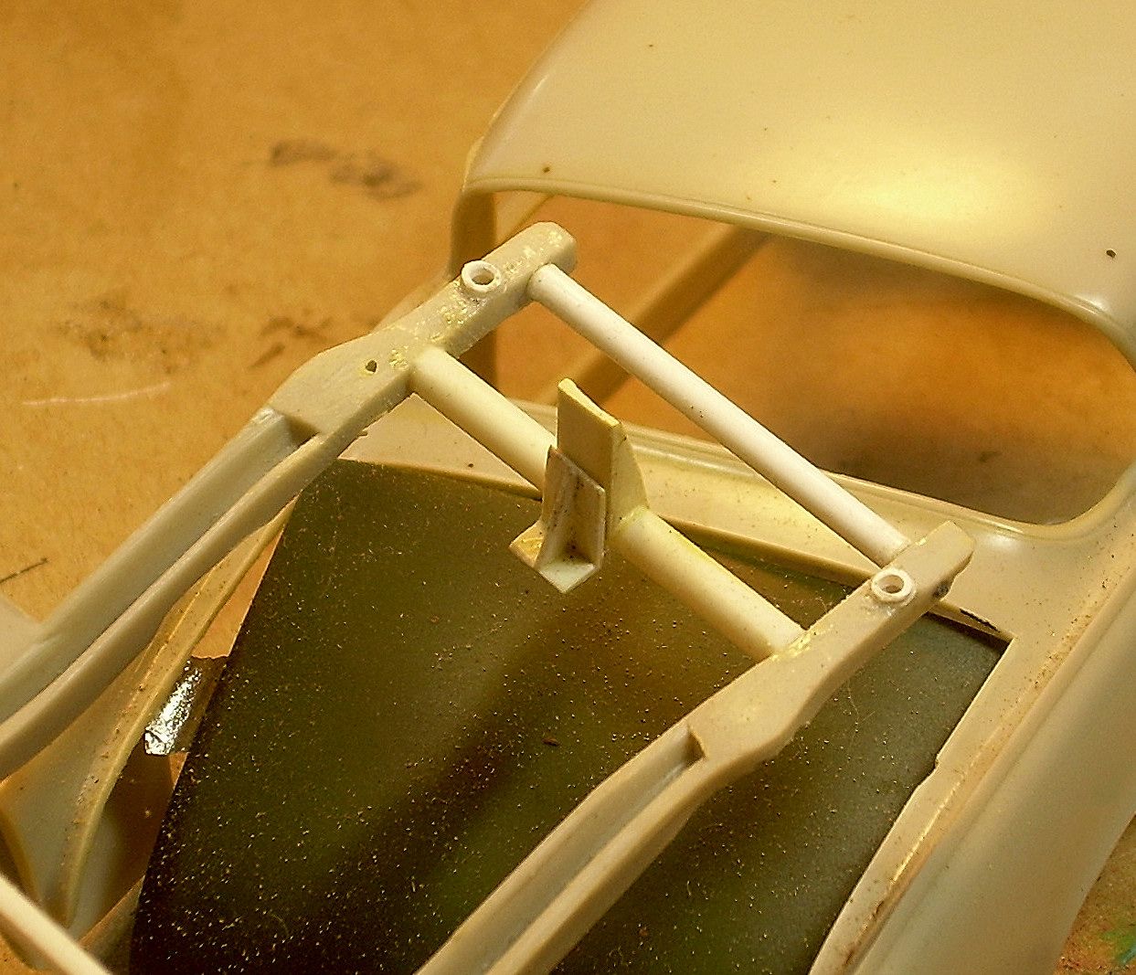

This is a spacer to move the chassis down relative to the body. After opening the doors, it became obvious that the chassis fit too high in the body shell, so the floor would have an incorrect step at the sill. The front fenders and hood will also be removable, and this pinned arrangement will let the front clip go back in the same place every time.
I made the firewall before I realized I'd have to space the frame down, so it's a tad too short. Styrene extensions will close the gaps.
