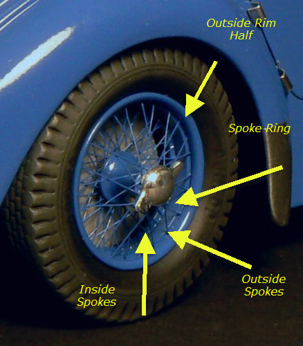

Plastheniker Posted November 10, 2013 Author Posted November 10, 2013 Probably you have noticed this topic by member Curt Raitz http://www.modelcarsmag.com/forums/index.php?showtopic=81345 Curt re-discovered this old topic started in 2007 by member Yad' who left the forum obviously in 2008 http://www.modelcarsmag.com/forums/index.php?showtopic=6659&hl=%2Bmaking+%2Bwire+%2Bwheels#entry808443 His topic is about his technique of making wire wheels. Curt adopted Yad's technique with marginal modifications in his own a. m. topic. This re-discovered technique is very similar to my obsolete technique described in the 1984 article of a German modeling magazine (depicted at the beginning of this topic). The results of my obsolete technique and Yad's technique are identical. I did not explain my obsolete technique because though very simple its results are no match to my modern technique. As said:"When using the obsolete technique the spokes are applied directly to the plastic wheel halves. This technique is okay for very narrow rims as bikes, motor-cycles and and very few vintage cars, where all spokes are fixed very close to the centerline of the rim well , but on all other cars this looks completely unrealistic". Now thanks to Curt you can compare the results of my simple obsolete and my present technique. Because Curt adopted Yad's technique without changing anything essential I recommend to choose the original link of the former member Yad' and Curt's link as well . Here are some more pictures of wheels made with my present technique. I think the additional effort of the present technique pays off. http://www.modelcarsmag.com/forums/index.php?showtopic=78461http://www.modelcarsmag.com/forums/index.php?showtopic=80009http://www.modelcarsmag.com/forums/index.php?showtopic=81255http://www.modelcarsmag.com/forums/index.php?showtopic=81024 (scroll down for a second car)
curt raitz Posted November 10, 2013 Posted November 10, 2013 Thanks Jurgen I didn't know "diddely squat" about wire wheels until I started to make'm myself. I got tired, just like everyone else of the "out-of-scale" wire wheels out there. The method I've been using has the spokes centered between both rims, good for bikes and old dragsters May not be accurate on some applications, but better than what comes in the box. There are a multitude of wire wheel patterns and levels as Jurgen has pointed out I'll be giving his method a try and see how it works c'ya
Plastheniker Posted November 11, 2013 Author Posted November 11, 2013 Curt, You are absolutely right. Any self-made wire wheel, even those made with the simplest techniques (up to now I saw about half a dozen more or less simple techniques), is better than the best plastic wheel. I have no doubt that a modeler of your skills will master any technique. As I said before (I think): If any questions occur please post or send a PM. Here is another picture sent to a forum member showing the construction of the wheels
