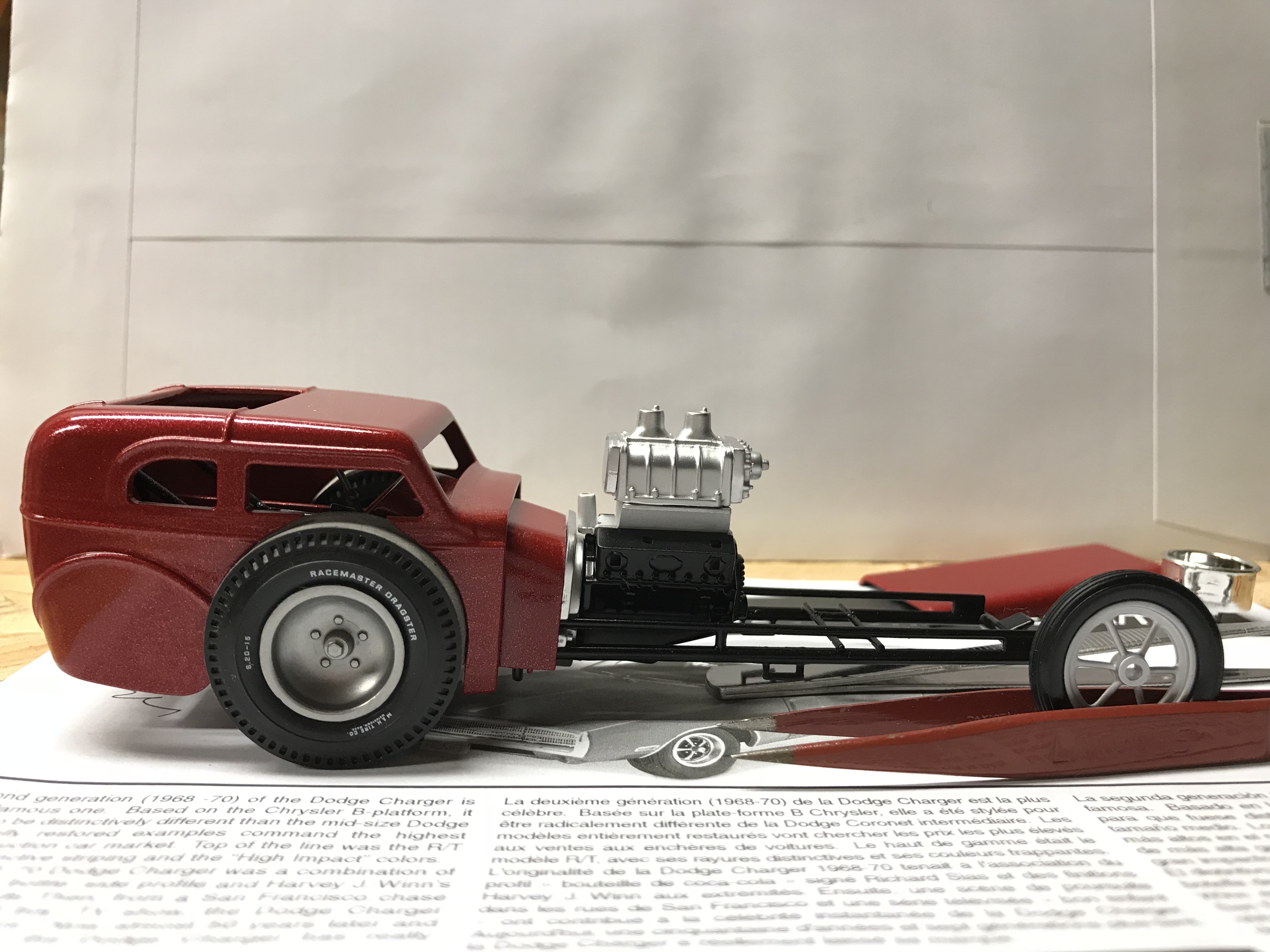

That was my big disappointment in the kit...opened it up, looked at the slicks, and went..."what the eff??"  I've seen them used on a '27 Ford hot rod, they're about the right size for that application.
I'd be curious to see some actual measurements. Just from looking at historical photos, I can see that the slicks should probably be larger in proportion versus the Bantam body.

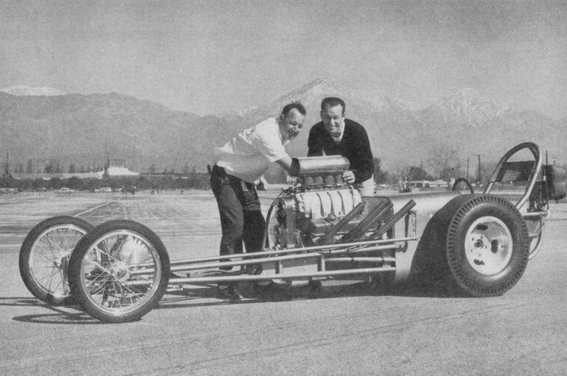

No problemo. We had an old blown SB Chebby-powered rail on a Dragmaster frame in the shop several years back.
The owner wanted it freshened to do some nostalgia drag events. The 16" slicks were rock-hard, and measured about 31" diameter.
We replaced them with repro slicks in a 32" diameter from Radir.
This is the general look of the car...
Image result for Dragmaster frame
Here's the Radir catalog page...
http://www.radirwheels.com/slicks.htm
Edited by Ace-Garageguy

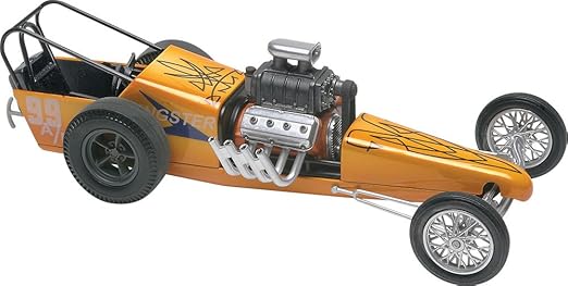

Well, here is a K-88 Chassis, what I am assuming is what the kit represents, with some rather small tires on it.
There's this thing called perspective, but if you really think those small tires in the kit look right, by all means use them.
That's an injected nailhead-powered car, and isn't going to need as much tire as a blown SBC-powered car anyway.
Tire diameter can be used to augment gearing, as we all know...or should.
Most of the cars I'm familiar with that appear to me to be what's represented in the Slingster kit run significantly larger rear tires.
The box-art appears to show larger rear tires as well.
There are other scaling and proportion issues, but maybe it's just not worth the effort to try to disseminate correct info.
I'm beginning to find that to be the case.
And besides...what do I know ? B)
