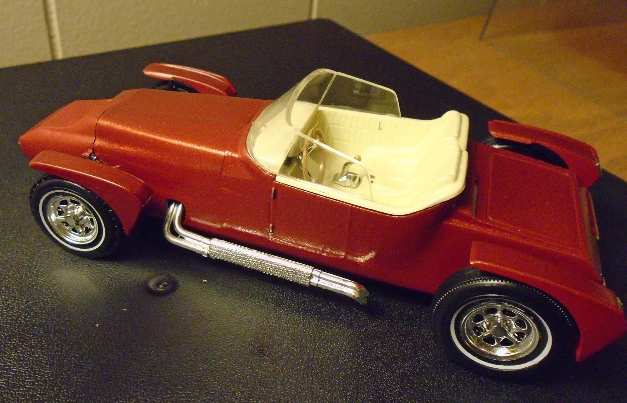

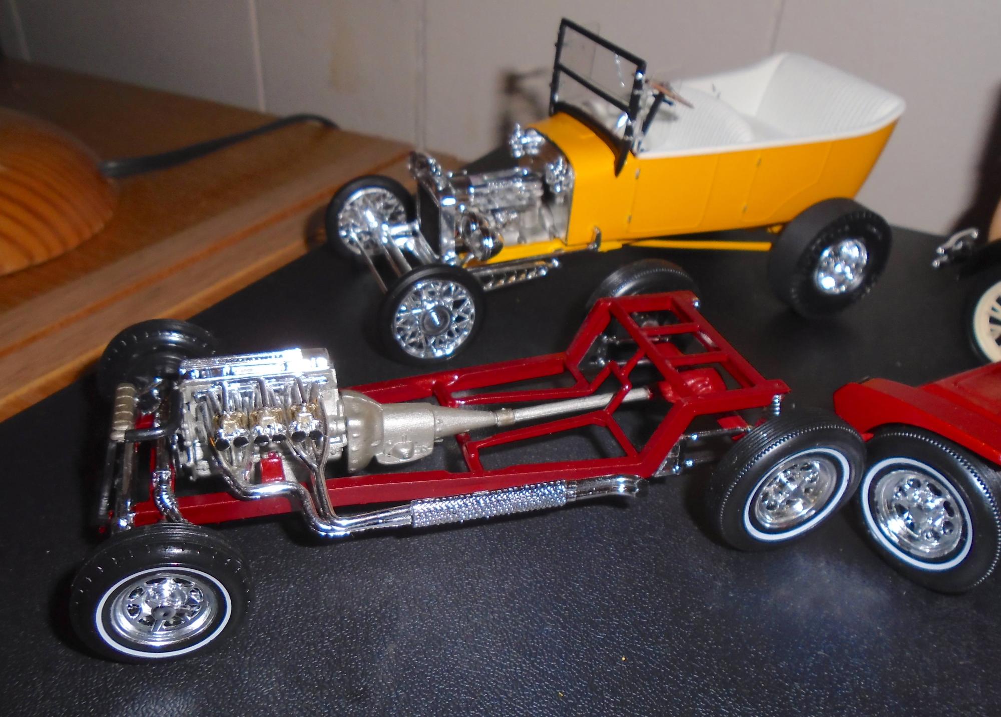

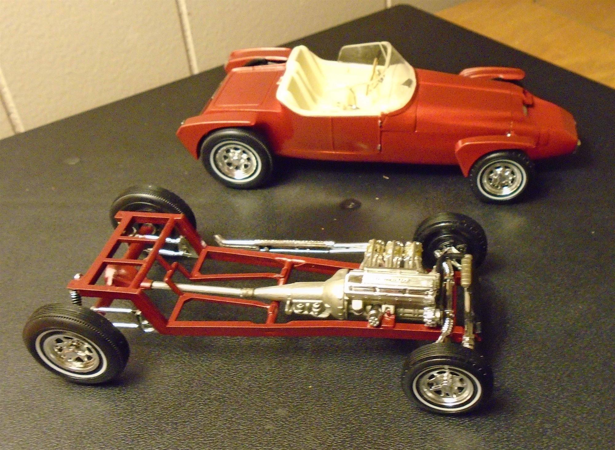

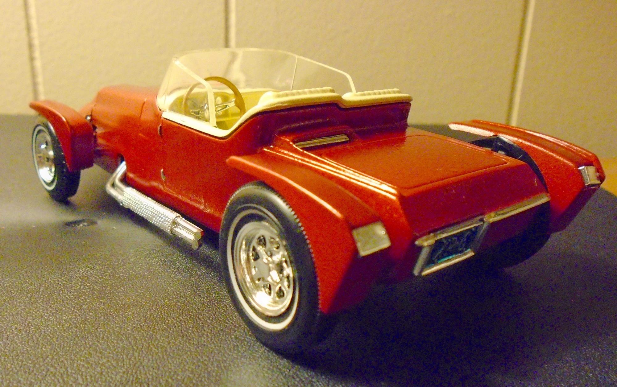

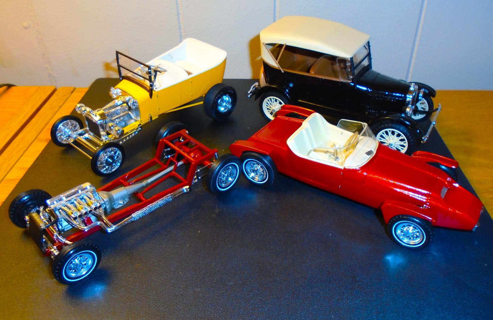

Get work! I love this kit, and just added a new topic about an older build I did of the whole 1927 T Double Kit. I don't think my building skills (or photo skills!) match yours, based on the excellent work you've shown so far, so I'm going to be watching your topic anxiously of more updates.
