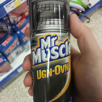

fitforbattle Posted May 12, 2014 Posted May 12, 2014 I got a suggestion about using Mr. Muscle oven cleaner (see picture below). Has anyone tried it? Is it even available for you guys on the other (wrong ) side of the Atlantic? Paint is revell enamels(?).
Frank Posted May 13, 2014 Posted May 13, 2014 It's good stuff for stripping paint and it's even available down under in Australia.
Dinky Posted May 13, 2014 Posted May 13, 2014 Mr. Muscle oven cleaner does not work for all paint. I used brake fluid DOT4, all brake fluid should work (3, 4 and 5.1) except for DOT5. This is the result using Mr. Muscle oven cleaner This the result of 24 hours DOT4 On the dutch forum a lot off guys are using brake fluid.
fitforbattle Posted May 13, 2014 Posted May 13, 2014 Thanks for the input. I covered a kit with the Mr. Muscle oven cleaner last night so we'll see. Hopefully it works.
