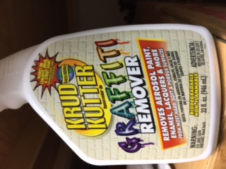

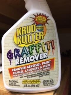

BDSchindler Posted May 16, 2017 Share Posted May 16, 2017 I picked up this "Graffiti Remover" today to try after I had a chevy pickup sitting in Purple Power for 3 weeks with very little movement. Truck was painted with Gravity Colors metal flake about a day befor going into the bath. I only soaked a couple of test pieces but t it removed everything to bare plastic in no time and only required minor scrubbing in tight areas. One of the prices I used some squadron to fill a hole and it did attack that also. Since the body has a fair amount of 2-part filler and some squadron on it, I'll just leave that in the purple power and scrub as needed. So far, it does not appear that the purple power is attacking any of the fillers used on the body. Quote Link to comment Share on other sites More sharing options...
