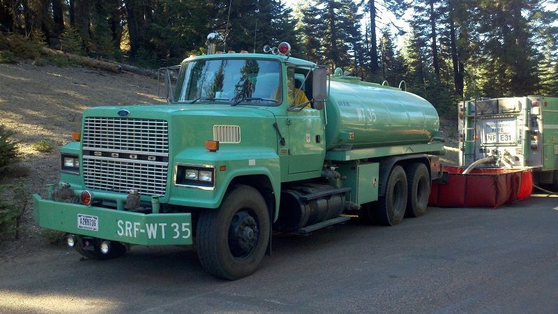

My plans for the kit are to end up with something quite like this.
The Italeri kit is a no brainer, it is the only LTL kit I know of. I'm planning on a piece of ABS pipe for the tank, heated and flattened into an elliptical shape (first time I've tried this so wish me luck) and various bits of styrene for the other tanker body components. I'll be stealing a Caterpillar 3406 from the Revell Peterbilt snap kit for power, then there is the daycab conversion which I have already done.

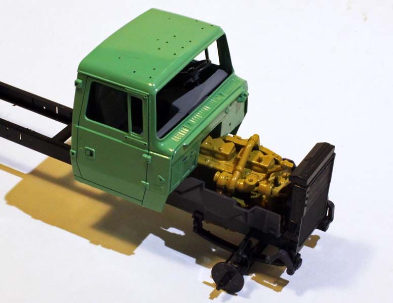

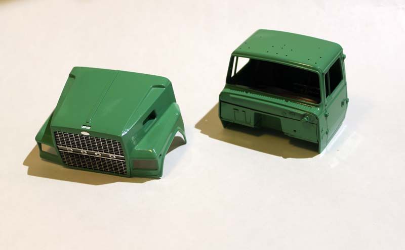

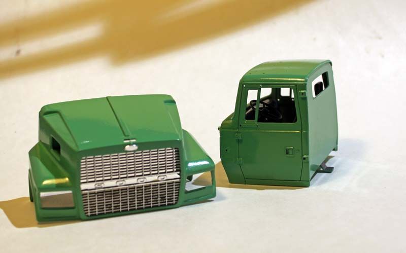

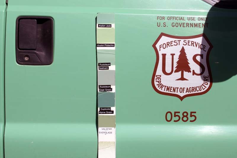

Here is where I currently sit. The kit comes with a fancy chrome grill shell, while the real truck has a smoothly integrated body color grill surround. Was easy enough to blend the grill into the hood, then mask off the bits that will stay chrome.

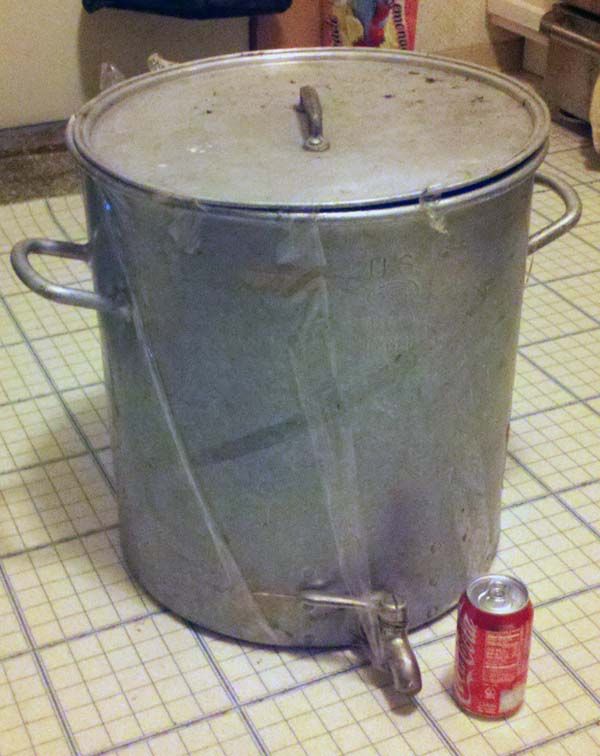

I've got a Lindberg Tanker, but I've been wanting to try the PVC / ABS pipe method for quite some time. I even got a big pot special for the job.
Yes, Sir....Good job on matching the paint.....Great start....
Thanks, I've spent some time finding just the right shade of green, this sort of became a project all of it's own. :)

I was planning on using boiling water, not direct flame to heat the pipe. The chemical issue is part of why I'm using a dedicated pot rather than my wife's big stew pot. I'm not sure I want to eat out of a pot used to boil plastic. I'd never use this pot for food anyway, it came from an old building that at one time had a morgue in the basement, no telling what might have been "cooked" in the pot. :blink:

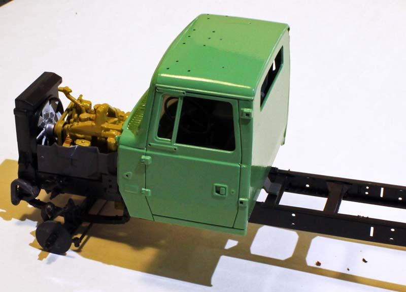

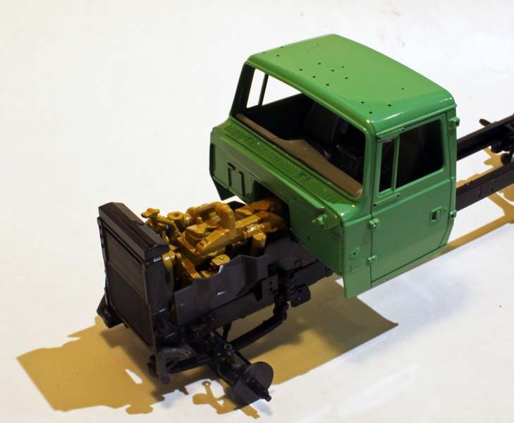

I've been away for 8 days, hoping to get back to this now. Got a little work done on the engine before I left, swapped the Cummins from the kit with the Caterpiller out of a Revell Kenworth.
The kit is set up for a sleeper. The rear panel in the kit has a large opening with a deep lip around it, so just easier to make a new rear panel with a standard size rear window.
Need a lil dulcote on that CAT too glossy
Just a test fit, engine is fresh from the spray booth. Once the paint cures for a few days it will get detailed and mildly weathered, won't be so glossy after that.
