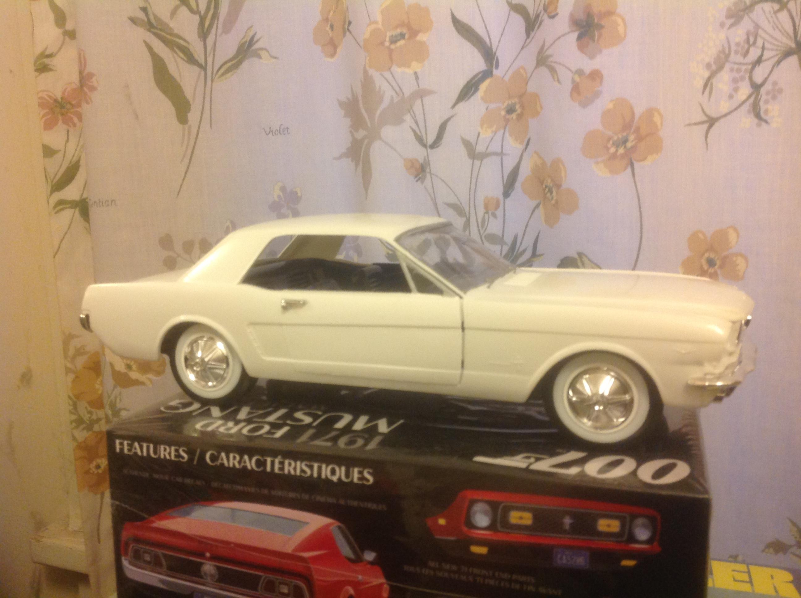

Rob Hall Posted June 20, 2014 Posted June 20, 2014 The kit has 'em molded to the doors. The builder of that box cover car hacked 'em off for some reason... The vent windows on that kit look a bit undersized, could be because the angle of the A-pillar is off
Casey Posted February 19, 2021 Posted February 19, 2021 Here's the passenger side door...see anything which looks slightly off?
Rob Hall Posted February 19, 2021 Posted February 19, 2021 10 hours ago, Casey said: Here's the passenger side door...see anything which looks slightly off? The vent window frame is angled back too much.
iBorg Posted February 19, 2021 Posted February 19, 2021 Casey- so does the kit come with that used and abused patina out of the box or did you have to work at it?
Casey Posted February 19, 2021 Posted February 19, 2021 4 minutes ago, iBorg said: Casey- so does the kit come with that used and abused patina out of the box or did you have to work at it? This one's been tumbling around in a parts box for who knows how long. Still shocking to see how far off the windshield angle is, and think someone said "eh, it's fine, let's go ahead with it". ?♂️
mk11 Posted February 20, 2021 Posted February 20, 2021 (edited) On 4/6/2014 at 8:14 PM, Modelmartin said: I know that they are commonly called 64 1/2 but Ford never labeled them as such. 65 would be correct... True, that Ford marketed them as '65s, but they used the 64 1/2 id for internal documents, part listings etc as they had to differentiate them from the actual '65 model year production cars. Some of the engineering changes during the model year changeover in the summer of '64 were introducing alternators (only five years after Chrysler adopted them) and changing the 289 engine castings to accept six bolt bellhousings, among others. An important change during the '64 model year was the transition from open draft tubes to pcv systems. The 260 was dumped for '65 also, replaced by 3 different versions of the 289. Regarding perspective on this 1/16 body, the roof C-pillar is actually about 3/16" back of where it should be; meeting the rear quarter at about the halfway point between the door rear edge and the back end of the quarter. Moving it forward should restore the proper 40 degree windshield angle. There really is no excuse for such a poor interpretation of this in scale. Scaling up directly from the 1/25 coupe should get a guy in the ballpark. Now, if we could just get a scale set of F70-14s for this, we'd be set Edited February 20, 2021 by mk11

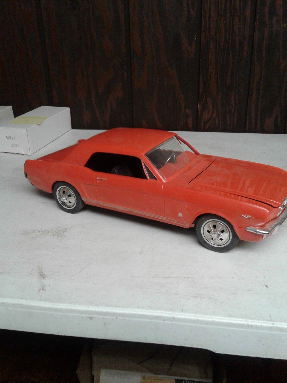

mk11 Posted February 20, 2021 Posted February 20, 2021 Sure be cool to find one of these for bashing a full detail model. The perspectives are a lot closer than amt's. No idea who made it...
Rodent Posted February 20, 2021 Posted February 20, 2021 Wen-Mac. They did a '67 as well. They appear on ePay all the time, but be prepared to open your wallet for a nice one.
