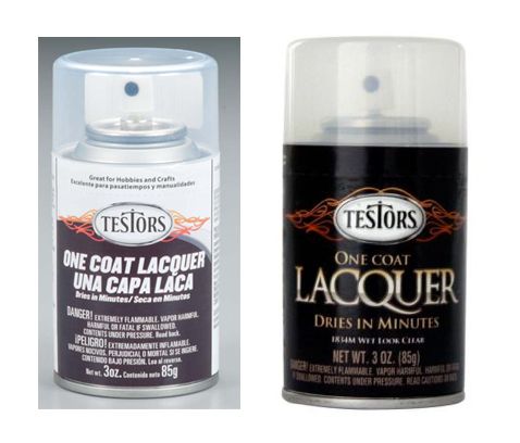

Brett Barrow Posted July 2, 2014 Posted July 2, 2014 Are these two the same thing? Yup. New multi-lingual label vs old label.
