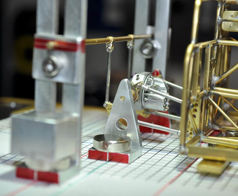

Today, I got the 4 links done. The rear is now in position, height and side to side and back/forard. Now I can start the rails. The jig worked VERY well but todays work was fairly simple, straightforward stuff. It's true capabilities will be tested in the coming days. The tubing is s/steel and I tried to replicate the bungs on the ends of the rods by softening the edges of RB Motion A & N fittings. Kinda worked. Now, if I had a lathe, I might have..... A few pics.......

Whew...thanks Randy. Glad you like it. What you won't see is that today I spend 2 hours tearing it all apart and re-doing the bars and geometry on the rear It was wrong. Now it's correct. I thank my friend Dave for catching that one. Oh well, better to get it right. If you go to my Fotki page you'll see the changes I made. And I must add that I'm so flattered that you think enough of the build to share it with others. Especially those not familiar with our hobby. Cheers
Michael - Thanks dude. See my comment for Randy. Nothing is easy it seems. But, it WILL be correct. Please note too the difference in the diameters of the upper v. bottom bars. The tops are 1.1mm and the bottoms are 1.4mm. Dave pointed out that the bars on real cars are substantially bigger than most modellers make them (1.250" to 1.5" in diameter) So, I took what was the closest material (s/steel tube in this instance) to replicate the 1:1 cars. It's the little things.

Hi Tim, I didn't notice, but now I can see the difference. The length of the bars lets the thicker material look right. I use 1mm tube so far, I'll give a little thicker material a whirl next time.
Question; How have you constructed the rod ends? The "sleeve" looks correct on the ends, is it just a larger size tube slipped on to the ends?
I also like the double brackets, so far I'm happy to get a single piece in position! I like this setup a lot.
Michael

Michael - I took RB Motion .054" A/N fittings and slipped them, one at a time, on a thin brass rod against my dremel wheels. First the "red" sanding wheel (dremel part EZ473SA held at an angle and then the polishing wheel, Dremel part # 512E. That took the edges off of them for the most part and shined them up afterwards. I like the contrast you see on the ends. Took 20 minutes to do 8 of them. Let the part spin against the wheels, don't hold them still or you'll immediately get a flat spot.

Today a few pics of the setup I've done to locate the rear shocks since the rear end is now in position. I wanted to "protect" my Penske shocks so I made matching rods that match them in length and you'll see them in position on the shock brackets I made. These key pieces are now fixed. Now it's time to bend and solder some brass tubing to get this thing moving forward. I did discover one aspect of my jig that I don't like. The magnets have a tendency to grab some of my tools if I get them too close to them. THAT can / could be a real problem. You'll see in on the taller brackets that I put some 1/2" aluminum block over the top of the magnet to "shield" my tools from their magnetic field. Cheers, Tim
