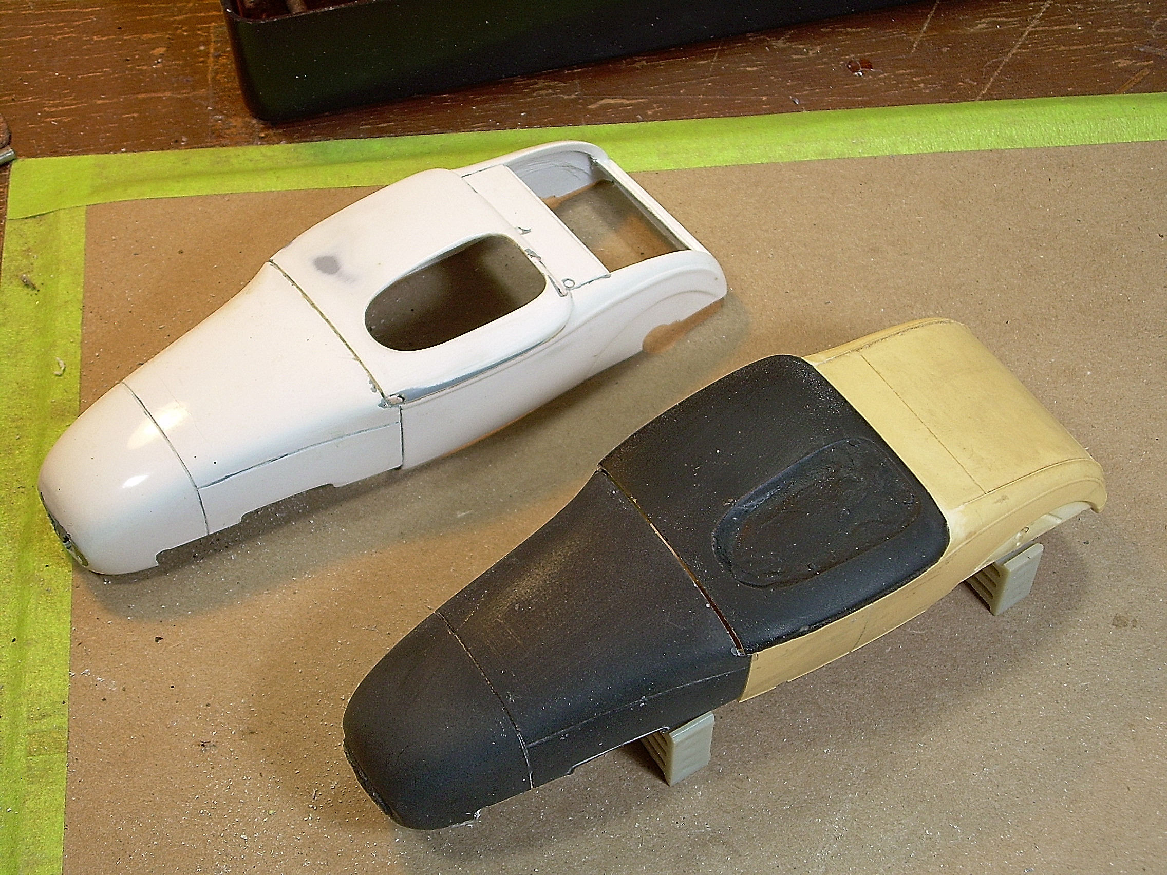

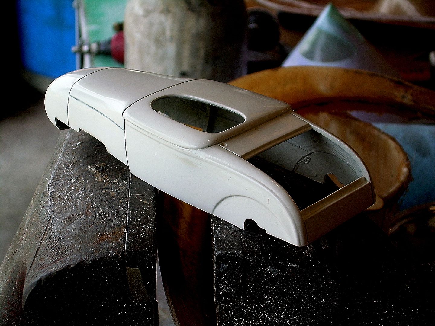

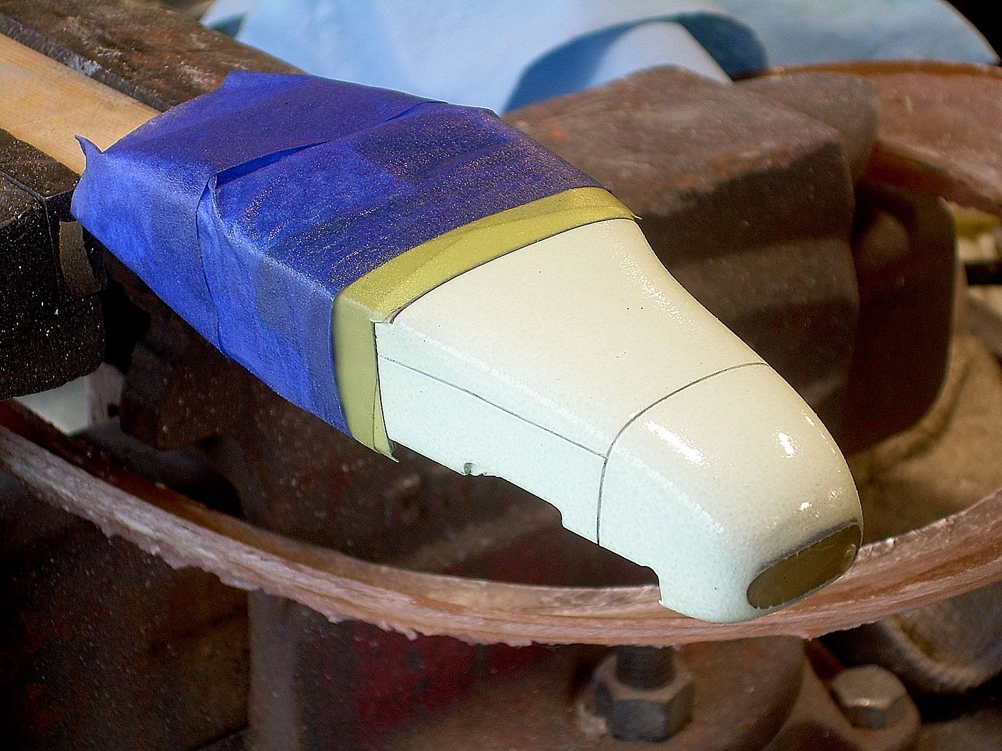

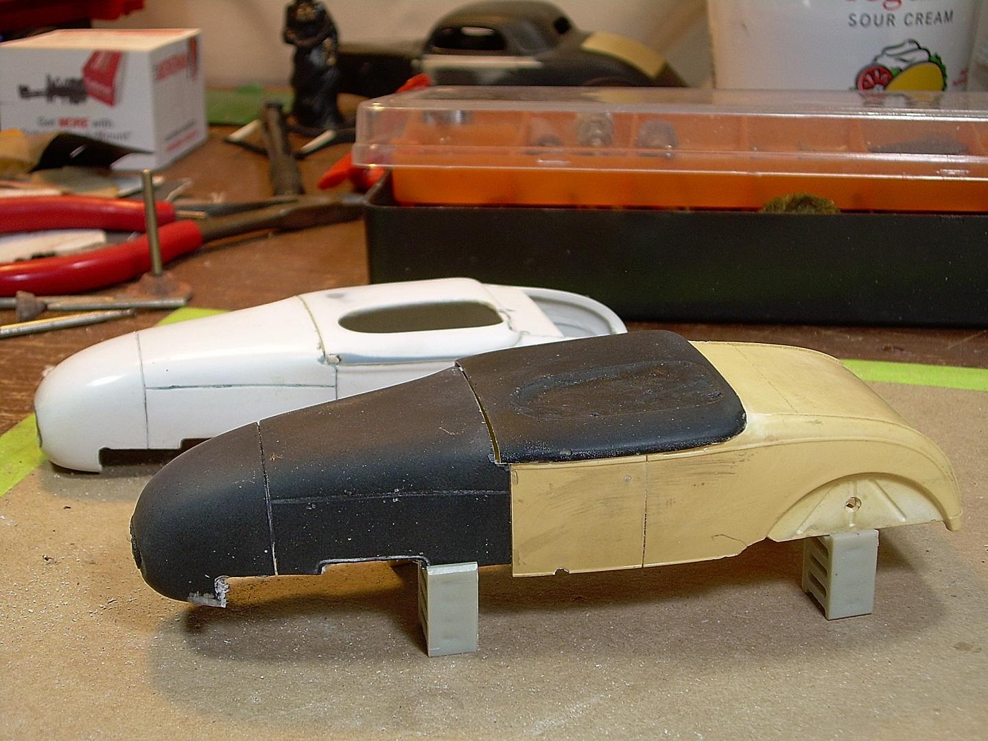

Ace-Garageguy Posted March 28, 2017 Author Posted March 28, 2017 Rattlecan Ace-Hardware white lacquer, sanded and polished...but not too glossy. Too much gloss at this point can make it a bugger to get the PVA mold-release to lie down slick. Masked for pulling molds for front sheetmetal, with a coat of PVA sprayed...

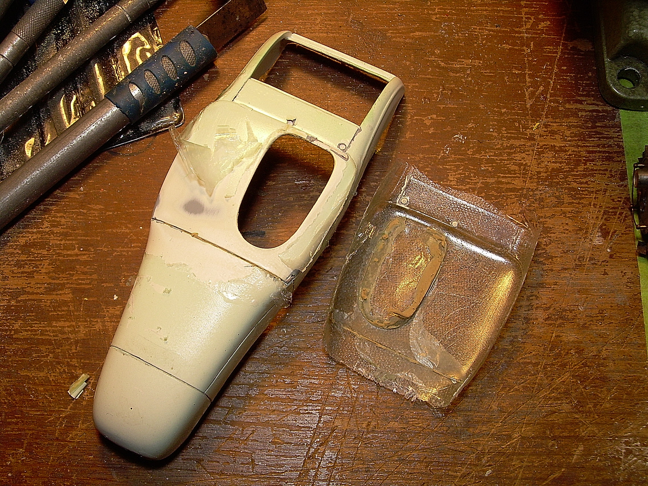

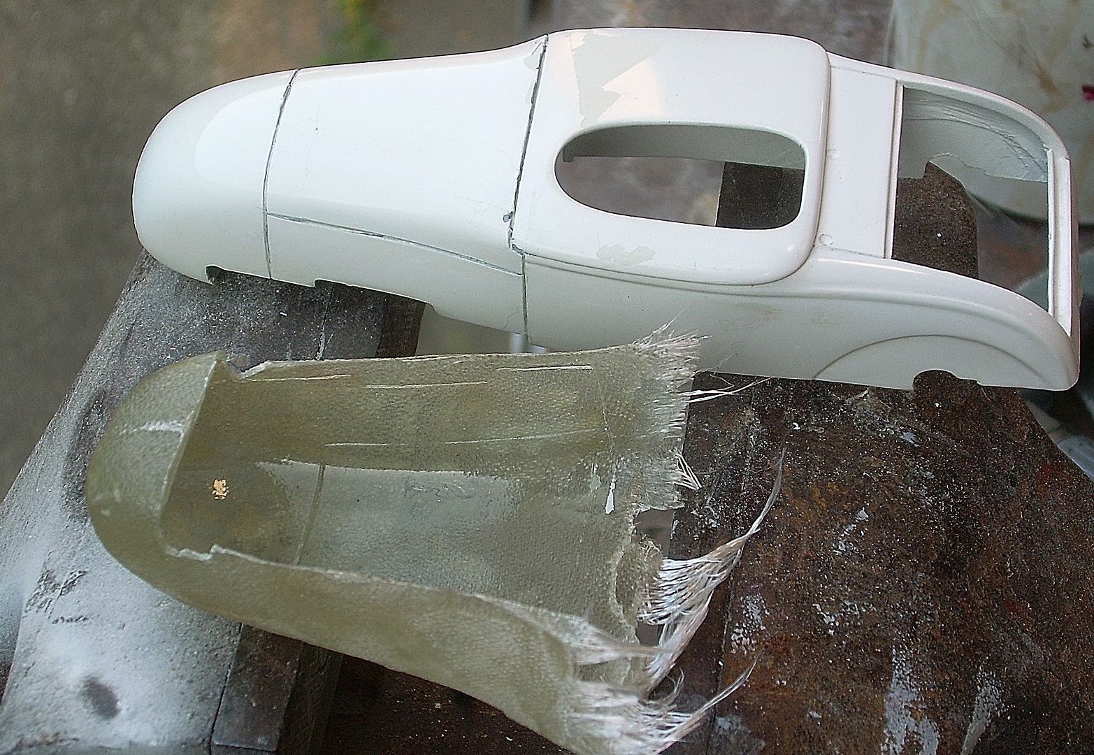

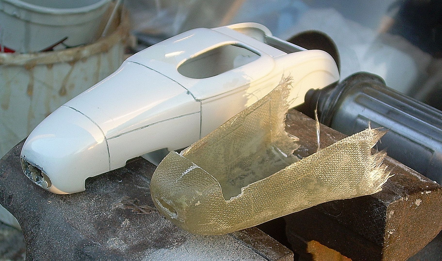

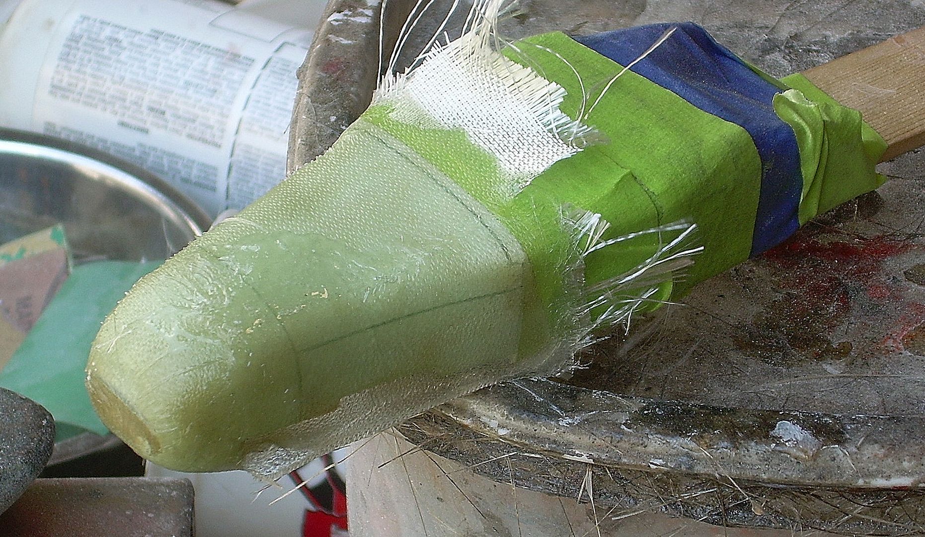

Ace-Garageguy Posted April 16, 2017 Author Posted April 16, 2017 All this time later, and I'm glad to see that progress is still being made. Me too. Loving this. Thanks for the interest, again. I laid up a mold of the entire nose and hood, using a high-strength epoxy and very fine cloth. Not my best work to date, but I was in the big-car shop and decided to use up some resin I'd mixed for a 1:1 project. Anyway, I rushed the work a little and didn't really think the draft-angles through very well, but she'll be OK. The release was a little dicey, but the mold did finally come off with minimal damage to the plug, and no damage to the mold. The next step is to prep the tonneau and pull a mold of it. After that, the plug can be set aside or discarded, though I'll probably use the nose of the plug as a final part of this particular model. Fiberglass copies of the hood and tonneau, as well as the bellypans and decklid, will finish her up.

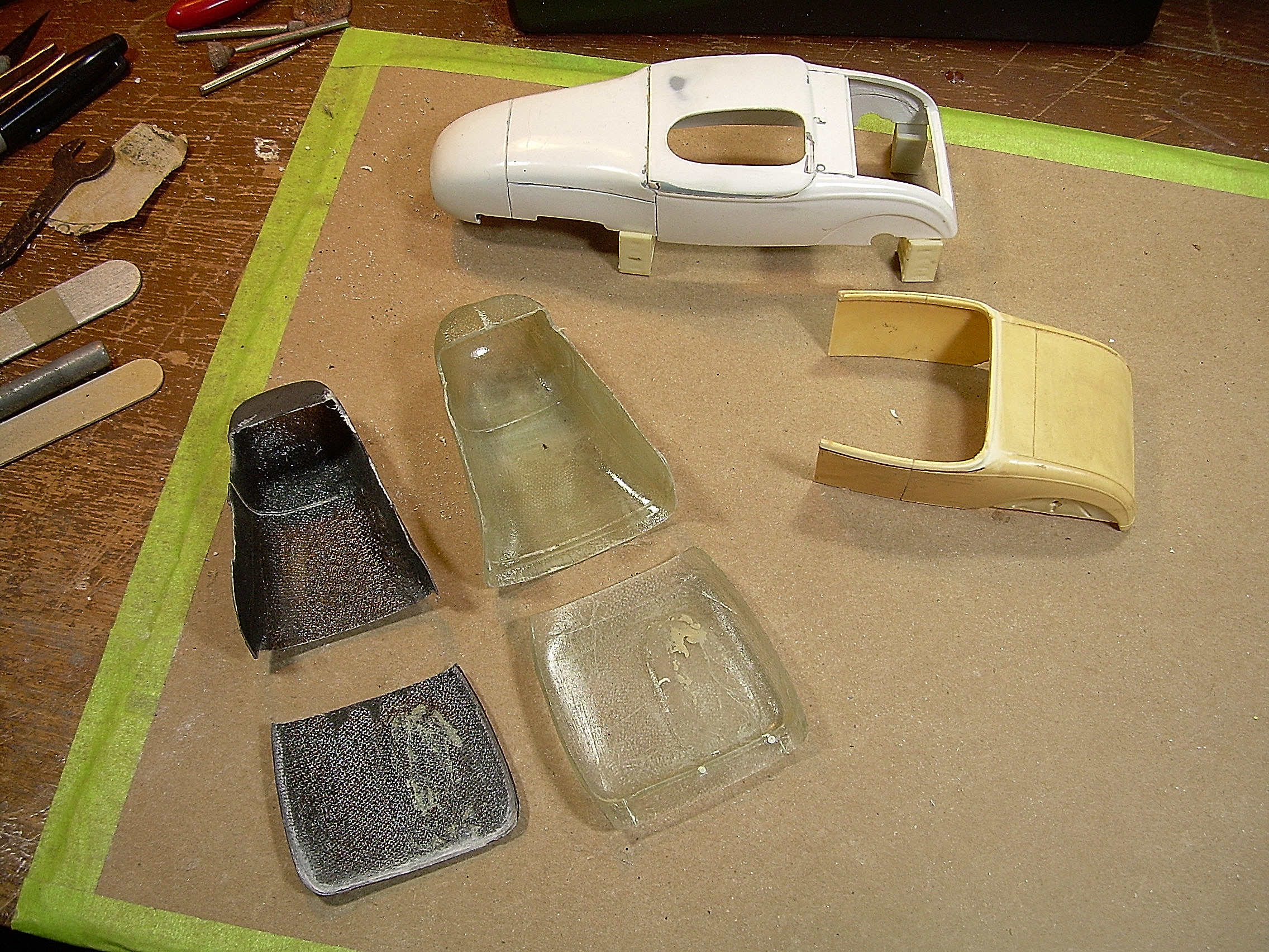

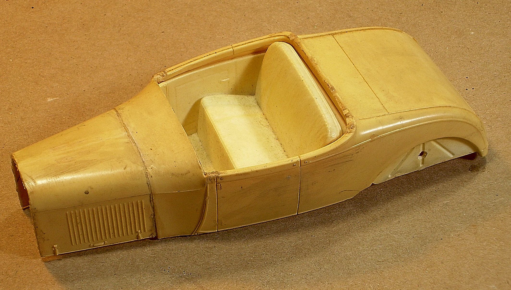

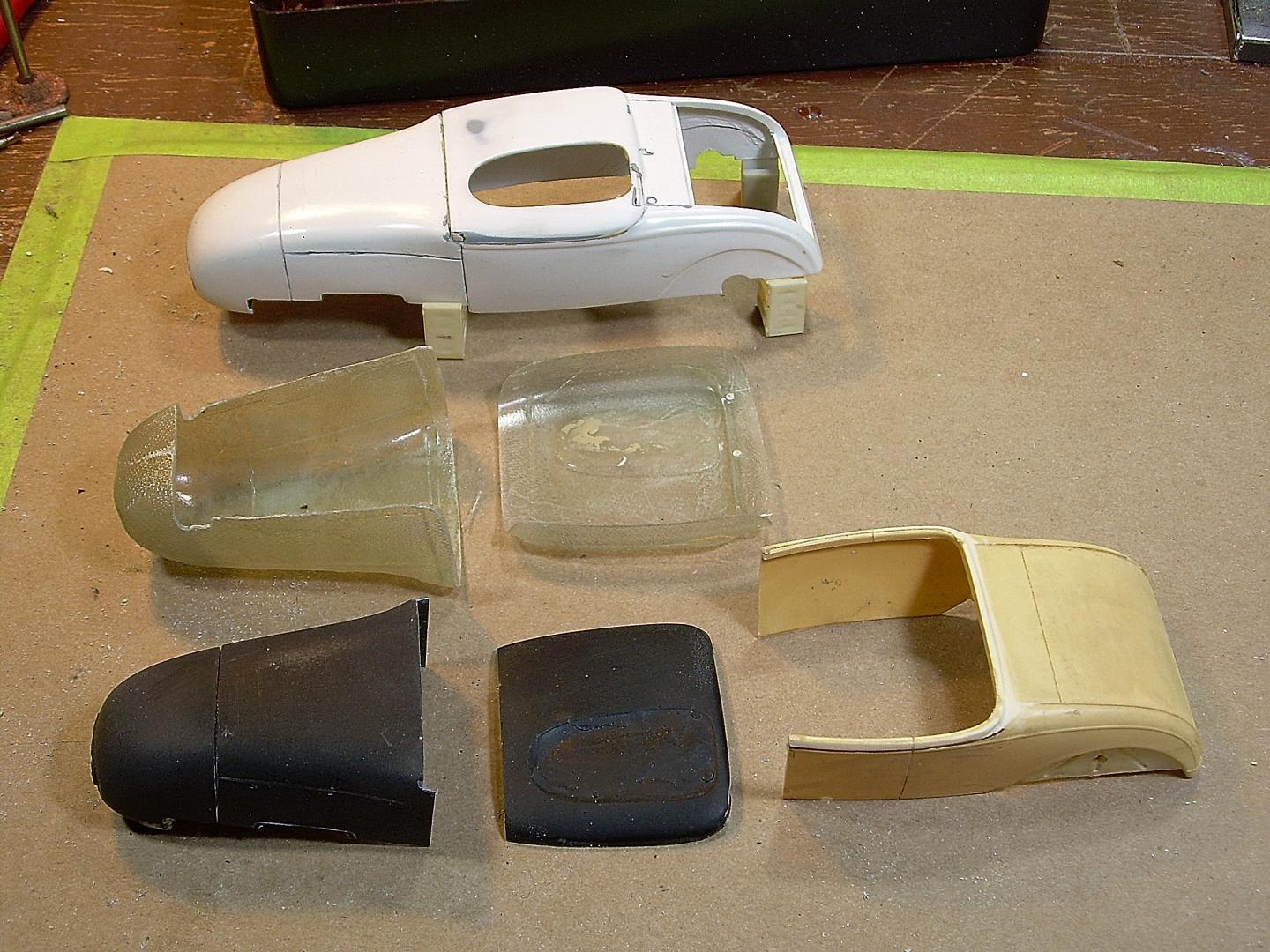

Ace-Garageguy Posted November 25, 2018 Author Posted November 25, 2018 Made the mold for the hard tonneau. The draft angles were not quite right on the plug and I got in a hurry. The result was minor damage to the plug, but the mold is fine. The body parts were designed and developed to go on a suitably modified AMT '29 Ford body shell. The junkyard yielded this candidate, needing some repairs as well...which is just fine. The hood is solidly glued to the cowl, so this thing is pretty much useless otherwise anyway. Here's the modified shell, and the first set of parts out of the molds. They have been cleaned of mold release, and shot with a coat of self-etching black primer to show up defects. This underside shot demonstrates how thin the molds and parts are. Entirely different from the usual "resin". Parts being fitted to the modified shell. Though everything needs a little more finessing, it all works and fits as intended.

Ace-Garageguy Posted November 26, 2018 Author Posted November 26, 2018 (edited) Thanks for the comments and interest. 16 hours ago, alan barton said: ...If it were mine, I would be building the original up as a curbside, just for a bit of instant gratification and to keep the juices flowing on the full detail version... Funny...I thought about that, and after your reminder, it will probably happen. There are some repairs that need to be done on the plug, but nothing overly dramatic. It would be nice to have it in one solid piece to try the paint scheme I'm thinking of too, and possibly make up some frisket masks. I'm also kinda thinking of doing a silicone mold of the whole thing, maybe making a few copies as curbsides that could be opened up by an enterprising builder. Edited November 26, 2018 by Ace-Garageguy

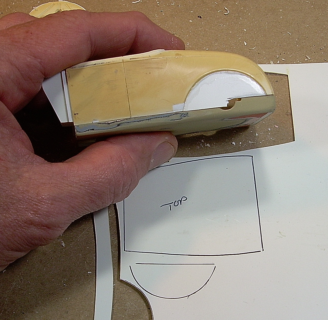

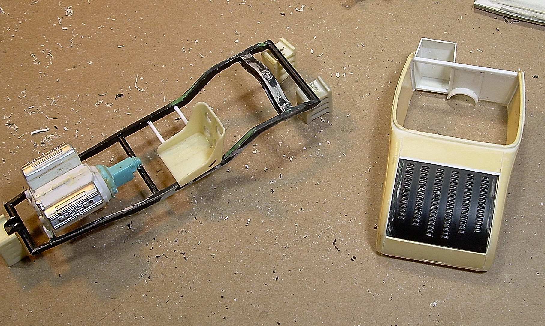

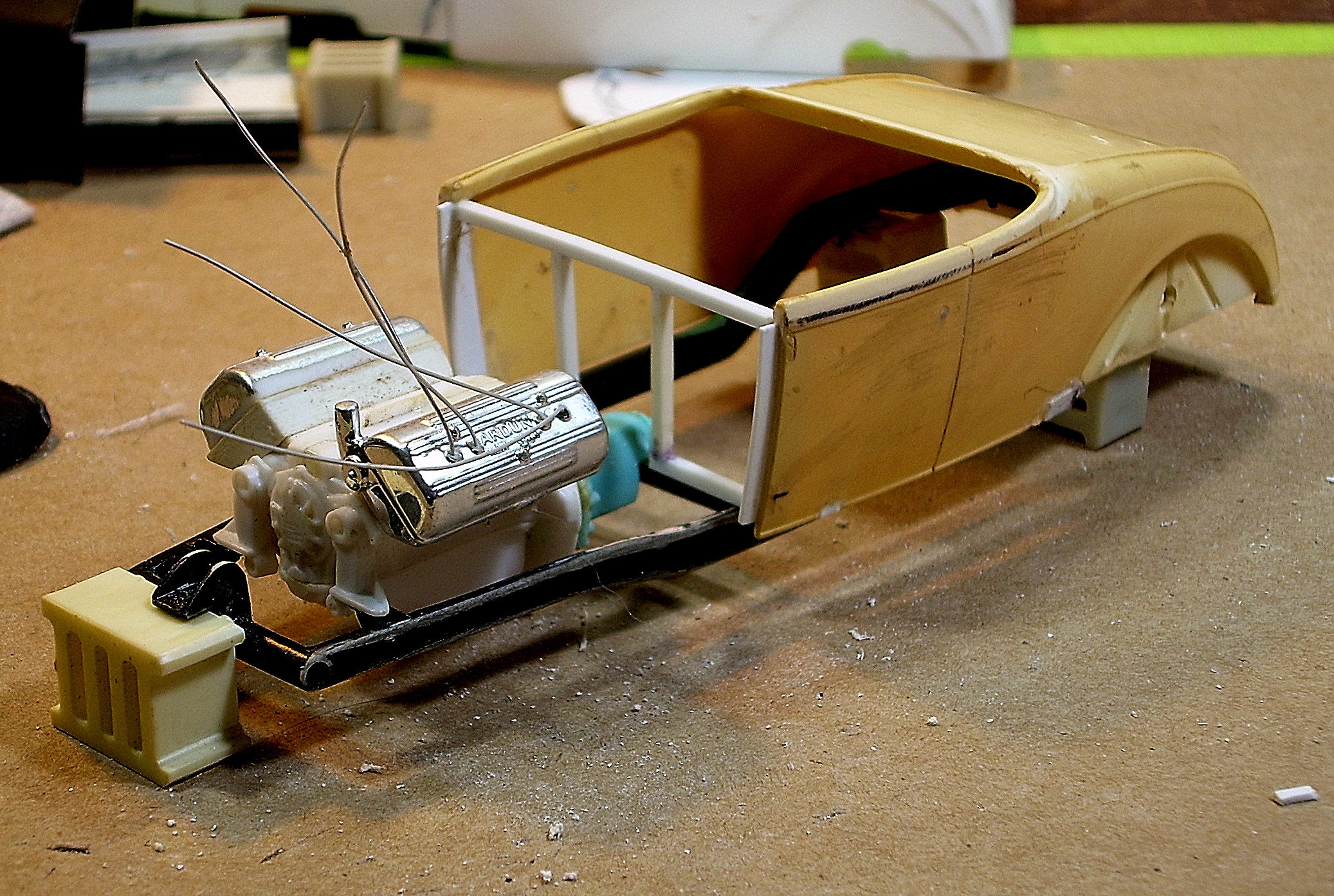

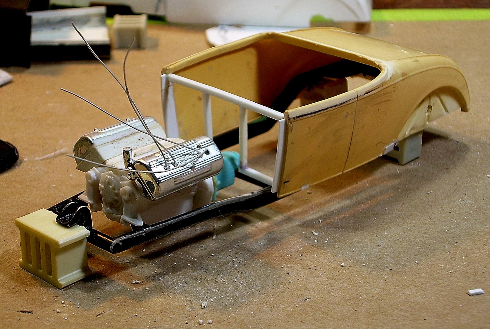

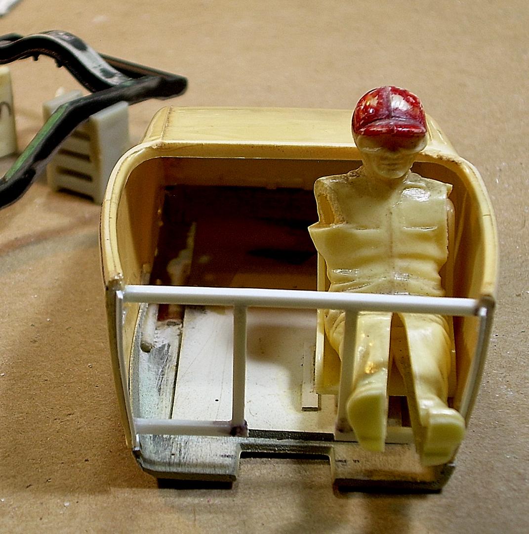

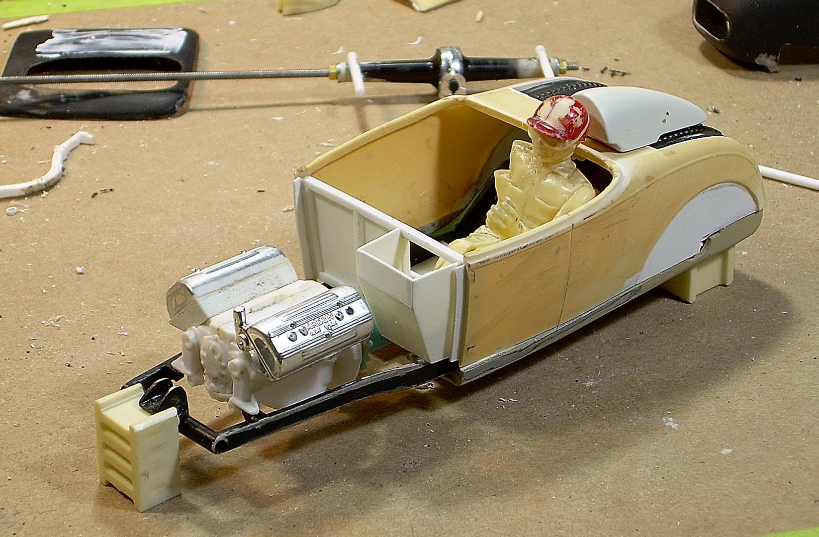

Ace-Garageguy Posted December 4, 2018 Author Posted December 4, 2018 (edited) I built some structure in the front of the new shell. It will form the front body mount, as well as support the firewall and footbox for the driver. The flanges on the body sides will positively locate the hood side panels. Lefty still has infinite patience when it comes to helping fit parts so a real driver could actually operate things. One of my goals with most models is to make them represent reality close enough so that they could be scaled up and built 1:1 pretty much as-is. That framework isn't actually wonky, by the way. It's an optical illusion. New seat supports on frame, firewall and footbox, and decklid fitted to new shell. Fabbed some new wheel opening fillers too, made to fit the previously built-up plug for the rear bellypan. The bellypan assembly had warped a little over time since I worked on it last, owing to the very slow evaporative drying of liquid "cement" trapped between layers of plastic. I also found that there is an inherent slight twist in these AMT '29 Ford body shells. Looking like it's supposed to (though the helmet fairing is shown too far to the rear; it's been corrected). The rear axle was mocked up previously with a spring and spacers to simulate hangers and shackles. Below, the axle is getting mount tubes for the shackles. The threaded rod and nuts hold the axle bells in correct alignment without glue, while I build the spring mounts. It all has to be taken apart again to be painted. The inboard ends of the axle bells have been thinned to better represent reality than the way-overly-thick usual kit parts. Below, the tubes the shackles bolt to have been trimmed to length, and spring "eyes" are being formed on the spring ends using styrene rod. One more shot for tonight: the spring eyes are done. Now they just have to be drilled, and the rest of the shackles made up and attached. Edited December 4, 2018 by Ace-Garageguy
