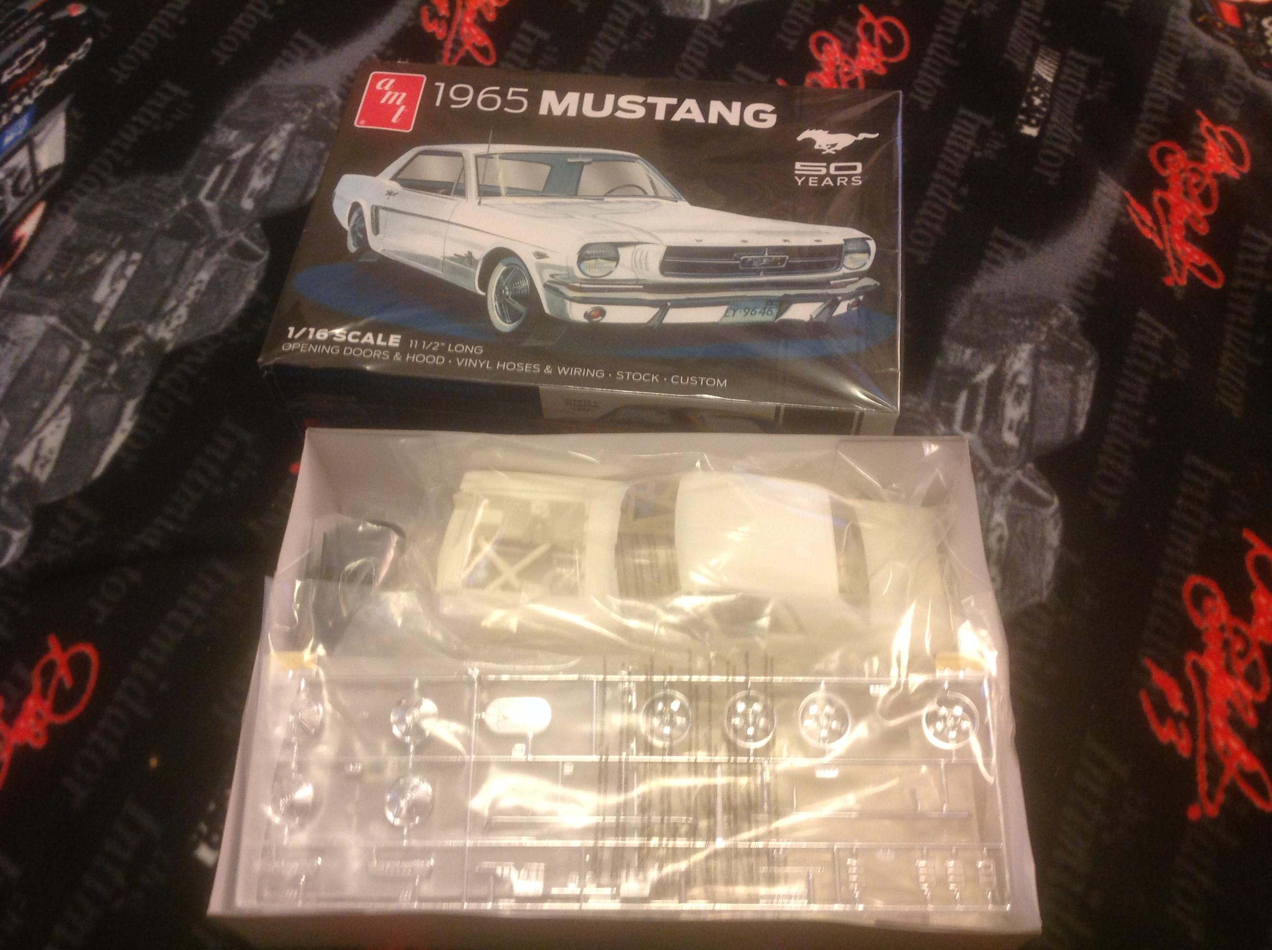

I'm happy to see the instructions for the "50 Years" 1965 Mustang kit above. ☝️ At least they give proper information on what colors to paint the engine. Not Ford Blue! Ford painting all their engines blue didn't start until the 1966 model year. Thanks for getting that one right Round 2.

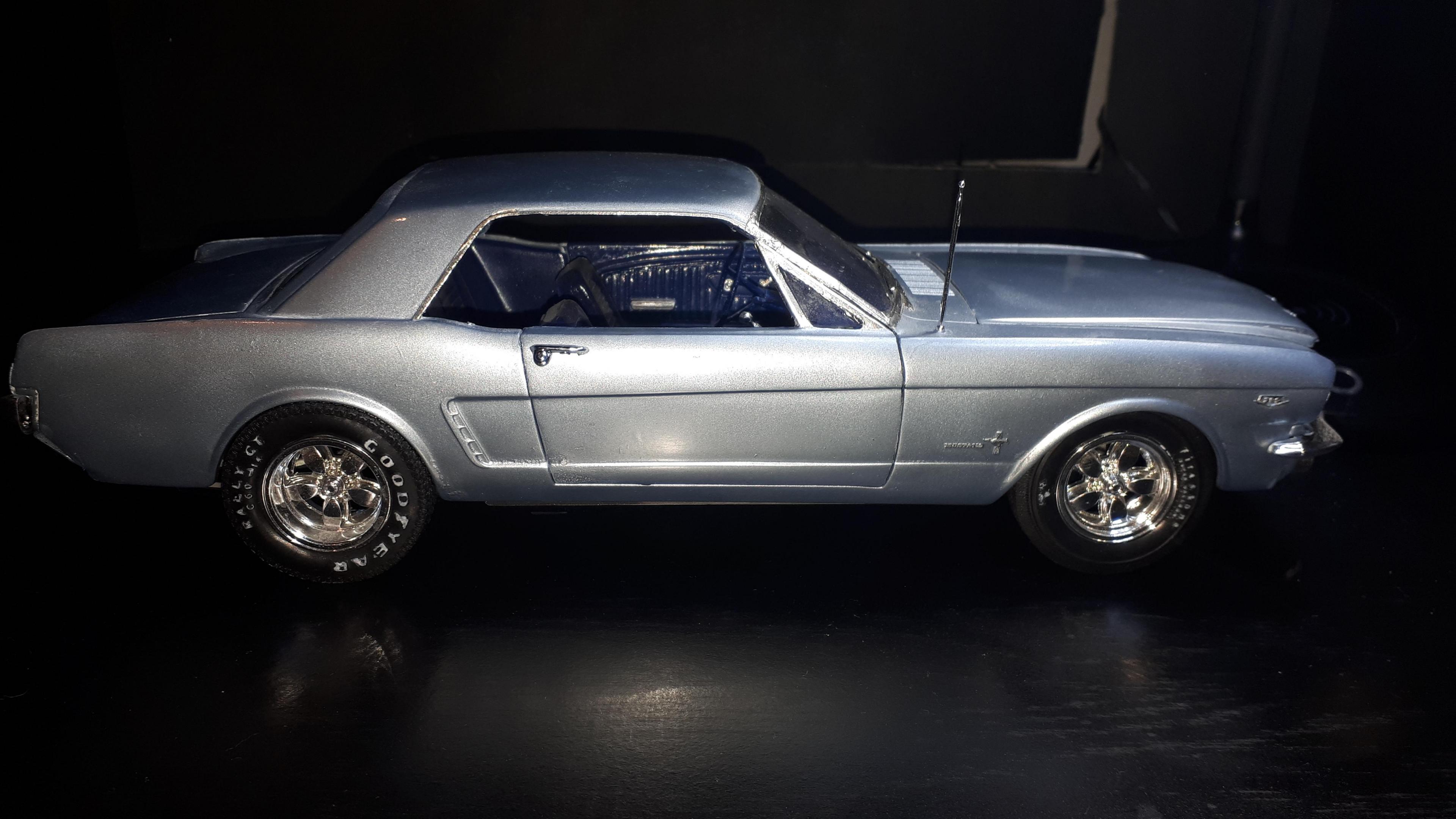

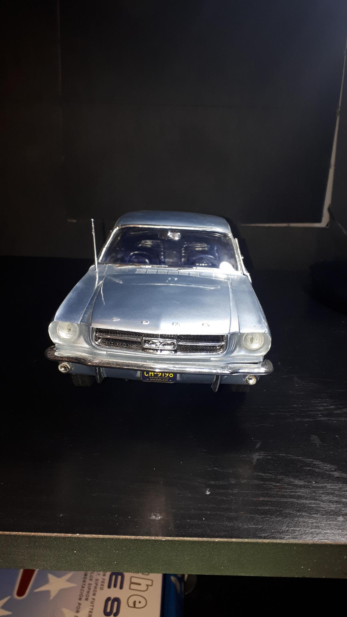

I had a very hard time with this model.  The rear bumper would not fit properly at all.  The interior tub/body once completed  would not fit properly on the chassis and the doors would not line up properly (I ended up gluing them in as I couldn’t get them to look right.
i painted it scalefinishes Ford silver blue metallic.
I’m sure the more experienced builders here would have had an easier time, but I found it a bit of a chore!

Don't beat yourself up too much. This kit is rather crude, starting with that way-too-leaned-back windshield. The entire kit suffers from that "73% there" feeling, with no details quite right, and simplified assemblies all over.
It's a total mystery how Lesney/AMT could have created such accurate American 200-S wheels, and almost completely failed on the balance of the kit. I would never recommend this kit to anyone, other than for the aforementioned wheels.

Despite your problems with the kit, it looks like it turned out pretty nice. ?

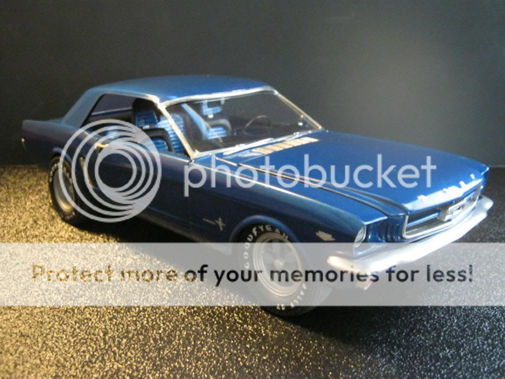

Here is my build of this one, the kit i bought was opened but not started and came with the resin teardrop hood. I want to redo all the trim in bare metal foil as I built this one before I learned how to use foil.
And it sure does have that windshield lean.
Again I’m impressed with above build. ☝️ Another one that looks pretty nice. Other the area around the windshield, I don’t think the kit looks to bad. Not great. But, not terrible either.
