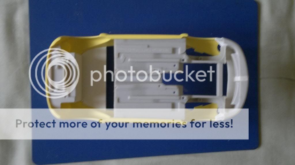

Lowlife ! ! Posted February 4, 2015 Author Posted February 4, 2015 (edited) Thanks guys, much appreciated, Slusher hadn't heard from you in a while, glad your still around ! Man this guy can spray paint.....And thanks Sonny, talking of chassis......... Bit more, at this point I thought id start on the chassis, the 350z had a nice engine with lots of chrome so thought id go with the 350 chassis, (and the engine) and maybe scratchbuild the running gear. The most important thing in my builds is stance, if its not right (usually on the floor, hence the Lowlife tag . .. ) then I rip it apart and redo it till its right. After removing the temporary floor, i found with these wheels it was going to need some major work so I tried the chassis fit, then trimmed a bit off, and another bit, till it was in 10 pieces !! I made the centre section fit, then had a couple of tries to do the front and rear....... More soon.... Edited February 4, 2015 by Lowlife ! !
