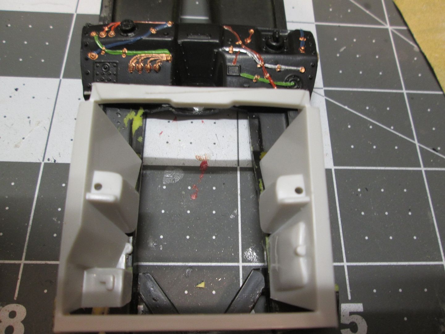

vamach1 Posted February 26, 2015 Share Posted February 26, 2015 You may want to "upgrade" under the hood with replacement inner fender and adding shock tower braces. Quote Link to comment Share on other sites More sharing options...

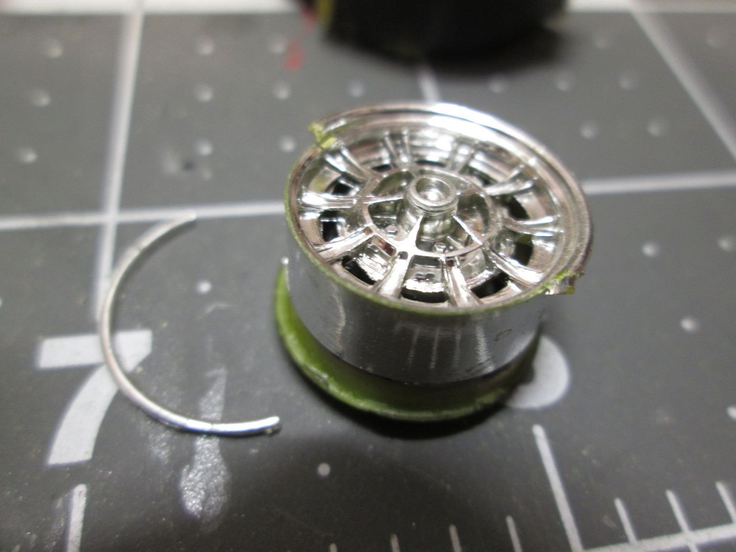

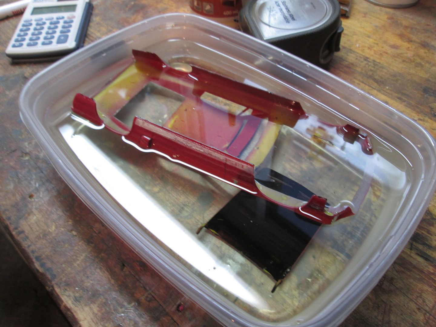

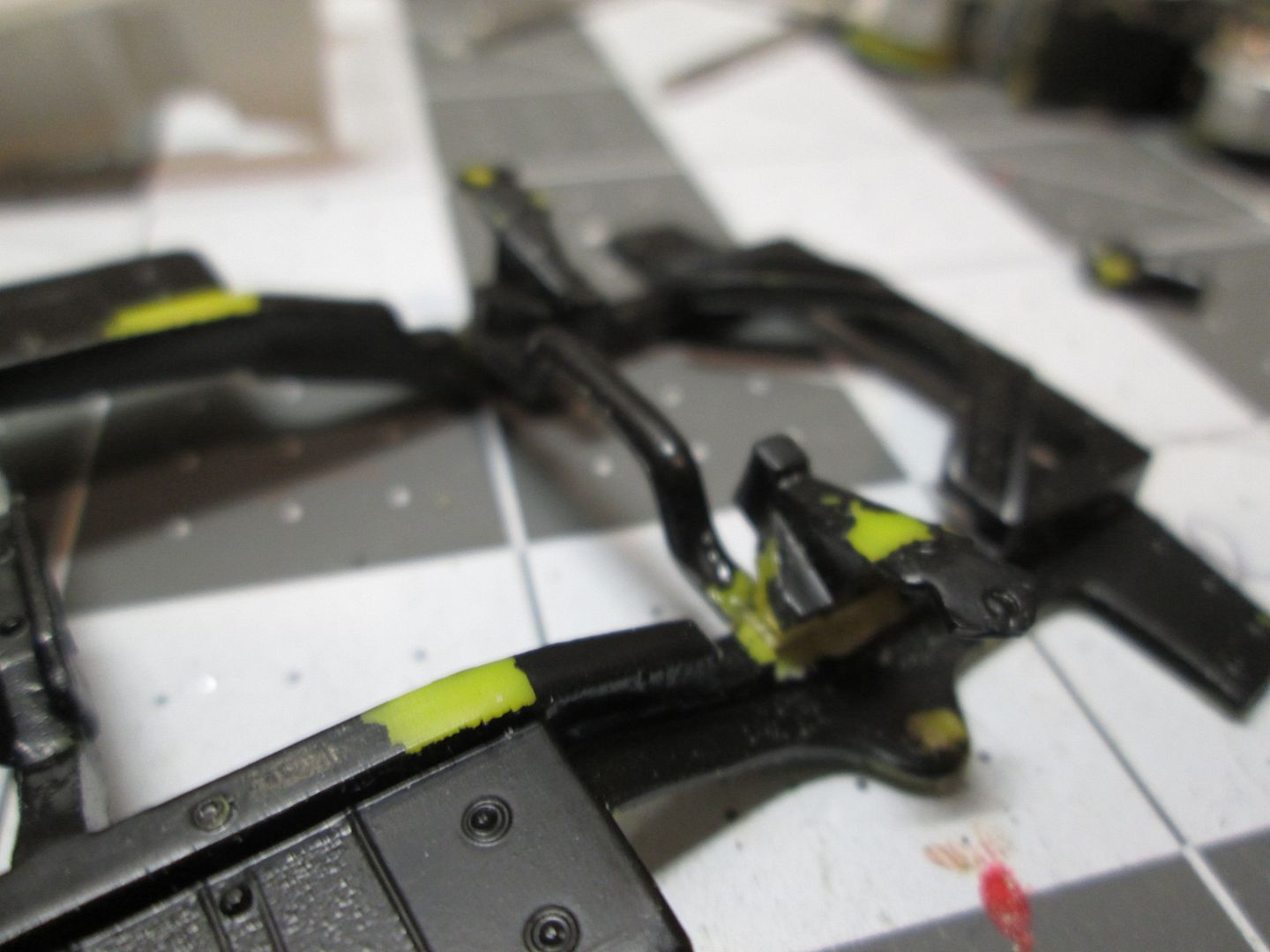

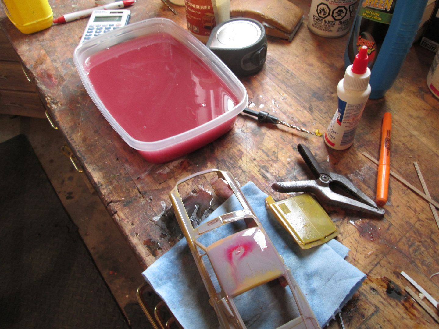

landman Posted September 7, 2015 Author Share Posted September 7, 2015 Body is in the brake fluid. Picked up on Rex's suggestion above Started repairing broken pieces, in this case the front suspension crossmember. Are there Shelby 10 spokes available on the aftermarket? Quote Link to comment Share on other sites More sharing options...

72 Charger Posted September 7, 2015 Share Posted September 7, 2015 Pm me Pat I may have some of those rims Quote Link to comment Share on other sites More sharing options...

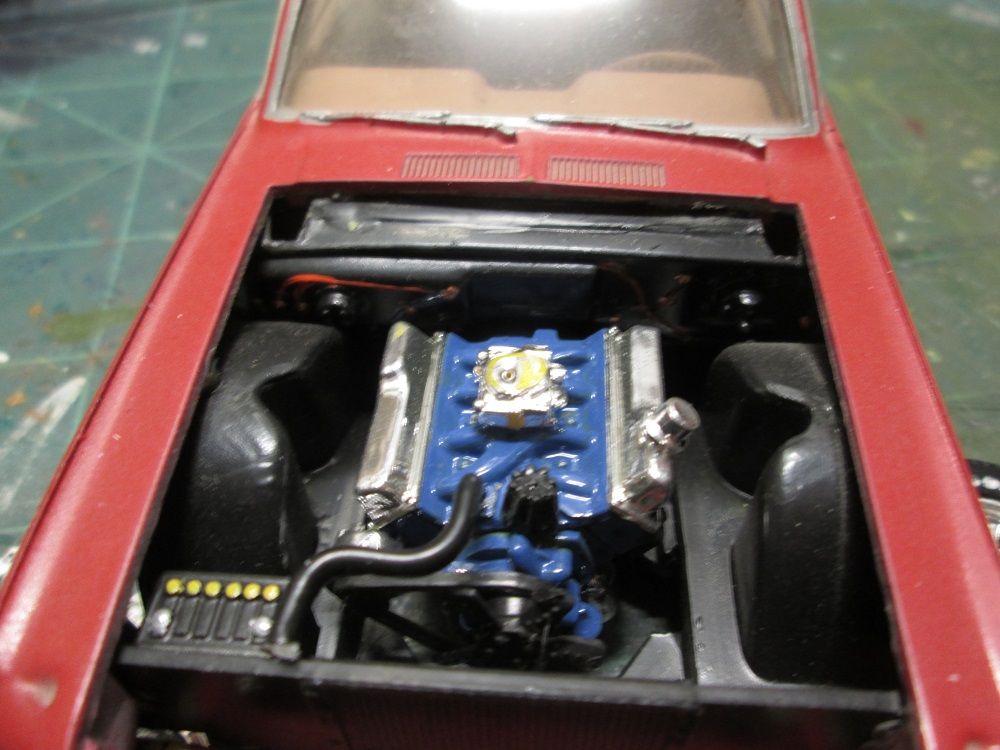

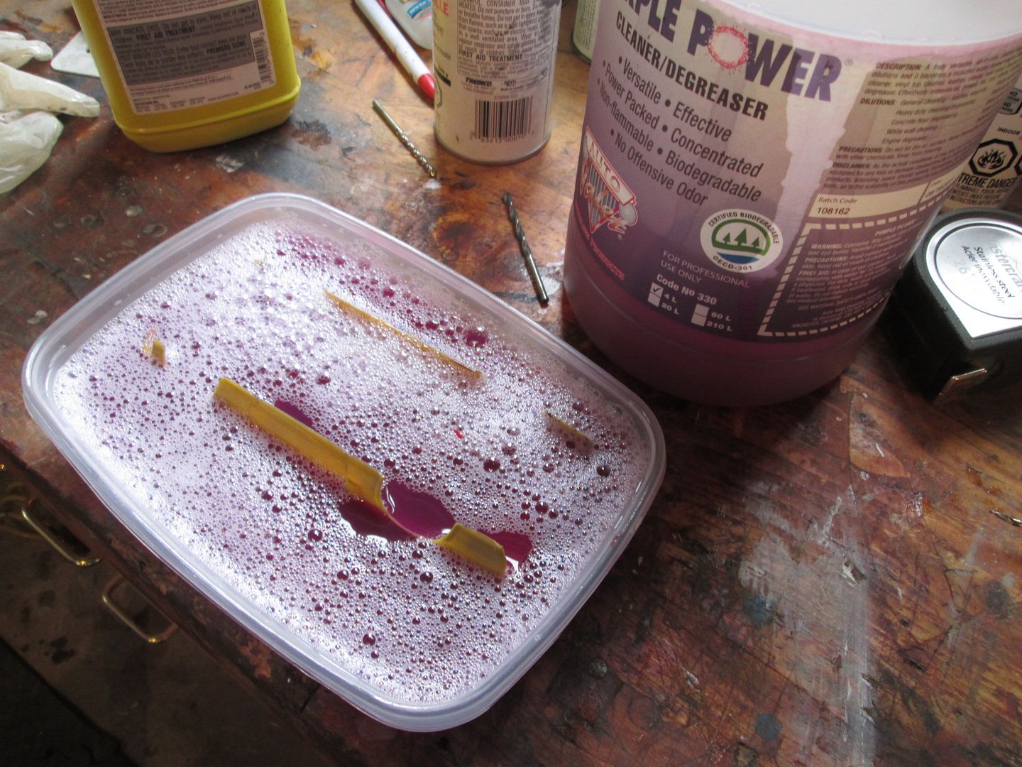

landman Posted September 7, 2015 Author Share Posted September 7, 2015 And the "depaint" process continues. Is that brake fluid shot or is it reuseable? Next step, the Purple stuff. Looks like the cross pieces have to go for the inner fenders to fall in the right place. Quote Link to comment Share on other sites More sharing options...
landman Posted September 7, 2015 Author Share Posted September 7, 2015 You may want to "upgrade" under the hood with replacement inner fender and adding shock tower braces. Rex, are the shock tower braces available on the aftermarket? Quote Link to comment Share on other sites More sharing options...
vamach1 Posted September 8, 2015 Share Posted September 8, 2015 I'm pretty sure I poached the braces from another Mustang kit. The fender were resin cast but bought a few decades ago. Quote Link to comment Share on other sites More sharing options...
kruleworld Posted September 8, 2015 Share Posted September 8, 2015 And the "depaint" process continues. Is that brake fluid shot or is it reuseable?You can reuse it, but you'll find it gets less and less able to strip paint. you can't use it for anything else, so you might as well try using it again. Quote Link to comment Share on other sites More sharing options...

om617 Posted September 8, 2015 Share Posted September 8, 2015 (edited) Nice project. I swear it look identical to mine built as a kid with the color and all,other then i used the soch engine. Missing Link offers engine compartment. Edited September 8, 2015 by om617 Quote Link to comment Share on other sites More sharing options...
landman Posted September 8, 2015 Author Share Posted September 8, 2015 Nice project. I swear it look identical to mine built as a kid with the color and all,other then i used the soch engine. Missing Link offers engine compartment. Thanks Tommy. Just ordered one. It'll be a lot simpler this way. Quote Link to comment Share on other sites More sharing options...
Travis T Posted September 8, 2015 Share Posted September 8, 2015 (edited) Certain reissues of the old AMT 66 Mustang have some nice correct 67-68 Shelby ten spoke wheels, better than the 68 Shelby kit came with anyway. I know the reissue with the dark blue Mustang with orange and yellow stripes on the box has them. The broken one in your picture has curved spokes making it right for a 66 Shelby. Edited September 8, 2015 by Travis T Quote Link to comment Share on other sites More sharing options...

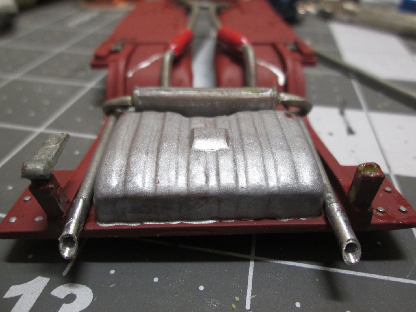

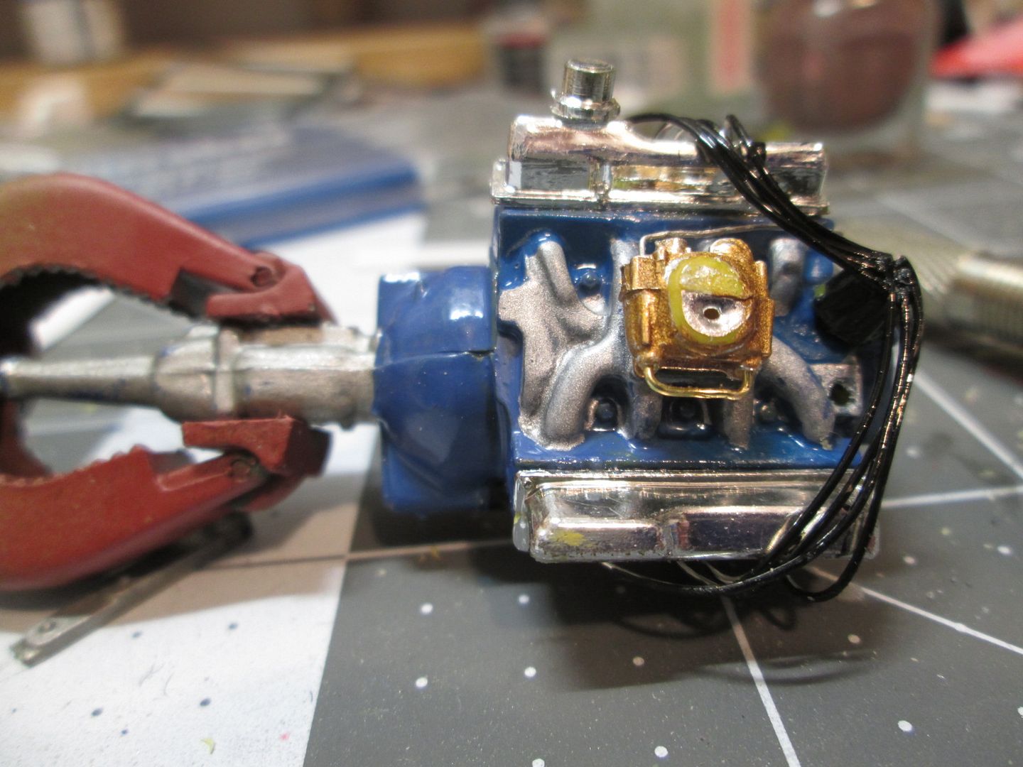

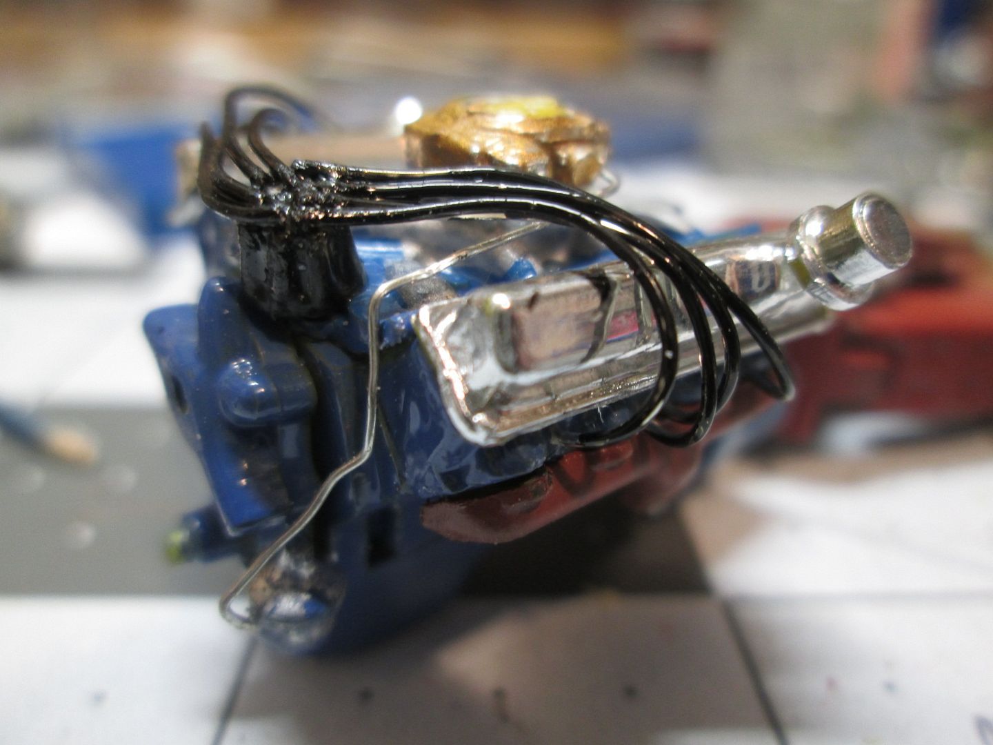

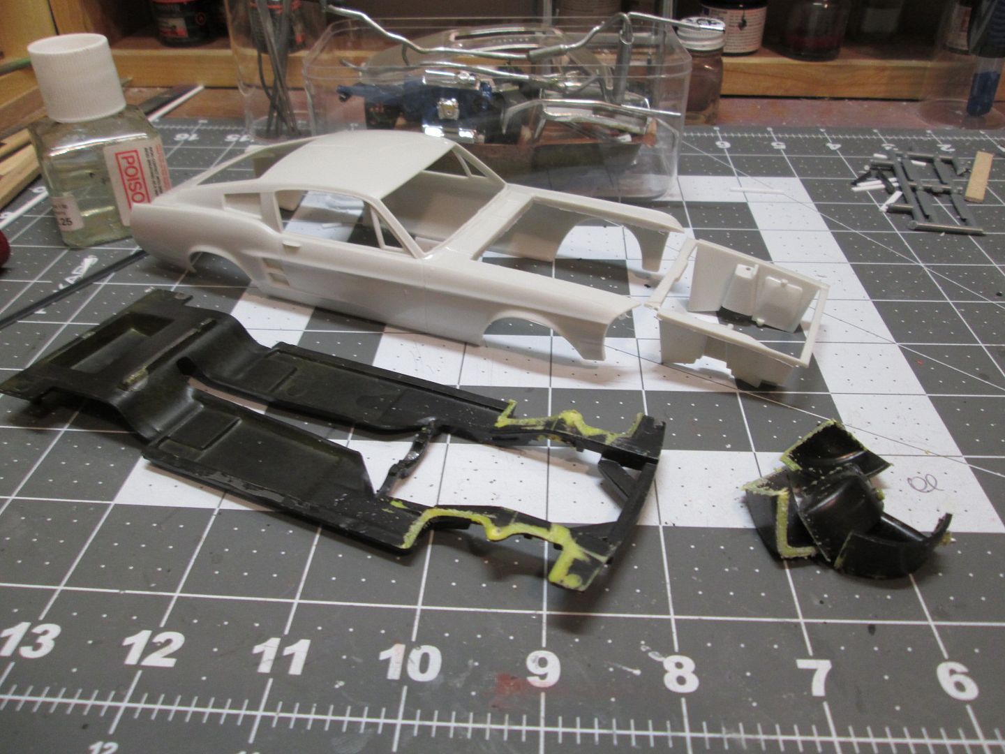

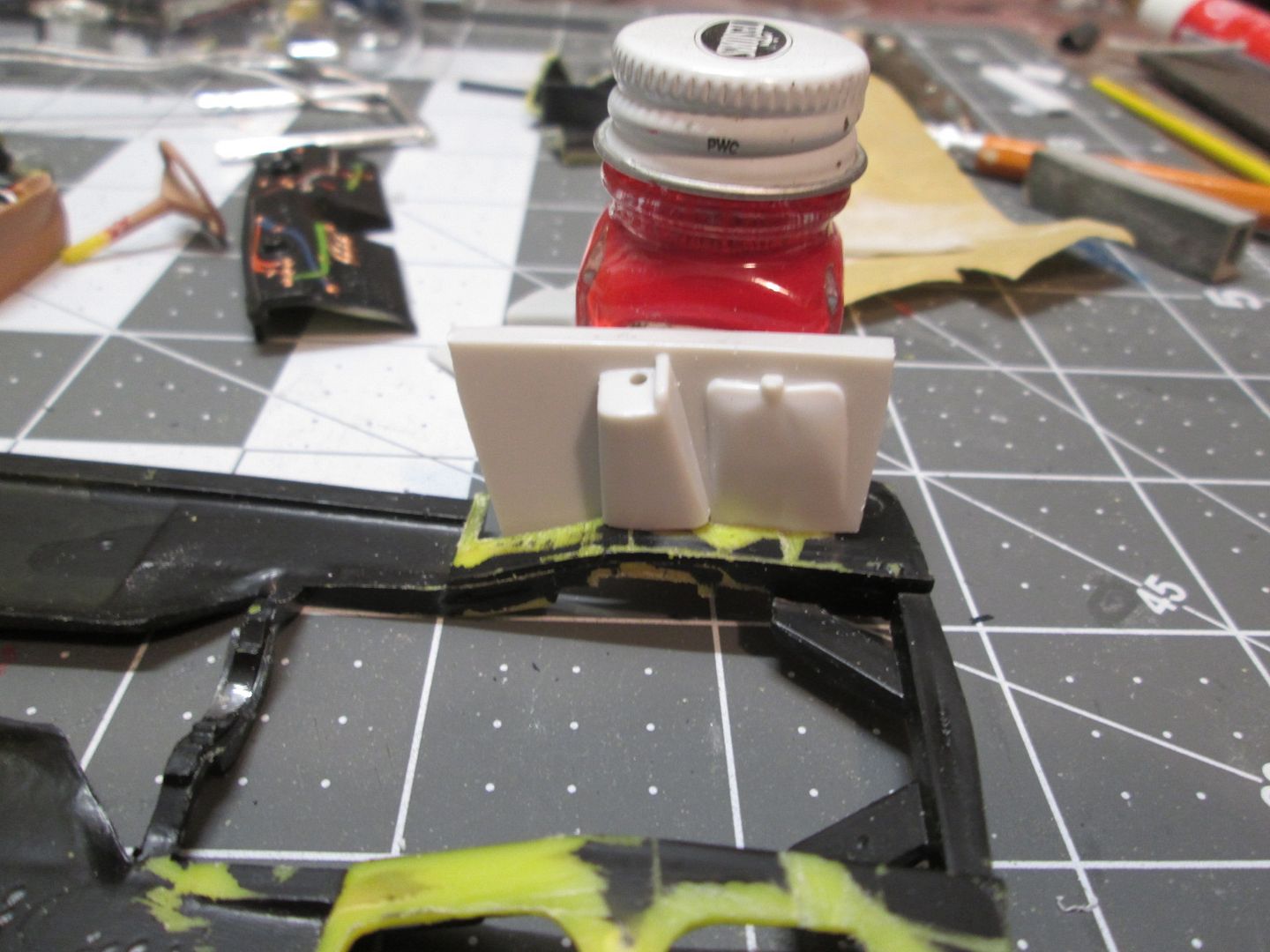

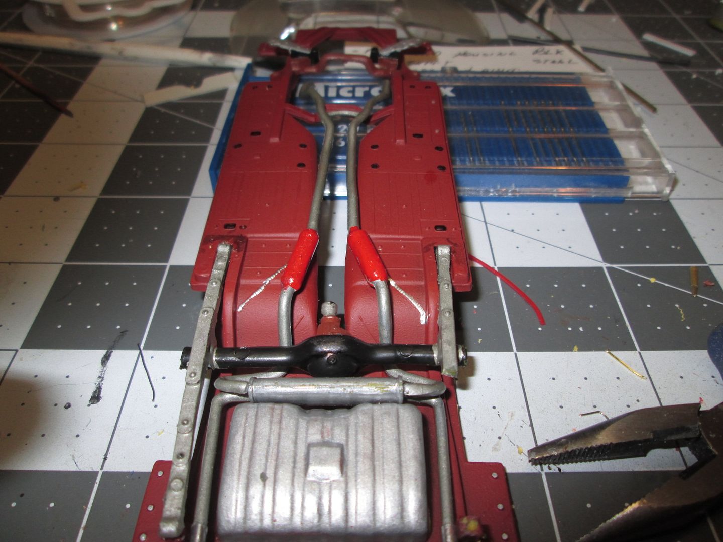

landman Posted September 12, 2015 Author Share Posted September 12, 2015 Beeg battle tonight. Started adding stuff to the floor pan and broke a spring. Broke the other one trying to fix it. Broke the exhaust trying to remove the rear end. I ended up removing everything, drilling & pinning the exhaust back together. I think I'll make a new main leaf and splice it in. After a while I gave up and installed the fuel lines , spark plug wires and exhaust manifolds on the engine. Quote Link to comment Share on other sites More sharing options...
Sledsel Posted September 12, 2015 Share Posted September 12, 2015 Cool.... Dated kit but builds to a nice looking kit.Do a lot of trial fitting. The interior tub does not sit in the frame flat. The issue can be sanded out pretty easily. I trimmed off the flat piece on the top of the floor (above the rear end) and sanded the interior corners to sit the tub into the floor pan more. I believe I sanded the top side of the trans cross member also. Made a big difference This will help keep the body from sitting crooked and the floor hanging down to low below the rocker. Quote Link to comment Share on other sites More sharing options...
