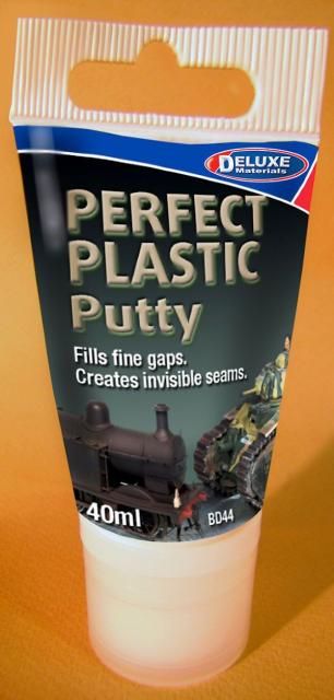

My new favorite putty is Perfect Plastic Putty by Deluxe Materials. It is a very fine grained white putty which is unique in that it is NOT solvent based! What does that mean - no damage to surrounding plastic, loss of fine details, no noxious odors, and it dries quickly. It sands like a dream! A great feature is that because it it water soluble, as it sets up, you can smooth it with a finger dipped in water. There are some great video reviews on Youtube. Google Perfect Plastic Putty and you will find nothing but positive reviews. I have no interest in this product or company other than being a happy customer. A 40 ml tube costs $7-8.00. Any hobby shop that deals with distributor Horizon Hobby can get it for you.
Check it out!
David
