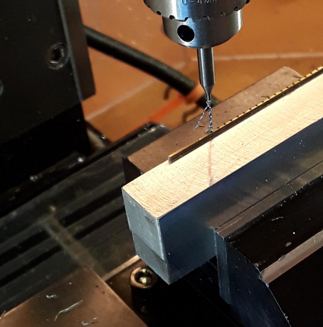

I'll second Chris with McMaster Carr.  If you want really good bits look up circuit board drill bits. https://www.mcmaster.com/#circuit-board-drill-bits/=1bilazv  They are much more expensive but they are carbide bits and are much better quality.  They stay sharp longer but will snap easier if you get a little off center.  I use them for making little bitty holes in little bitty parts. That piece of brass in .020" wide!

Buy the way, the ones I get from McMaster are made by Kyocera.  Super quality. They also all have a 1/8" shank, which also makes them work on a Dremel or regular chuck even at very small sizes.

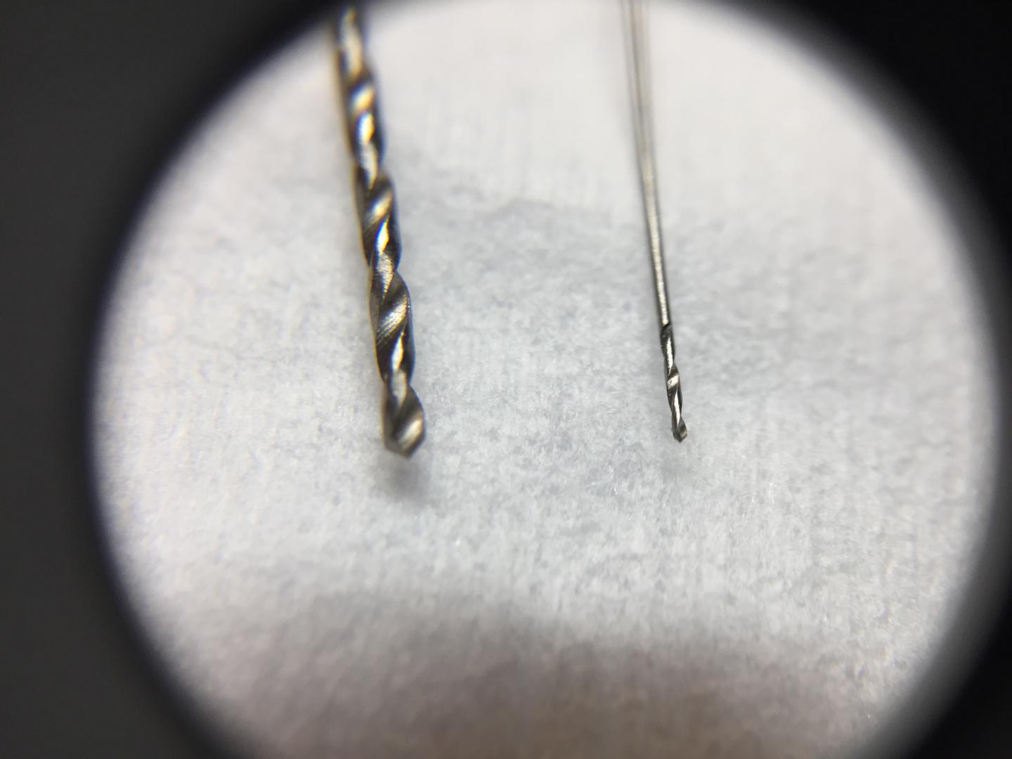

I found a good set from my local tooling supplier. The one on the left is a #61 (0.039") and the one on the right is a #80 (0.0135") Wow that's tiny! I took this pic with my I-phone held up to a 25X loupe.

And that is the reason to pay a little more for these.  The cheap versions are lucky if the end it flat, much less has a real and proper taper.  Quality control costs money!

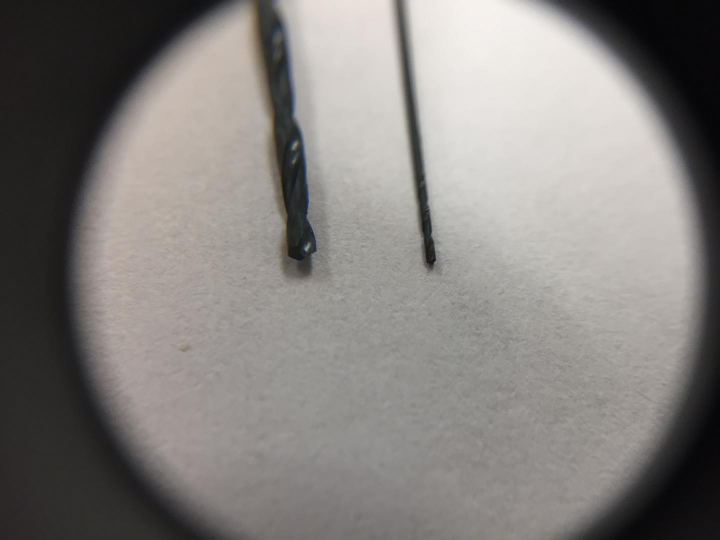

Here is the other set which I was forced to buy as an up-sell, since the local R/C dealer would not refund or credit me for the absolutely useless Zona ones they originally sold me! They are useable?, but nowhere near the quality of the Morse ones.
