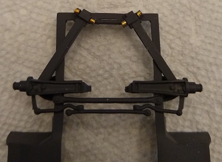

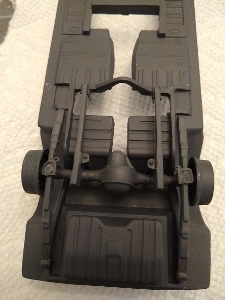

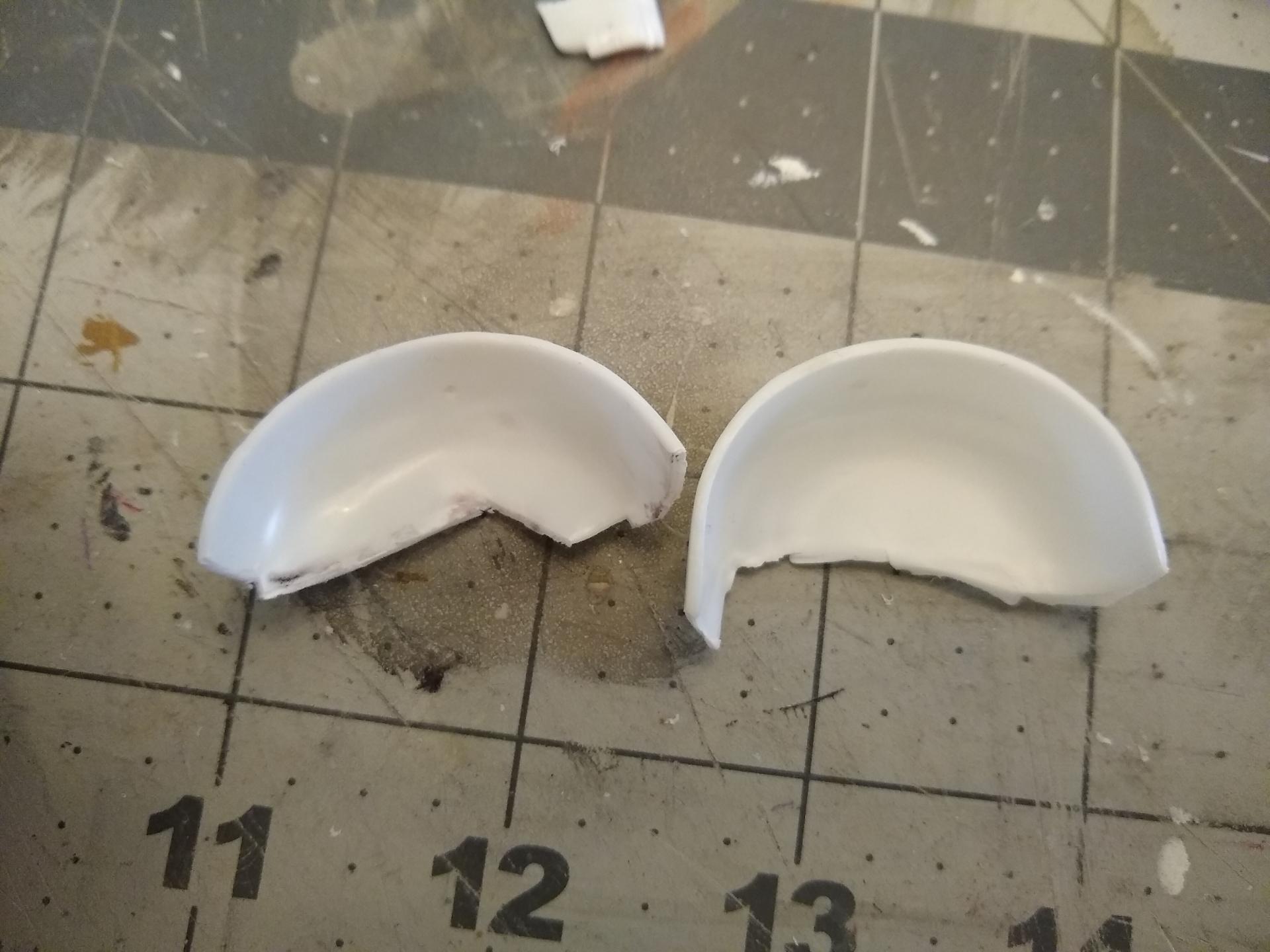

Got some work done on the Mustang. I sorted out the rear wheel wells which I had to pull from the parts bin.
Here I'm mocking up the front and rear suspension. You will note that the I added an axle mounting plate with the old shock locations but no shock installed. The actual shock location is on the traction bars per the 1:1.
I used brackets from Dirt Modeler for to attach the front of the traction bars, and fabricated some shackles for the rear springs.
The front suspension shows my take on the torsion spring setup. Its not exactly like the 1:1, but I feel its close enough. The brass pieces are ferrules, which I won't glue into place until the chassis is painted so they can keep their color.

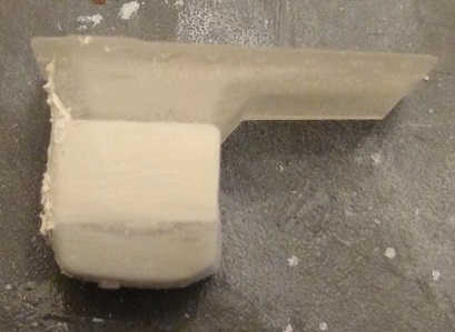

I'm also starting on the engine. Here I show the oil pan being deepened. I just used a piece of plastic I found that was about the right size and grafted it into place.
Thanks for looking, and commenting.
