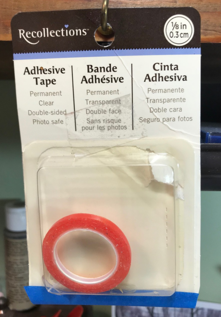

First, if you are building resin bodies,  a lot of them need clean up where the windshield will mount.  Some bodies are too thick and will require thinning so the glass doesn't appear to be in a deep hole.  Others need the mounting surfaces sanded to flatten them out.  Check yours before you paint the body!
I agree with others on types of plastic to use.
I will add one more tip.  As you are trying to get the flat windshield to hold in place, this tape helps!  It's two sided tape for scrap book folks. It's clear. I bought it in Hobby Lobby or Michaels.
You can use it all the way around and it sticks very well.  I don't see any failure on cars I did with this a few years ago.  And / Or...  use it to hold the windshield in place and use the canopy cement or appoxy as you would normally around the edges.
