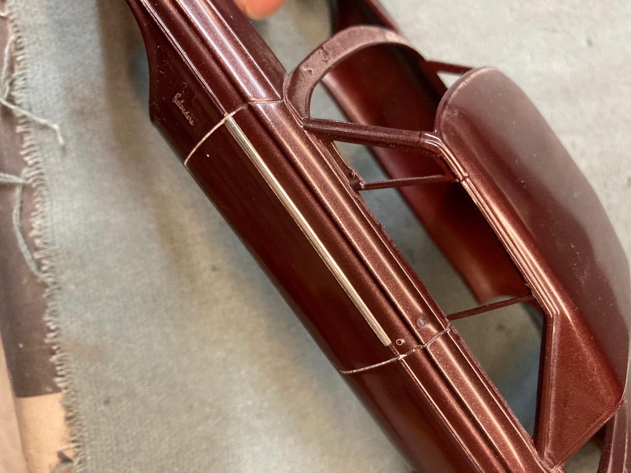

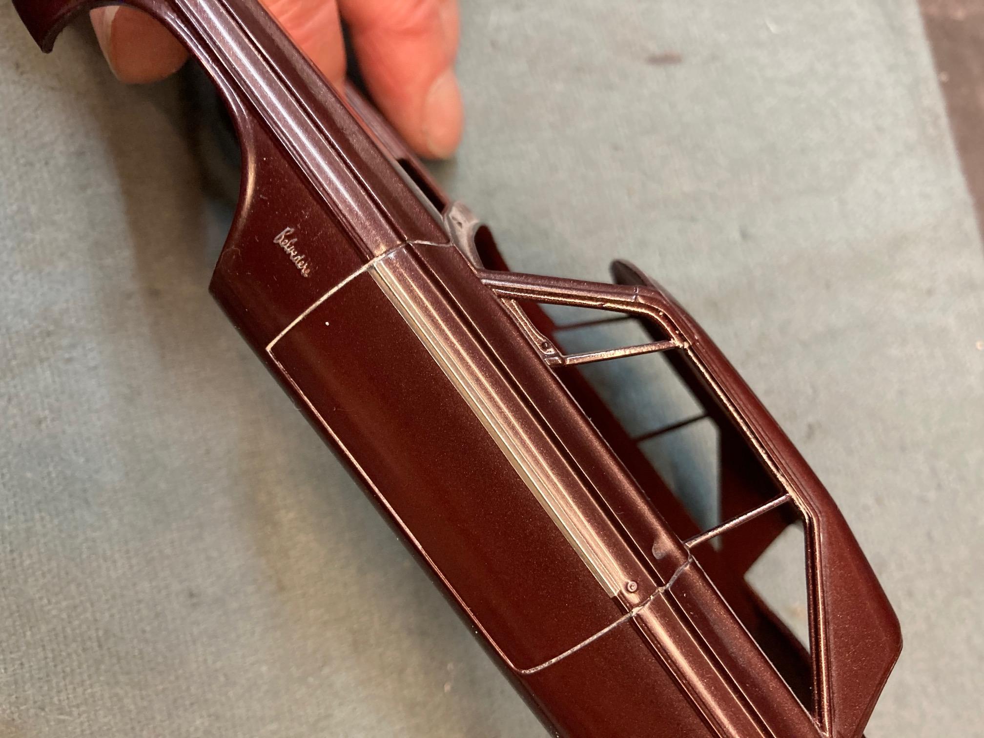

Well, my curiosity got the better of me, so I thought that I would give the new foil that I got very recently a trial run.
In all honesty, it doesn't appear to me to be as bad as some of the reviews that I've been reading.
I cut a quick piece and threw it on a spare body, and this is my assessment.
It seems to be somewhat thicker, requiring a little more pressure to cut, but it seems to lift off of the backing pretty much identically as the original.
It seems to apply pretty much the same, and burnishes down just as well.
I cut this freehand, so the cut edges appear a little more ragged than they would normally be with the painters tape method that I usually employ, but the excess lifted off pretty much the same as the original stuff would as well.
It shined up just as good and appears that it lays down in an acceptable fashion also.
I then pulled the piece back off to check adhesion, and it appears that it passes in this regard as well.
I could detect no difference in how well it was sticking.
So, in conclusion, in my estimation, other than the difference in thickness, I can't see any reason to discontinue using it on my projects.
Time will tell if there are other hurdles to working with it on an entire project, but I'm encouraged after this initial test.
Steve
