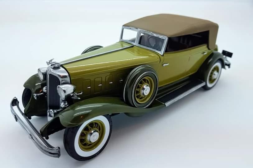

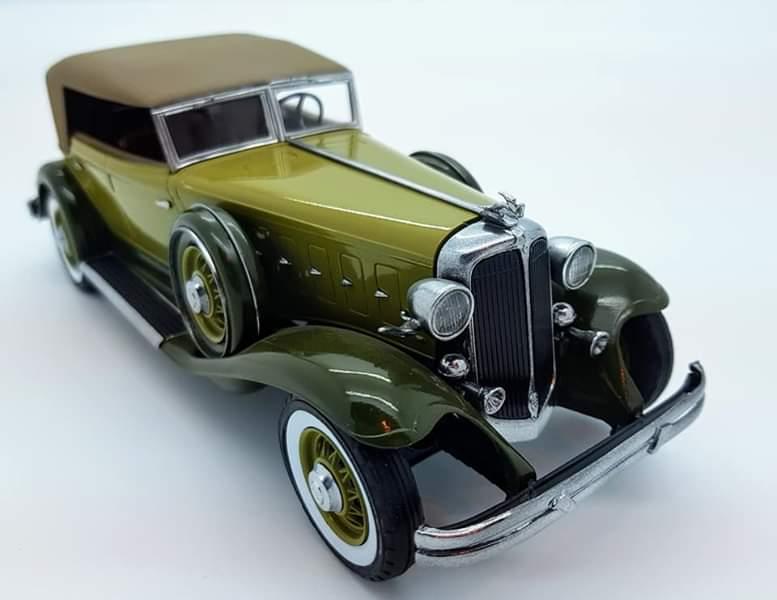

Agreed that either Molotow or Alclad really don't like being handled, and since the early 1990's I've been using Bare Metal foil, although a few years I built the MPC/Airfix 32 Chrysler, the chrome was shot, so got stripped and everything was redone using Alclad, it's been sitting in the display cabinet and still looks as good as it did the day it was built.
Wow!  Excellent work Geoff!

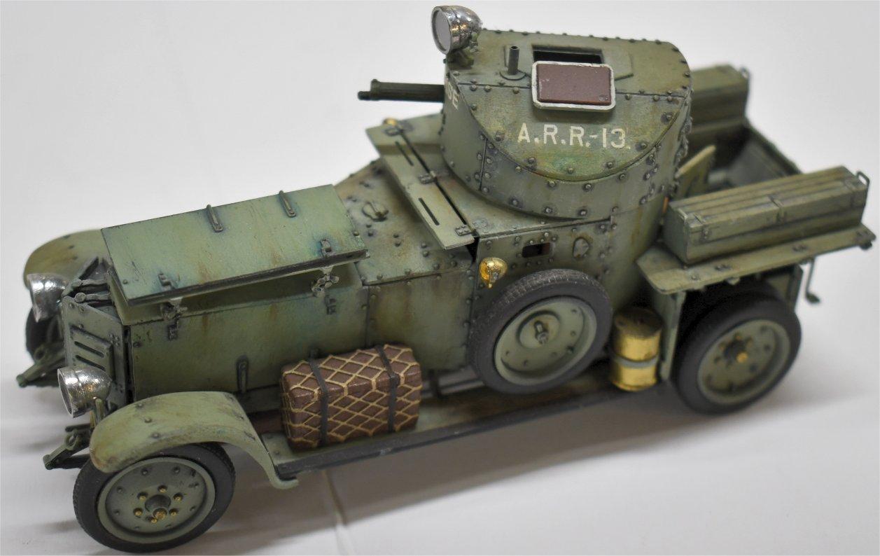

The headlights and searchlight on this 1/35 scale Rolls were painted with Alclad Chrome about 10 years ago. The fuel can and side-lights were painted with Alclad Polished Brass.  The photo is recent, from just a few days ago.
The chrome parts were base-coated with Tamiya Gloss Black acrylic, then sprayed with Alclad and polished with a soft cloth. I think the brass parts were hand-painted (even though Alclad tells us not to do that).  Anyway, they're still nice and shiny!

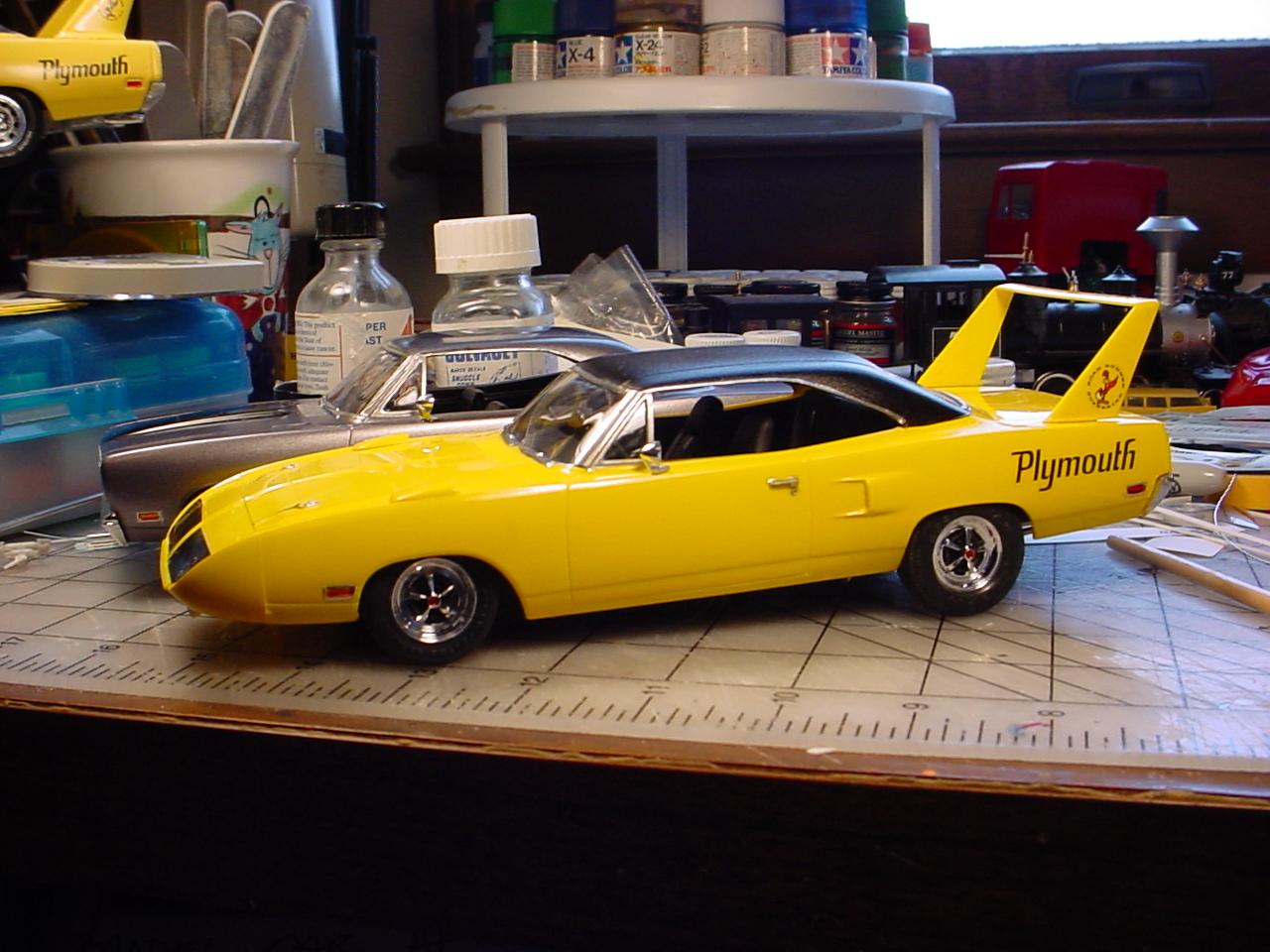

I've been using Molotow spray cans on the past few builds. I apply body color, then on the Superbird the rook color. I then masked off the chrome trim and spray it. LOTS of masking but I liked the results and foiling has become difficult for me......
