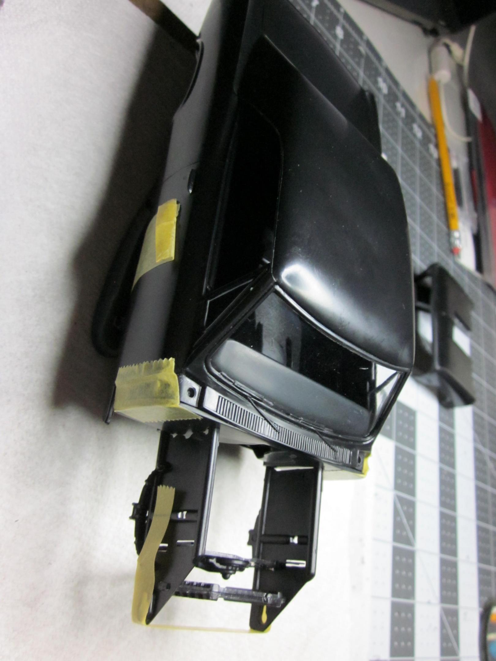

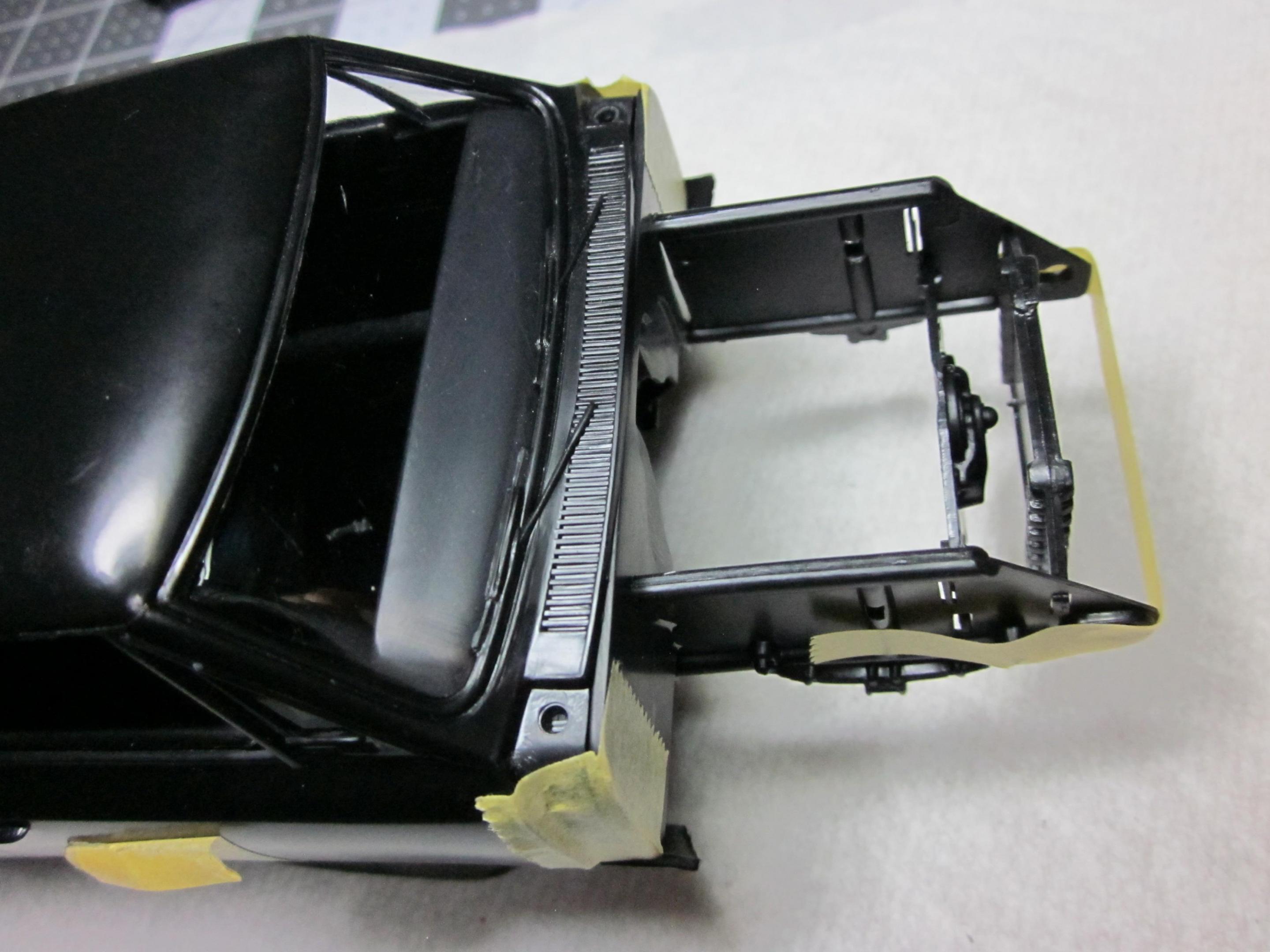

Pulled all the parts and took inventory of them. They were then washed and let dry. All the parts were then cut off the tree's and each one will get cleaned up and test fit. These kits have a few problem areas and i will address these areas for proper fit. The first thing i worked on is the fitment of the dash to body. If this is not done the rear axle will not be in center to the rear wheel opening because the chassis to body will not fit together properly. The chassis will instead fit to the rear because the interior bucket is not in the right position caused by the dash fitment. Starting with the glass, All the numbers and letters on the bottom of the roof were removed and the area sanded (still needs more sanding done) smooth so as the glass will sit flat inside. The dash was first lowered a little in the interior bucket. Next i started filing on the leading edge of the dash till the body and interior bucket fit together nicely and the chassis was center in the rear wheel wells. Been working on cleaning up other parts of pin, sink marks and casting imperfections due to the old molds.

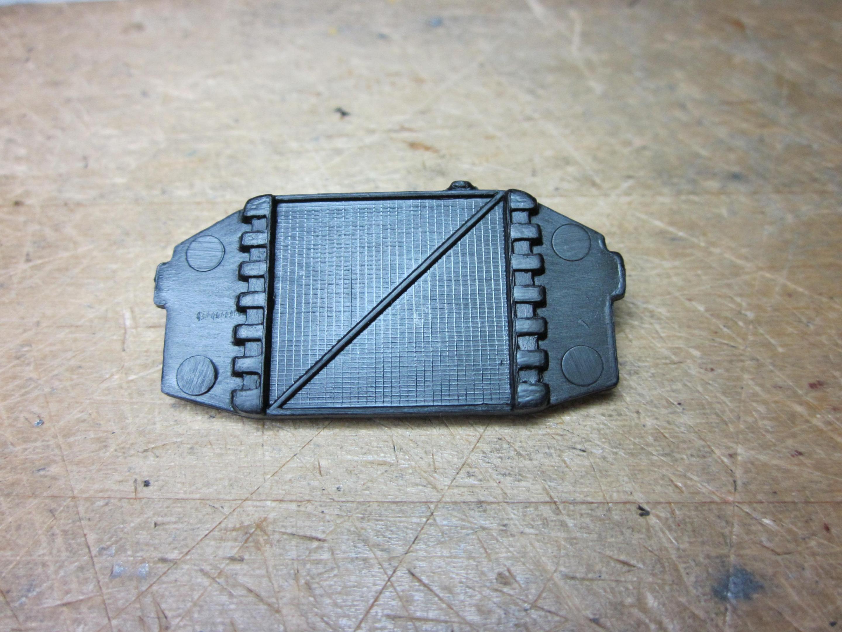

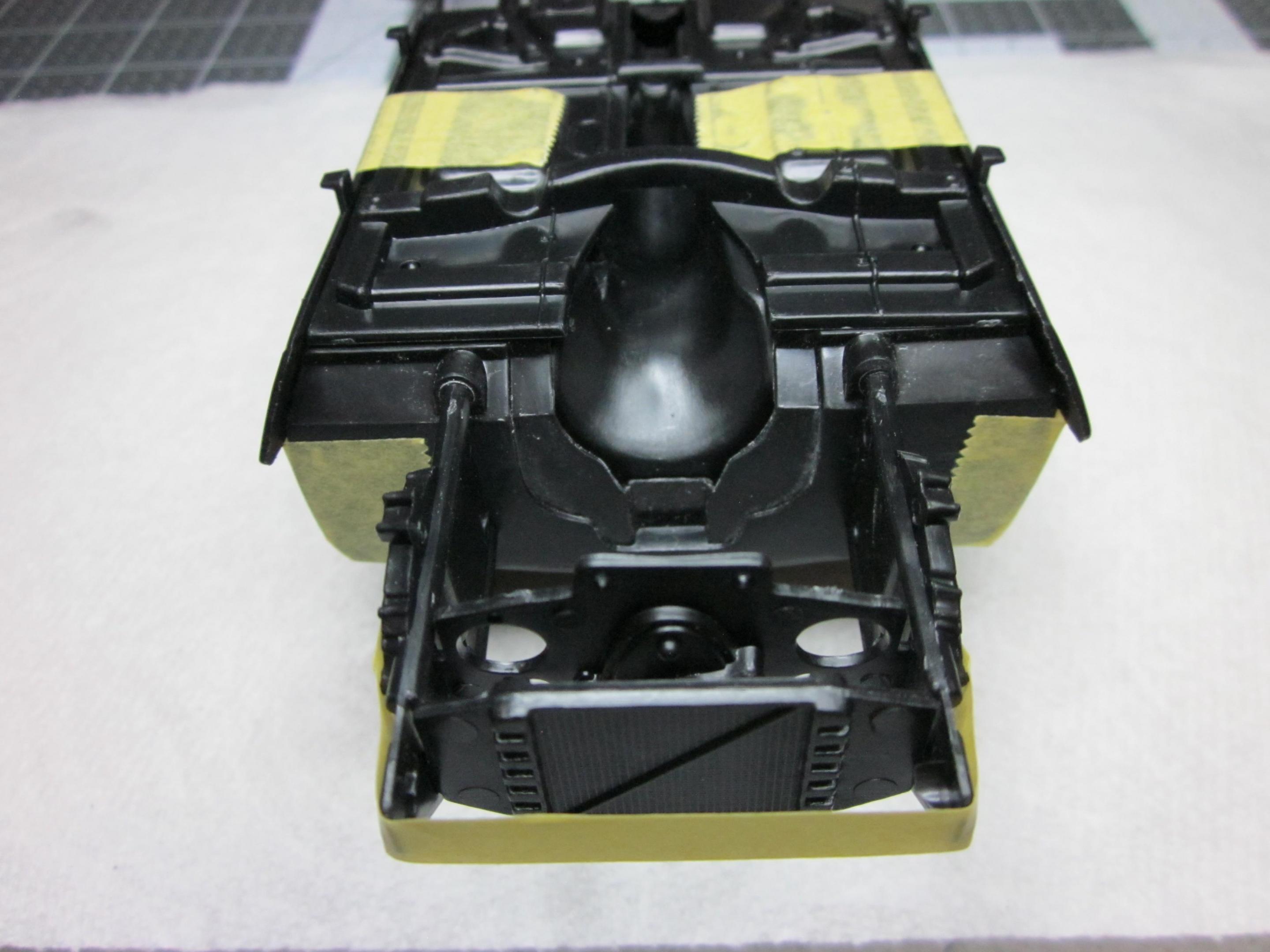

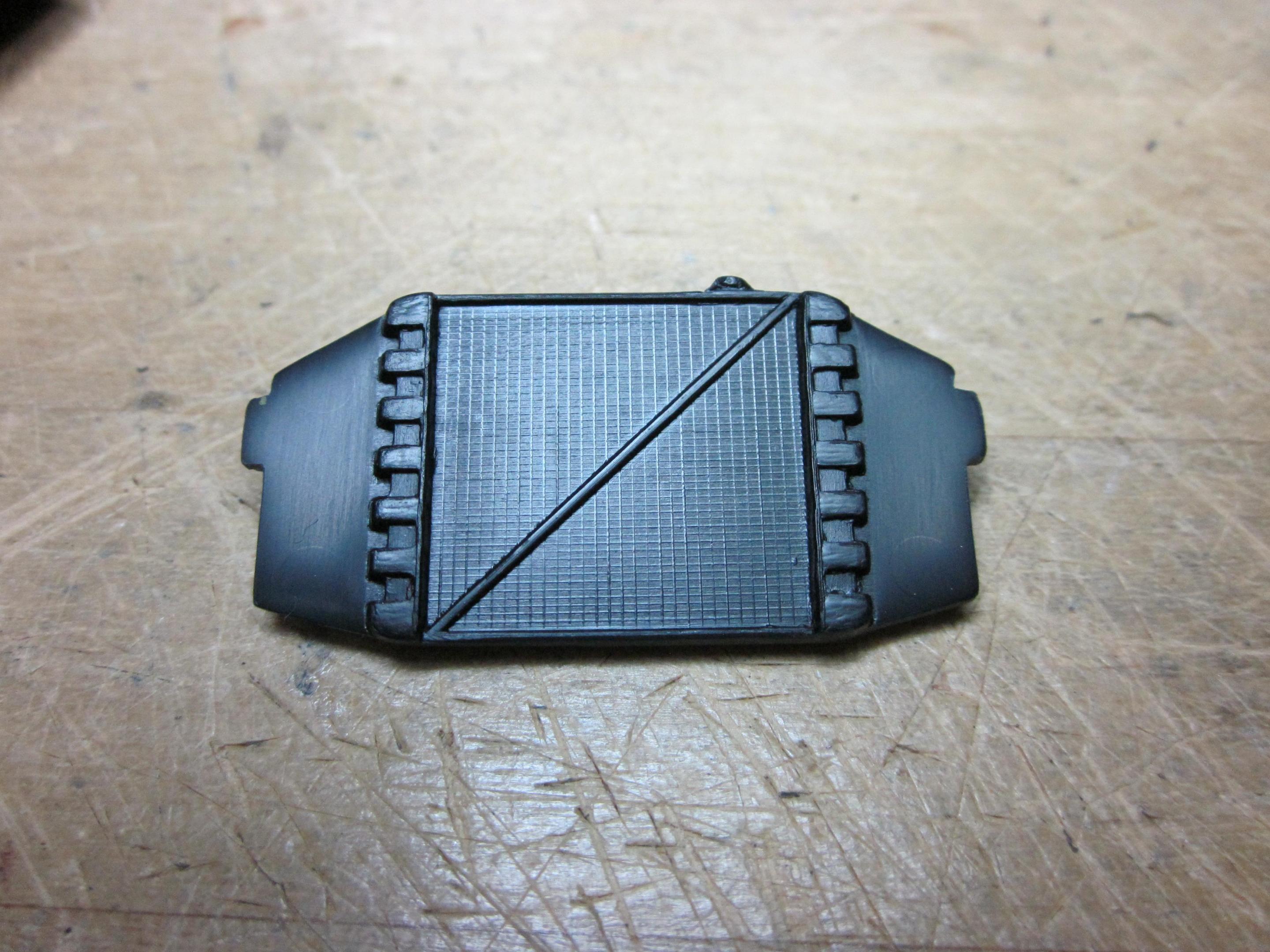

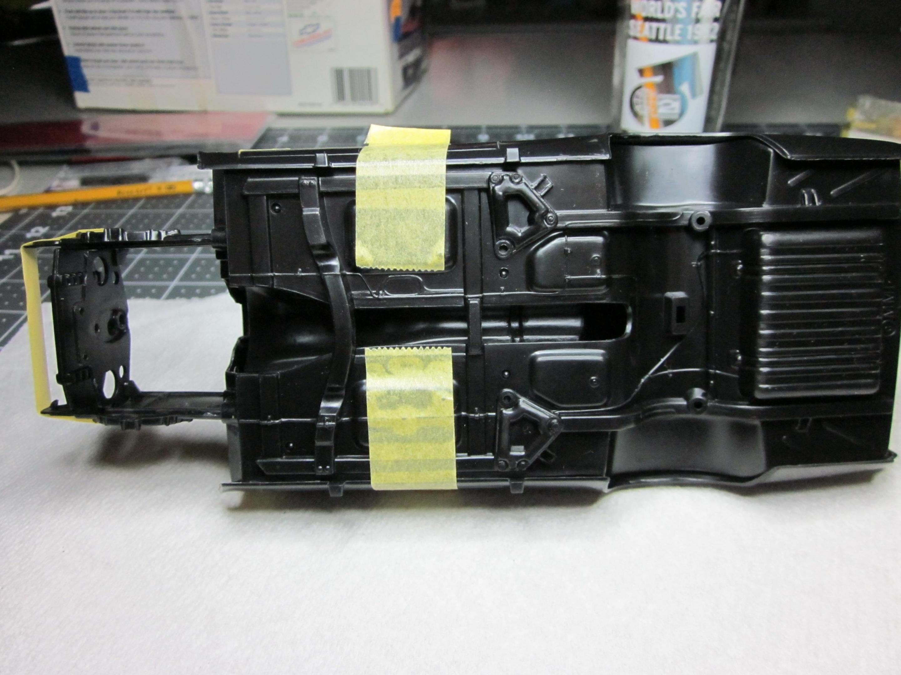

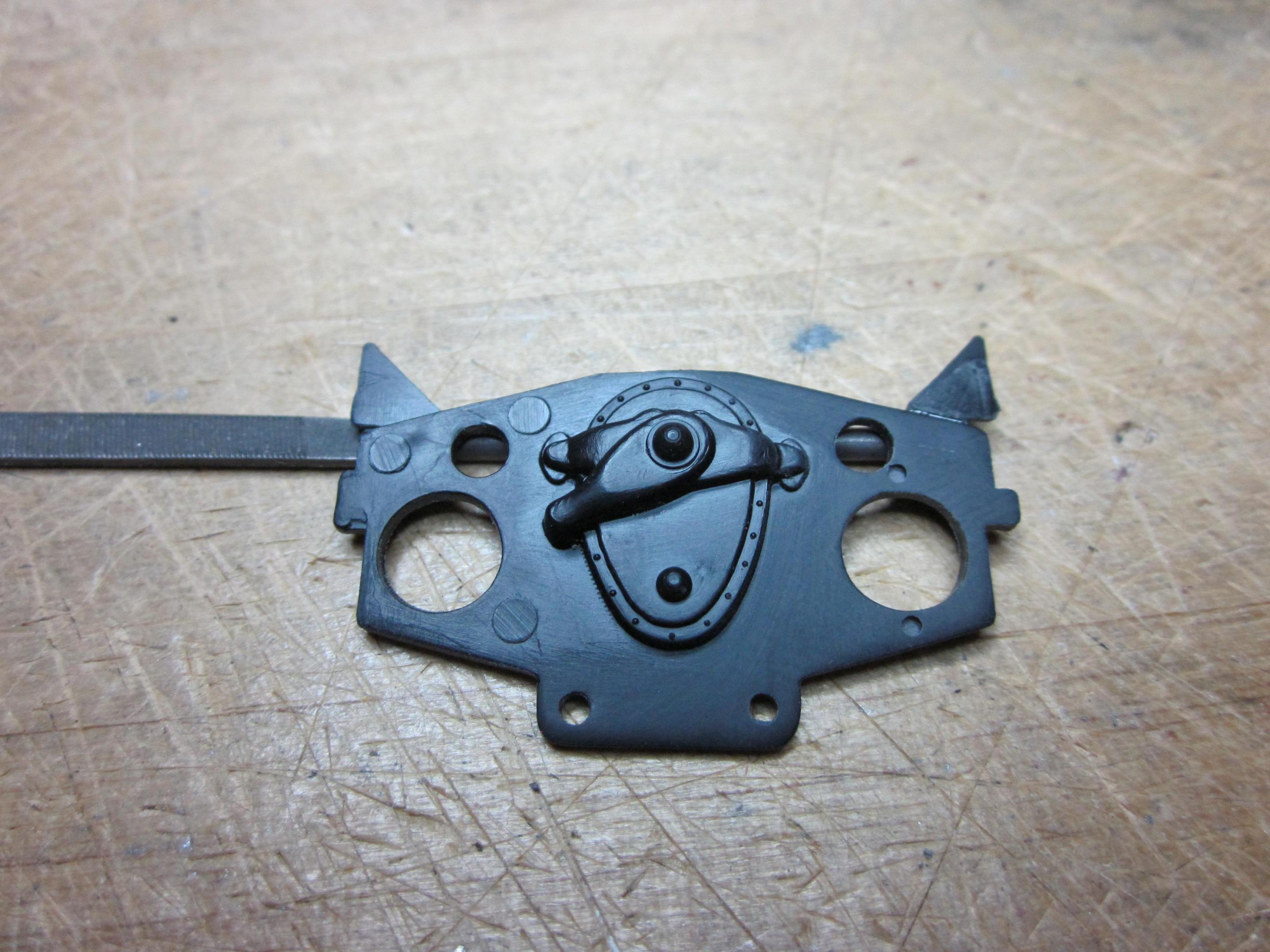

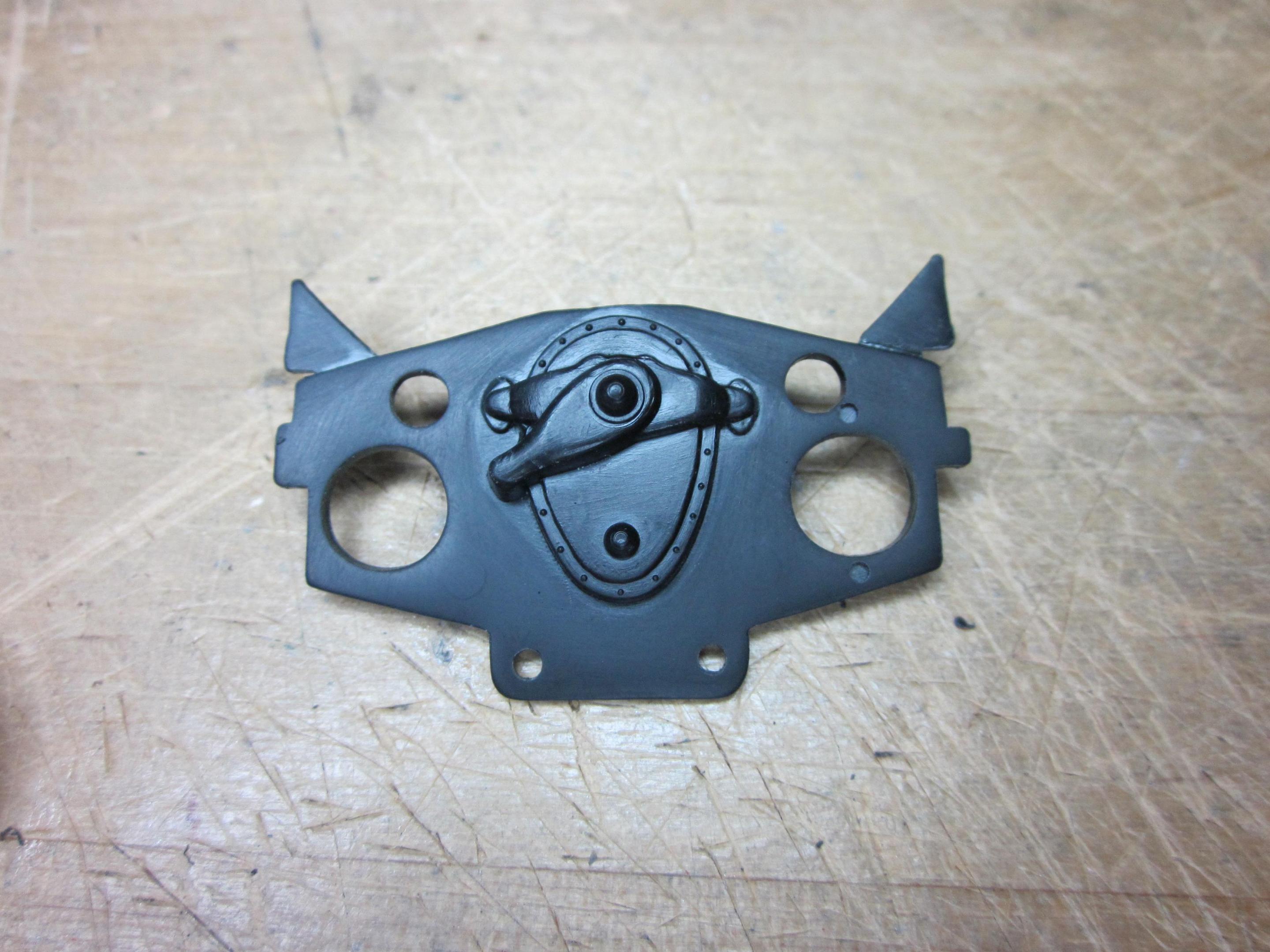

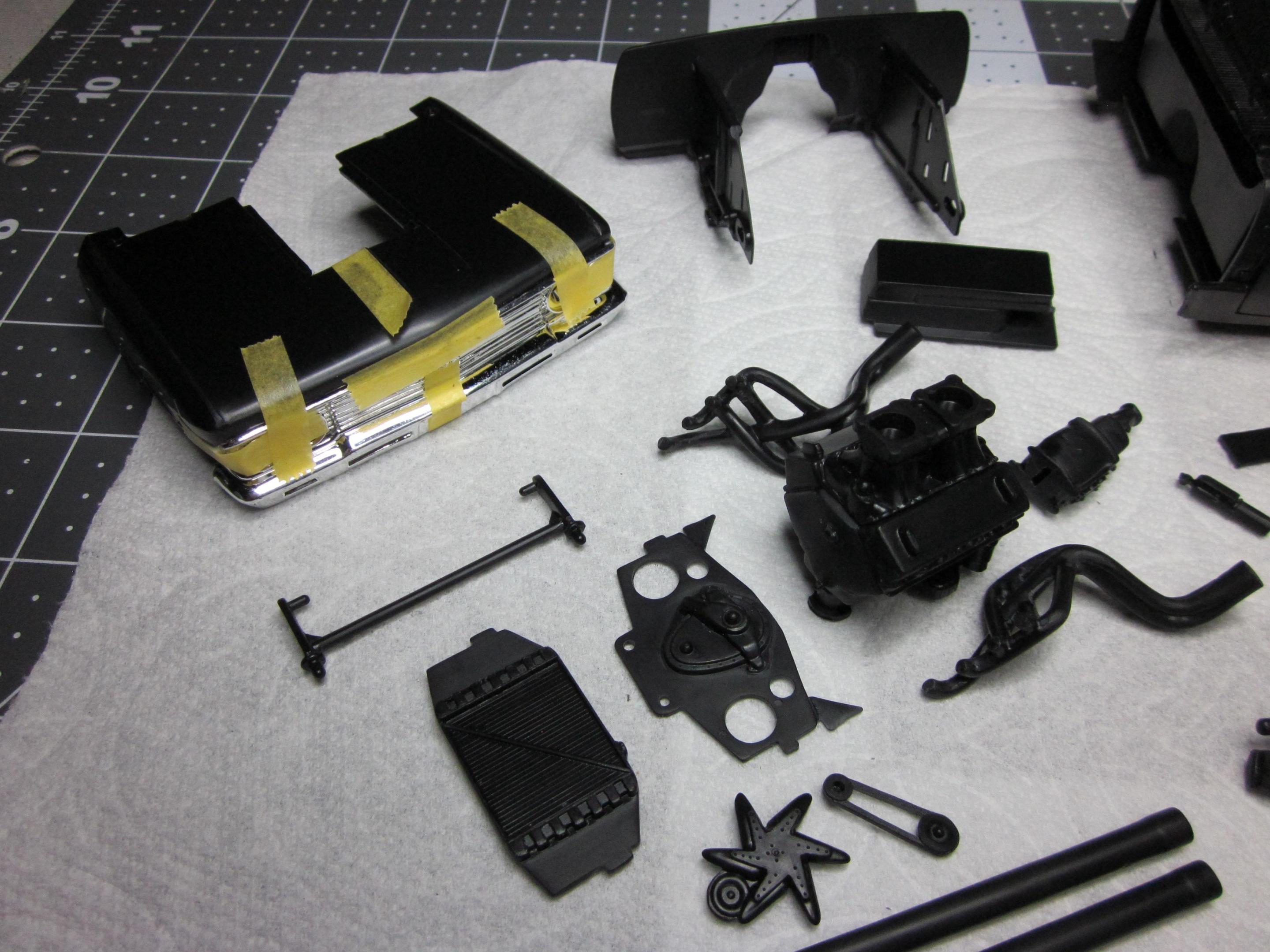

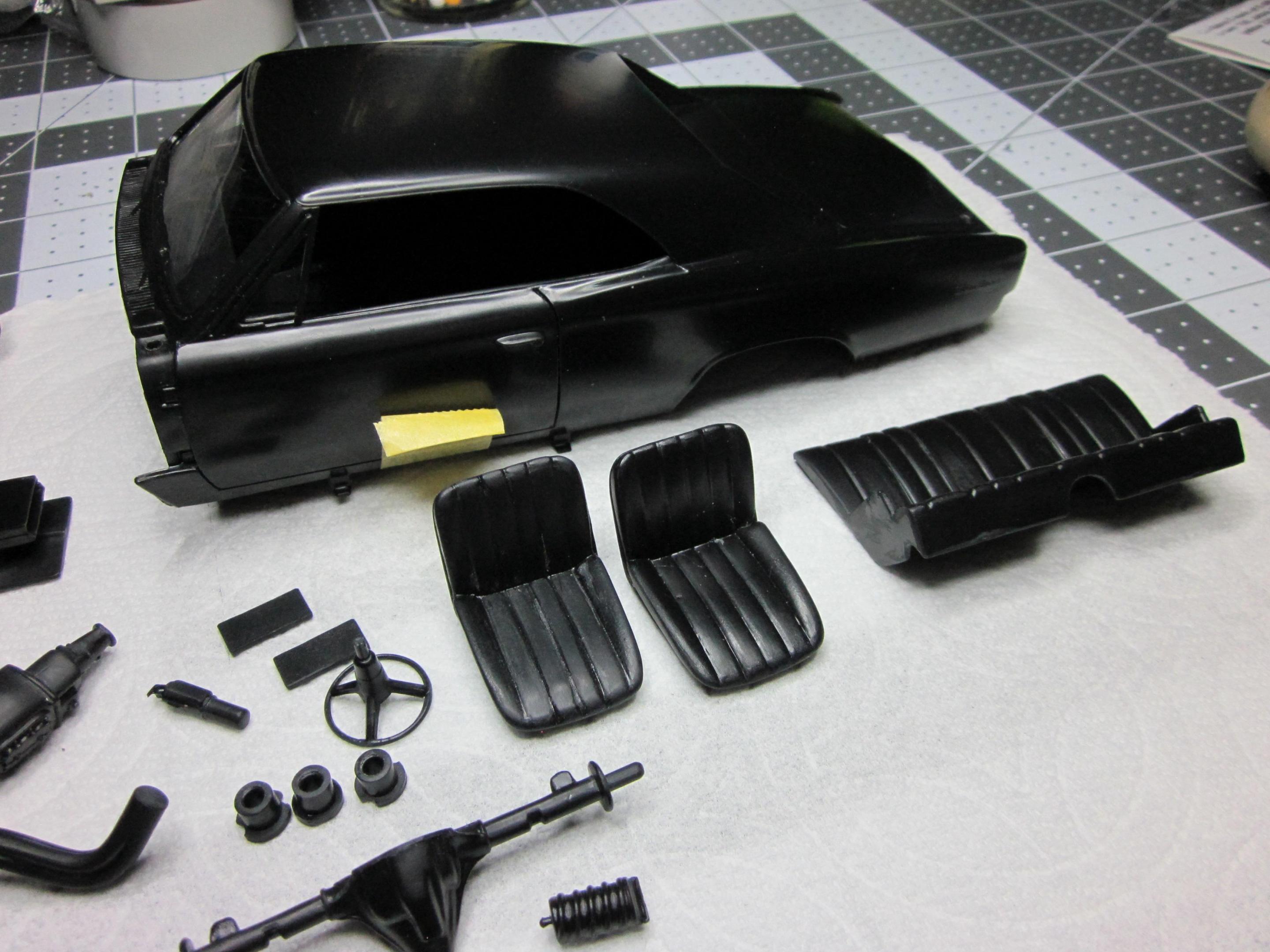

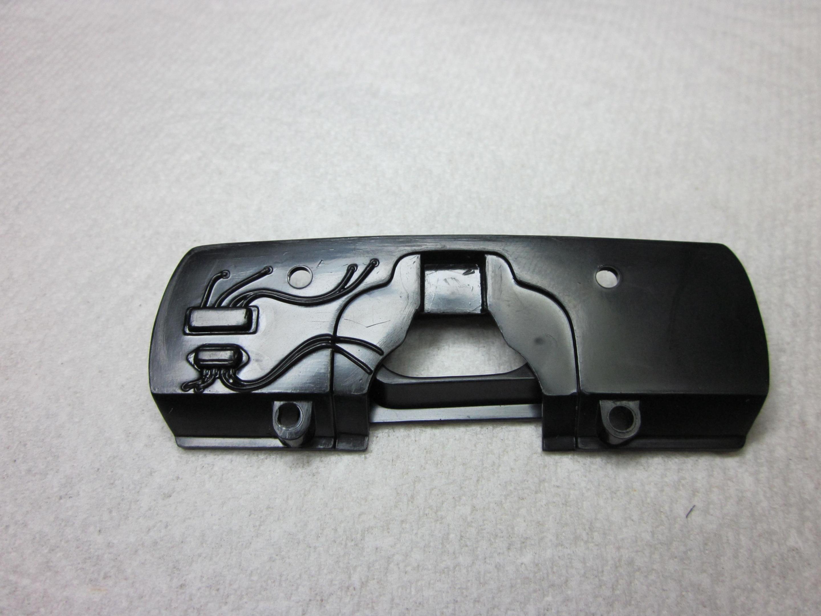

Got the majority of the parts all cleaned up and detailed. Put the engine long block together and the trans. Most parts ready for paint.  Shaved the firewall of the two box's and wiring.
Fitting of the firewall and side frames.....................
Some of the pin and sink marks i had to remove............................
Parts cleaned up.............................
