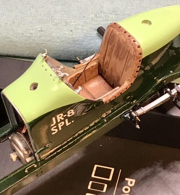

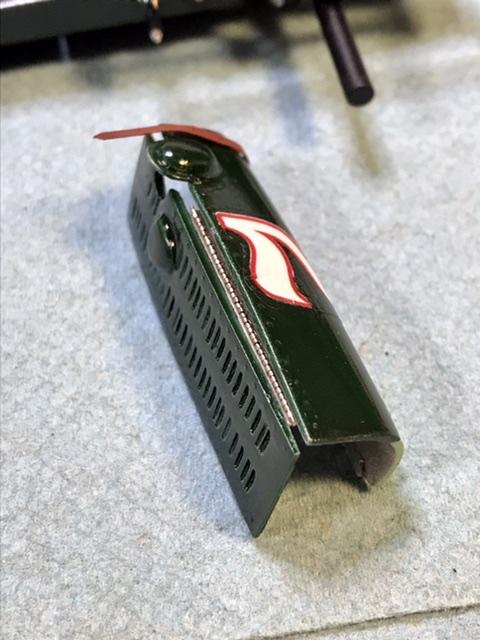

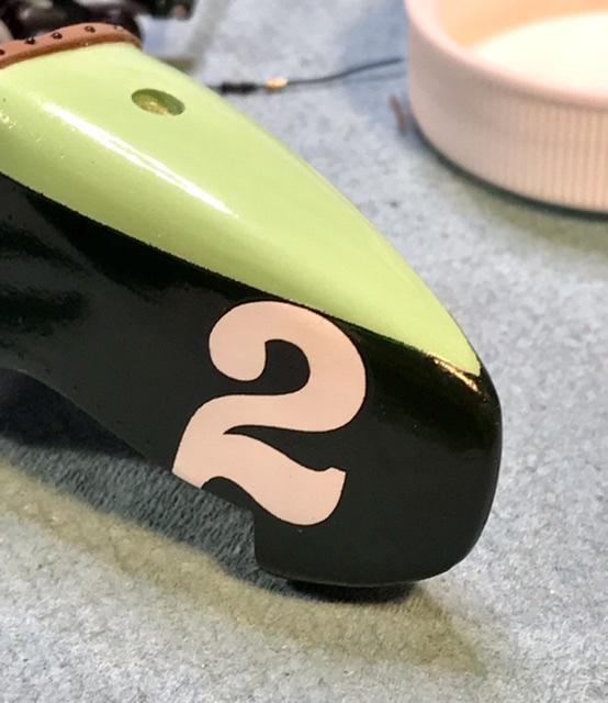

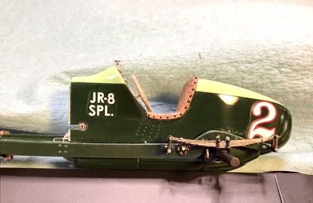

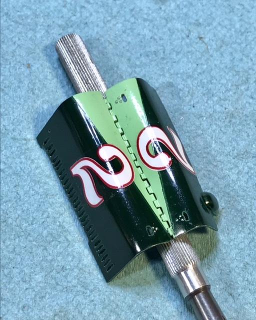

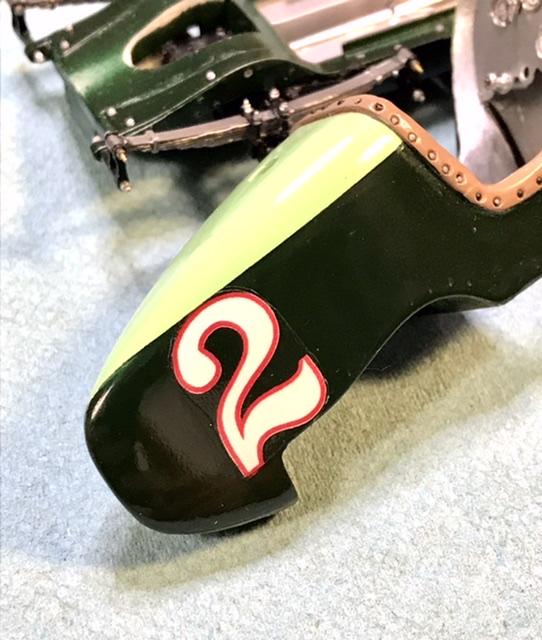

absmiami Posted April 2, 2023 Author Posted April 2, 2023 The decals require a clear coat - i used Tamiya clear - and guess which panel I did first …
Pierre Rivard Posted April 3, 2023 Posted April 3, 2023 Aahhh, decal day, my favorite. Always takes more time than expected but so rewarding. Looking good Andy!
absmiami Posted April 3, 2023 Author Posted April 3, 2023 You’ll be pleased to know that the border was corrected with a brush touch up …

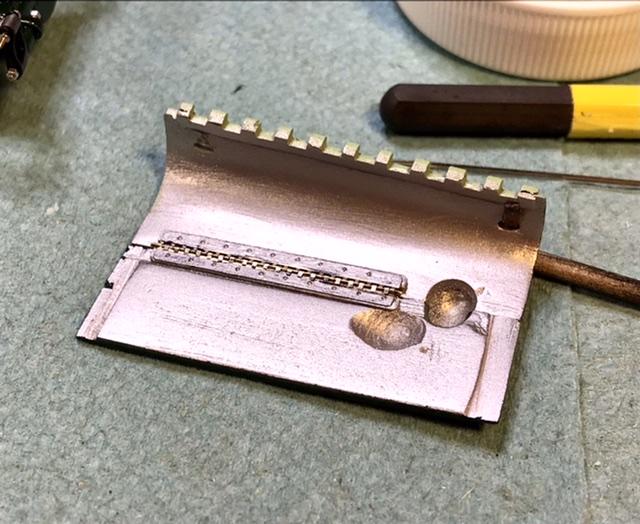

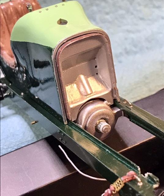

absmiami Posted April 3, 2023 Author Posted April 3, 2023 Model Car Garage hinge is epoxied to the back side of the left bonnet panels….

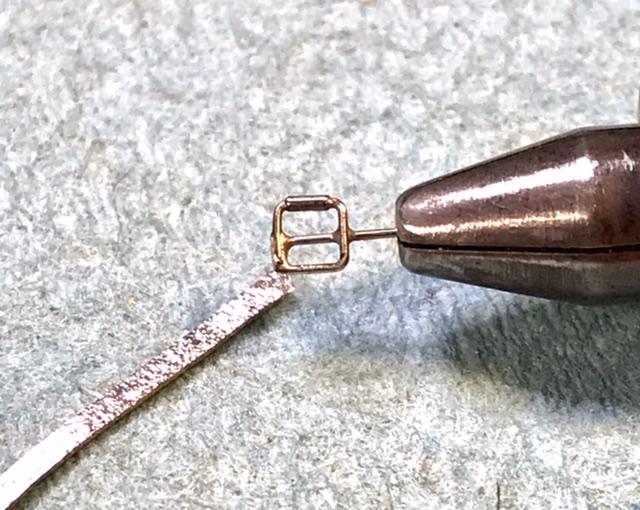

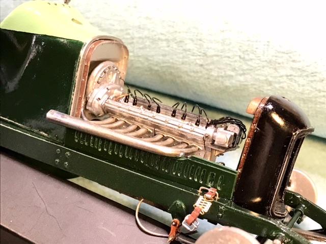

absmiami Posted April 3, 2023 Author Posted April 3, 2023 The bonnet has three straps - not four- the fourth would be ruined by exhaust heat …. The springs on the straps are unique to early open wheelers - Tom’s Model works - which has an early aviation and miltary focus - has these in its catalog - thank you Tom …. The buckles are made from .012 nickel rod and a short length of .022 tube … 1
absmiami Posted April 3, 2023 Author Posted April 3, 2023 The second part that is sourced fr Etzell’s 91 kit is the exhaust mamifold - Chris had his casted in white metal - he had planned to do a fr dr 91 kit - which is what Bradford has casted - All of Brad’s parts are resin - so my manifold is resin - with some slight mods to the location of the cyl head pegs…

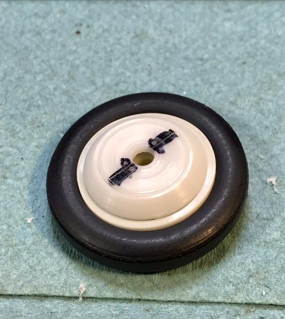

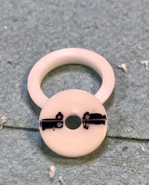

absmiami Posted April 3, 2023 Author Posted April 3, 2023 The rear brake drums require some added detail - and i used a drill bit to carve out a section of the drum that will slip over the lip of the spindle - so now i’ve got the spats located properly …
absmiami Posted April 3, 2023 Author Posted April 3, 2023 (edited) The manifold was painted black, then Molotow chrome, and then hi-lites with steel and the Tamiya powders - blue and red - the red is not really red - its a gold tint … Edited April 3, 2023 by absmiami

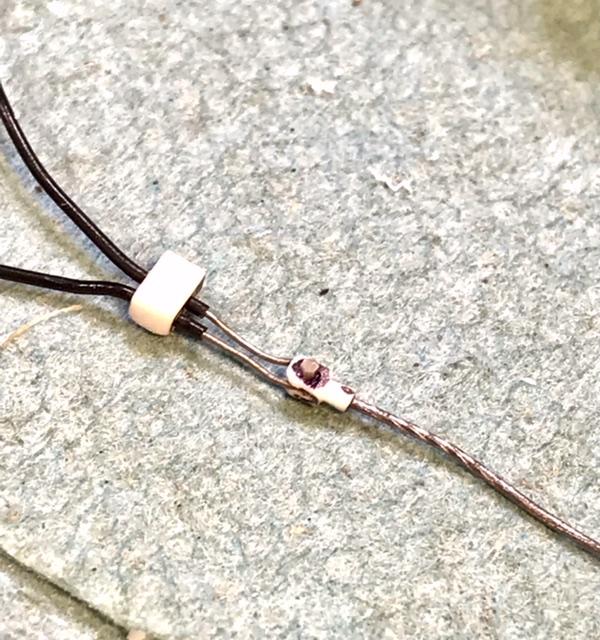

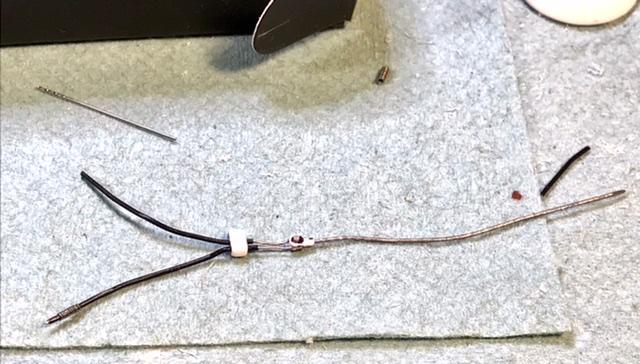

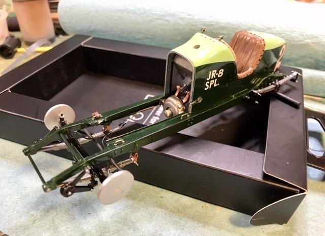

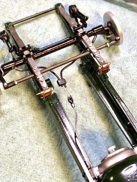

absmiami Posted April 7, 2023 Author Posted April 7, 2023 Mechanical brake lines - the lines left the drums - were fed thru the axle - met under / by the sump- and then headed back to the brake pedal - the line is .022 wire … 1
Pierre Rivard Posted April 7, 2023 Posted April 7, 2023 Your brake lines look very much like the 1/1 stuff. Very creative way of achieving that.

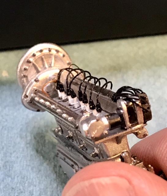

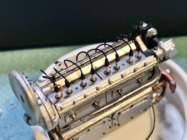

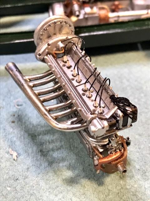

absmiami Posted April 9, 2023 Author Posted April 9, 2023 Gracias got those plug caps onto the plug wires and glued to the top of the spark plugs - 1

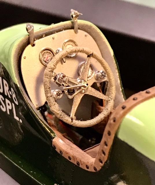

absmiami Posted April 10, 2023 Author Posted April 10, 2023 So the assemblies are finally coming together - with mixed reviews - the body was glued to the frame - i got a good fit - but the gas pedal was knocked loose in the install - and the steering wheel should actually mount higher - but that can’t be fixed on this build - maybe when i make the sister car- the Boyle Special … and i decided to add some contrasting brown to the seat for a weathering effect …

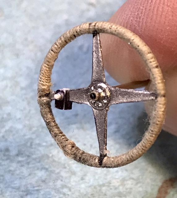

absmiami Posted April 11, 2023 Author Posted April 11, 2023 The device in the center of the steering wheel is found on many vintage Indys - i think that it advanced or retarded the magneto timing - not sure …

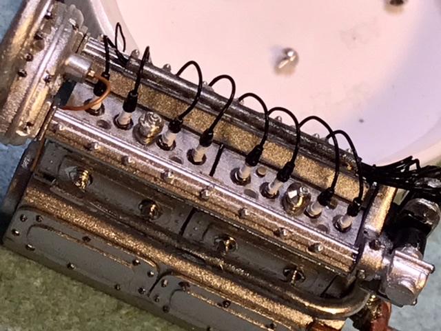

absmiami Posted April 11, 2023 Author Posted April 11, 2023 (edited) Each of the two cyl heads has a valve of some kind in between the plugs - these were turned fr nickel silver - dia of .075 - with a small Master Club center bolt and a flange base …. Edited April 11, 2023 by absmiami
absmiami Posted April 11, 2023 Author Posted April 11, 2023 The gas pedal is glued back into the footwell - so now i can glue in the firewall - which must be done before I can glue the engine into the frame …

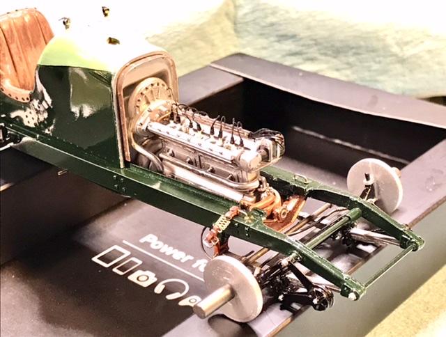

absmiami Posted April 12, 2023 Author Posted April 12, 2023 Engine’s in - w the cross brace in front - used epoxy to get a reasonably good setting in the frame - the pipe that emerges fr behind the supercharger and then curves below the frame is the intake for the carbureter … and the exhaust manifold is now epoxied to the cyl head - so i can now set the exhaust pipe … 1

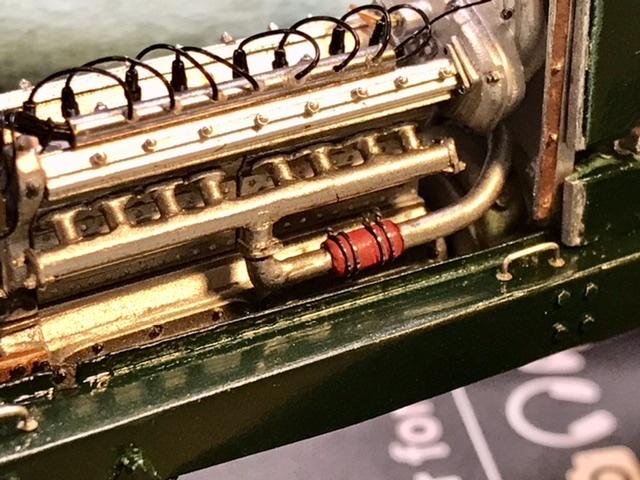

absmiami Posted April 12, 2023 Author Posted April 12, 2023 Gracias - as soon as this is done i can turn my attn back to a certain Ferrari engine …. The pipe with the red banding is the feeder for the manifold - and i managed to install the in/out lines for the oil pump that is located at the forward corner of the sump pan…
Pierre Rivard Posted April 12, 2023 Posted April 12, 2023 Looks gorgeous Andy. Looks like you are nearing completion. Which Ferrari? I thought you were working on the Sebring Daytona coupe?
