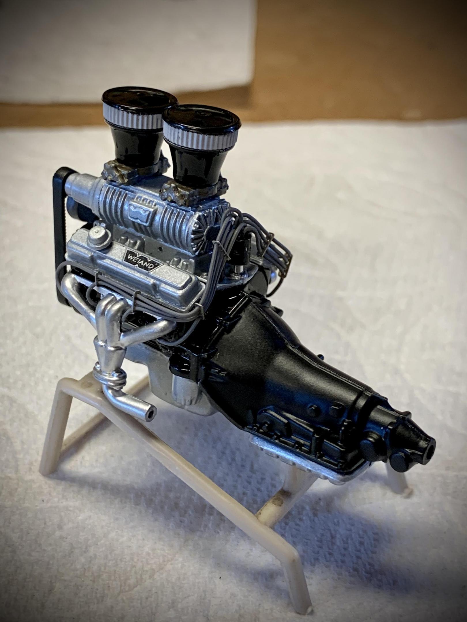

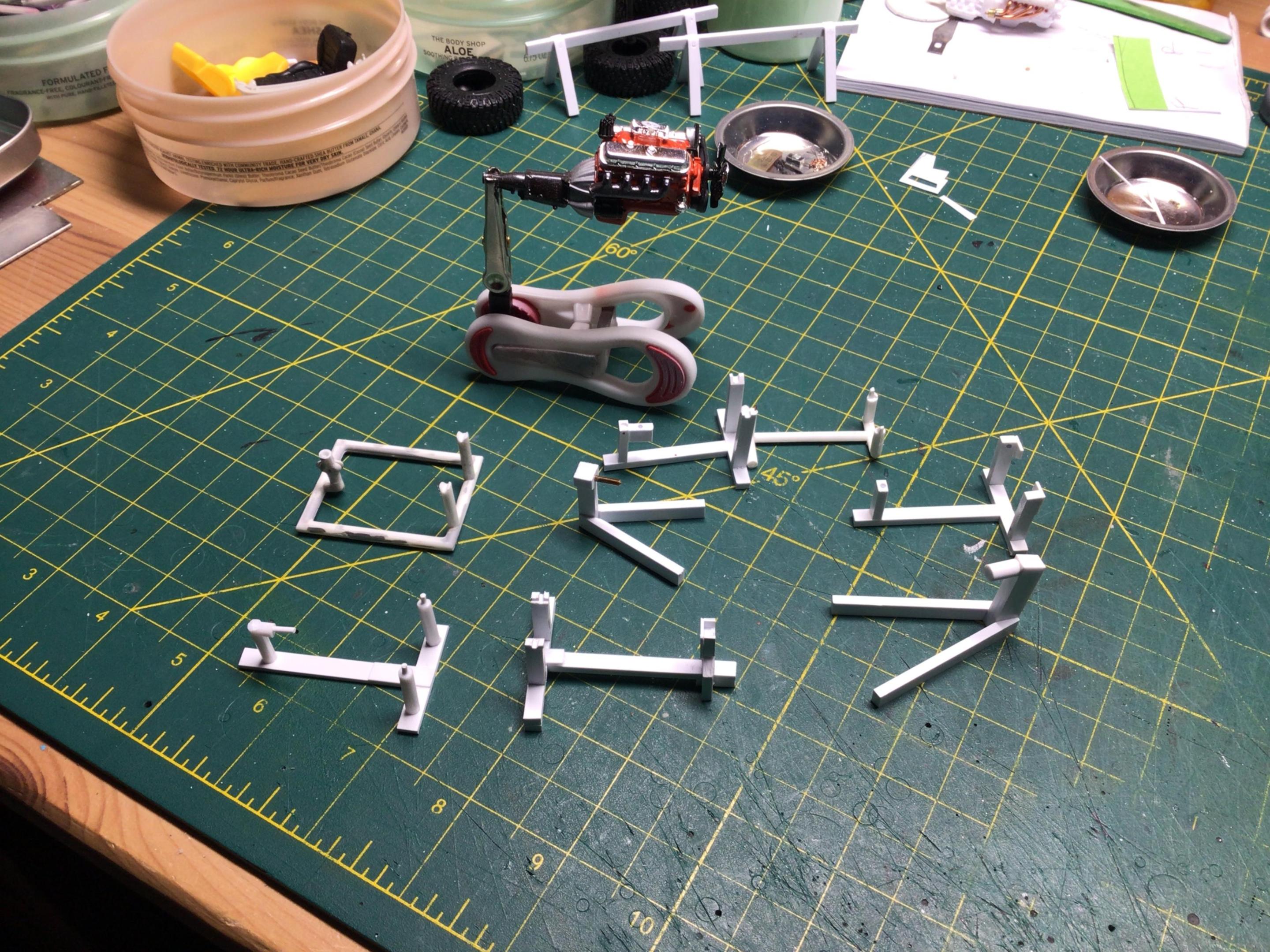

I'm going to start work detailing an engine/transmission and I was curious to see if there's any stands or jigs out there people use to hold the engine while you paint, glue wires, etc.?
Thanks!
I like these from amt... I think I went a little overboard with the pictures... But you get the idea...?
These pictures are not mine by the way... I  saved these from the forum... Thanks guys!....??

Sprue frames/trees are a great source for material that can be chopped up and made into stands.
I usually put some tape over the bottom section to hold it steady while attaching part's.
