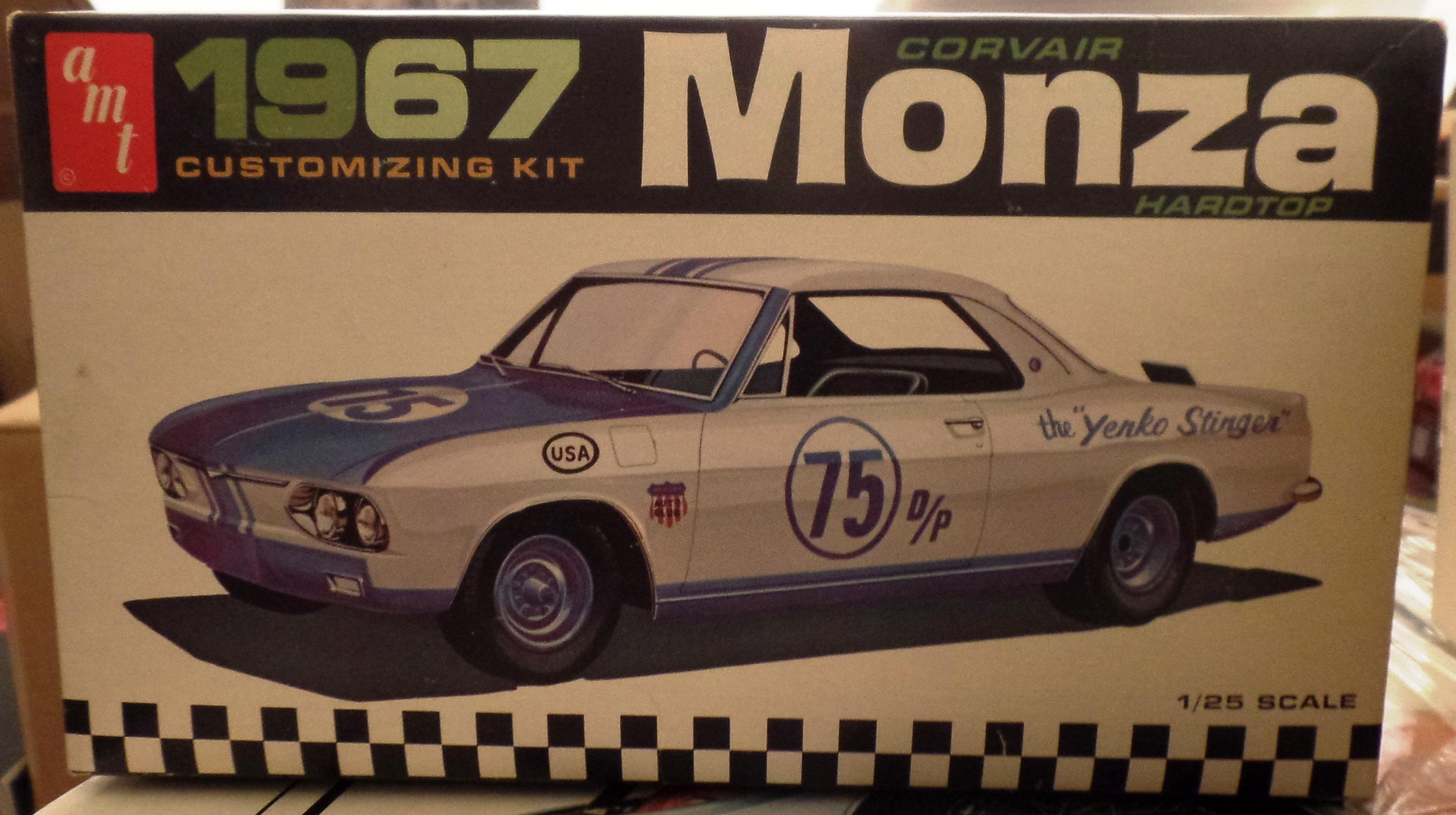

AMT 1/25 Corvair as Yenko Stinger
Been looking or one of these for a while, following an article by Jay Leno in a recent Octane and then watching the episode of his Garage featuring the beastie.
This boxing of the kit includes many, if not all, of the optional parts from the various versions offered over the years. There's no mention of Yenko or the Stinger in the instructions, but the essential parts for a Monza or Stinger seem to be present and correct.
The sail panels that extend the C-pillars and engine cover with spoiler and vents are two key features of the original, and there are "tuned" engine parts and extras for the cabin. Some elements are used in the build option that's described as "Rally" in the instructions, but you really just need to work from references and enjoy discovering how many of the bits you need are already in the box...
