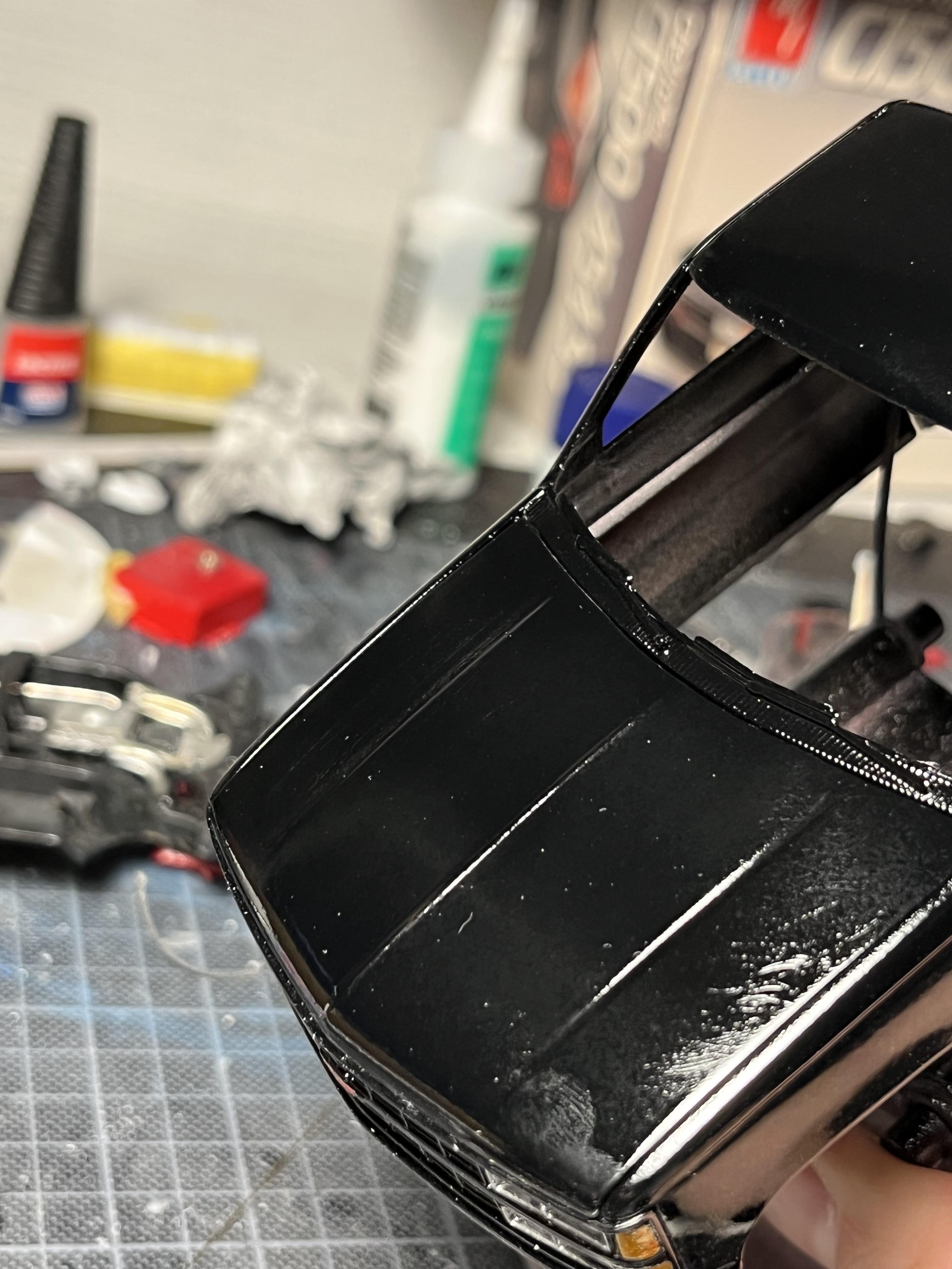

I think everyone that's built a model has, at one time, ruined a paint job. Whether it's a drop of glue, burn through or other. My latest goof was smearing what I thought was Tamiya Finish Compound, but was actually Tamiya White Putty, on the roof of my latest model. In my defense, both have white lids. But, I obviously didn't read the tube! I didn't get a photo as I was too busy trying to get it off. But, this is what it looked like after sanding it with 1000 grit.
I've saved quite a few paint jobs with this method. But, this one was the ultimate test! I first take a piece of paper and roughly draw the size of the area I need to fix. In this instance, my drawing looked a little too large. So, I cut inside the lines.

Sand with 2000. Then 4000. Polish with Tamiya Course and Fine compounds. And I'm back to where I was! Ready for Tamiya Fine compound. Like it never happened!
After Tamiya Fine Compound, there's no hint of the previous damage.
I even took it out in the sun and couldn't see where I did the repair. So, next time you have a goof, give this a try before stripping and starting over. I've used this method on metallic and solid colors with great success. It sure has saved me a lot of time, materials and grief.
