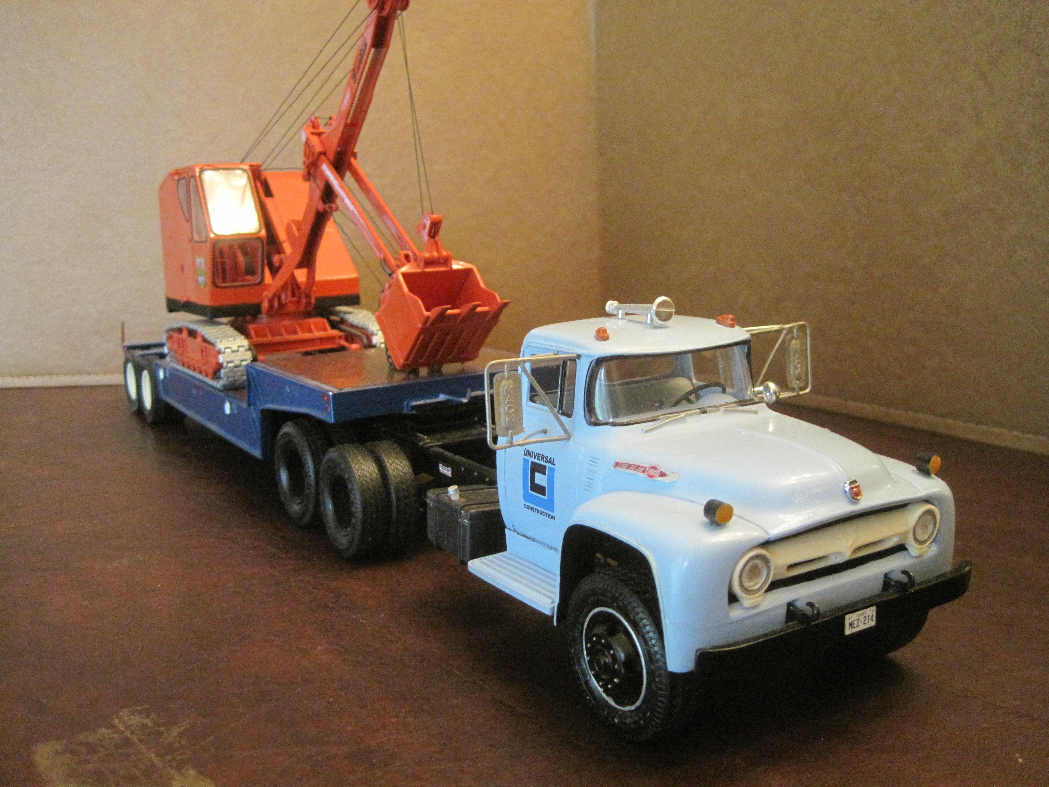

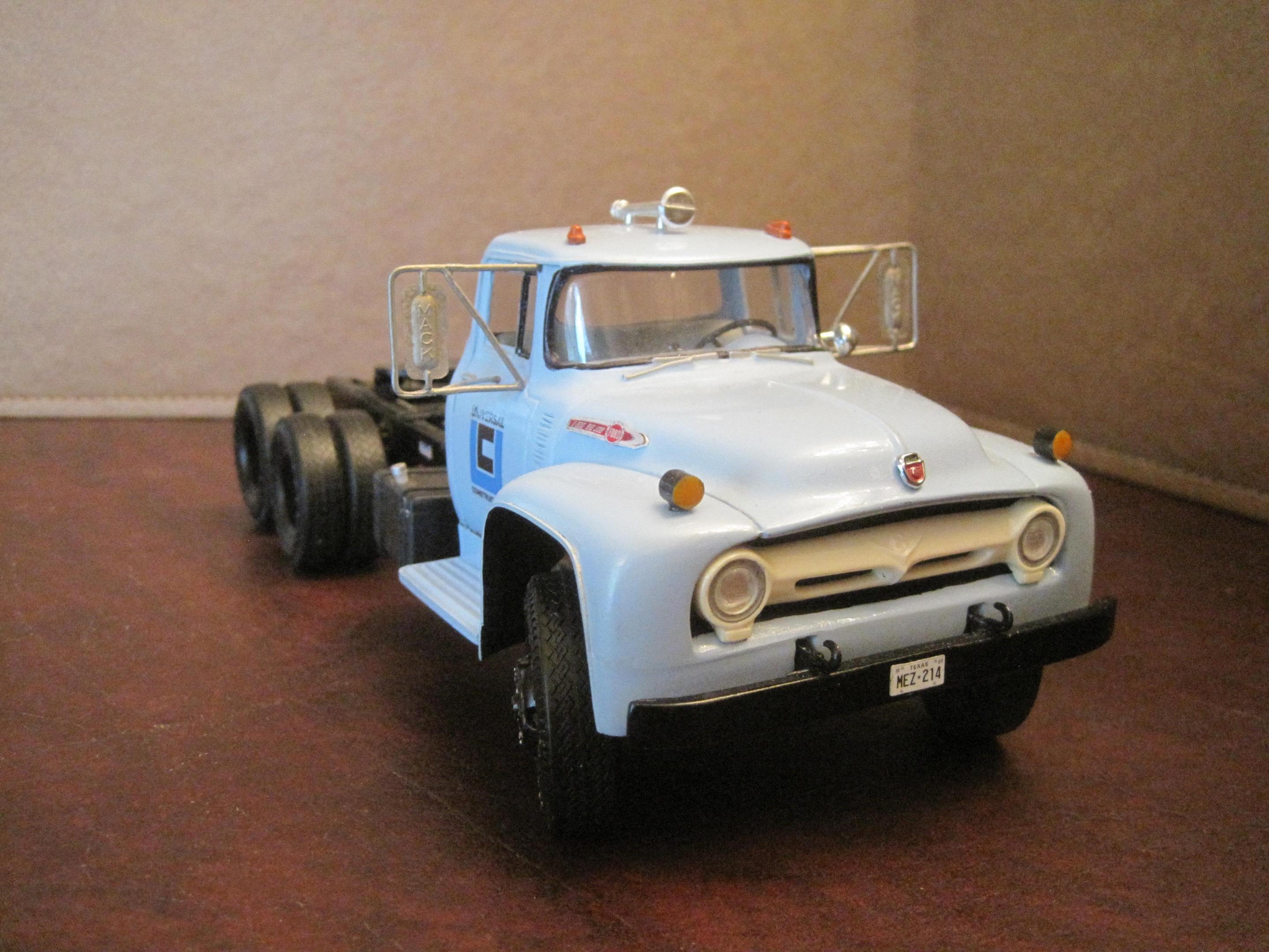

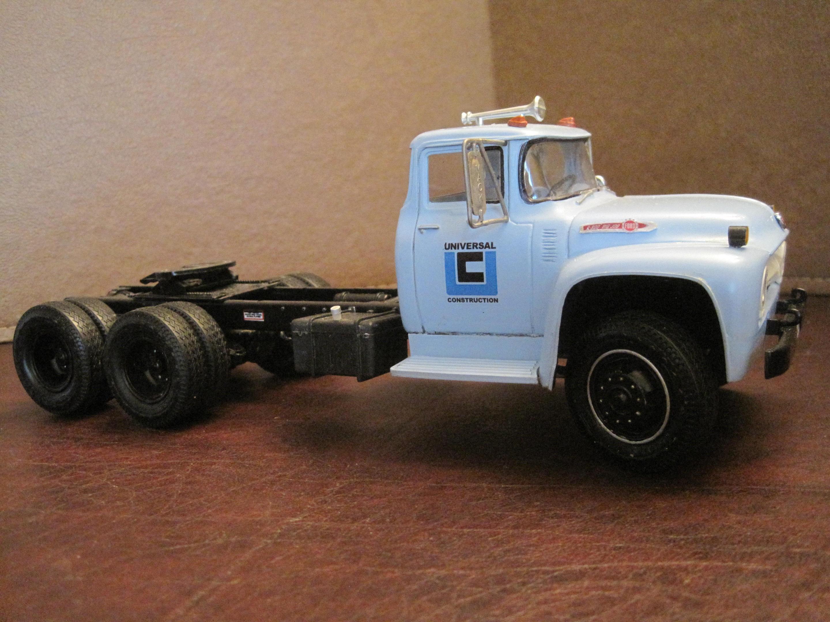

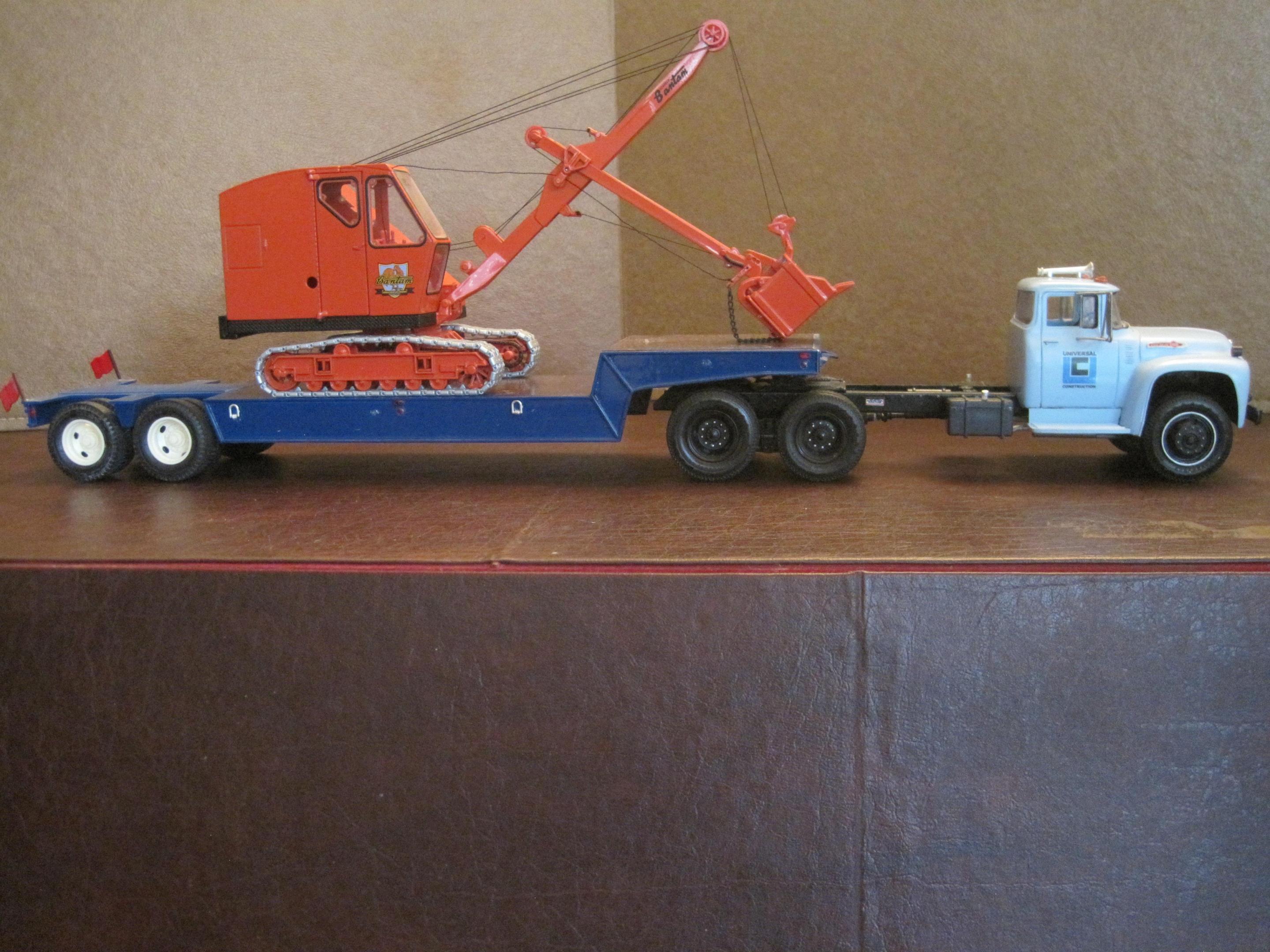

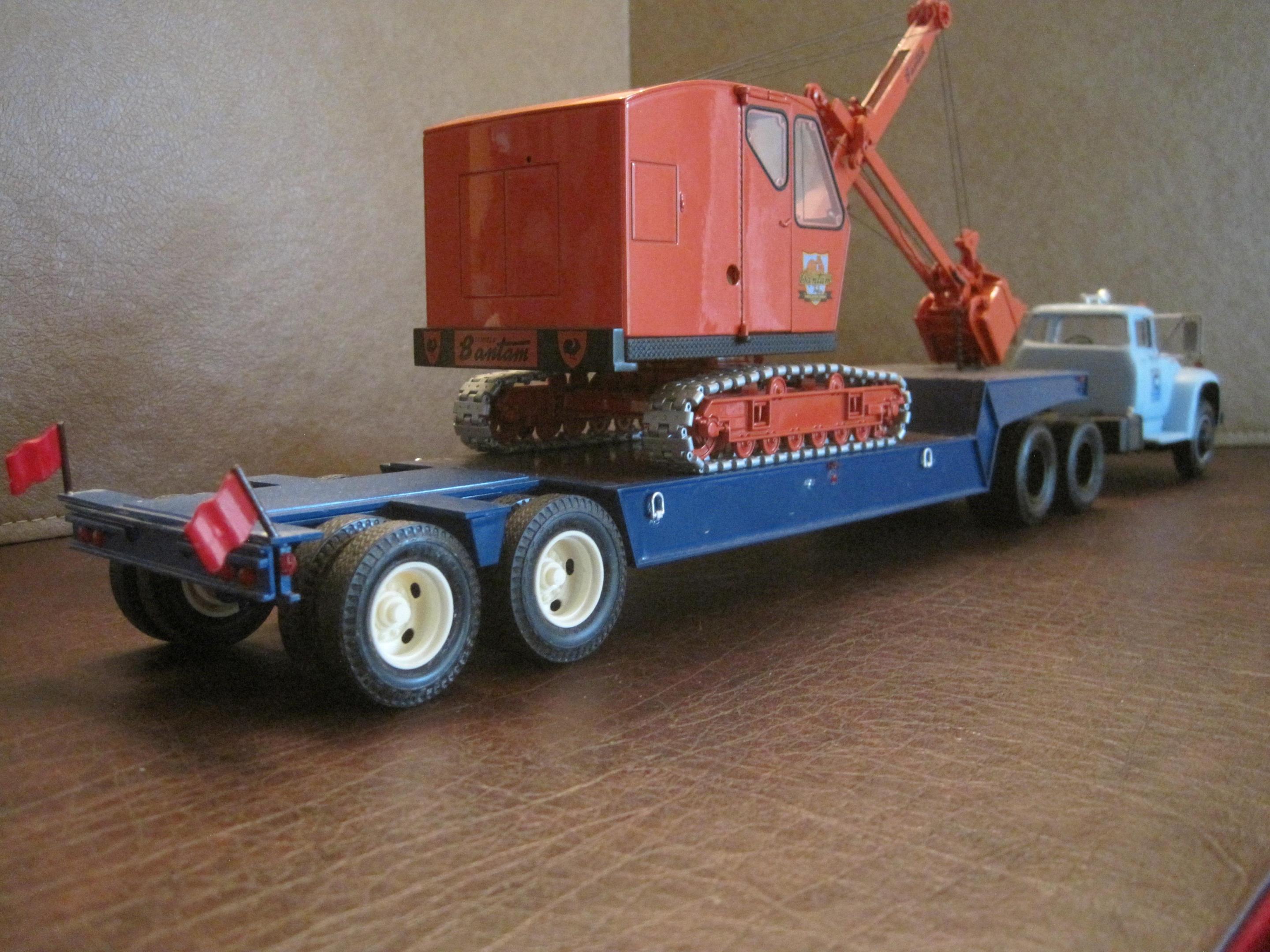

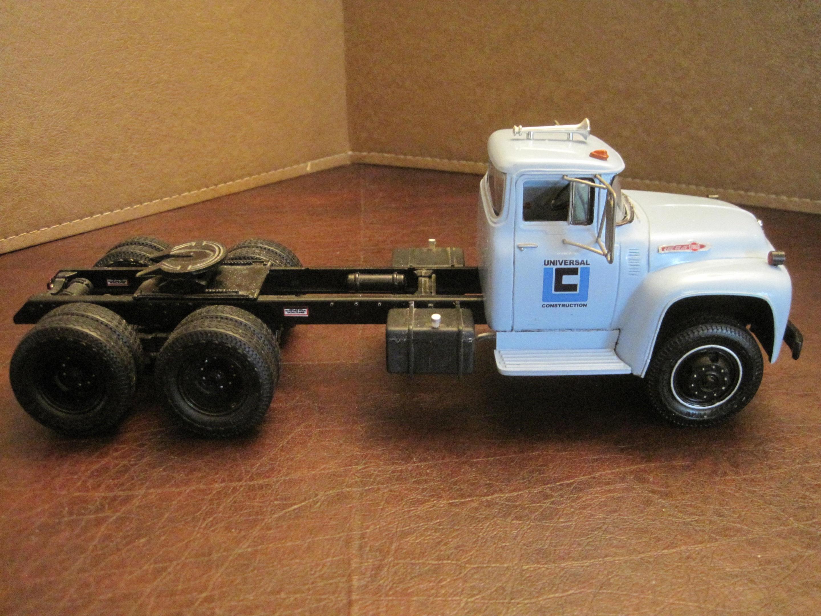

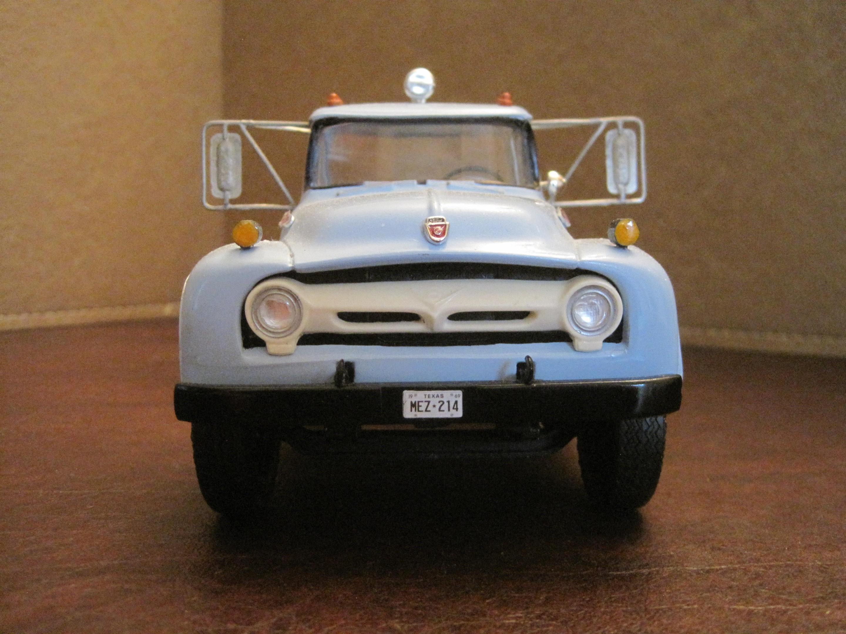

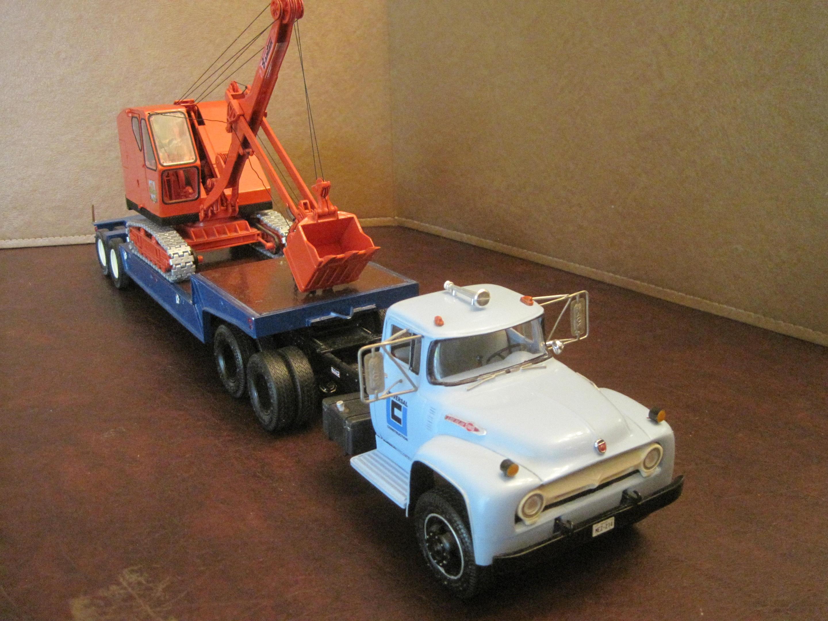

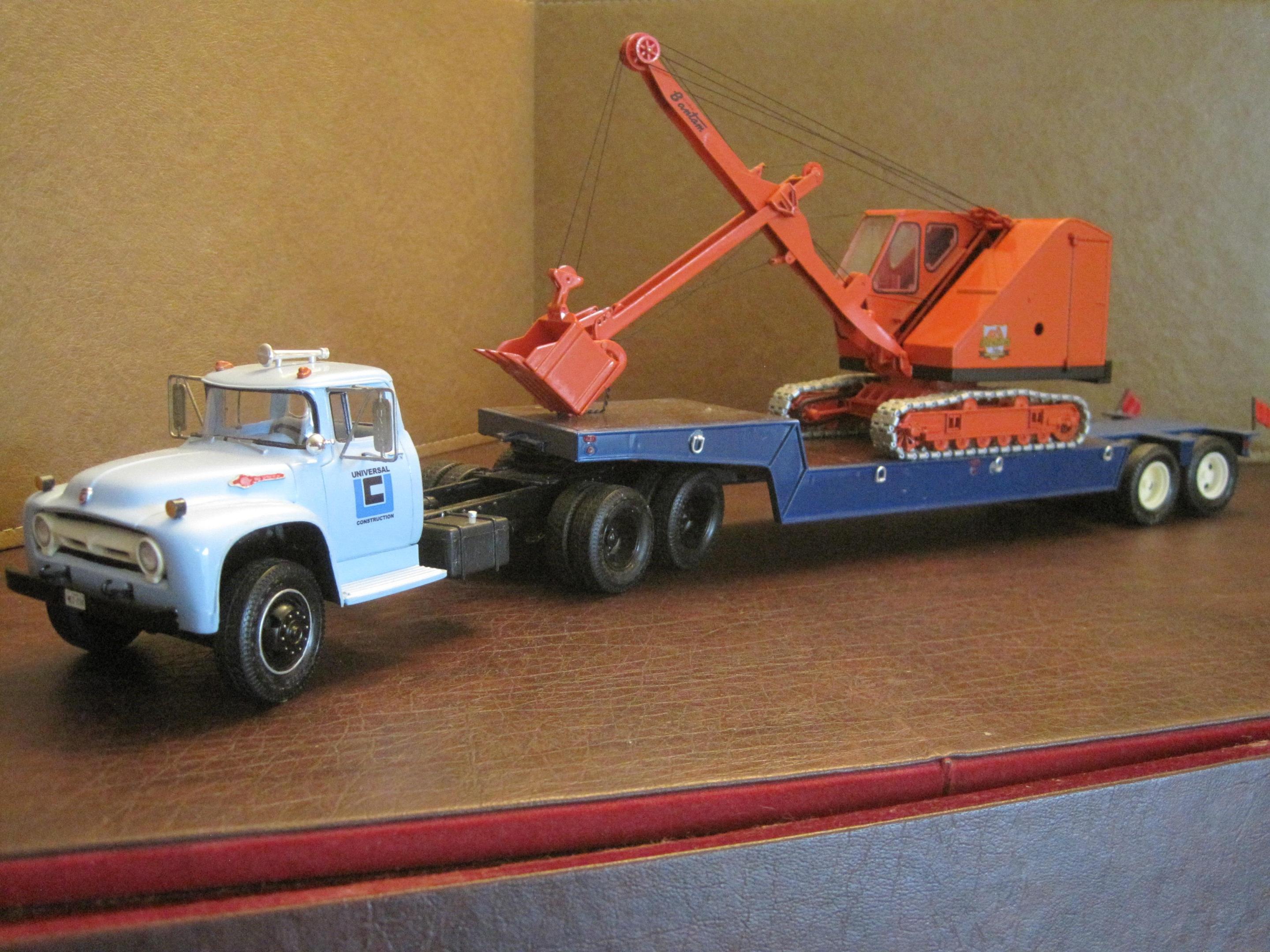

leafsprings Posted January 7, 2023 Posted January 7, 2023 (edited) Inspiration for the build was the old Aurora kit and a period Ford ad for a '56 T 800. Resin AITM '56 with modified fenders on a donor frame. There is a 534 under the hood mated to a 10 speed Roadranger, Ertl Paystar Budd wheels on tractor, resin Budd wheels on lowboy trailer converted to 2 axles. AMT did plan at one time to do a power shovel, but never happened, luckily there is a Bantam C 35 diecast in 1/25 scale to fill the void for the load. Edited January 8, 2023 by leafsprings 4

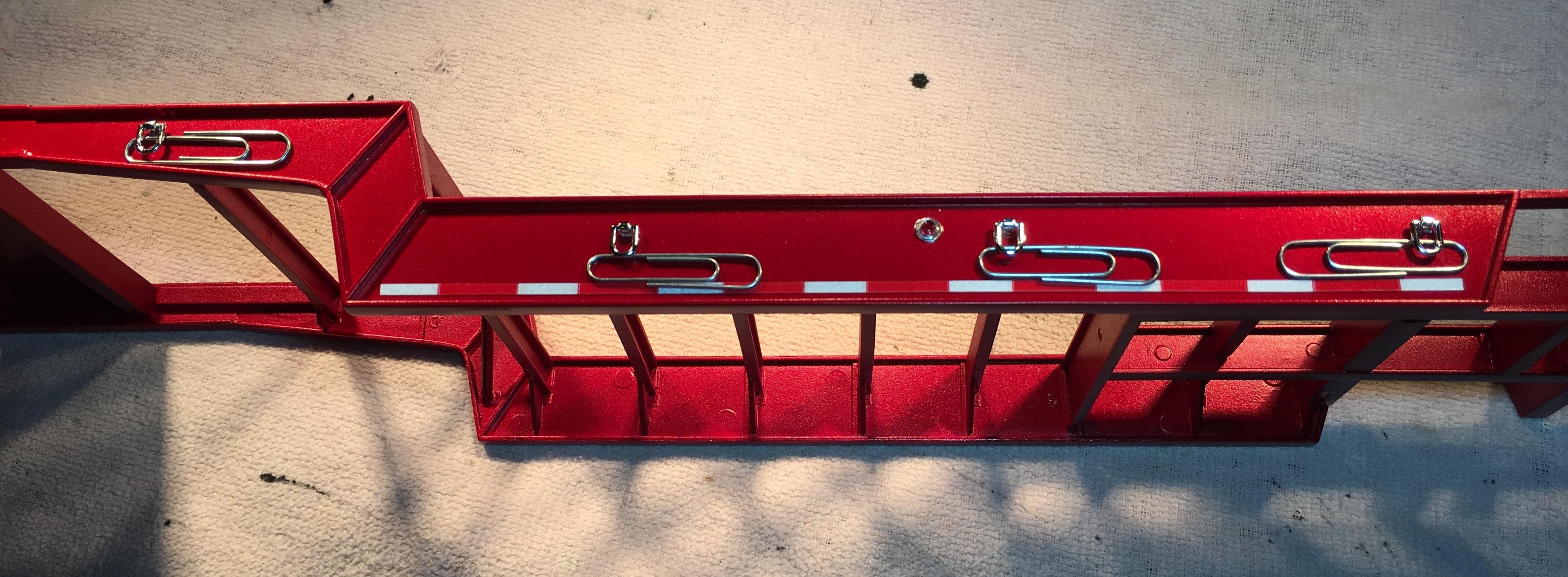

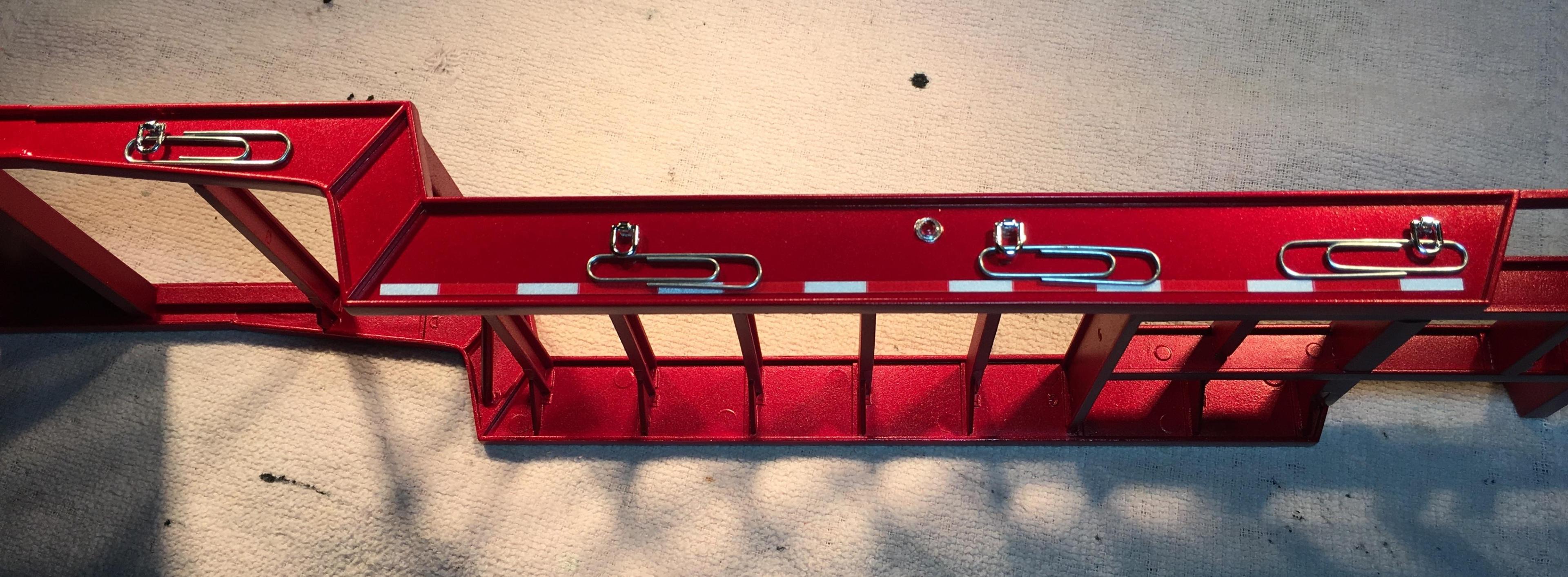

Bills72sj Posted January 8, 2023 Posted January 8, 2023 Very unique rig. You may want to add some chains to the load as some of the D-rings on the trailer are already pointing up. (defying gravity)
leafsprings Posted January 8, 2023 Author Posted January 8, 2023 (edited) I agree, trailer was an older glue bomb with some missing parts. Will look for some more hooks, great idea for getting the right gap. Edited January 11, 2023 by leafsprings

Warren D Posted January 8, 2023 Posted January 8, 2023 Nice looking rig but you better lower that boom, it's a bridge and power line grabber! LOL!!! 1
Joe Nunes Posted January 9, 2023 Posted January 9, 2023 A really good looking build. Some chains and a lowered boom would add to the effect. You might want to go for a scale boom height of 13' from the ground or lower if you can get it. There was a reason we had our auto transportation loads checked via those hanging chains before we left the yard; same idea would apply to any oversized load to avoid taking lines down or getting stuck under a bridge. You don't want that to happen! ??? Joe

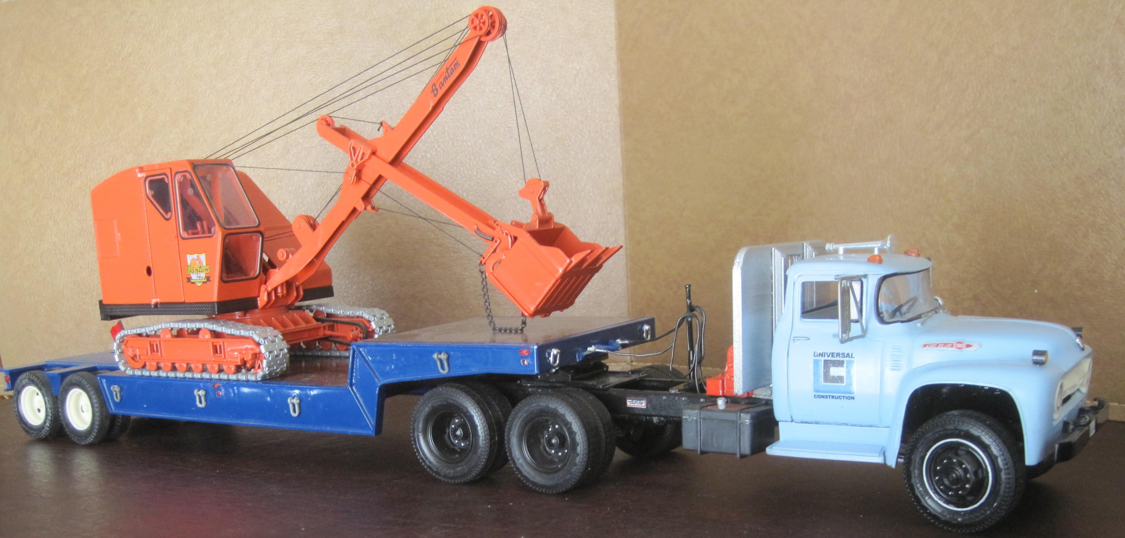

leafsprings Posted January 14, 2023 Author Posted January 14, 2023 (edited) On 1/9/2023 at 7:46 AM, Joe Nunes said: You might want to go for a scale boom height of 13' from the ground or lower if you can get it. Great point! The Bantam shovel boom is supposed to lower thru the key hole. The load measures approx. 8" high, which translates into approx. 17' in 1:1. Your right, way too high! This photo shows a much safer transporting position. Edited January 14, 2023 by leafsprings 1

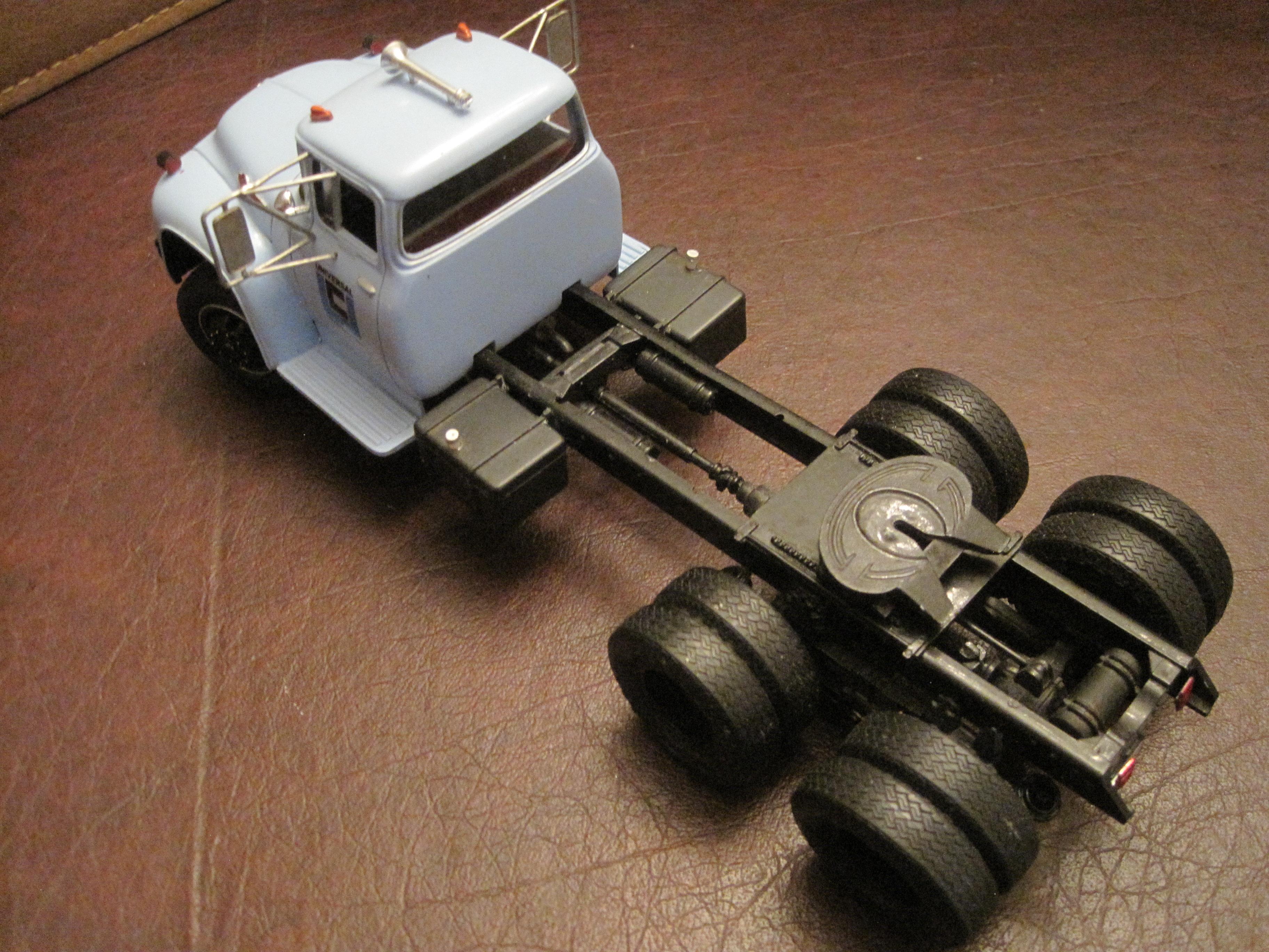

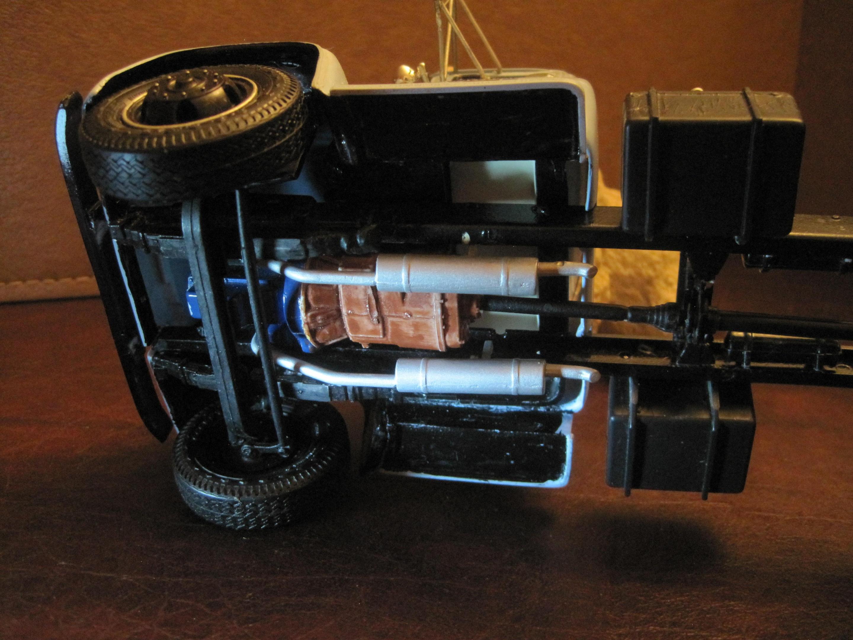

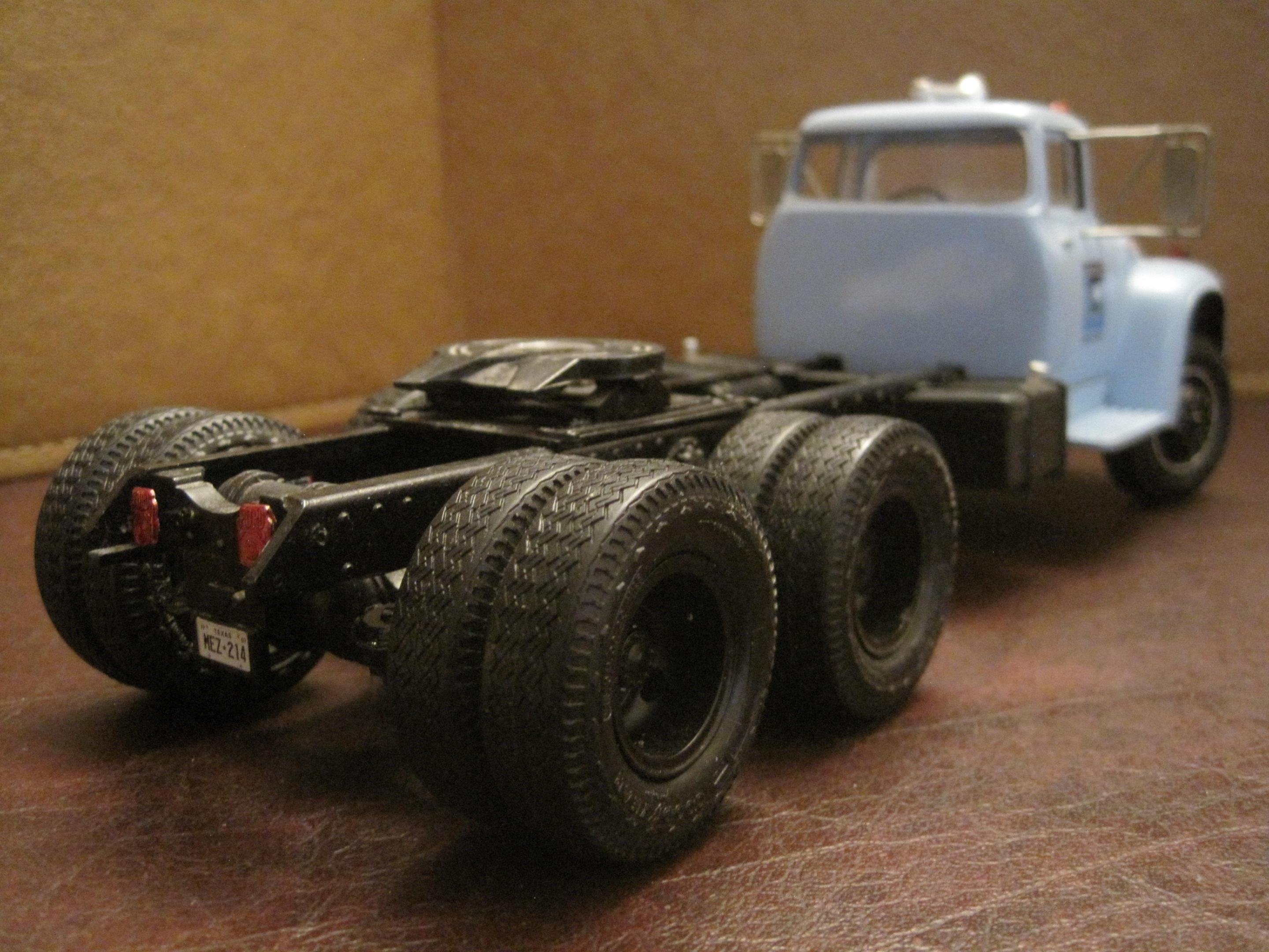

leafsprings Posted January 14, 2023 Author Posted January 14, 2023 (edited) Underneath shot. Research shows the 534's were actually installed in '56 and '57 prototype test models before the official introduction in '58. Edited January 14, 2023 by leafsprings 1

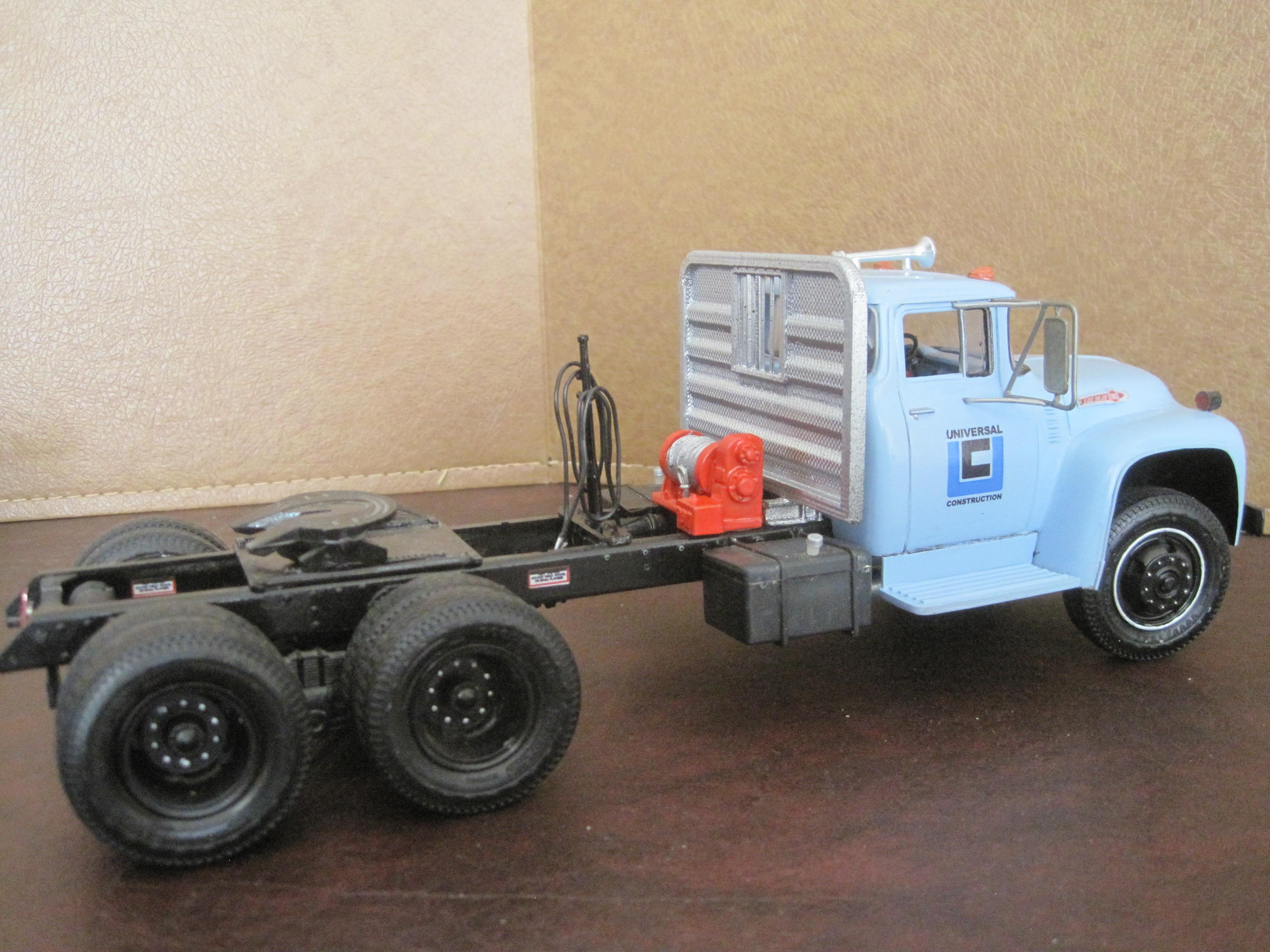

leafsprings Posted February 25, 2023 Author Posted February 25, 2023 (edited) Added a headache rack, winch, air lines and more cargo clamps on trailer for a more functional unit. Still working on trying to lower the boom height? Edited February 25, 2023 by leafsprings
