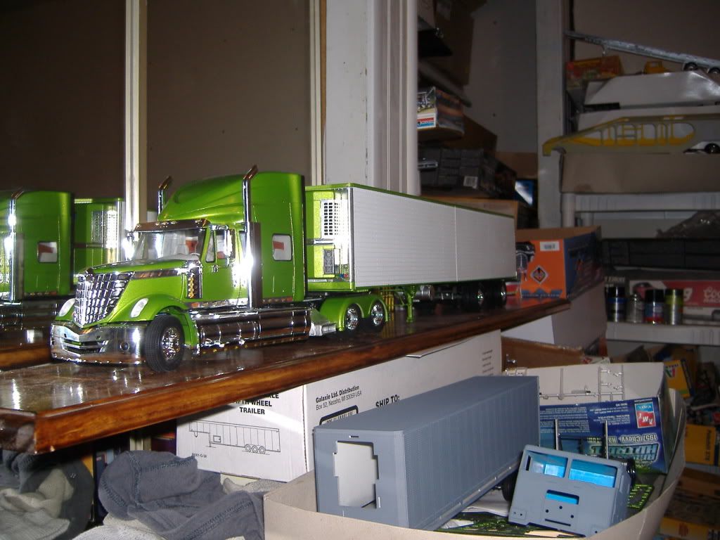

I guess!?!? I did this Challenger with the Custom Lacquer Hemi Orange and didn't think the metallic in it looked bad at all.
