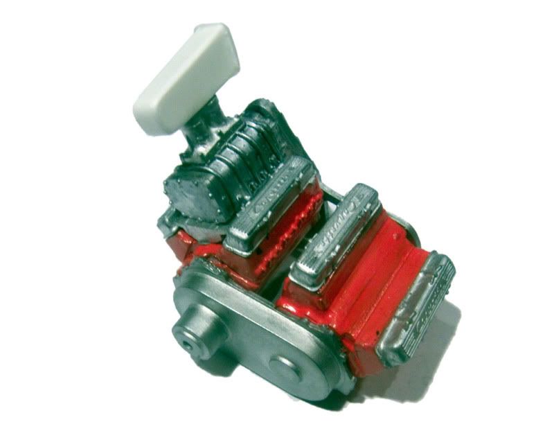

I would be interested in seeing a couple of shots of the bottom to get an idea of how the engines and transmission are put together.

...I would be interested in seeing a couple of shots of the bottom to get an idea of how the engines and transmission are put together....
The engines are connected using a chain transfer case. Here's a picture I have of the setup:

The enghines are connected using a chain transfer case. Here's a picture I have of the setup:
Very cool, thank you.
