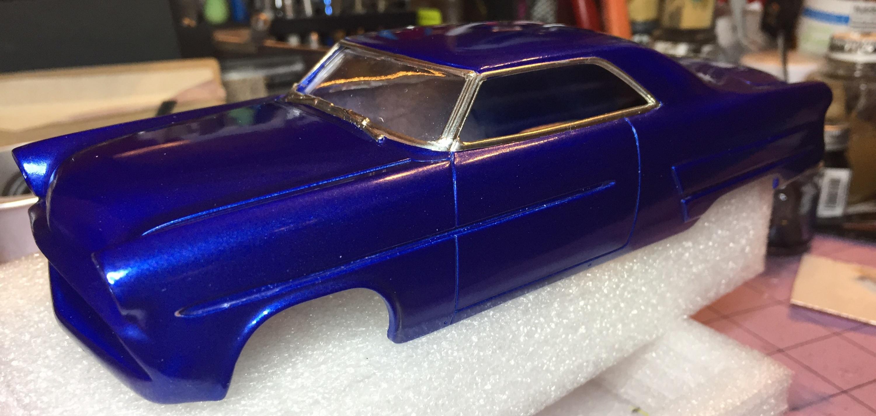

TODAY....I polished out the upper body and tried some home-grown decals. I also cleared the nose; gotta give that a day or two before wet-sand. While mocking up I discovered some fit issues that weren't there before ?. Anyway, I screwed up a couple of my decals by trying to cut them too close...sometimes it may be better to leave a little extra unprinted film.... another do-over on the way. ? Thanks for looking ?

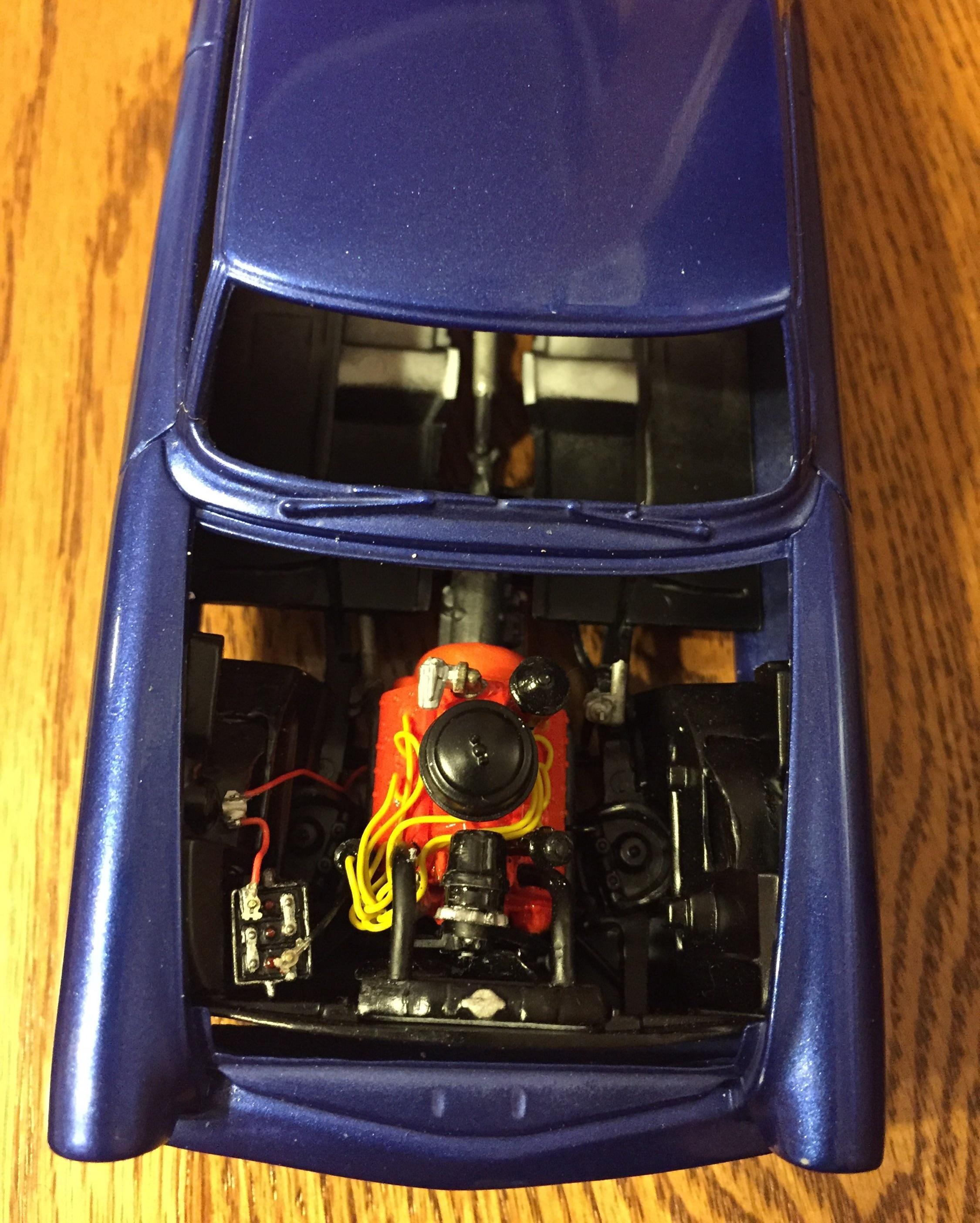

I got the wheels detailed and "mounted" for a mock-up with the engine in place. Engine is mostly wired and fuel line at the carbs is in place as well as the heat riser tube and the vacuum advance was "installed". I sunk a brass wire between the quads to mount that monstrous air cleaner in a removable fashion (seemed like a good idea ? ) because it hides all my eye-straining detail work ?. I need to do something about the carb linkage but I just haven't got the ambition yet. The elements involved in that are just too small for my 70 year old hands. I seldom build OOB because I feel compelled to do all the detailing and the issue becomes "if I add plug wires then why not the fuel lines.... and brake lines and then why not the carb linkage... and the battery cables and solenoid ...and on and on....I have to draw the line somewhere. I simply can't do all of it and that frustrates me. I'm venting, ? sorry. Also, I got the interior panels painted but not detailed . There may be a change of plans on the exterior color. I saw that '62 Chrysler under glass today by Tommy124. That color would look fantastic on the Riv. I have a few bottles of Boyd's Dusty Rose and I think it might work really well for this build.(I don't know what Tommy used but that's what it looks like to me.) I added "wheel cylinders" to the backing plates and drilled for brake line and parking brake cable placement. I thought about the bleeders but figured that would be completely insane. Anyway, thanks for your patience ?y -

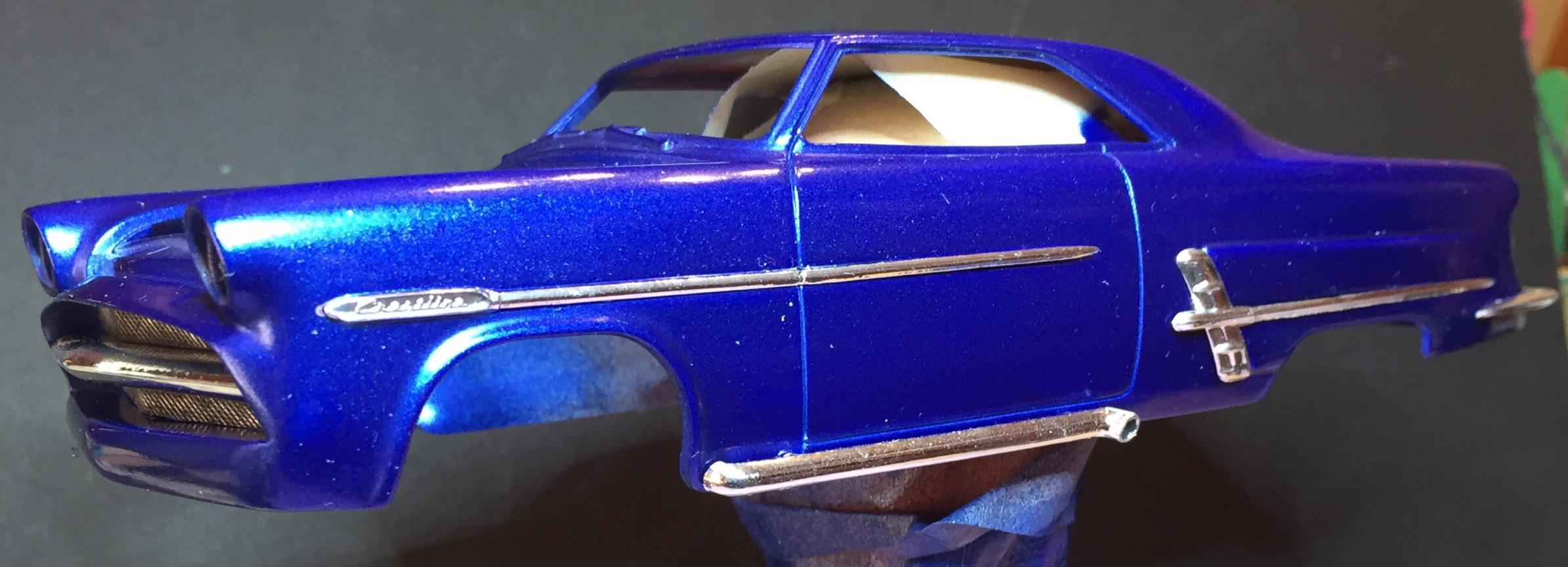

Well, thanks for talking me off the ledge, Dave. ? There was a time when the body would be painted yellow as well as the rest. I had a bad experience with my home-made decals and it gave me second thoughts about yellow messing with decals printed on clear paper. White or silver or a very light gold shouldn't be a problem. The can of Tamiya white pearl I currently posess (and was saving for a special build) might have made it to this project had I not started the '66 Riv. I've had that can sitting on the shelf for 2+ years and the Riv will get that paint job. So the red- headed step-child got the $2.00 can of Duplicolor I scored from Ollie's a few weeks ago. ?. I tested one of my decals on the silver and there won't be a problem regardless of what color decals I apply. I wish I hadn't used that one though. I only made 1 set of each type . Today the sun is shining and it's 64...gotta go clear the body!

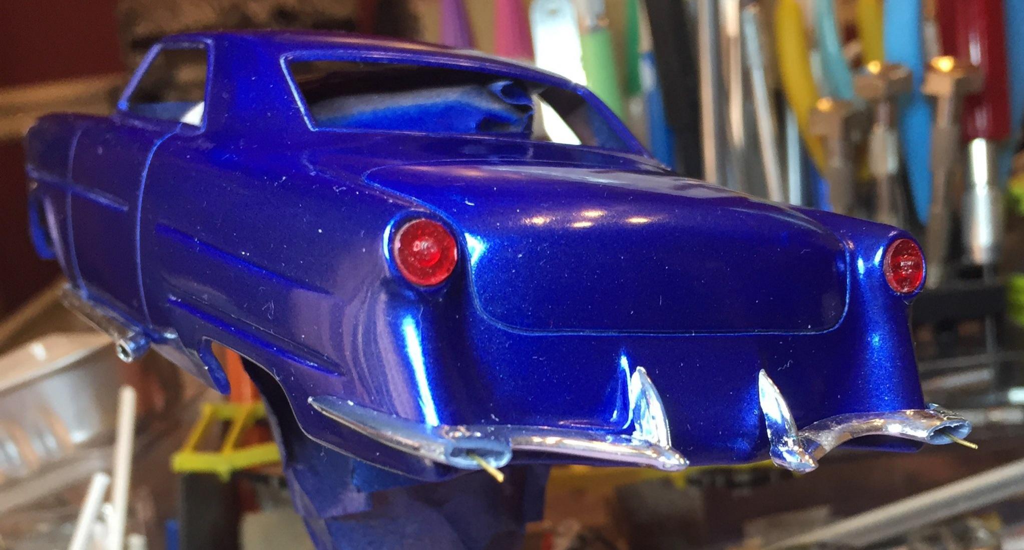

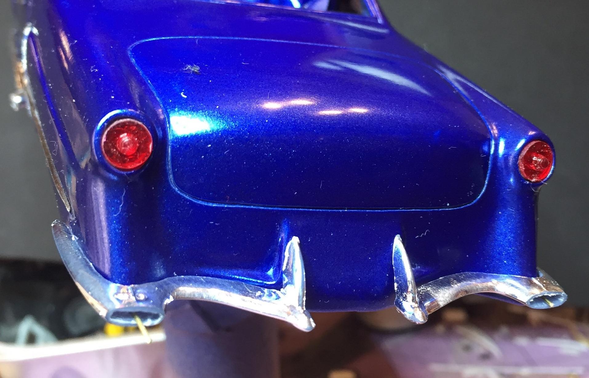

Nope. 86 the 'Vette tail light. Not gonna work. It was a great idea but I couldn't make it look right. Bummer. It's getting either '41 Plymouth units or some other nondescript things I picked out of my chrome junk. It's gonna work, though, trust me...? Today I painted the upper shell (for the second time ?) with Duplicolor (see below) and this time I will be covering that with Krylon gloss clear, out of necessity, and again after decal placement. Gotta do it all before the green dust flies because I paint out in nature ?. I'm getting there, but it's not easy these days ?. Thanks for looking. Still some decisions to take.....stand by....

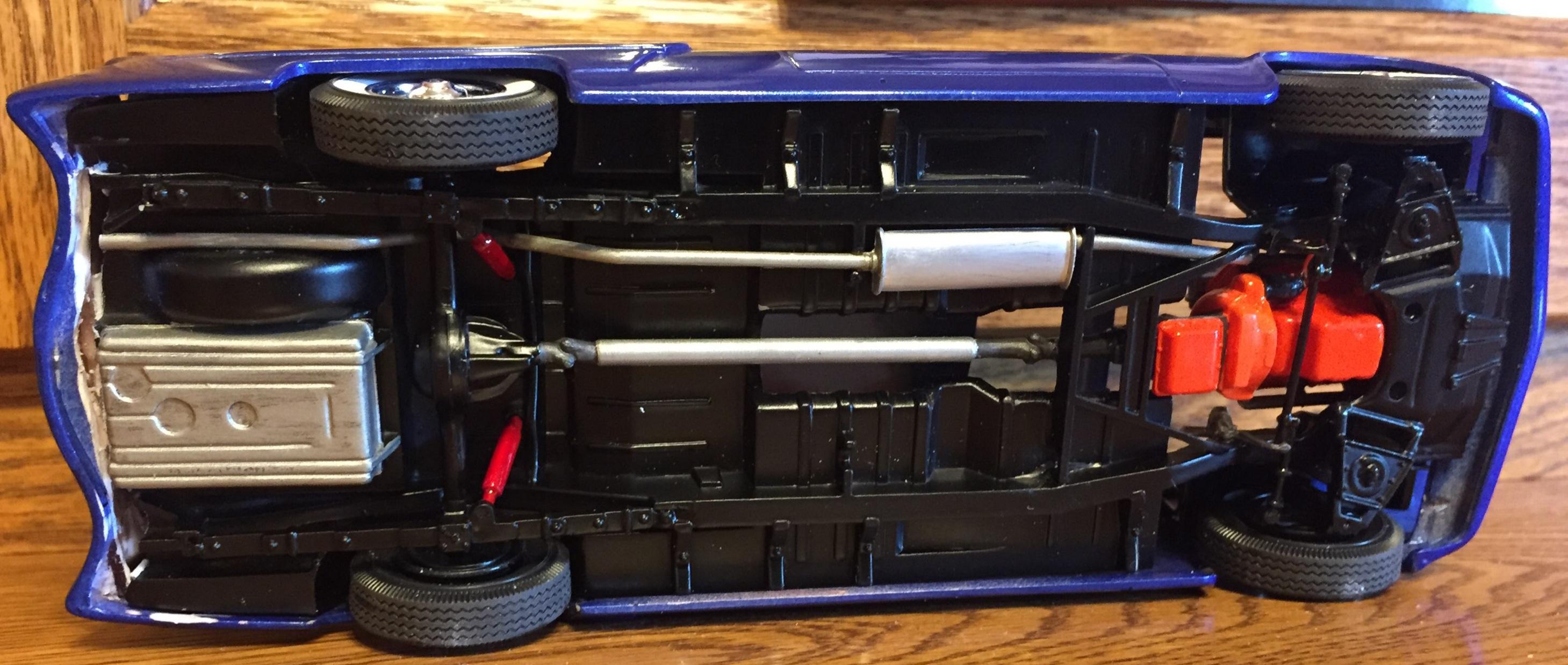

I tried to find reference pix of the chassis/underside of the Riv for brake line routing but there isn't much help out there; only a little for the rear axle housing so I worked with that (most live axles would use similar positioning. ) the rest will just be WWJD (what would Jimbo do?) The exhaust follows the "spine" so, if I want the line to show in a logical way, I'll have stay off the side of the frame behind the pipes. Suggestions encouraged ?. I glued a small piece of angle, with a hole to accept the flexible line, to the inside frame rail and attached a drilled block to the axle housing and connected them with black insulated 30 guage wire. It ain't perfect (in scale the block is about the size of a Marlboro box) but I drilled it through for the solid line to go through. Not easy for me to work with tiny stuff like that at my age. ?. A little detail painting and we're good. By the way....because this build will be slightly altered from a showroom stock rendition but is still basically out of the box, I feel it's time to create a proper acronym for this type of thing. This is a BOOB....Basically Out Of Box. ☺️
