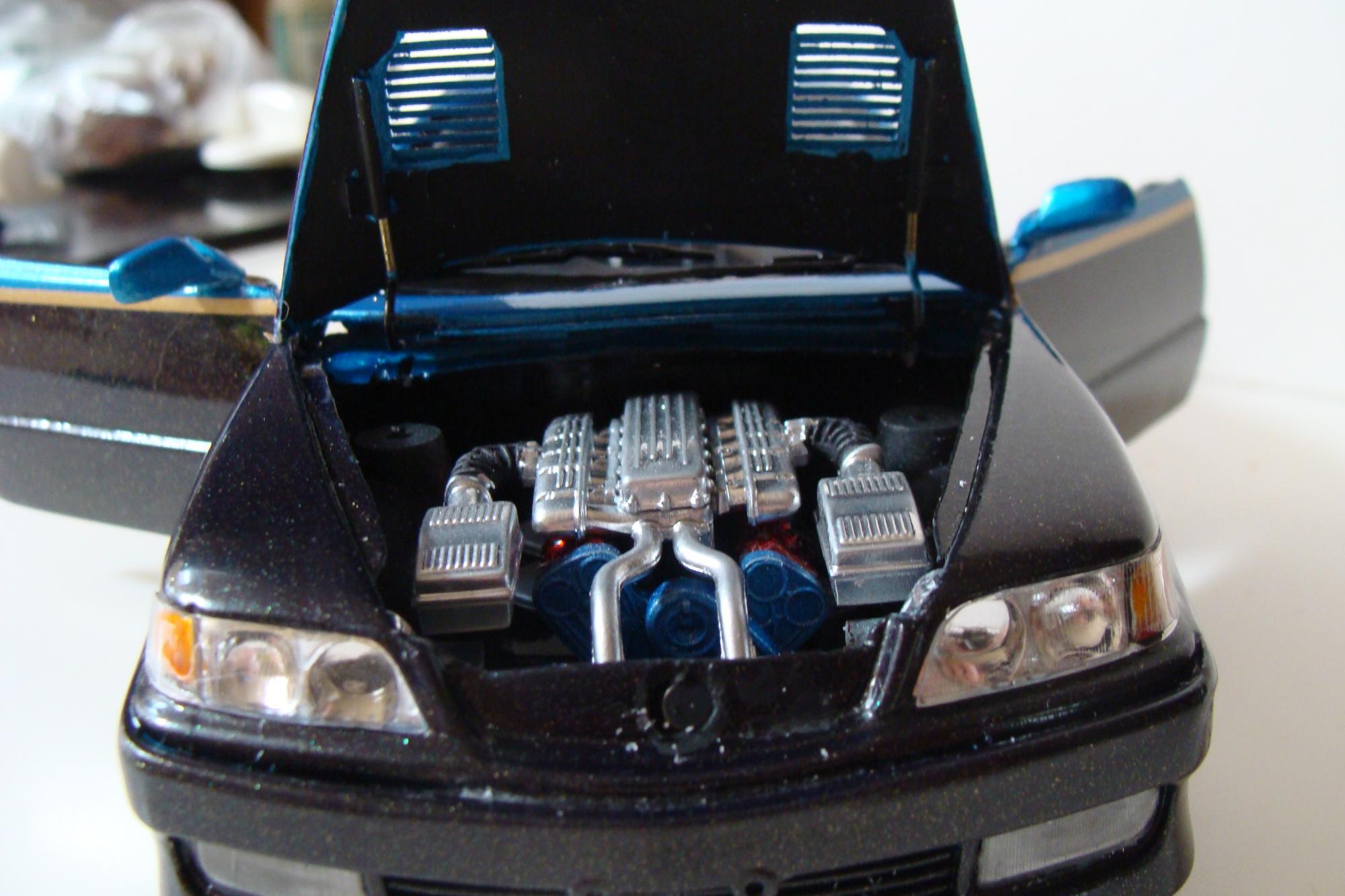

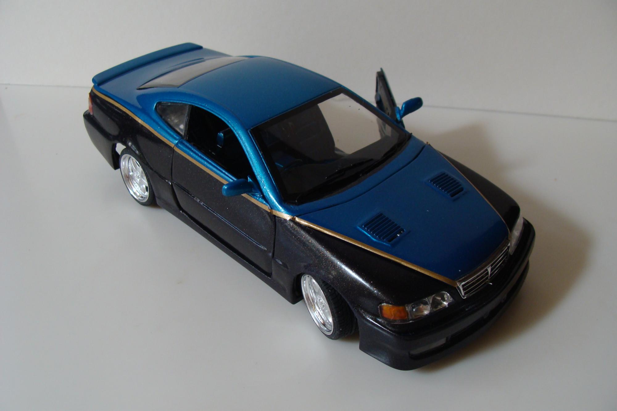

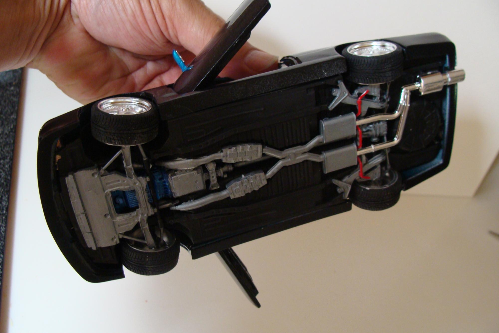

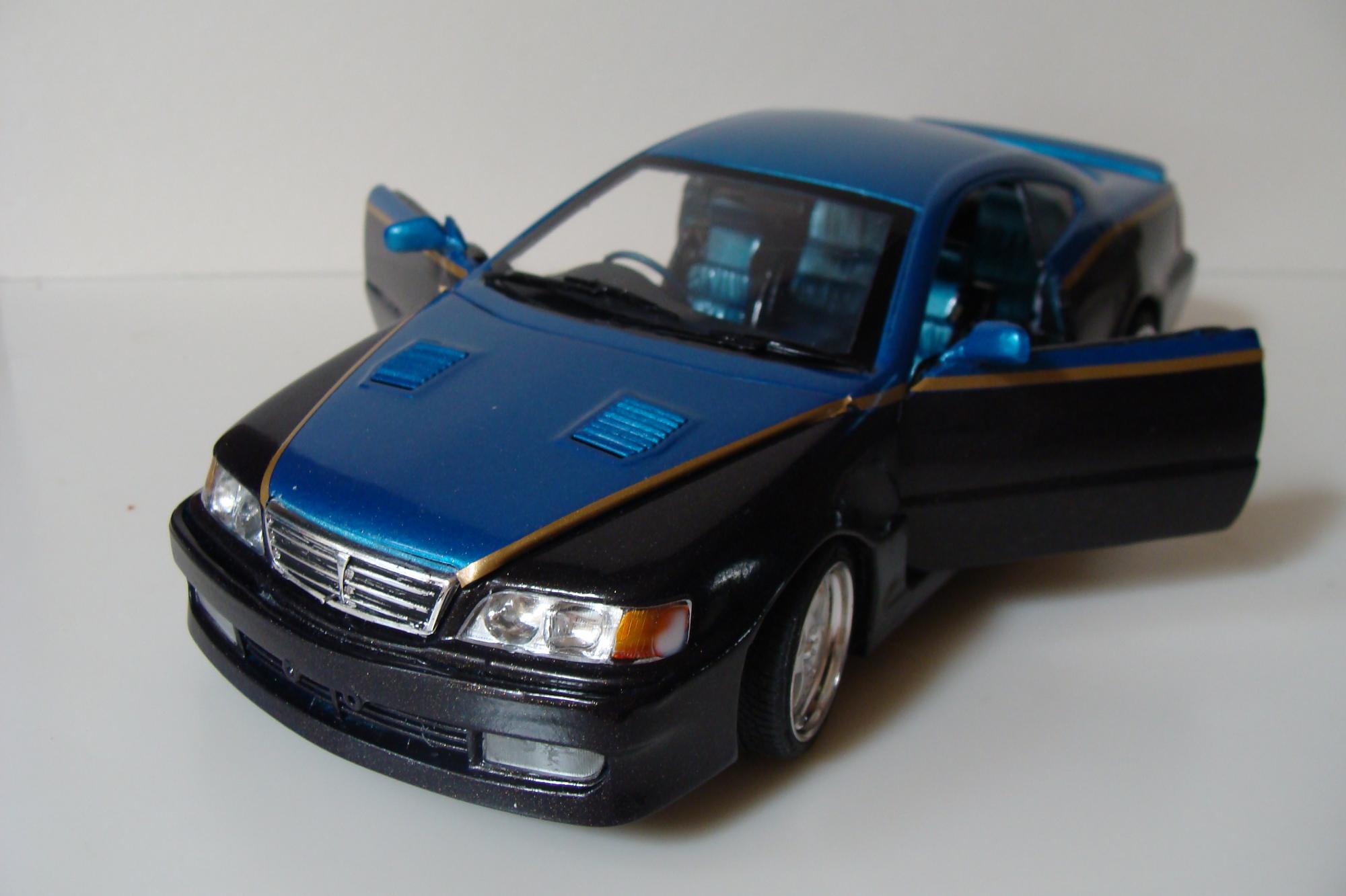

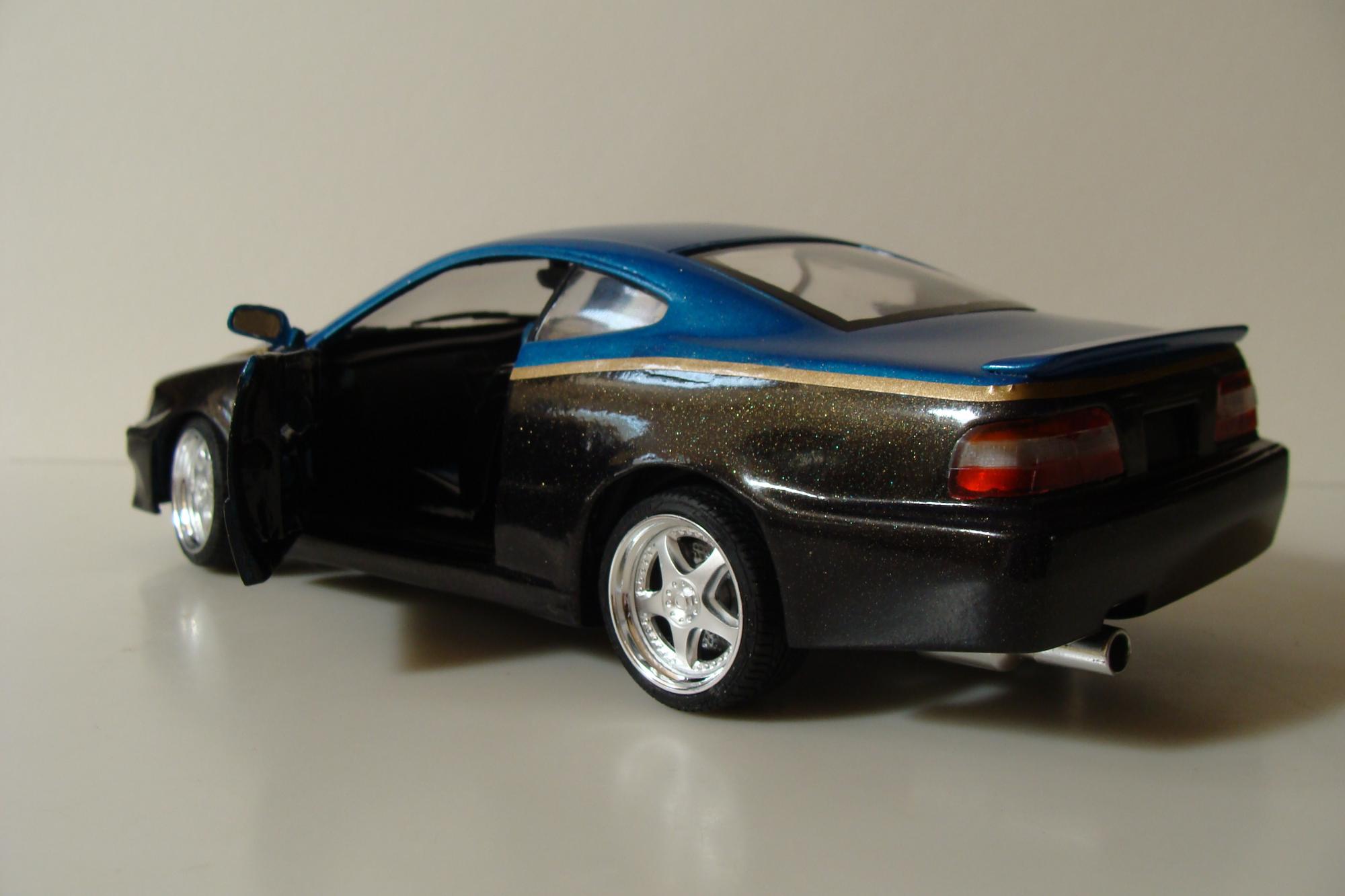

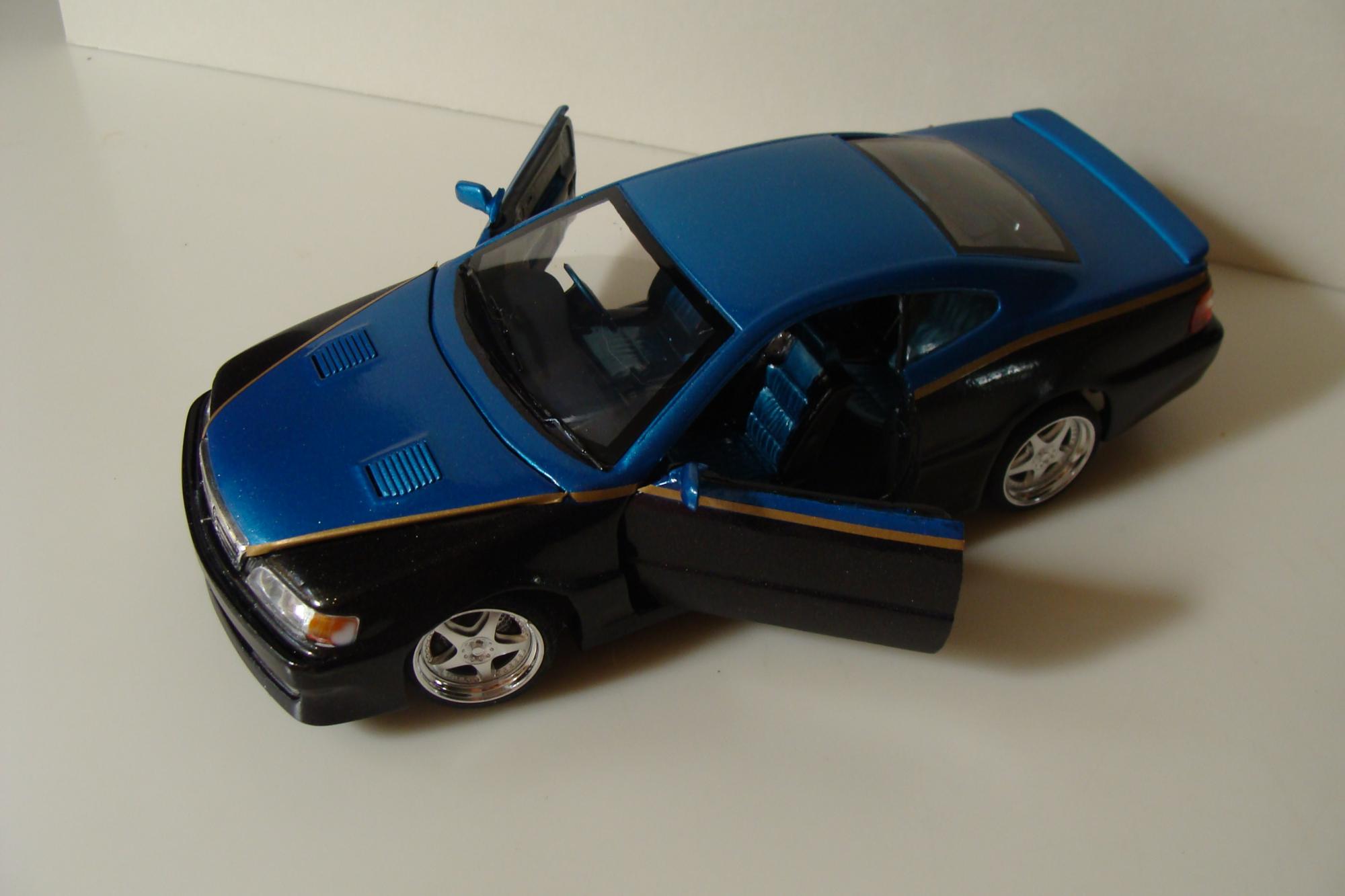

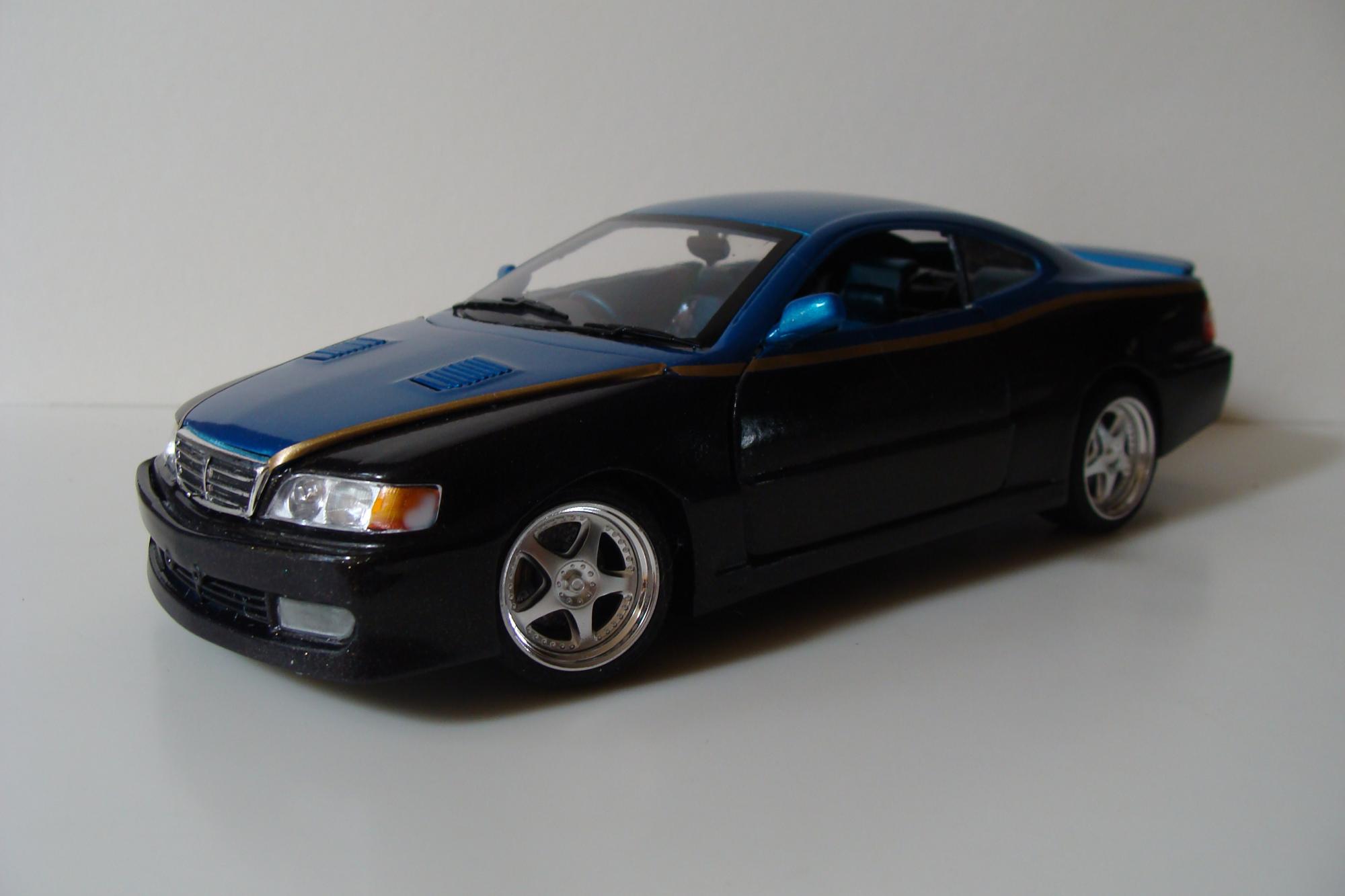

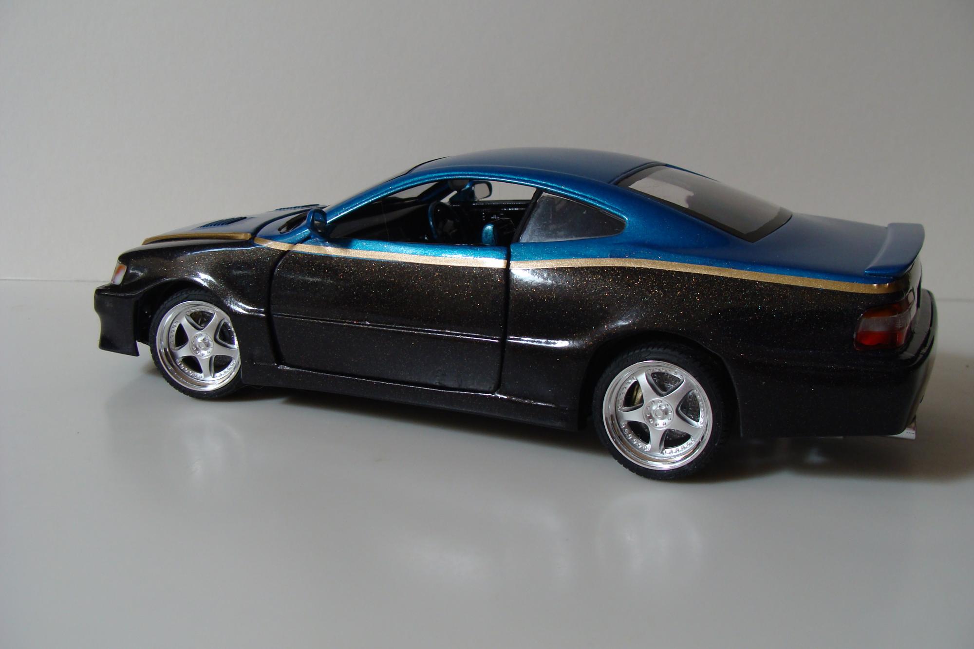

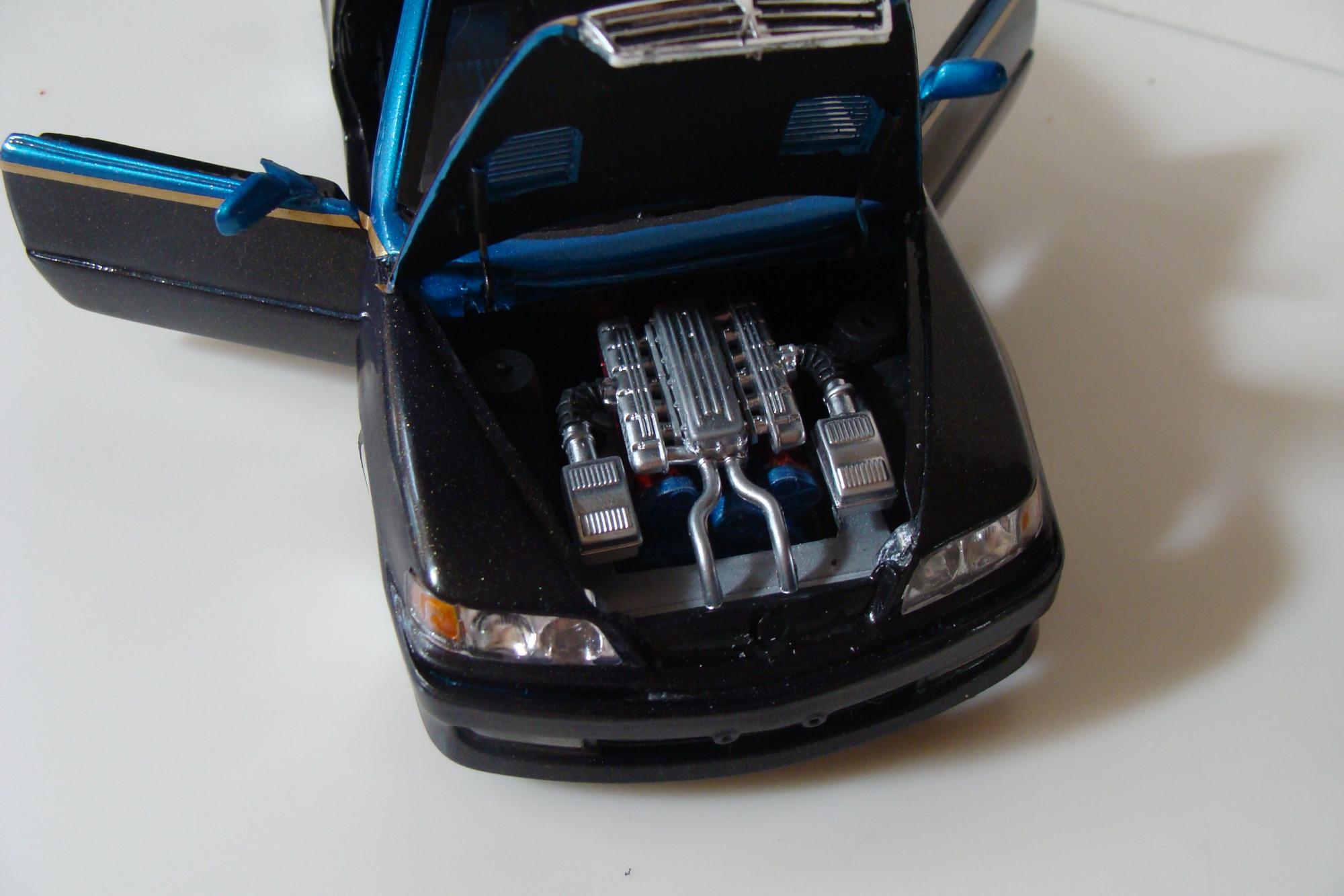

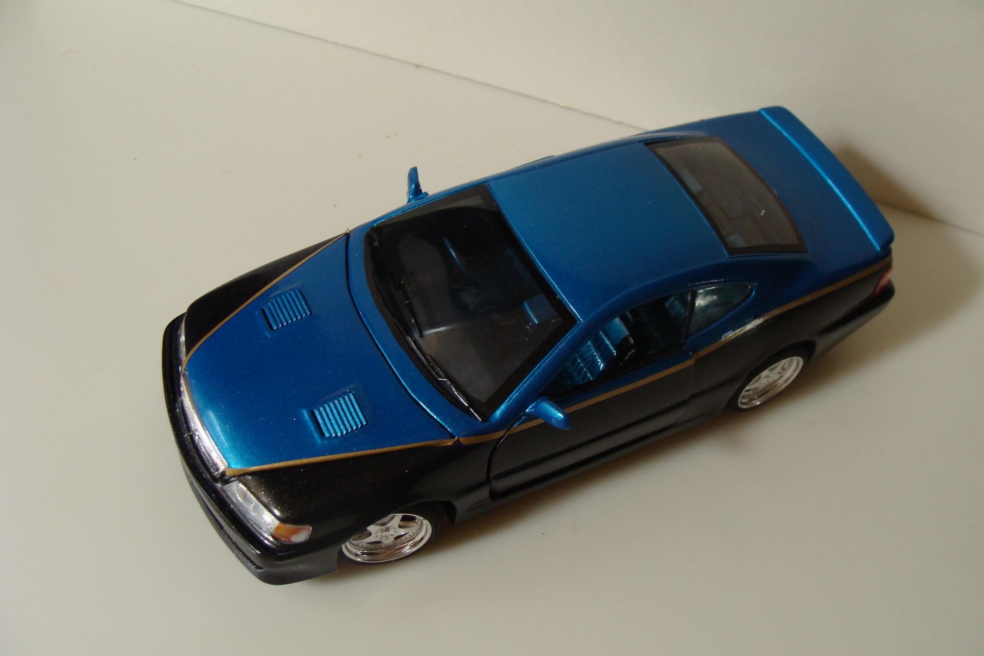

Just completed ( so new, the glue on the left front turn signal lens is still not dry and no license plates on it yet ) Nissan CIMA 4 DR / Infiniti Q45 4DR with a Ferrari roof grafted on. Doors opened, hood opened, Ferrari V12 under the hood. Photo etched hood louvers installed. Painted Bahama Blue Metallic on top, with Black on the bottom. Then topped with clear blue with gold metalflake mixed in. Then that was topped with clear with a little gold flake mixed in and then all topped with clear.....rubbed out with wax and a gold vinyl pin strip added at the color break line.

After thinking about whether to open the hood on this or not for about 3 seconds, I realized that if I took the time and effort to open the doors, it would be incomplete to not open the hood......so last night after we got home from a beautiful fireworks display, I set about opening the hood. If was actually a difficult task. One, the plastic used in the Nissan Cima is rather tough and brittle. The styrene used by Revell on the Ferrari ( the roof ) is much softer and easier to work with. So because of the toughness of the styrene, cutting out the hood was a slow and arduous task, especially at 11 pm after a tall Bourbon and soda. And because I wanted to leave some of the hood on the car just in front of the windshield, creating the curved line where the back of the hood ends was very tedious. I had to build up under the cowling an "under support" shelf for the top of the future firewall and to make a seamless lower edge for the windshield to butt up against. The radius of the Nissan rear hood did not match up with the radius of the Ferrari windshield so the outer edges need to be we-worked. You can see all of the putty necessary to fill in the side rear edges. Also the lip on the rear edge needs to be cut and sanded down to the height of the hood. To complicate this a little more, I changed the side edge and opening of the hood. On the Nissan, the hood open line is out near the edge of the front fenders, but on this model, I wanted to mimic the size opening that the Ferrari has, so I cut the hood open along the strong hood contour lines, very similar to the hood on the Ferrari. I may, or may not have the grille open with the hood......just not sure how this will work and where the hinges are going.....If the hood opens to the forward, then the grille is on the body, if the hood opens to the rear, then the grille can be attached to the hood. You can see the doors are taped in place, and still need a fair amount of shimming to get all the seams to line up correctly......note the huge gap below the A pillar and the front top of the door here, that needs to be corrected, as do most sides, but not to difficult to do. Once the putty dries, I can sand everything smooth and get the hood and doors hinged and set about dropping the engine in place. -

I made some headway on the Cima. I opened the doors, which was rather difficult because of the joint where the top connected to the body, plus, the car was a four door and I had to redesign the cut for a large door two door coupe. And to compound the issue, I added the kit supplied lower body cladding which also was designed for a four door sedan so the cladding needed to be cut and reshaped for a two door coupe. You can see the front and rear cladding here along with the side cladding. There is a rather sharp line where the cladding meets the body, which really doesn't bother me, but I did not care for the way the cladding is lower than the top of the wheel opening. I thought that looked odd, so I have added wheel arch extenders and filled the space above the extender with putty. I cut out the excess extender and sanded down the putty so there is a nice flair to the top of the wheel well that sticks out as far as the cladding. I think this gives the car a more uniform boldness. Obviously, the sanding is not complete yet on the wheel wells, but it is getting close. I have to sand out the doors yet and redo the hinges as I used a different style on this and I am not happy with it. I still haven't decided whether I will open the hood or not....but there is time before I have to make the decision on that. -
