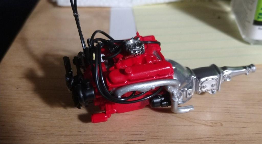

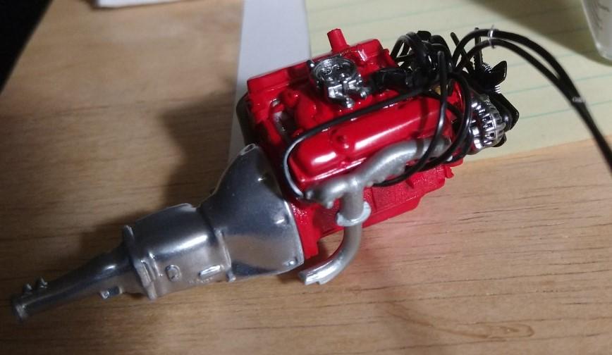

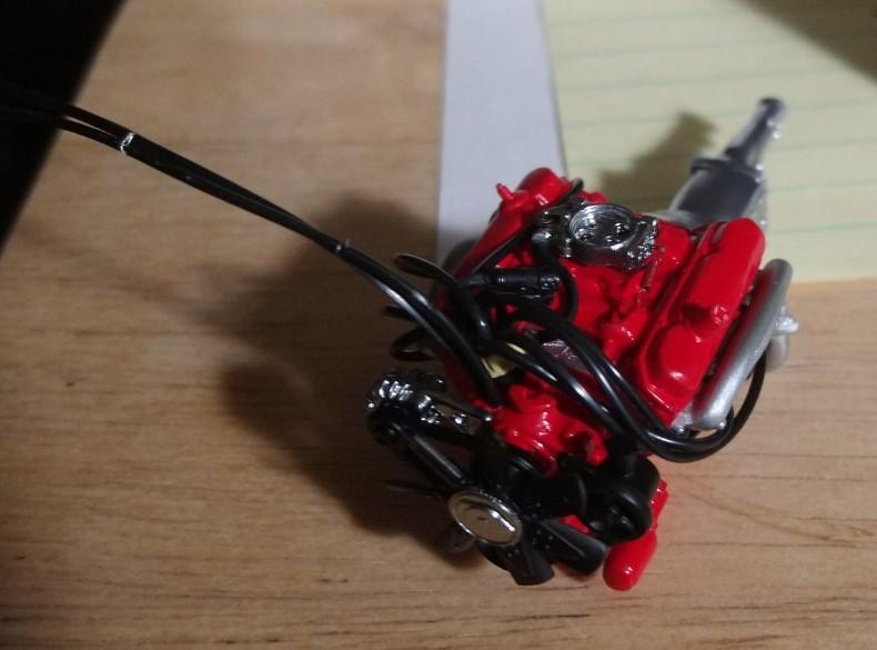

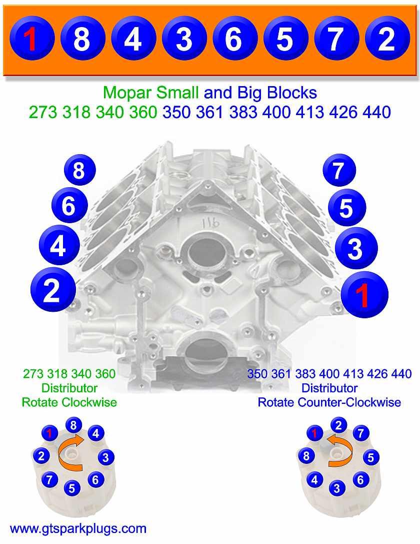

I got the wrong color anyway, its Chrysler engine red and I needed Chrysler engine orange. Ill have to rebuild another engine anyway because the stupid spark plug wires are to big. At least I got the firing order right. best regards, Steve. -

Thank you everyone for the helpful tips and positive reinforcement. Here are a few pics of the engine work so far. I think Ill have to break down and buy a wire set somewhere because the wires might be a bit to thick. I did get the firing order correct though I hope. Best regards, Steve -

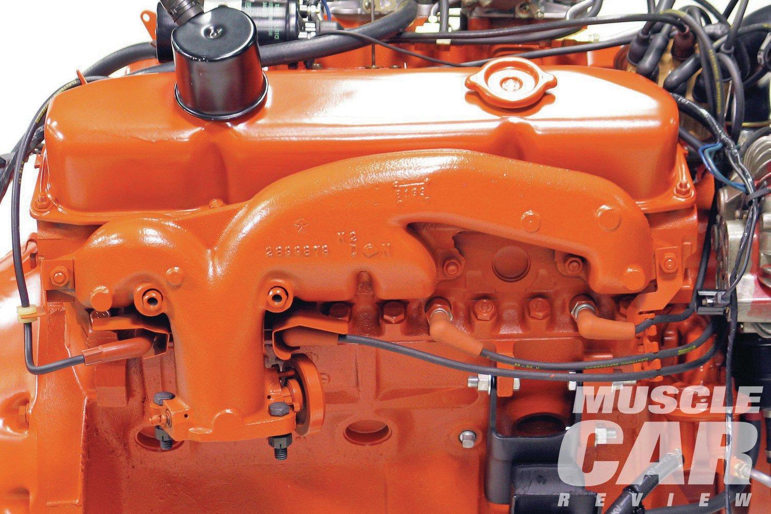

Hi David, thank you for the insight. Most likely I will do the exhaust manifolds like in the first picture. Now all I have to do is make some wires and plug caps. I have small wire mainly the phone wire size but with a solid core... the braided ones cant be bent so easily as the solid core type. I also noticed I'm going to have to make a small spring for the carb throttle, I think that's what is might be, I'm not an engine guy so Ill have to figure it out. It looks easier than a jet engine though. I will just have to see how far I can go with it. Best regards, Steve -

Hi David, here iare a few pics of what I found while I was trying to figure out the firing order and how the plug wires are to be run. -

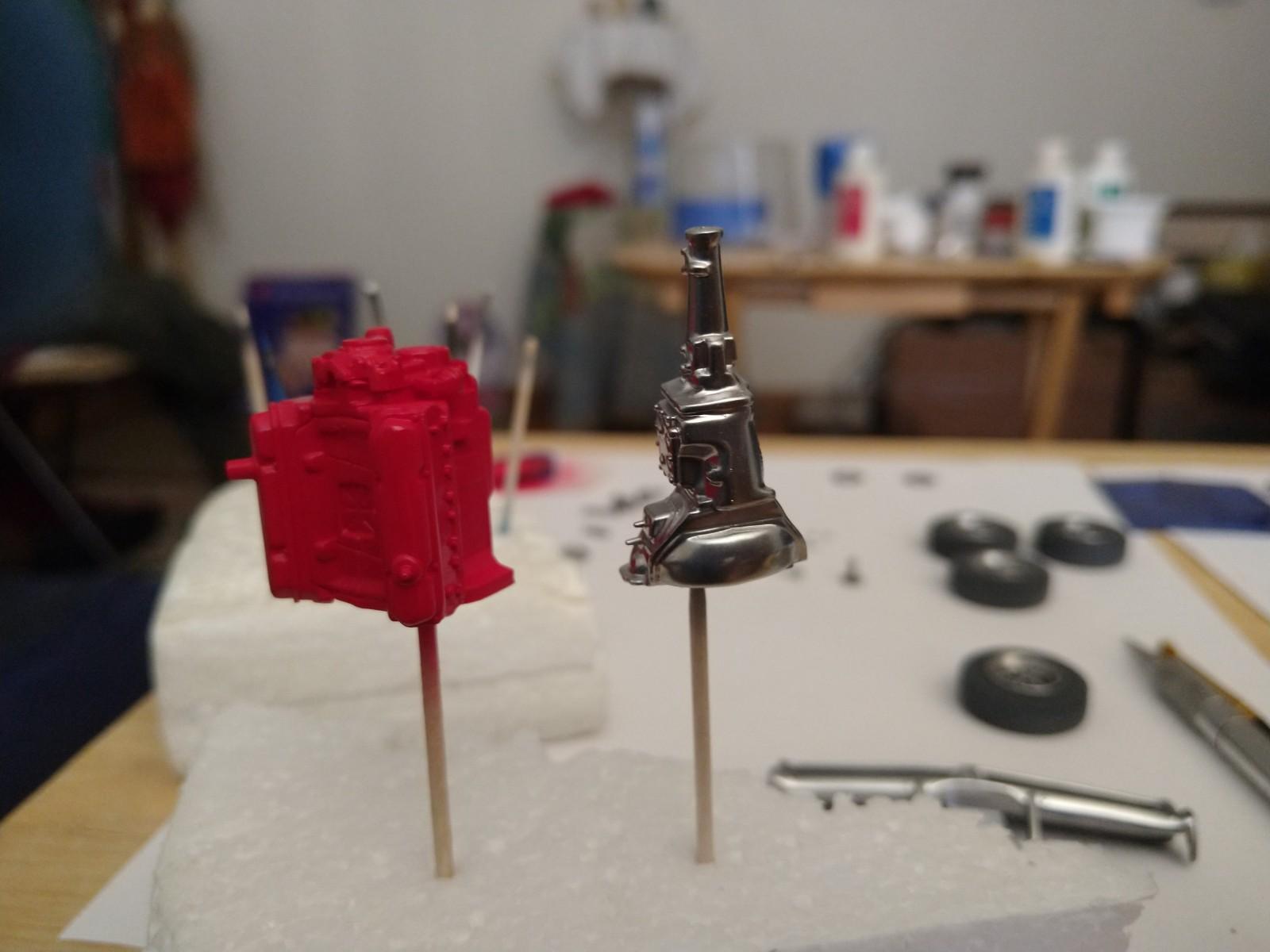

Engine work started. I don't know much about detailing engines but Ill give it a try. I'm going to search the forums to see what I can find. Engine painted Chrysler engine red, transmission is Alclad2 steel over Testors model master gloss white. It will take a few days for this stuff to dry. I wish I still had my dehydrator I gave it away to make deer jerky, the dehydrator dries enamel quickly but it can ruin a car body easily if you let sit in there to long. Steve -

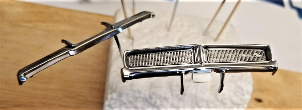

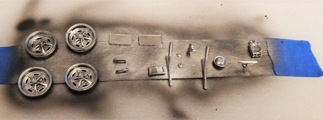

Thank you David, make sure you prime with Tamiya fine white primer first the scale finishes will not bite to the bare plastic. Then shoot your scale-finishes black base followed by Tamiya TS-13 decanted... thin it with Tamiya lacquer thinner and then spray light coats first ,wet sand 6000- 8000, polish.... clean off the polish then shoot your Alclad2 chrome.... finish sealing it in with Tamiya TS-13. That is how I did it, you process may differ, please test this process first before you apply it. Best regards, Steve -
