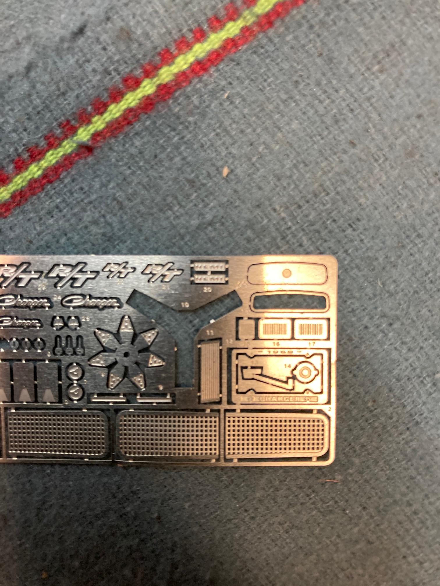

  1. Thanks guys! I finally installed the wiring harness to the firewall this evening, and I black washed the Hemi badges. I'm thinking that there's a possibility that I might use the R/T badges on the grille and rear panel as well if they fit properly. Steve

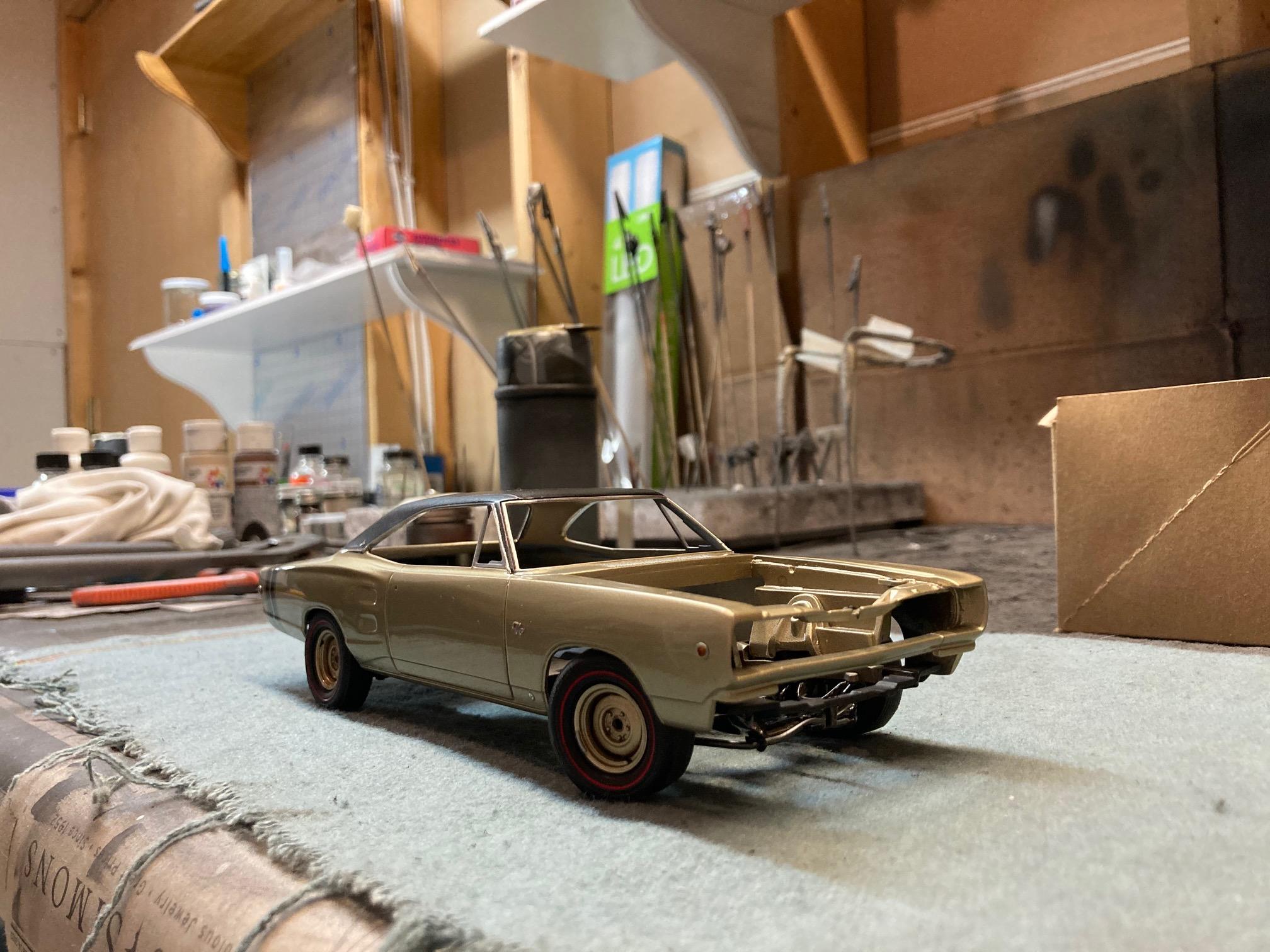

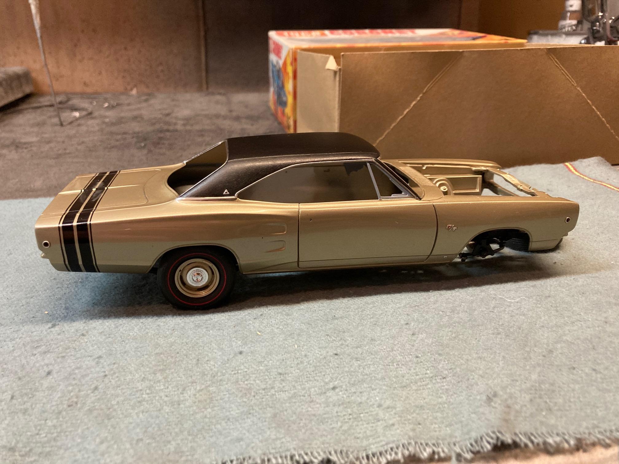

  2. Yes. I have a pair of Hemi badges from a Charger PE set. Had to get it up on the wheels one more time just to get a visual of where I stand. Steve

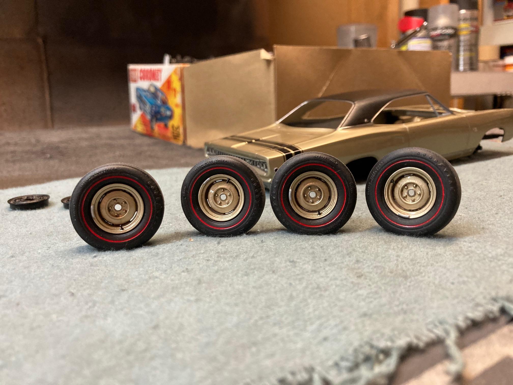

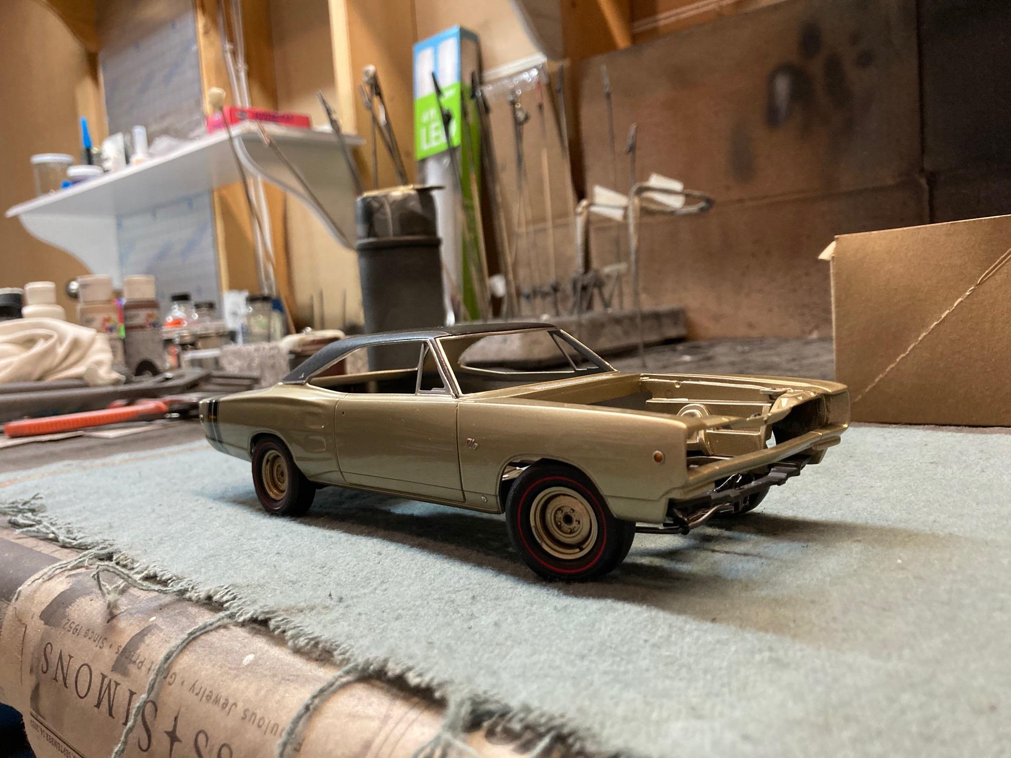

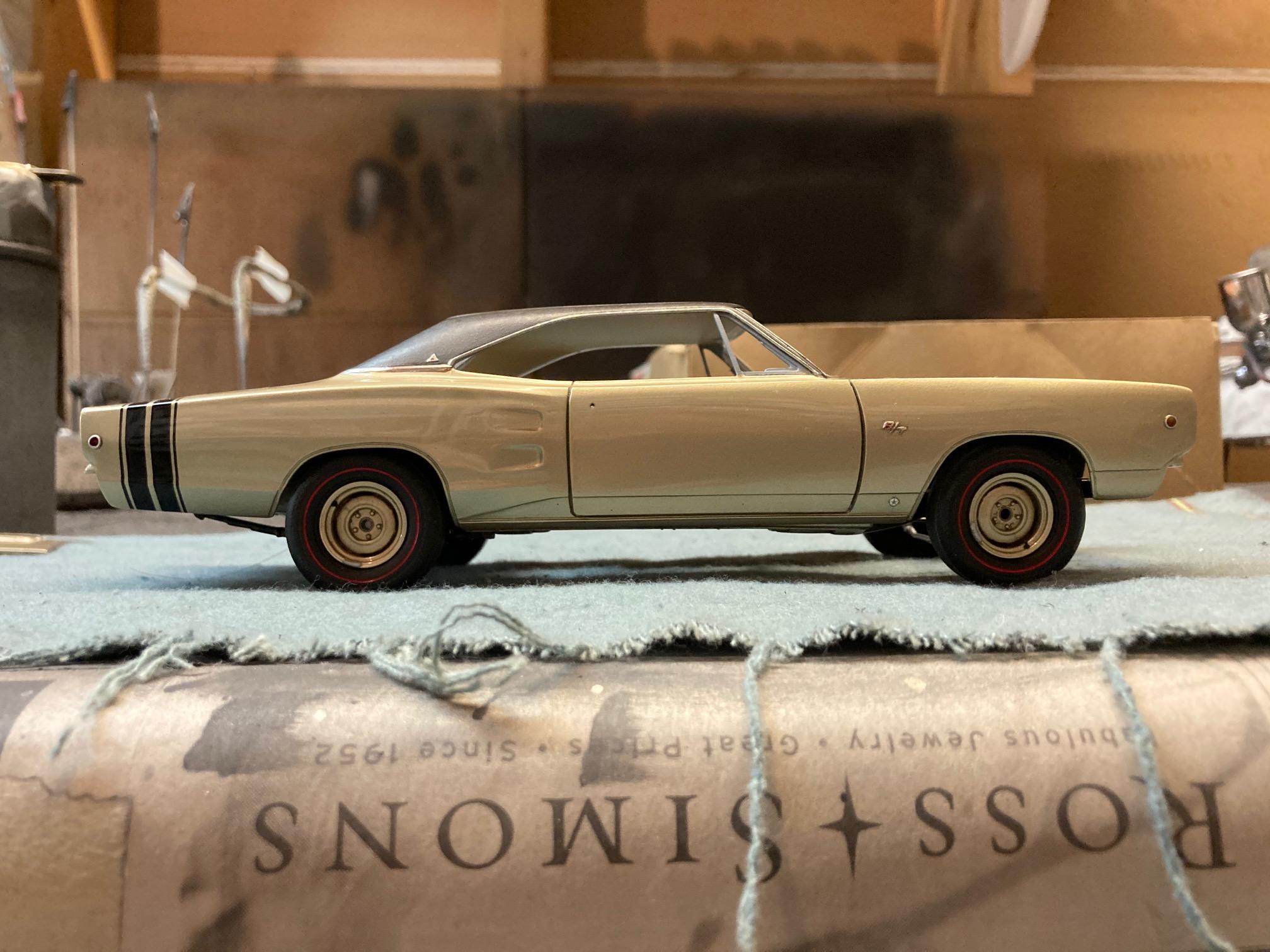

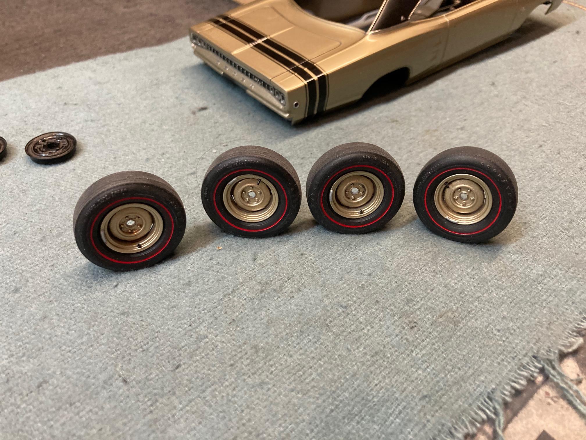

  3. Thanks guys. Started working out the lenses for the side markers today, as well as detailing the wheels and finishing the red lines on the tires. Steve

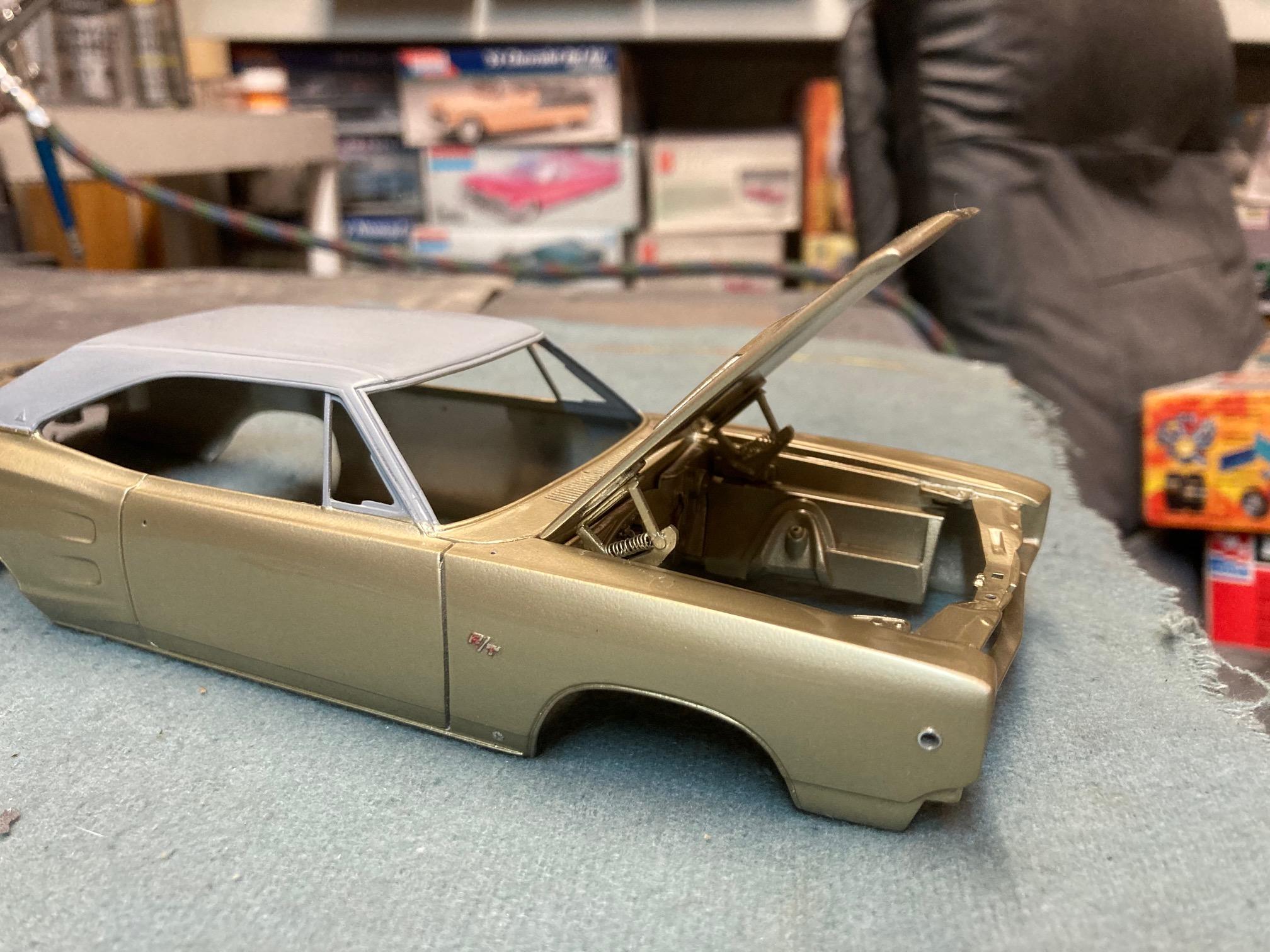

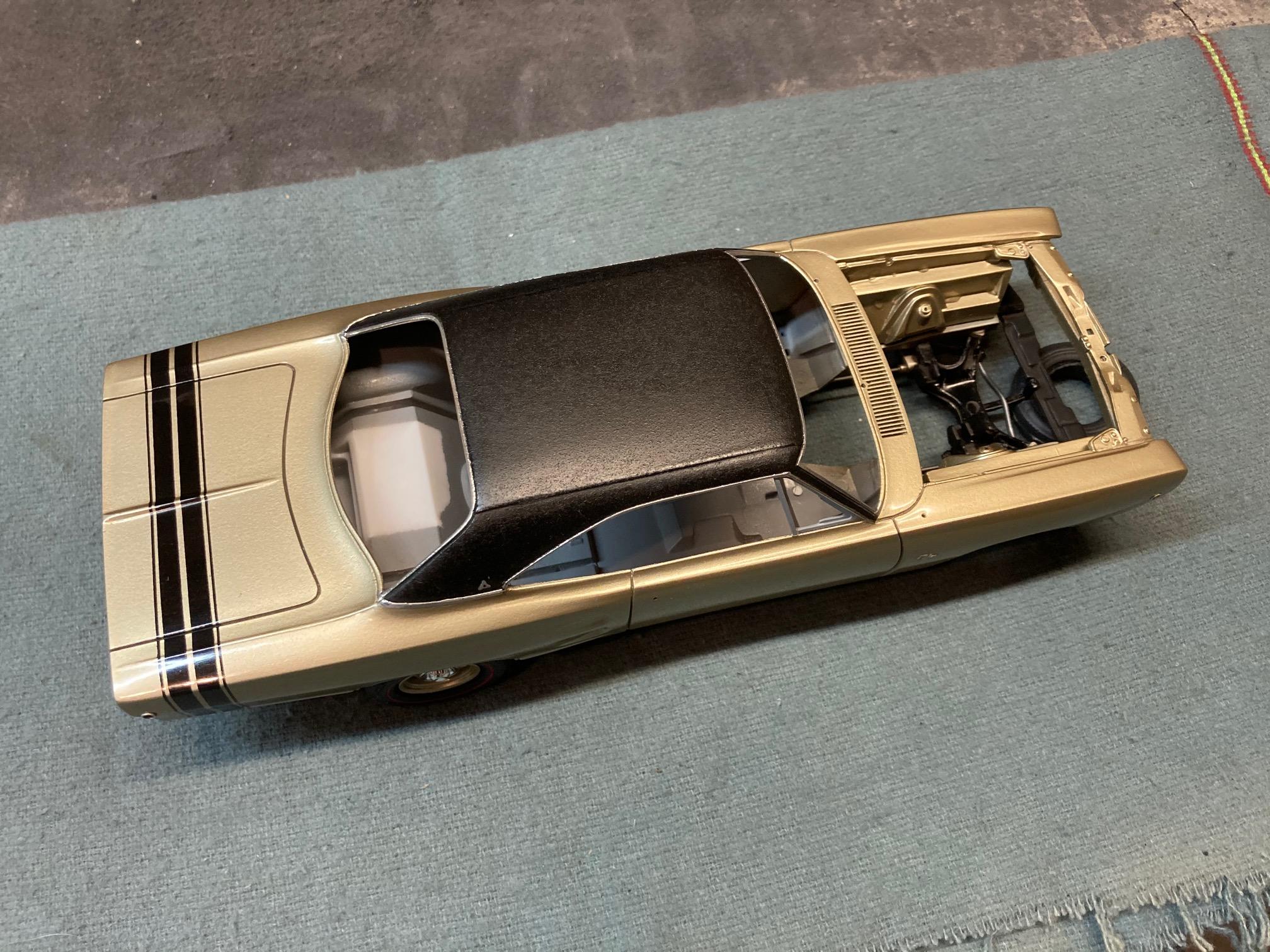

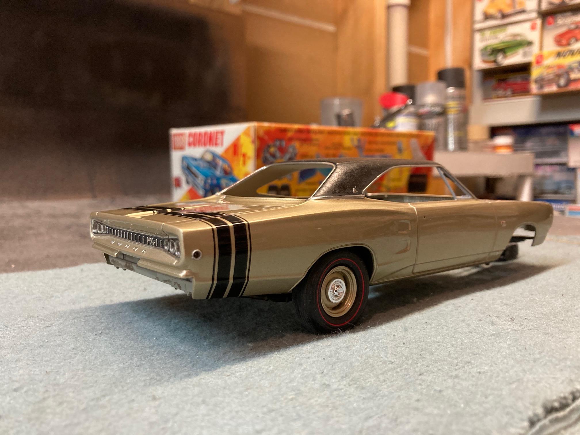

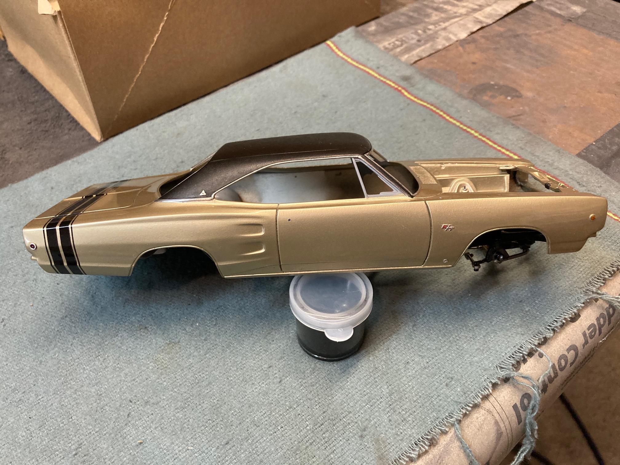

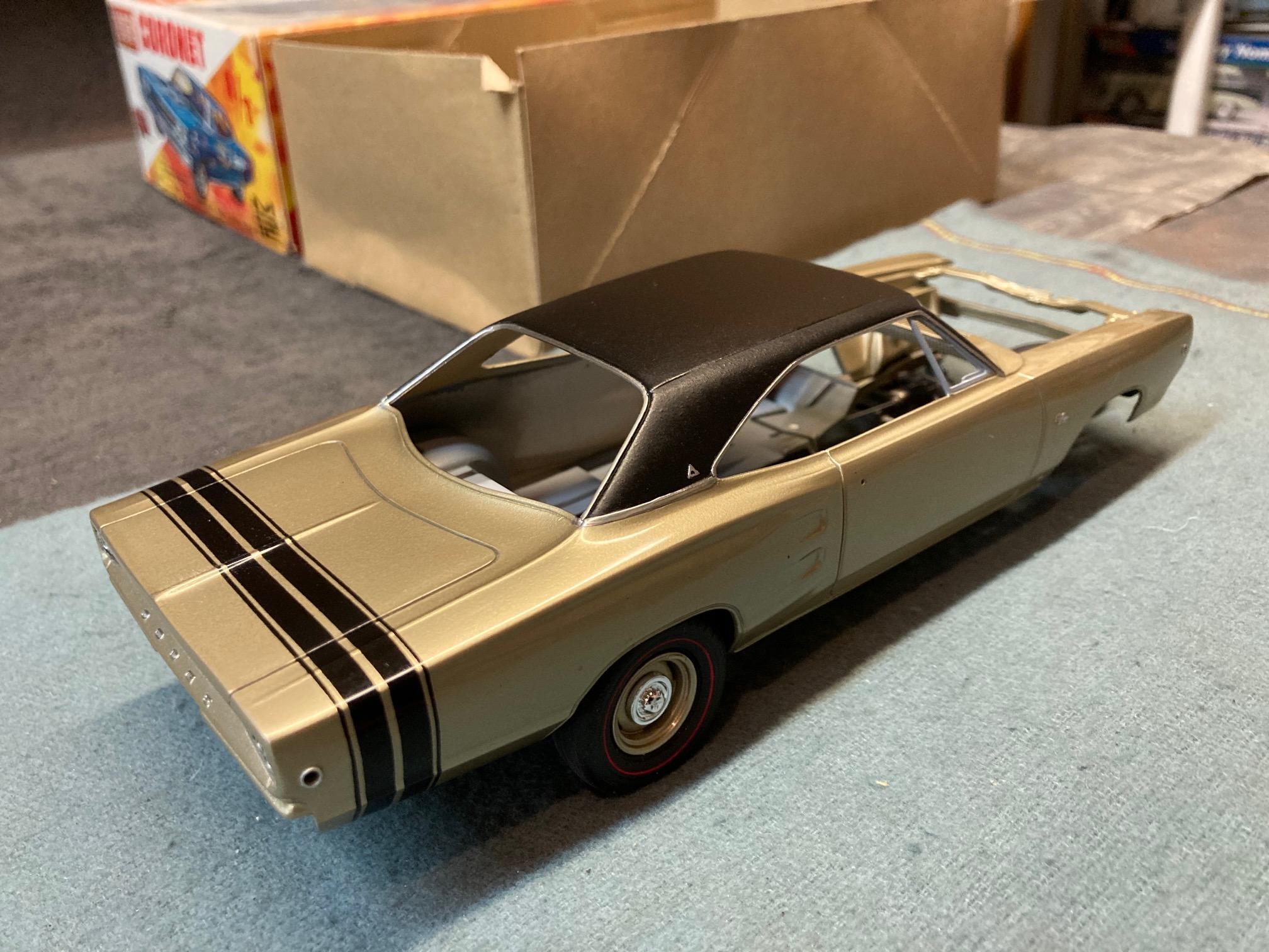

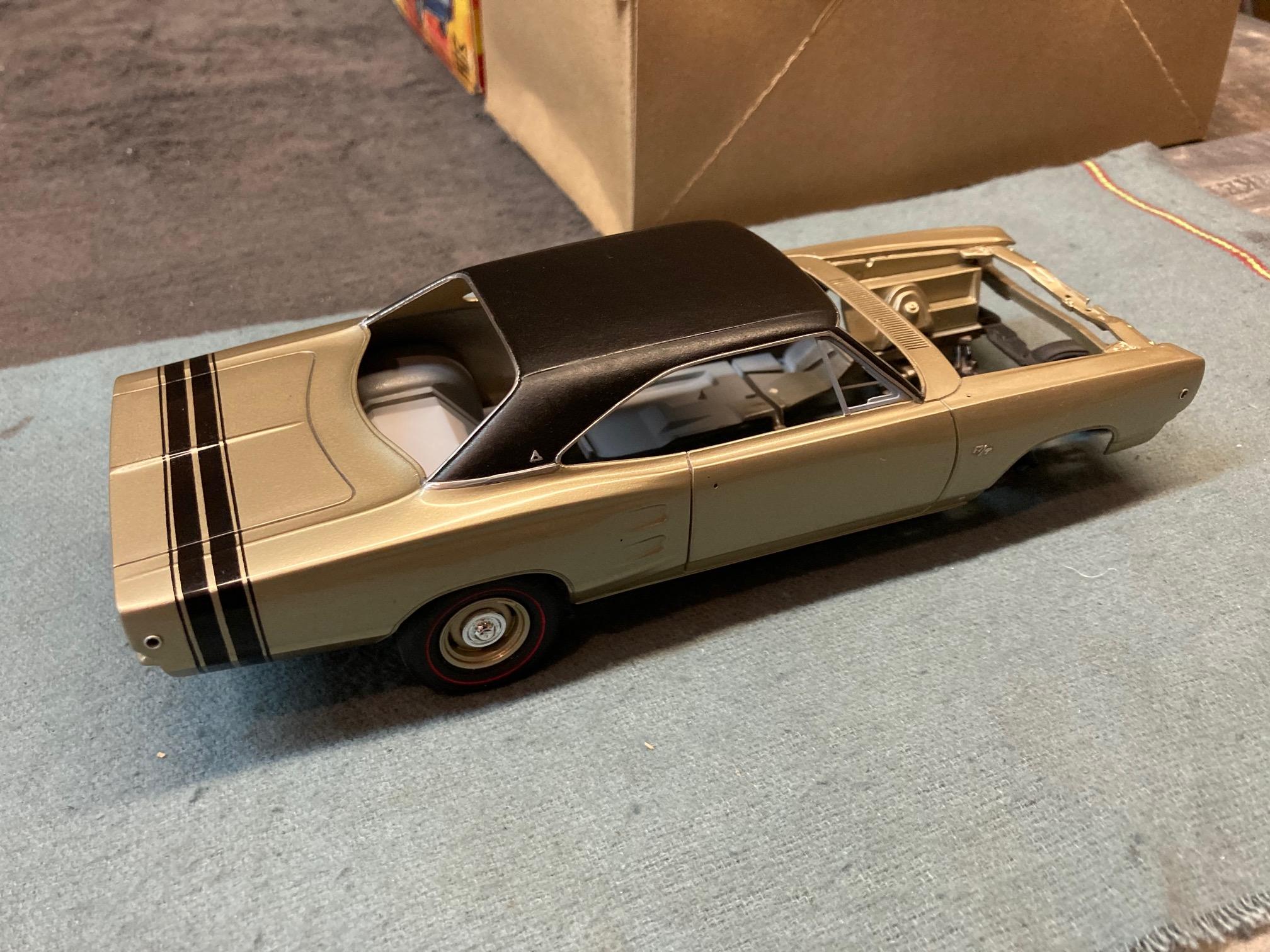

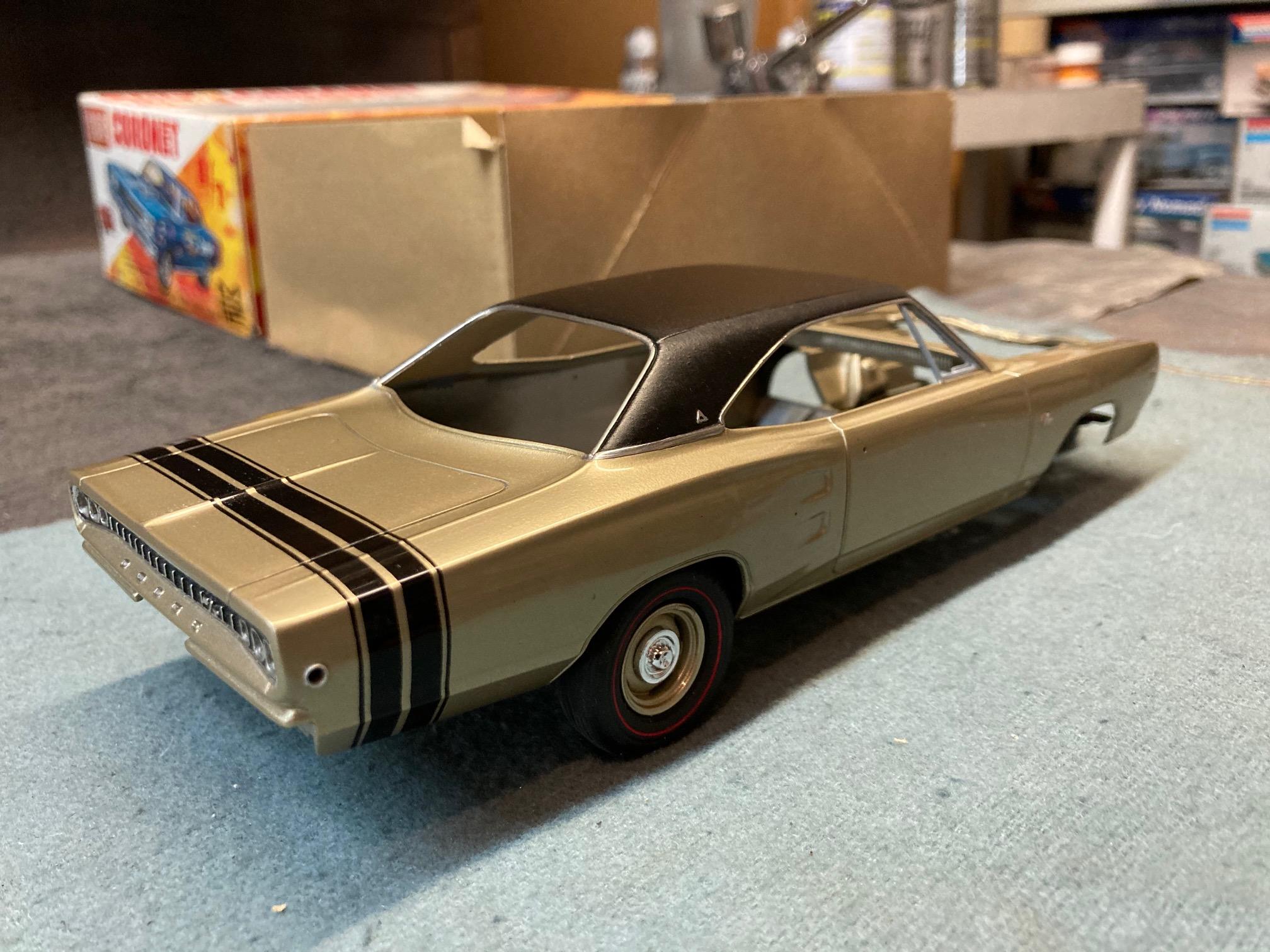

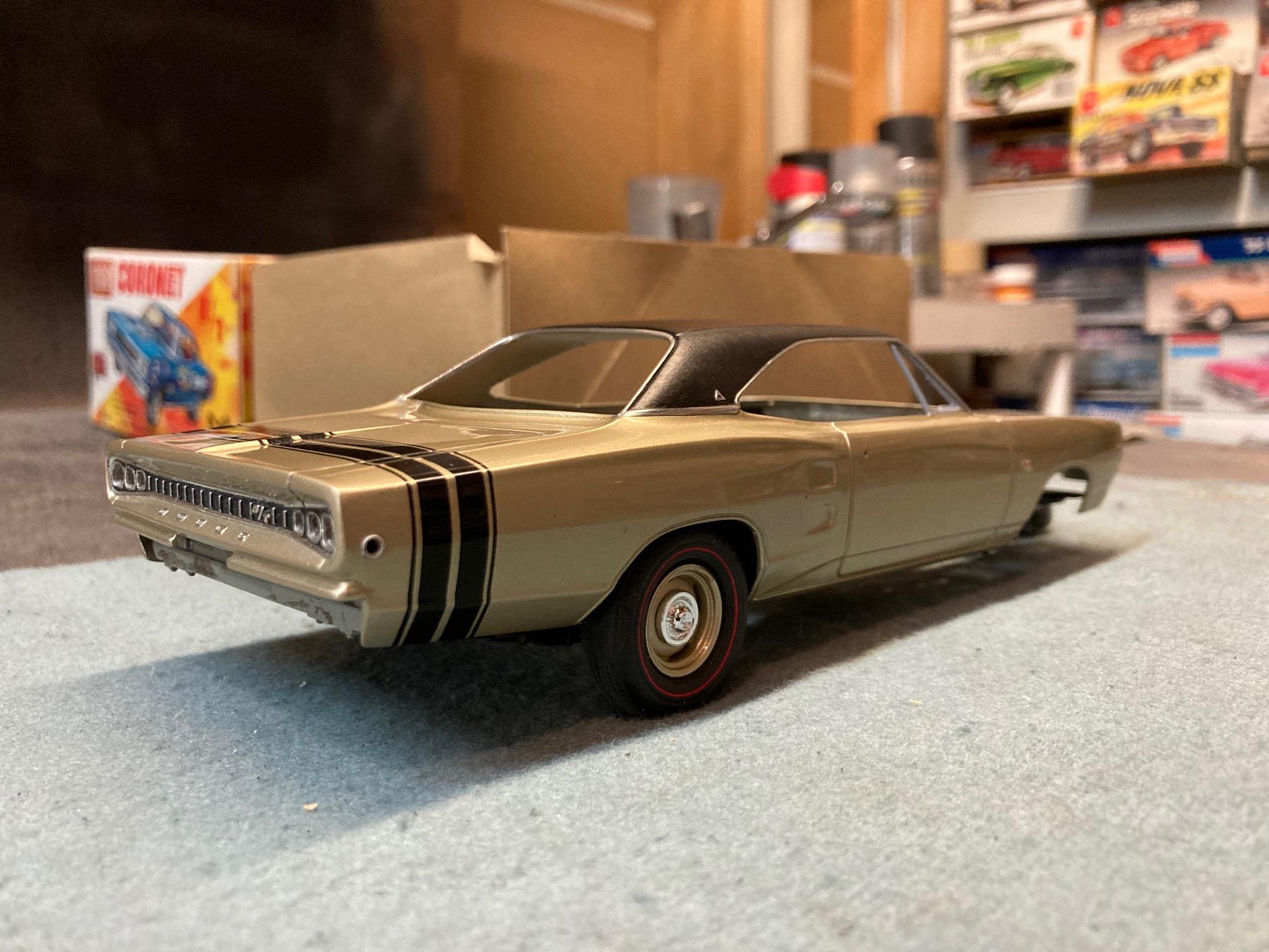

  5. Thanks everyone. After some contemplation, I decided that I wasn't happy with the finish on the vinyl top. It was too shiny for me. So I added a couple of coats of black primer, rubbed it down a little, and finished with a little Armor All. It's still a little blotchier than I would like, but then again, this model is supposed to represent a car that's a few months old, so it shouldn't be perfect. In any event, I like it better now. Steve
  6. Yes, this was already brought up earlier, but there’s no changing it now without a complete repaint. I’ll have to live with it. Steve
  7. Yes, I felt that it was too shiny as well. I’ve already addressed this by adding some more black primer over it. It might be a little more dull than desired, but I like it better. I’ll post a couple of photos later. Steve
  8. Yeah, I still have some of the old BMF. ? Steve
  9. Yeah, but that was just me experimenting. I had never used the MCW vinyl top paint before, and I thought it looked a little too shiny. So I sprayed another light coat of the black primer over the top........at which point it looked too dull. So I rubbed a little WD over it to help bring back a little of the sheen. Steve

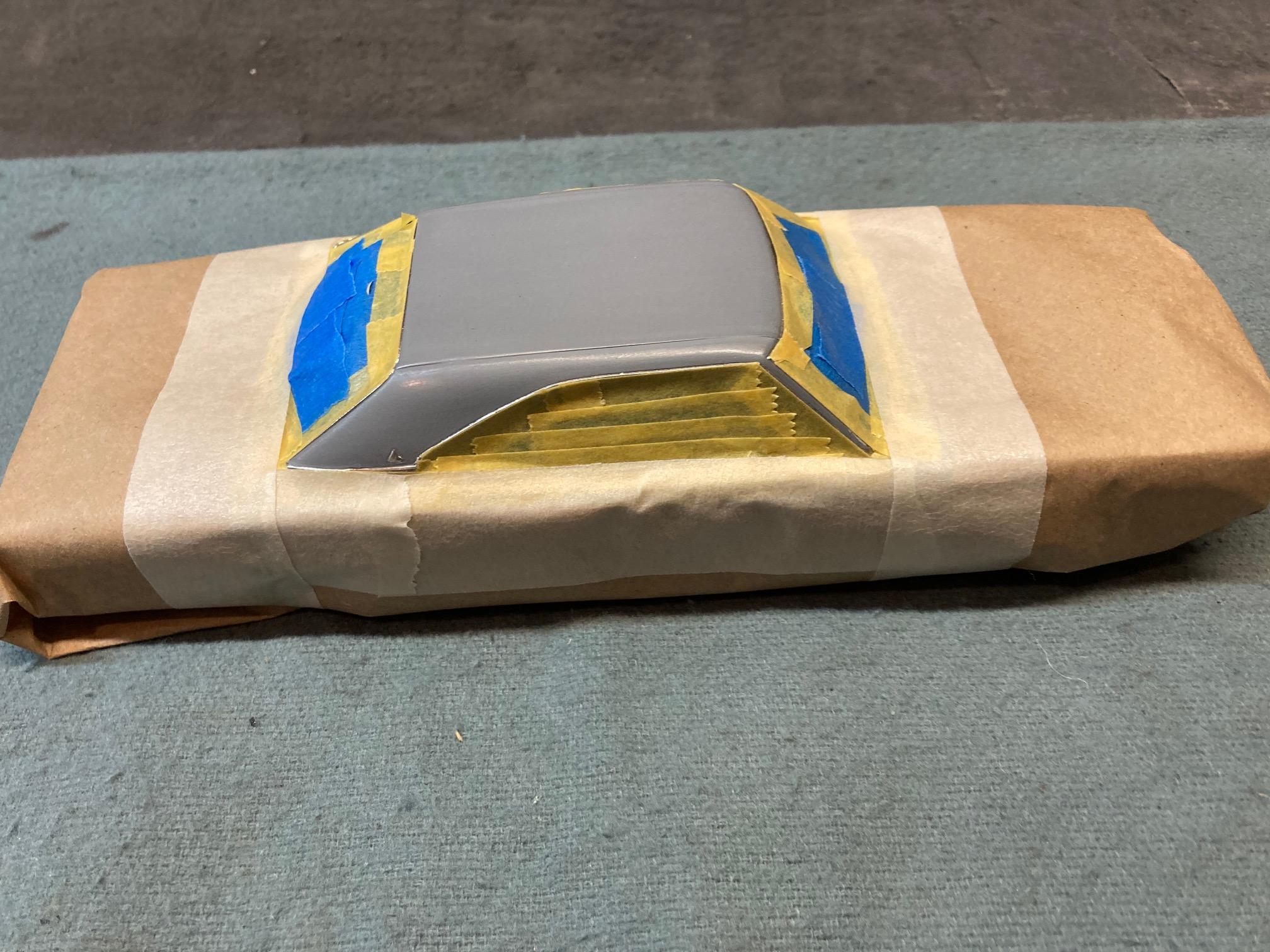

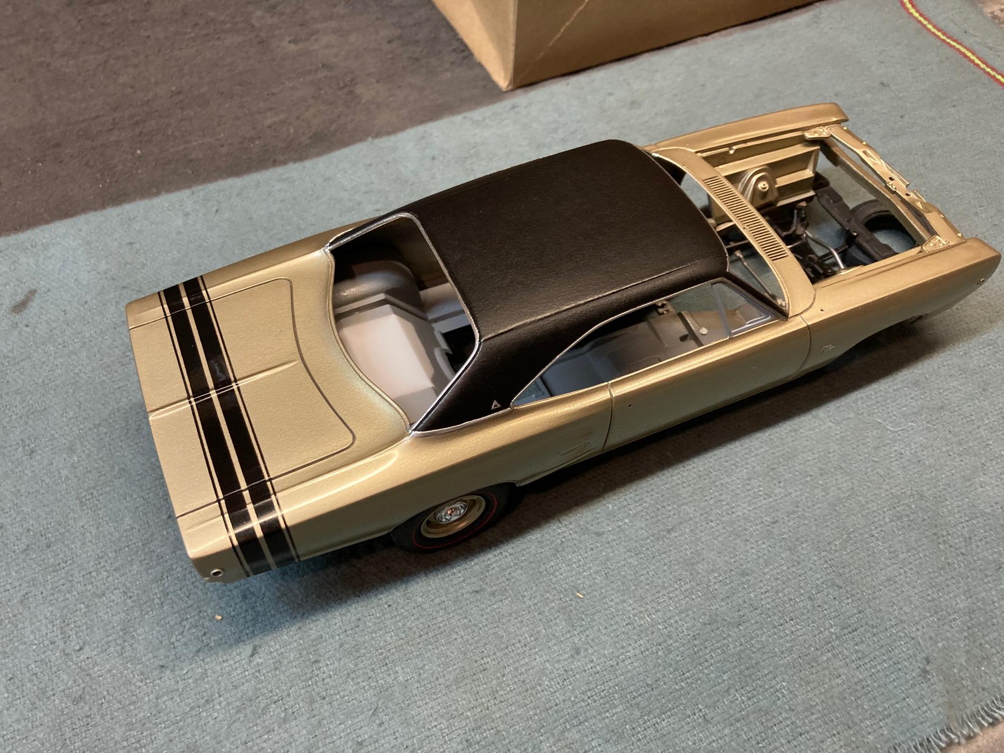

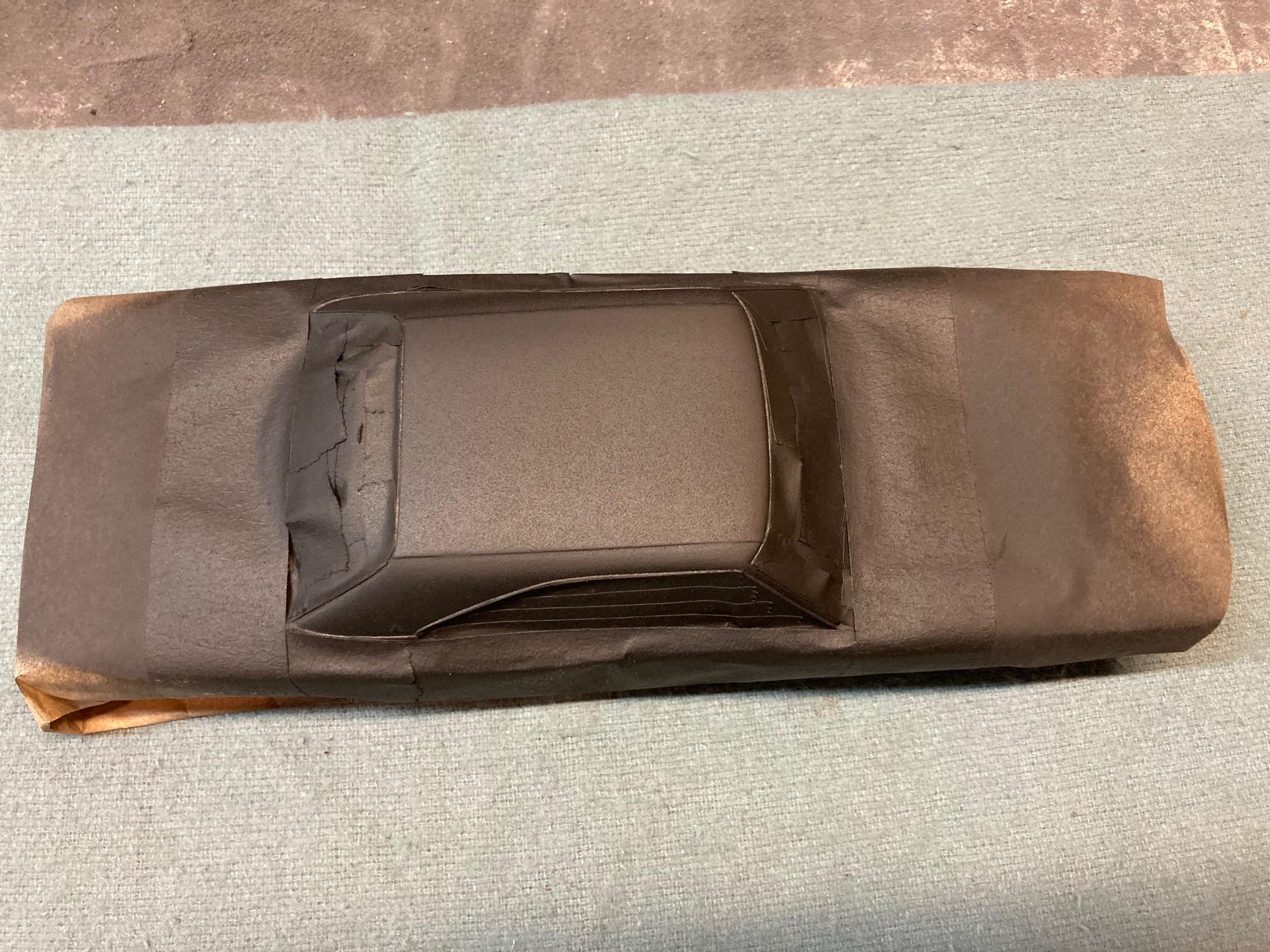

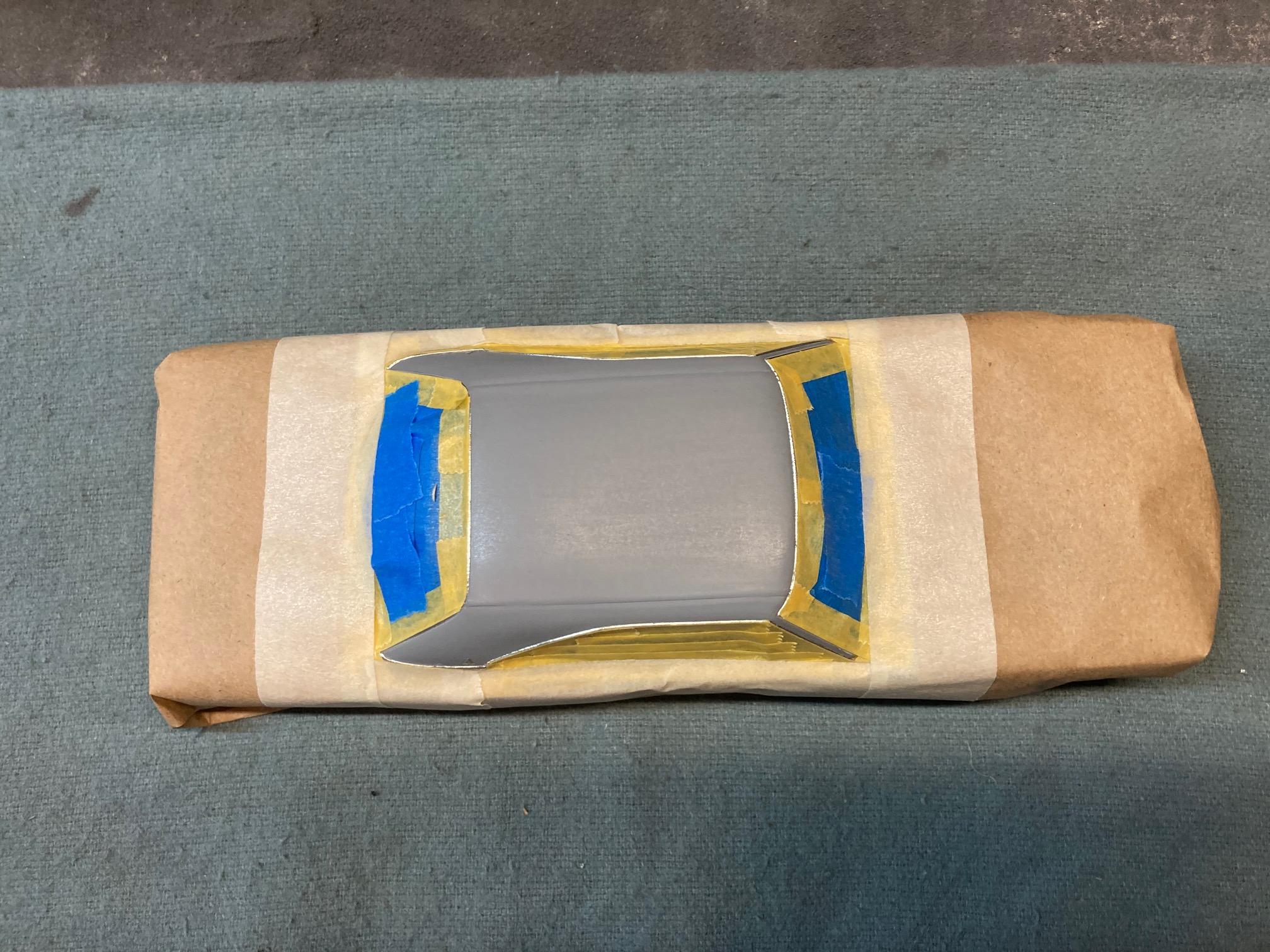

  10. Here are the results of my vinyl top plan. As I stated above, rather than try to mask the trim, or sand it after paint for foiling, I decided to use the trusty "foil under paint" technique and foil it first. I foiled, then masked to try to get as little paint on the trim as possible. Then I shot a few light coats of Duplicolor black primer, a couple of light coats of MCW "vinyl top paint" and then a final coat of black primer. I then gave it a little rub down with some WD-40, followed by a washing to shine it up a little. I made one very advantageous discovery during this operation. The paint that I used did not stick well at all to the foil, which made it very easy to remove the paint from the trim with nothing more than a little light scraping with a sharpened tooth pick! No thinner required!! Keep in mind though, that being as the paint did not adhere well, that the foil needs to be cut close to the trim to be certain that it does not flake off where you don't want it to. Steve
  11. Thanks Ryan. On past projects I've used regular flat paint for the vinyl top shot from a distance to give a little texture, and then just lightly sanded the trim smooth. But in this case, I'm planning on using a textured paint, so I'm going to try an alternative approach. My plan is to foil the trim prior to painting and then I will clean the paint from the trim with thinner after the top is finished. (The foil under paint technique) I use this technique liberally on other aspects of a build, and although I have yet to use it in this circumstance, I'm pretty confident that it will work well. I'll be finding out quite soon. Steve

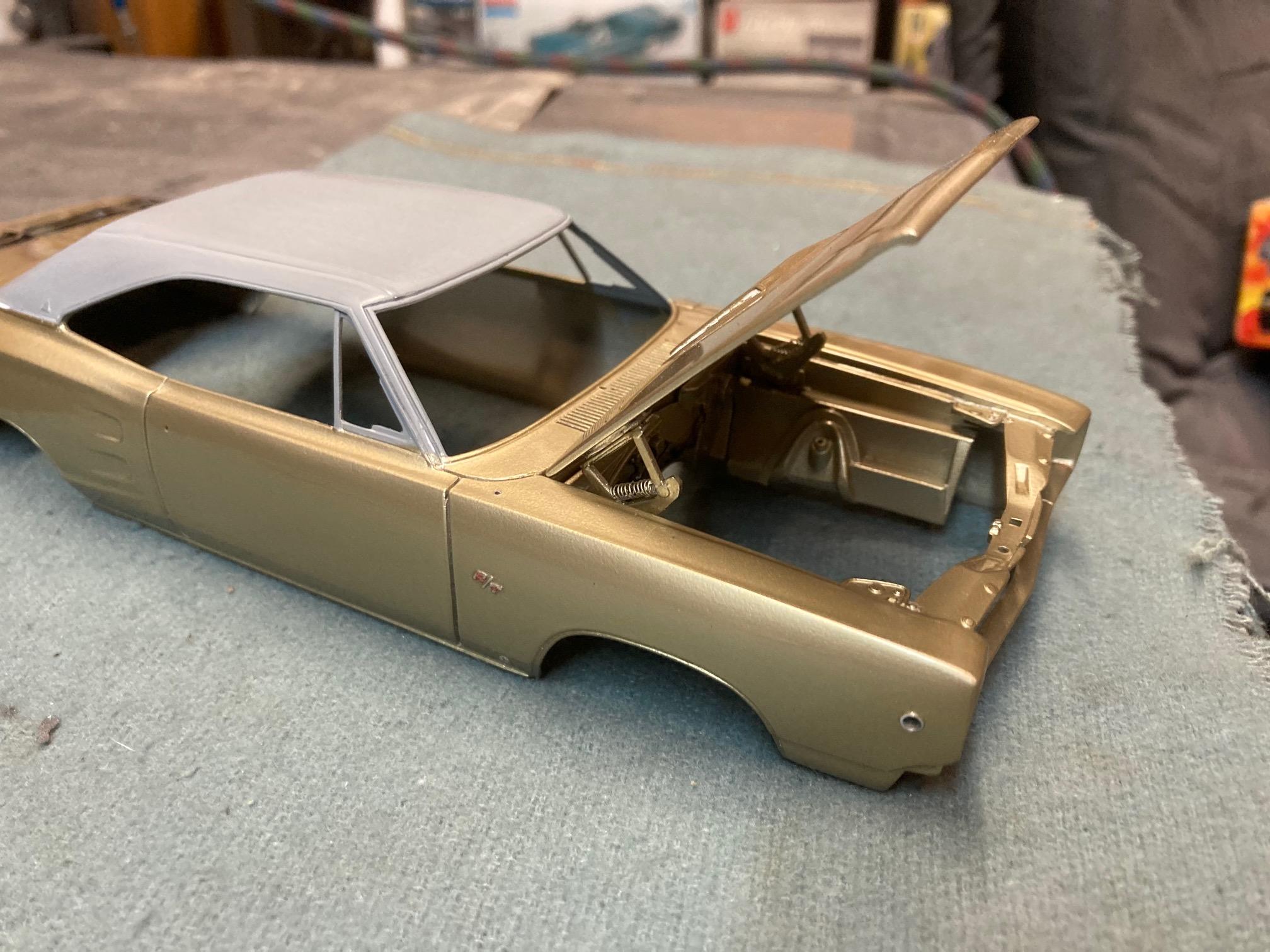

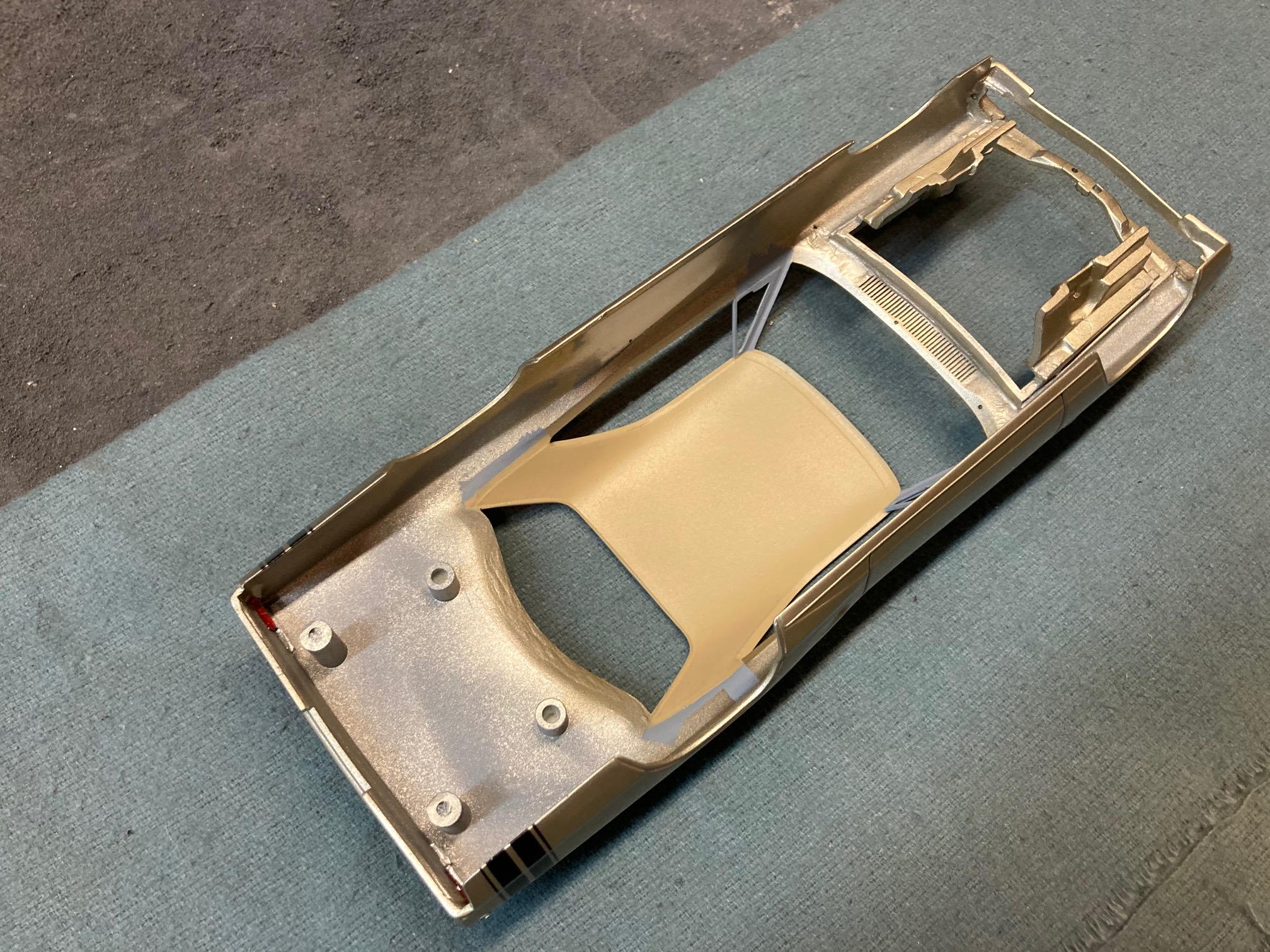

  12. Thanks everyone! My next task was to mask and spray the undercoating on the front wheel wells. What a masking nightmare! I wound up masking and spraying one side at a time to make the masking more manageable. It worked out okay, but what a PITA!! No room for getting any over spray on any exposed surfaces at this stage of the game! Steve

  15. Thanks guys. Didn't get a lot of time at the bench this holiday weekend, but I did manage to get the headliner sprayed with some Tamiya TS-46 "Light Sand", the front of the radiator bulkhead shot with flat black, and the wheel well portion of the firewall "undercoated" with some MCW "vinyl top" paint. Next I will shoot the top, and then the front fender wells. Steve

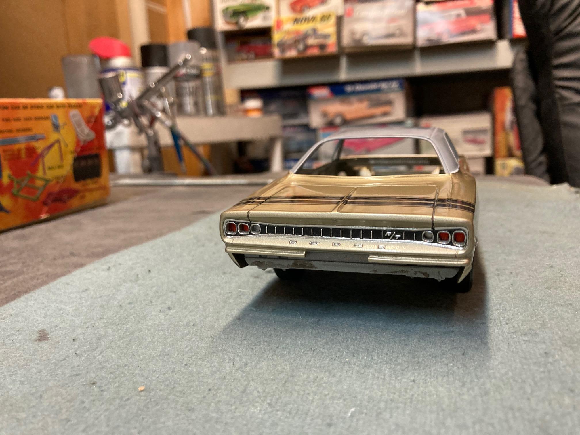

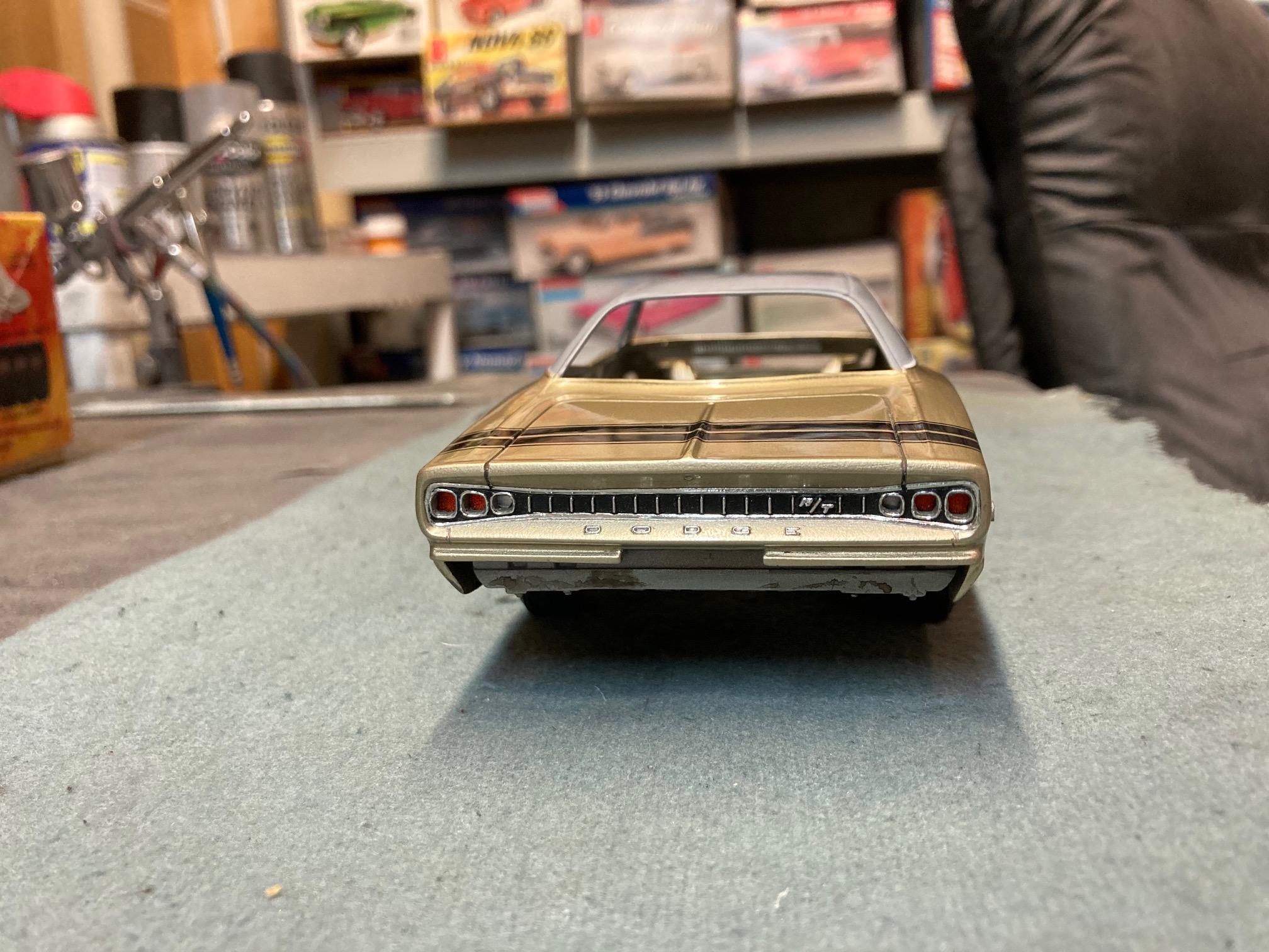

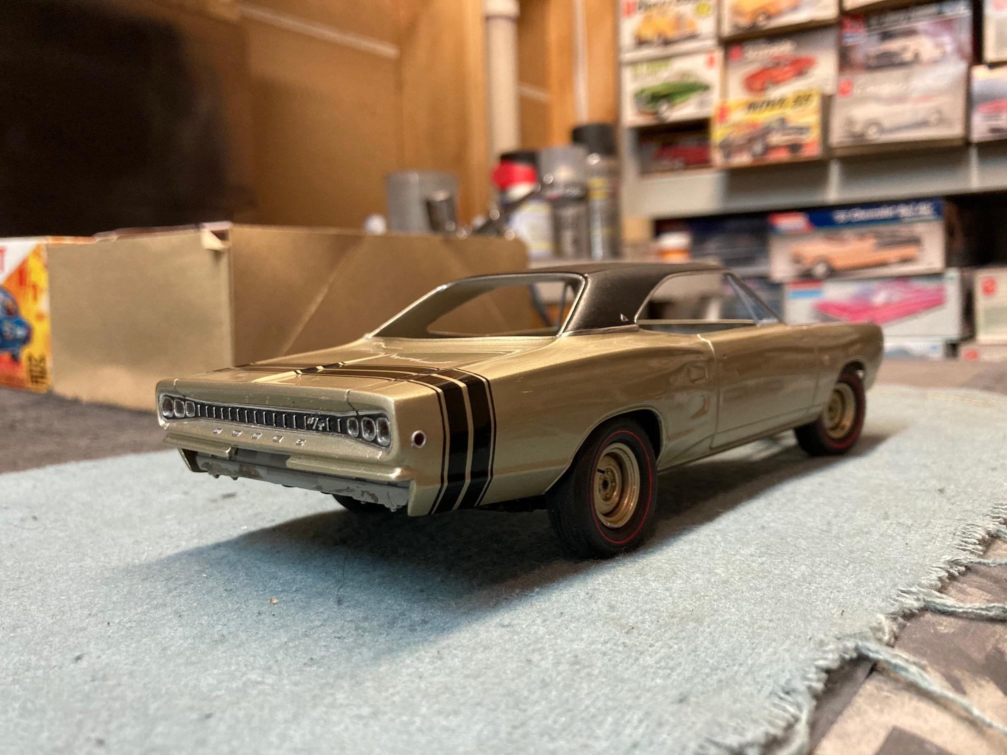

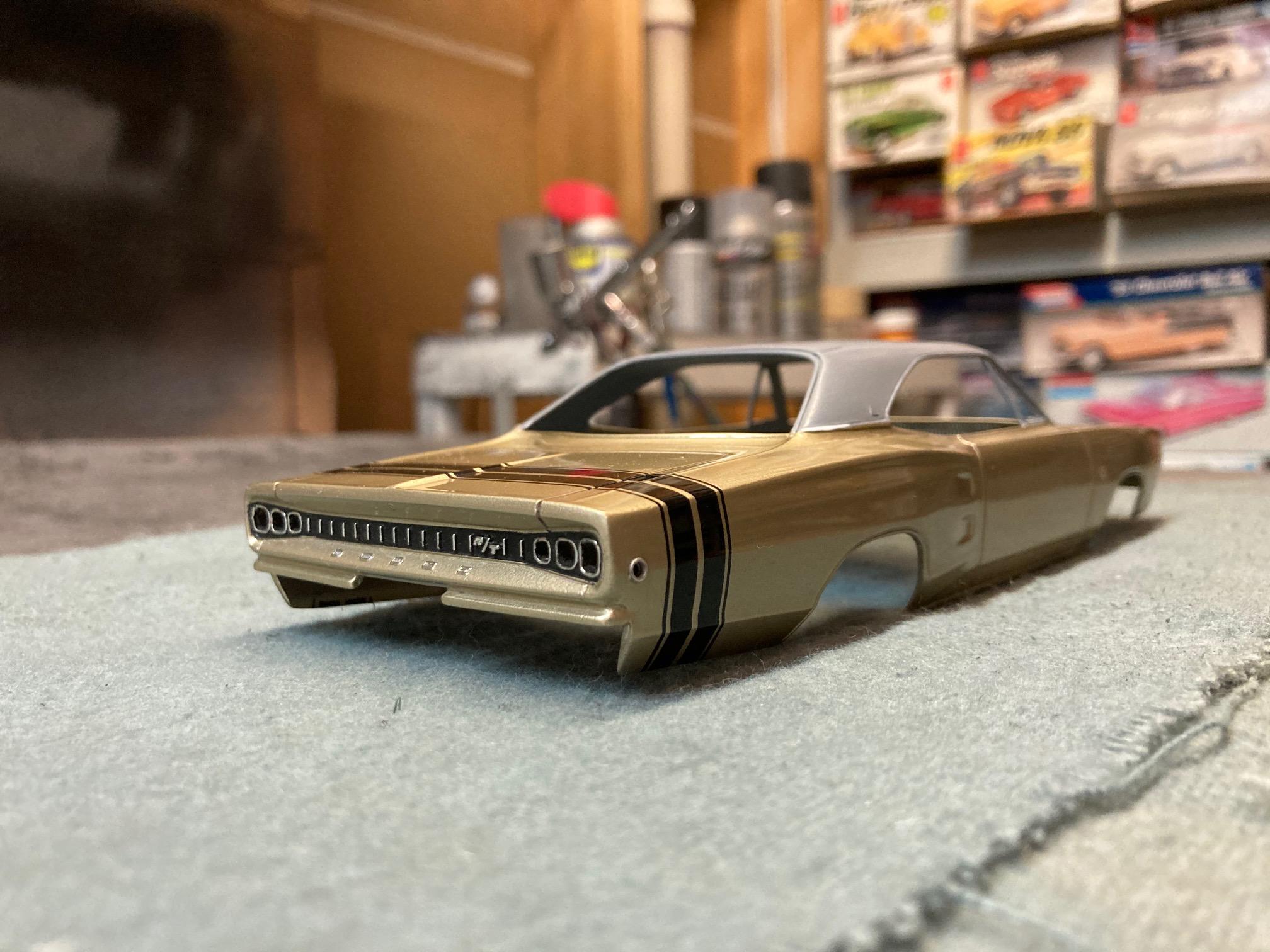

  21. I think I've got the rear panel and tail lights pretty much wrapped up. Steve

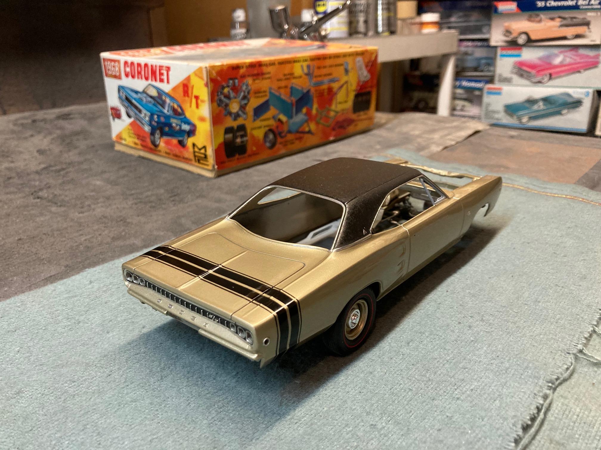

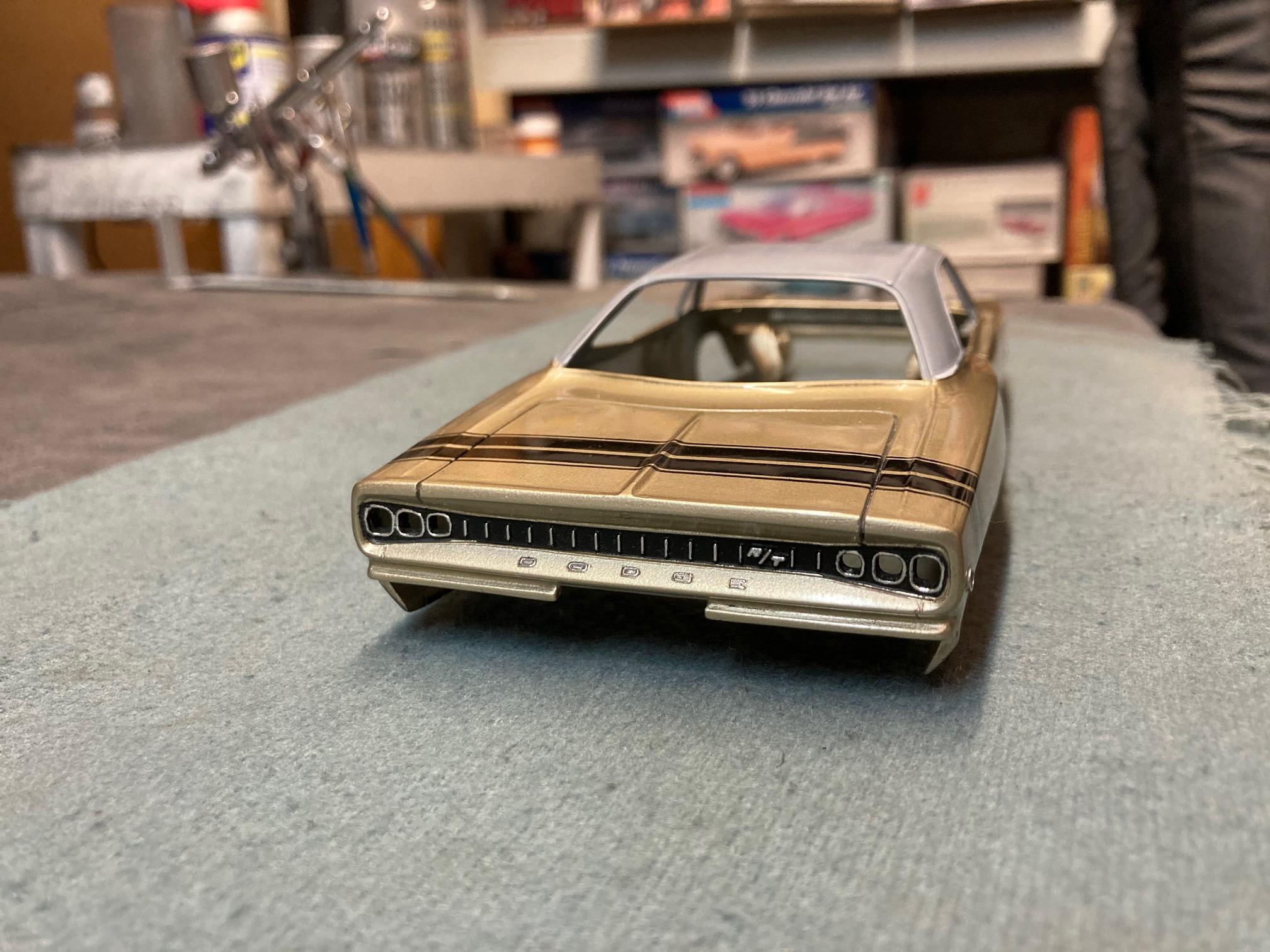

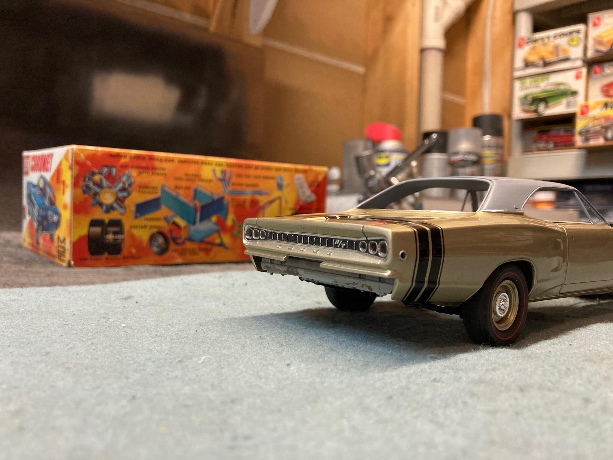

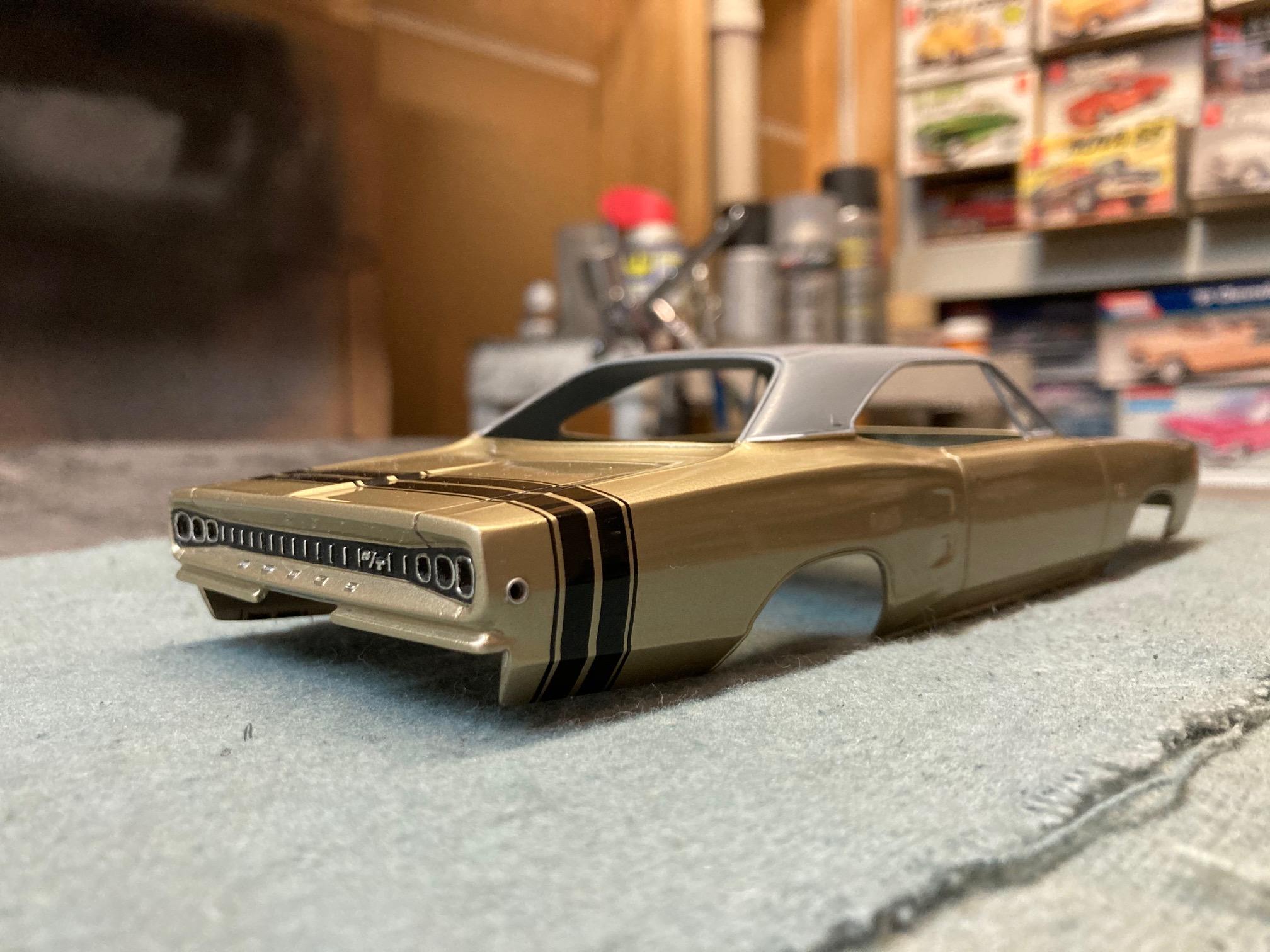

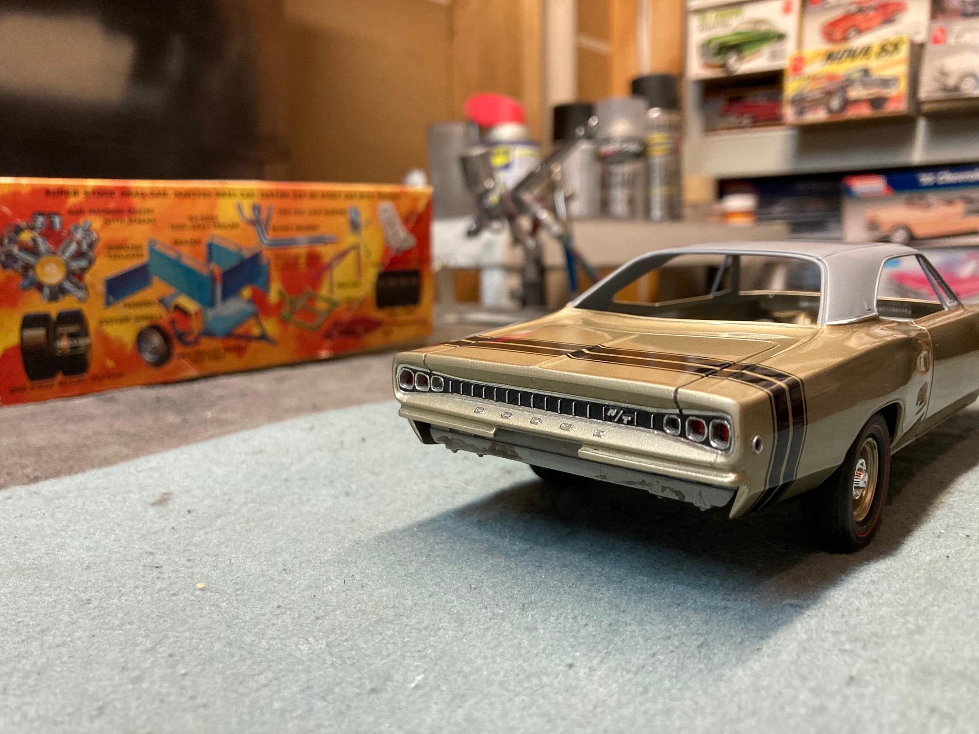

  23. Thanks folks! With the polishing finished, I was able to move on to detailing the rear panel. Still have the perimeter trim to foil, and I'll paint the inside of the tail light bezels argent, then I can continue on with the vinyl top. Steve
