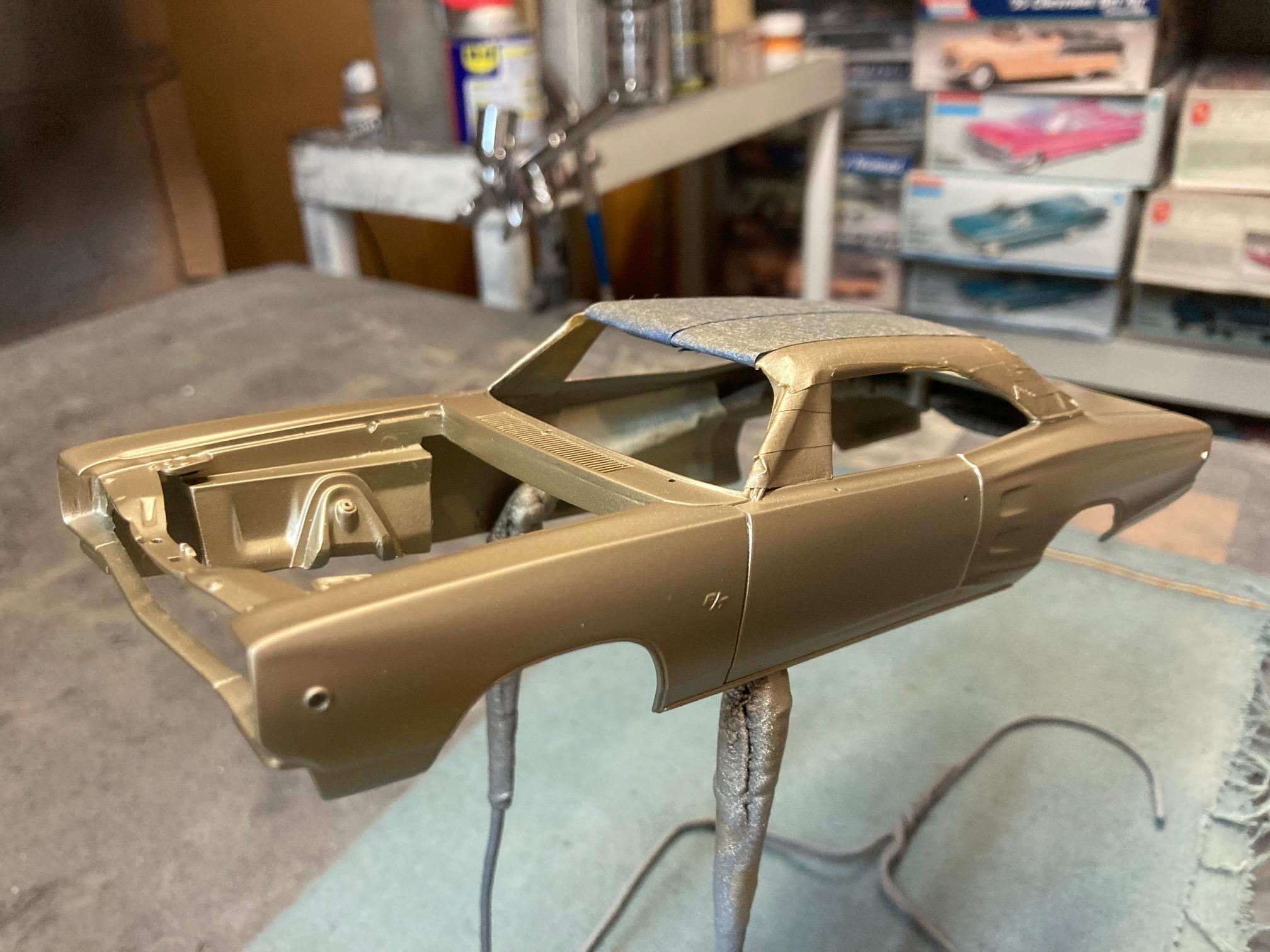

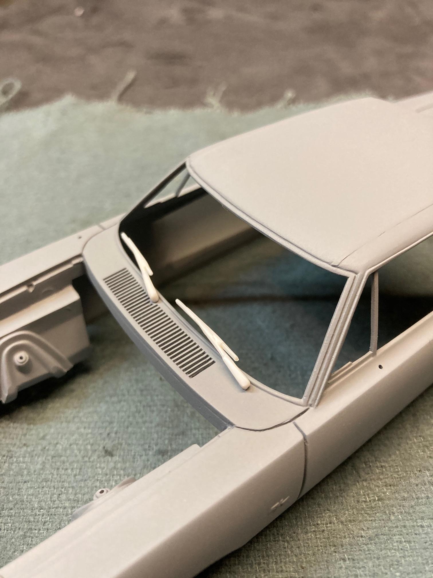

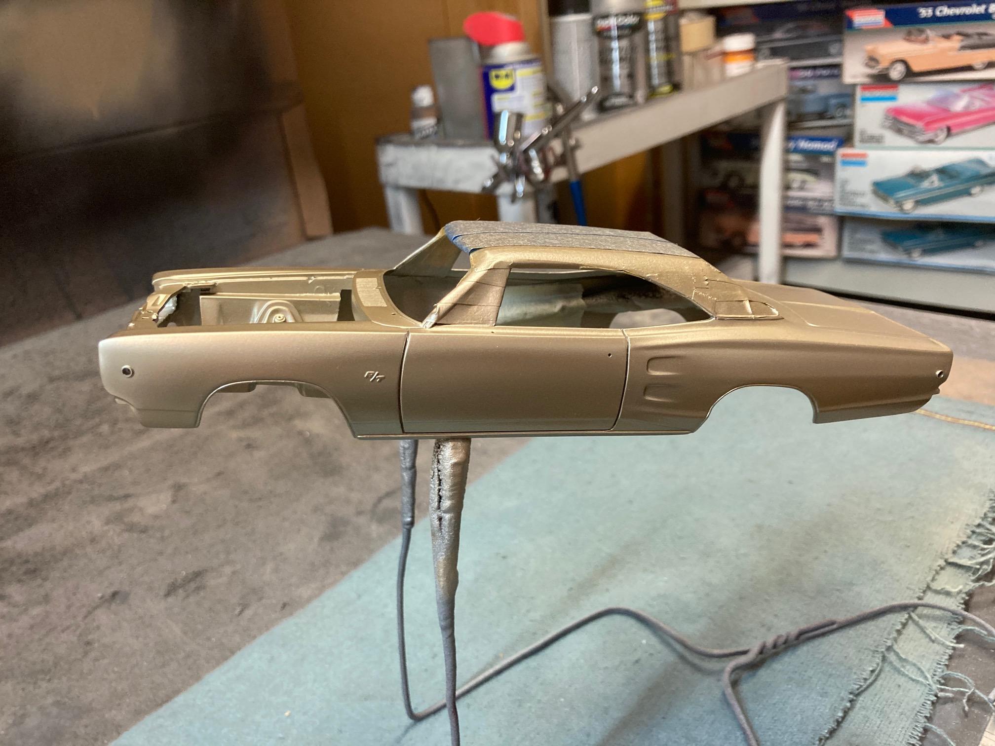

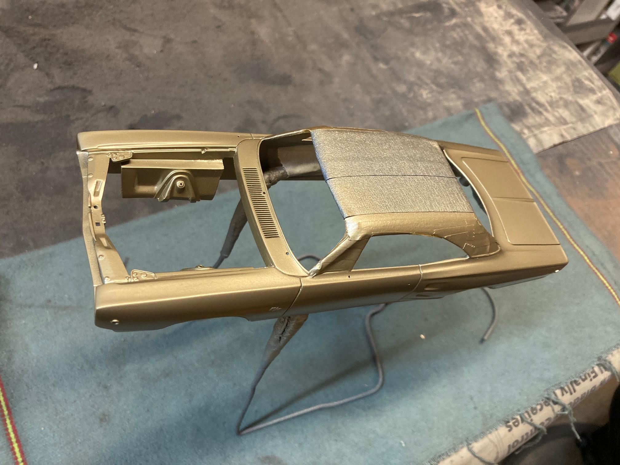

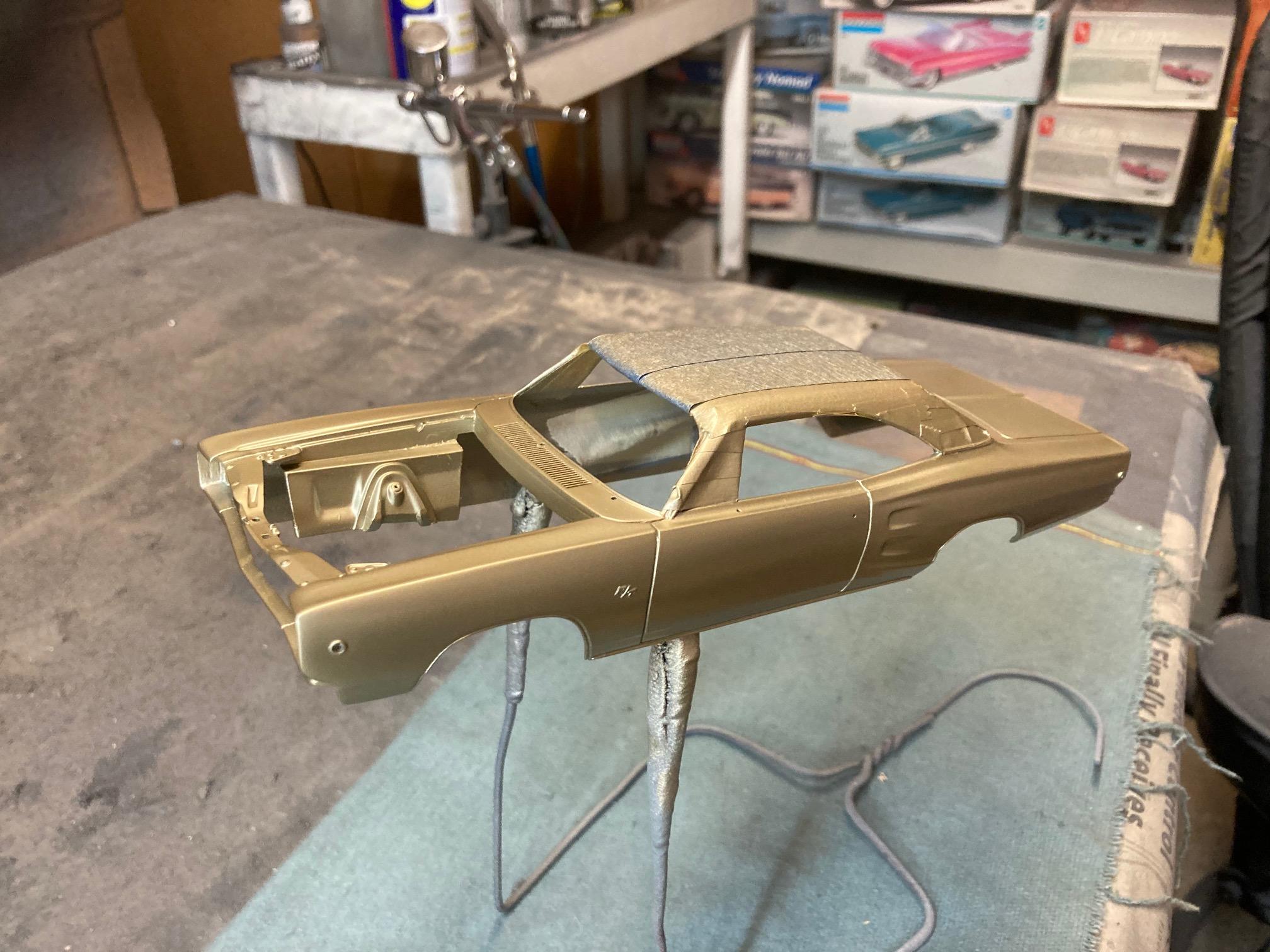

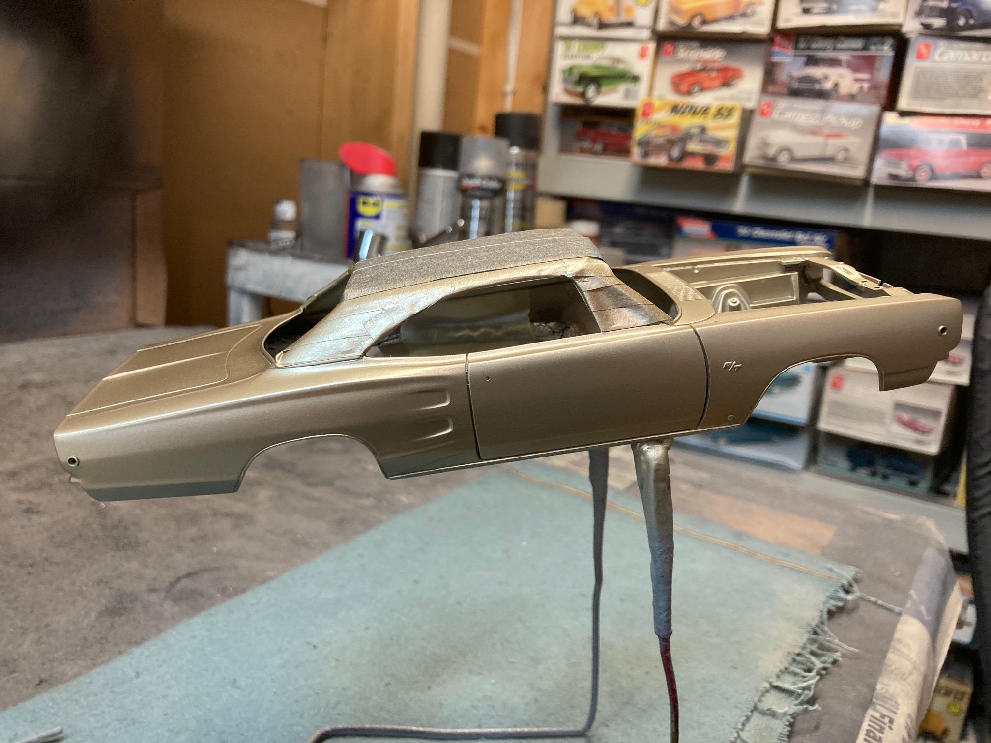

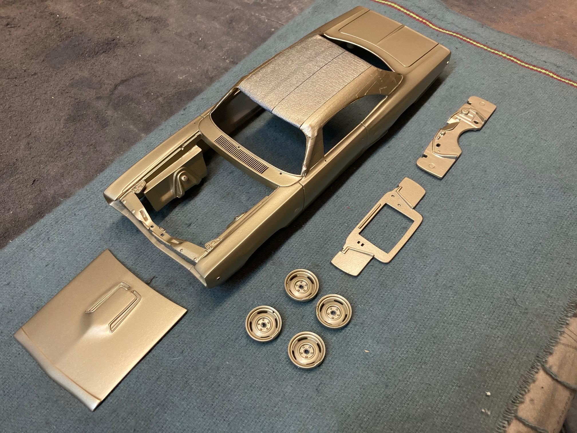

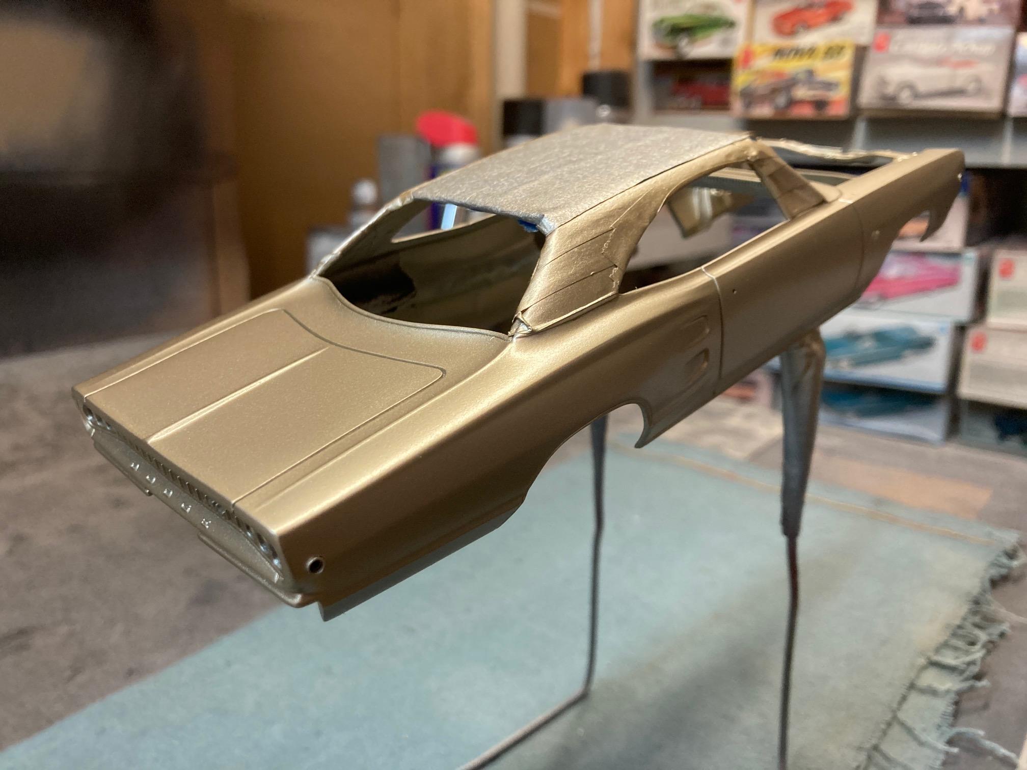

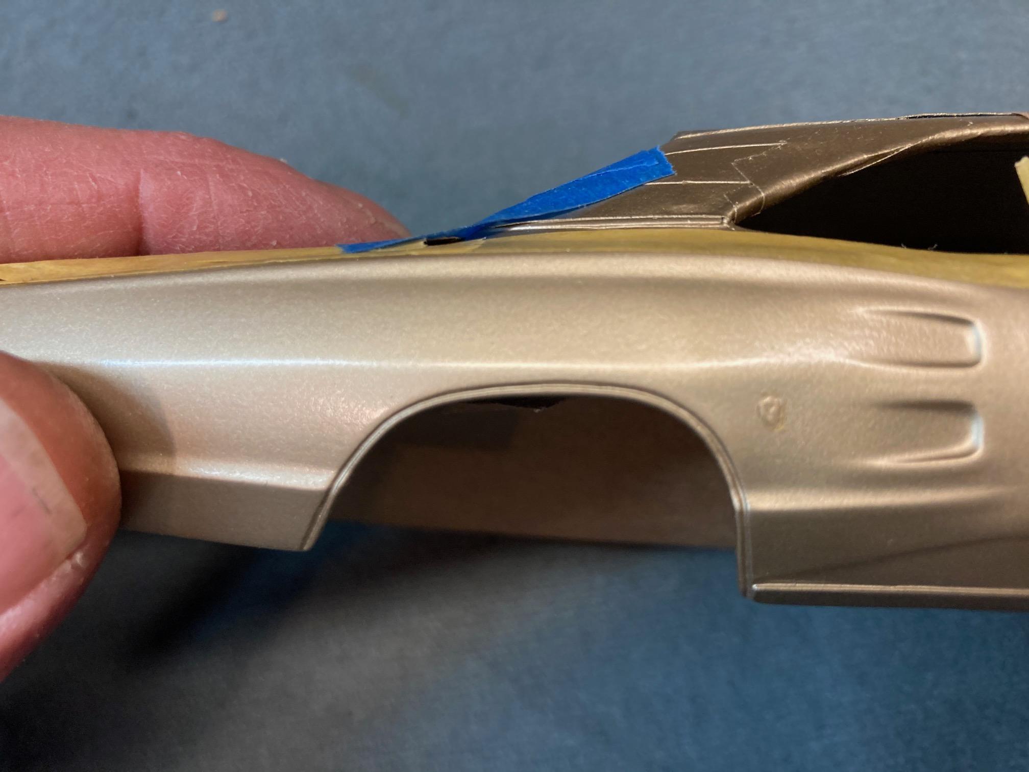

Here are the results of my vinyl top plan. As I stated above, rather than try to mask the trim, or sand it after paint for foiling, I decided to use the trusty "foil under paint" technique and foil it first. I foiled, then masked to try to get as little paint on the trim as possible. Then I shot a few light coats of Duplicolor black primer, a couple of light coats of MCW "vinyl top paint" and then a final coat of black primer. I then gave it a little rub down with some WD-40, followed by a washing to shine it up a little. I made one very advantageous discovery during this operation. The paint that I used did not stick well at all to the foil, which made it very easy to remove the paint from the trim with nothing more than a little light scraping with a sharpened tooth pick! No thinner required!! Keep in mind though, that being as the paint did not adhere well, that the foil needs to be cut close to the trim to be certain that it does not flake off where you don't want it to. Steve

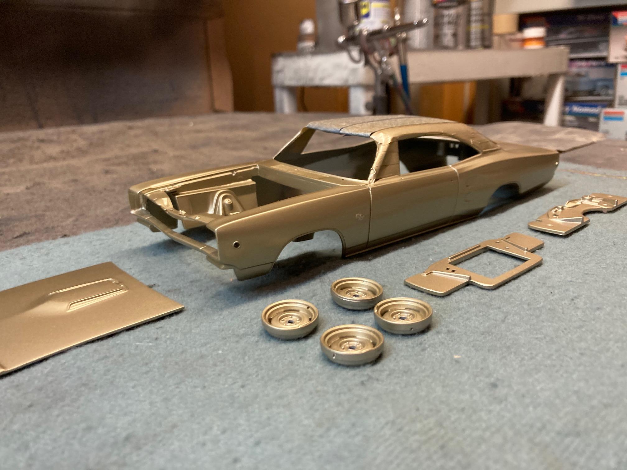

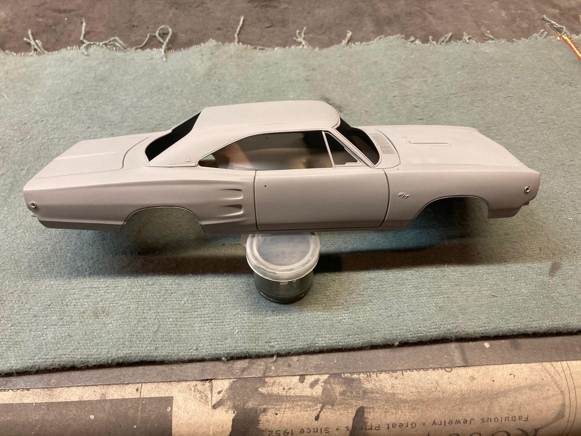

Thanks guys. Didn't get a lot of time at the bench this holiday weekend, but I did manage to get the headliner sprayed with some Tamiya TS-46 "Light Sand", the front of the radiator bulkhead shot with flat black, and the wheel well portion of the firewall "undercoated" with some MCW "vinyl top" paint. Next I will shoot the top, and then the front fender wells. Steve

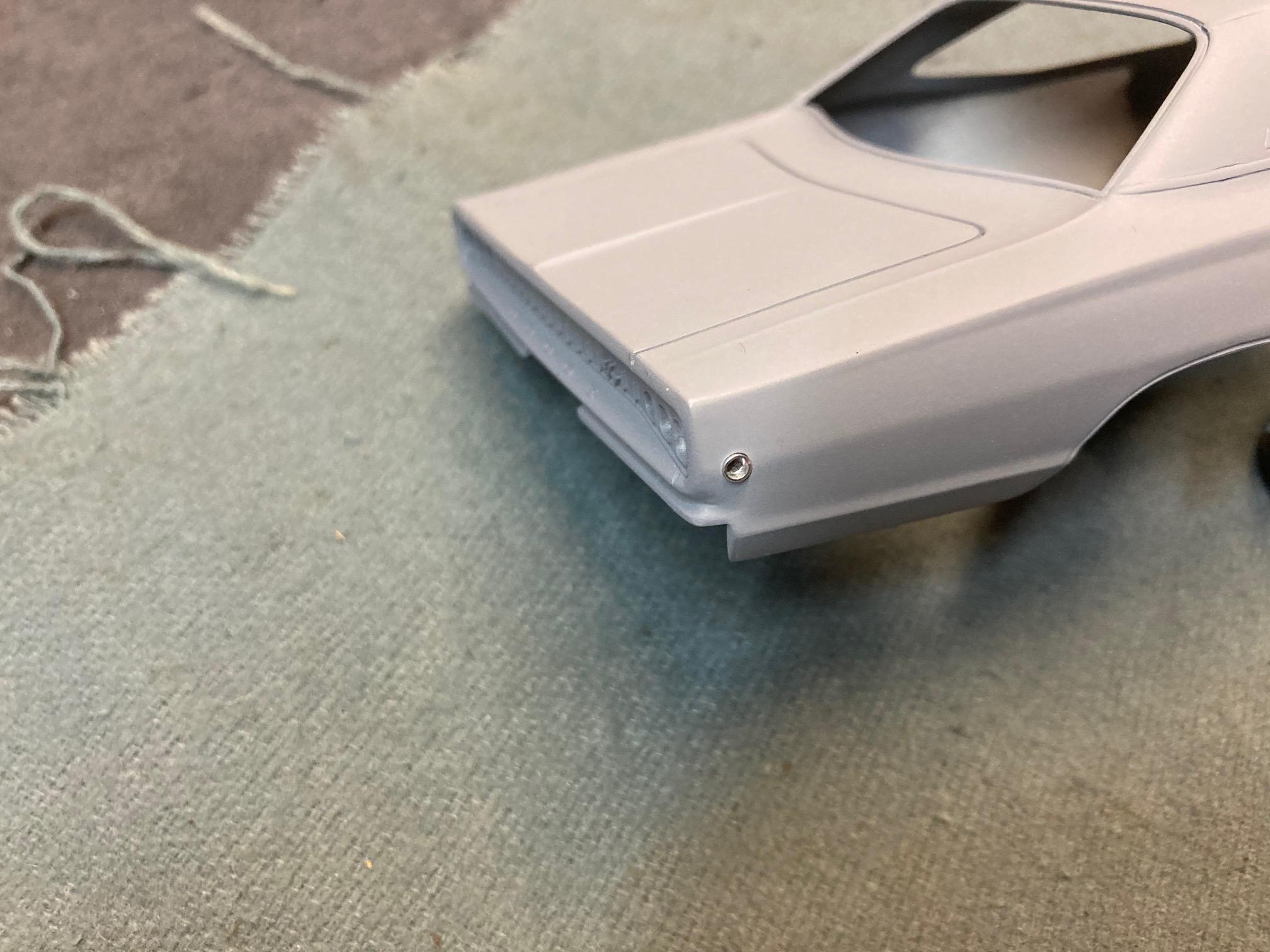

Thanks folks! With the polishing finished, I was able to move on to detailing the rear panel. Still have the perimeter trim to foil, and I'll paint the inside of the tail light bezels argent, then I can continue on with the vinyl top. Steve

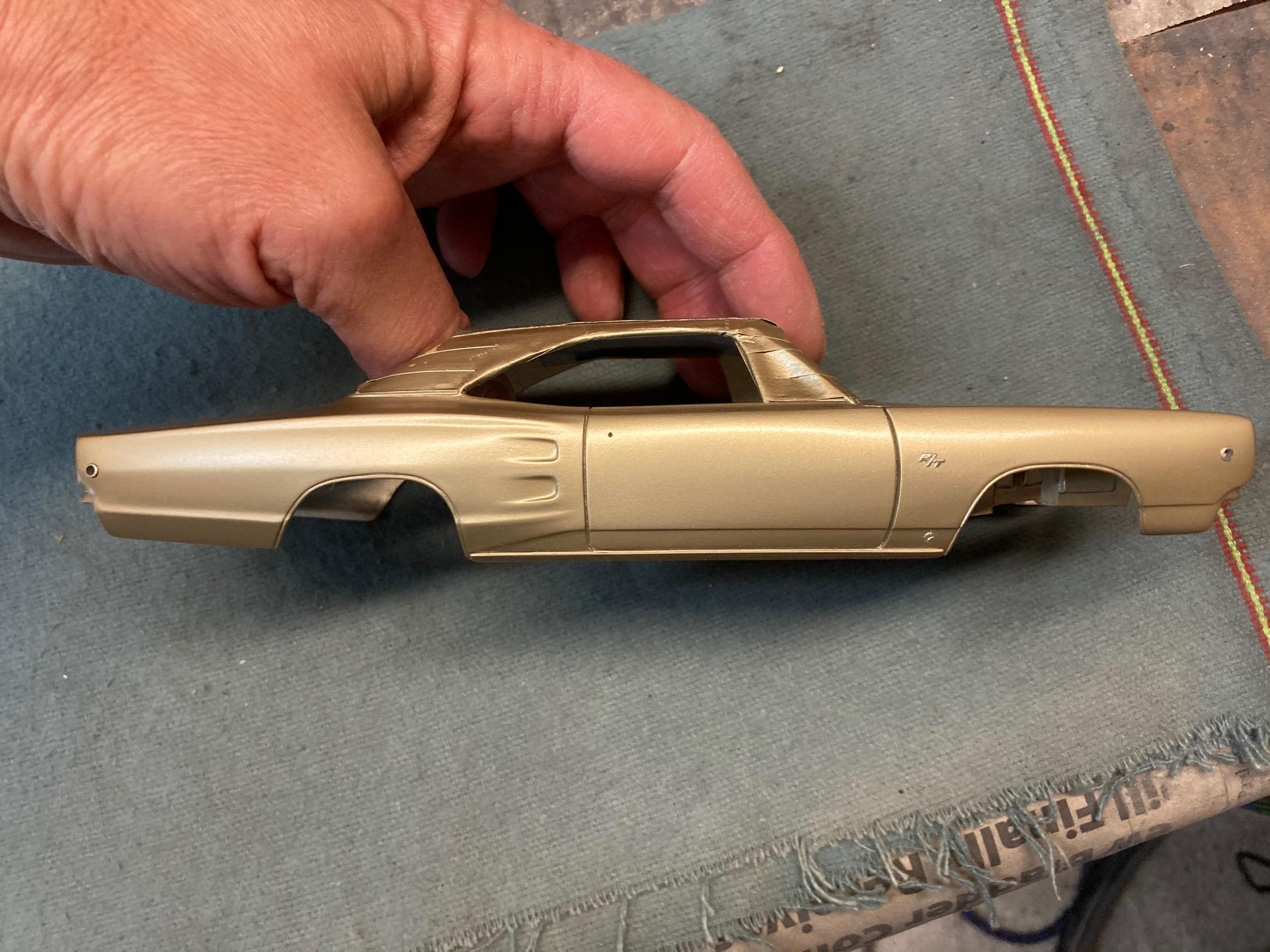

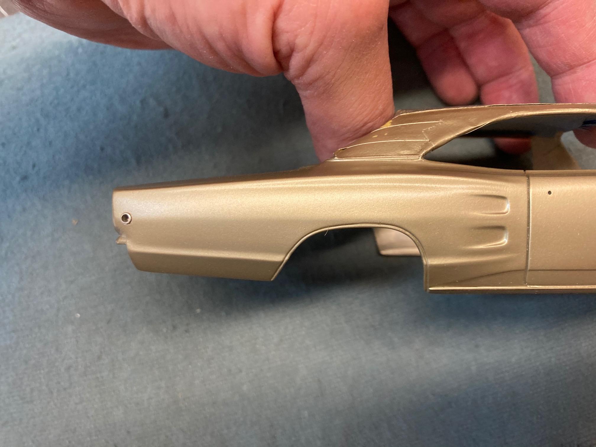

Thanks guys. Not the best paint job I've ever done, but it'll do. A little more trash in the paint than I would have liked, and a little bit of blush on the hood, but you have to be looking for them pretty hard. I guess they can't all be perfect. Steve

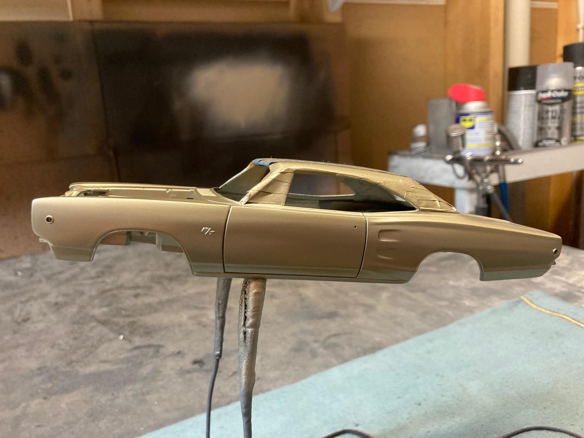

I think the polishing is finished. Now I can get ready to start painting the rear panel, vinyl top, and under coating the front fender wells. Steve
