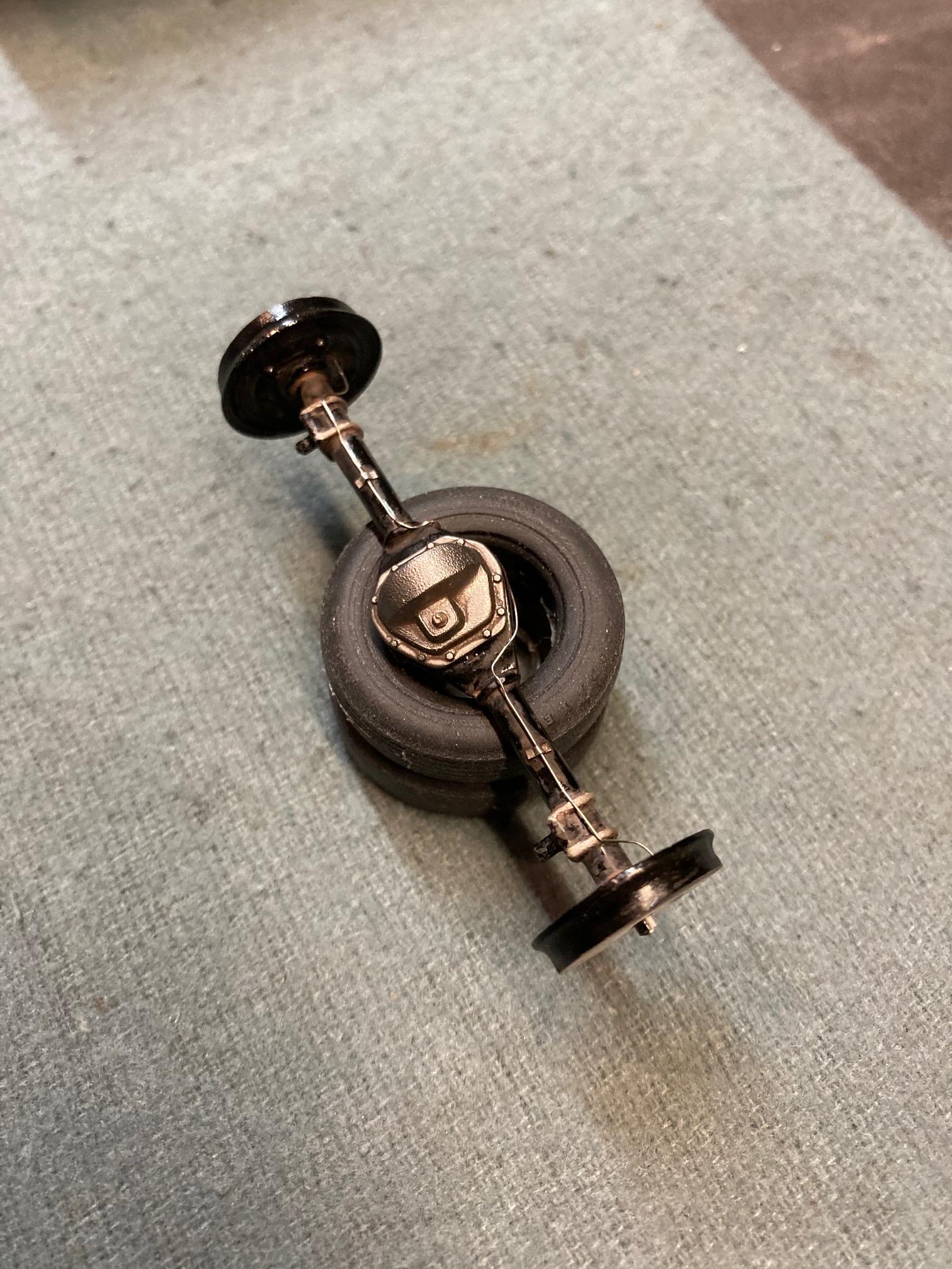

I'm using a set of resin tires from Fireball Modelworks on this build, so the red lines need to be painted. I picked up some white and some red acrylic at the hobby shop today and was anxious to see how it would go. I was very happy. The tires are molded with a recess for the red lines/white walls so painting was quite easy. Started with a little Mr. Hobby white, followed by a coat of red, and then cleaned off anything outside of the recess with a little bit of mineral spirits on a conical swab. A pretty easy operation, and the results are nice. Oh, I also "flat spotted" the tire by shaving and sanding a little off of the bottom, though it's really not evident in these photos. The resin in these tires is quite difficult to cut in comparison to a regular vinyl kit tire. Steve
