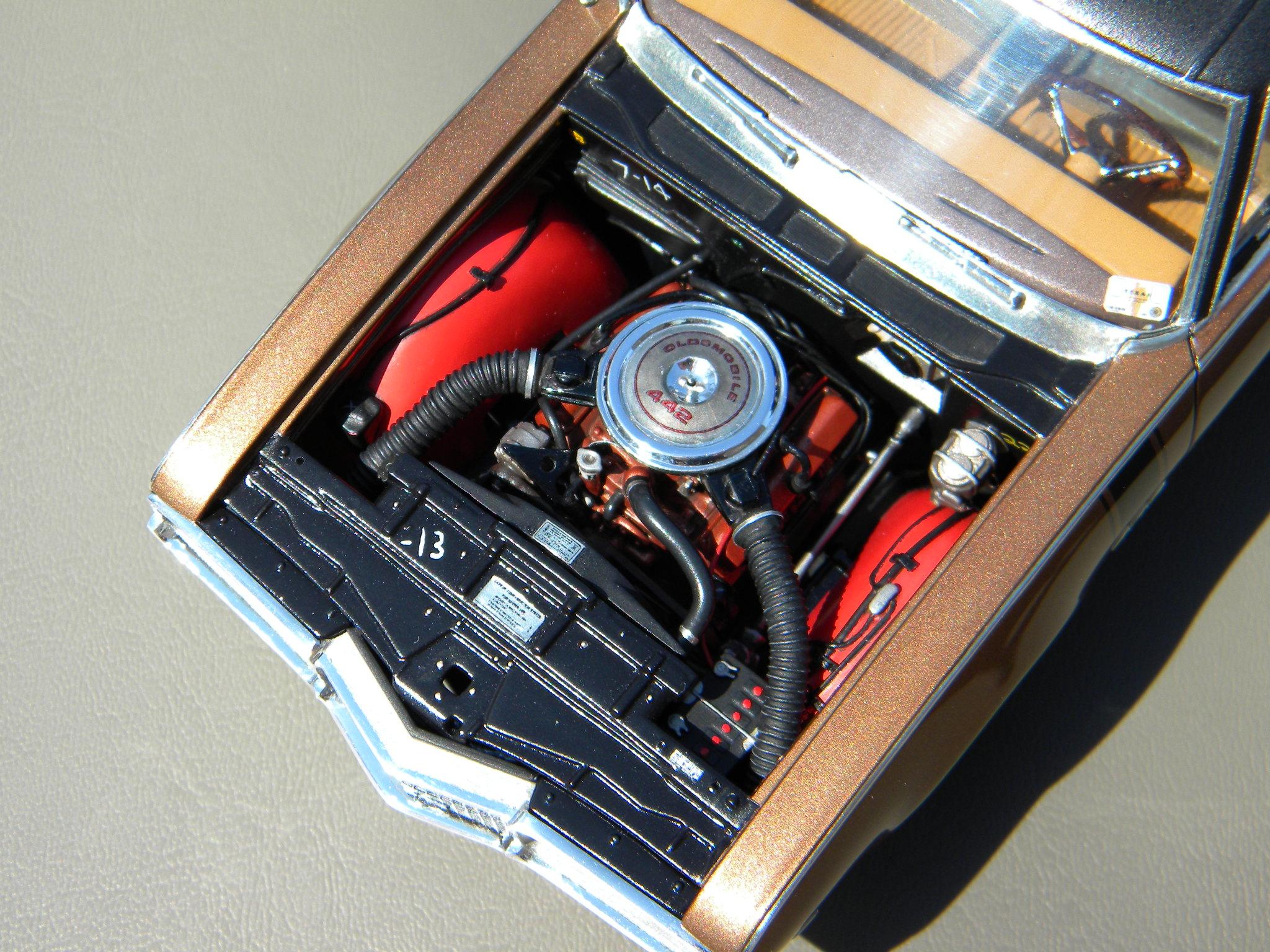

StevenGuthmiller replied to Bridgebuster490's topic in Model Building Questions and Answers
Just a couple of pictures of the results with the metallic powder that I like to use over paint & Elmer's glue. It also makes a pretty good hood insulation, although this is one of those instances where the more fibrous appearance of flocking might look better. Steve -
