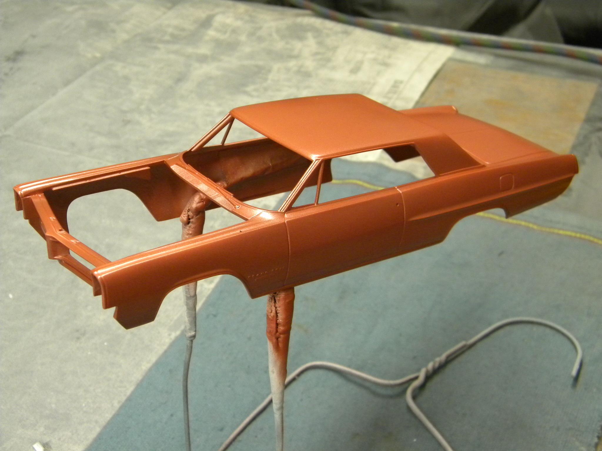

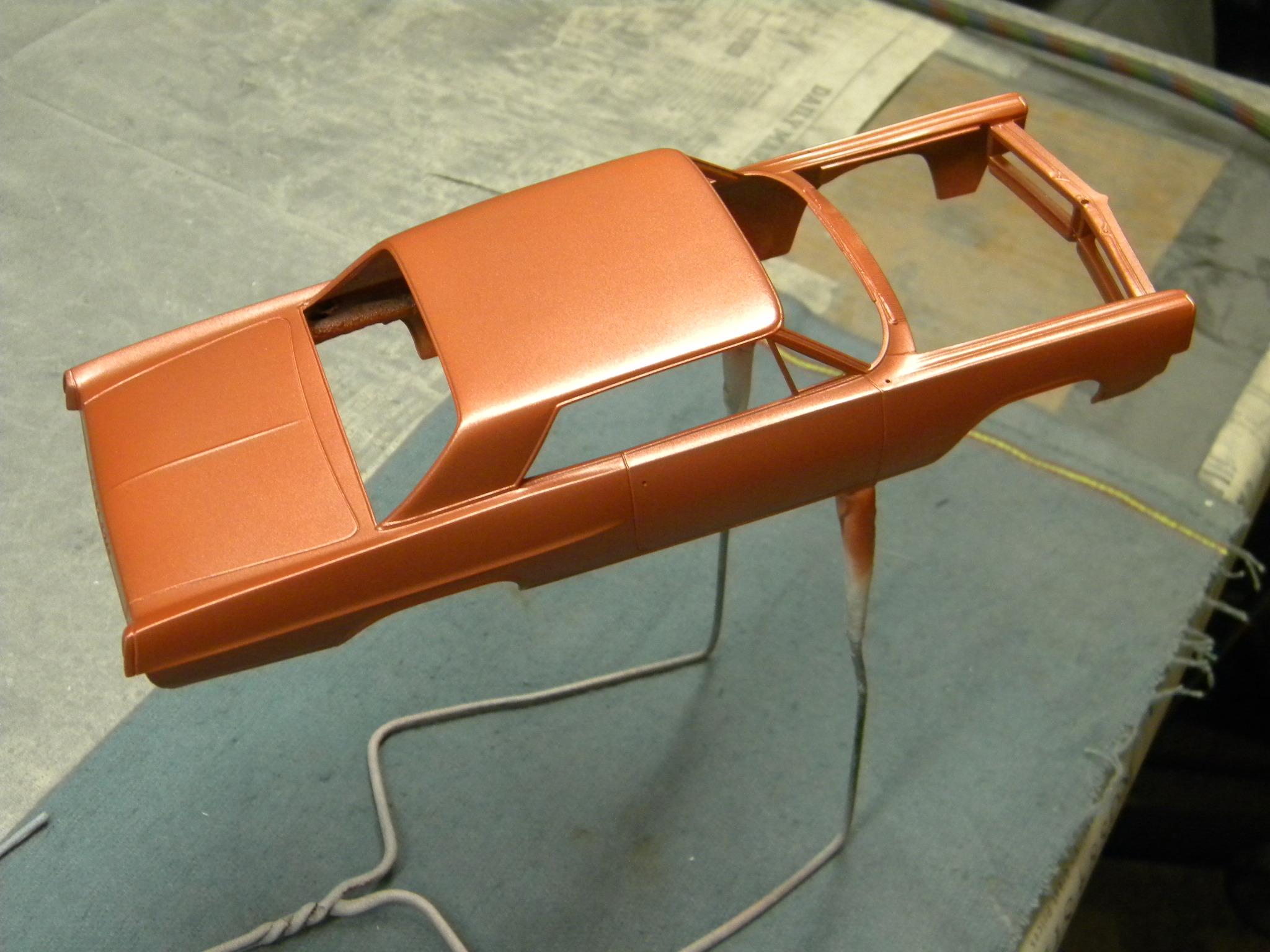

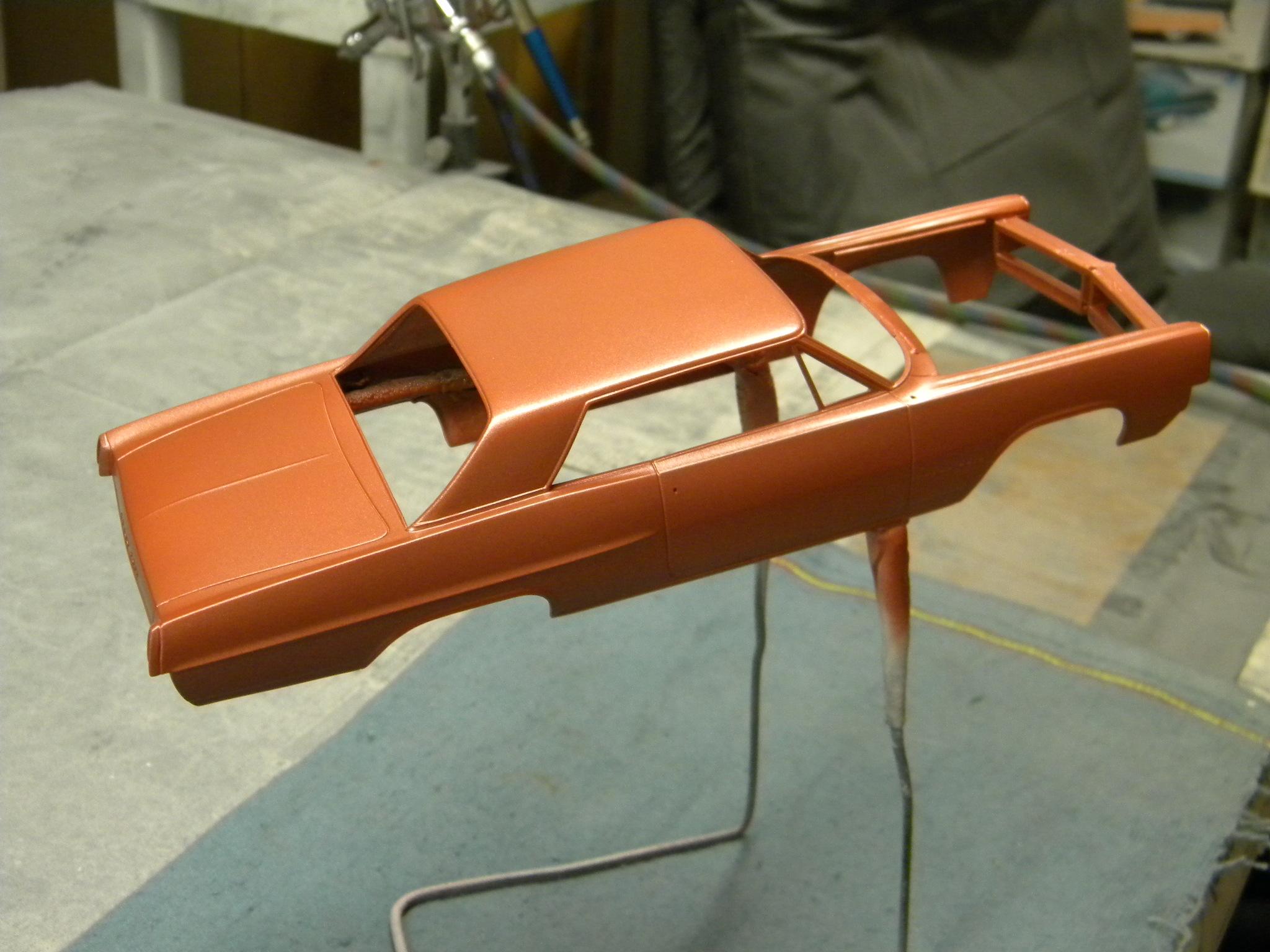

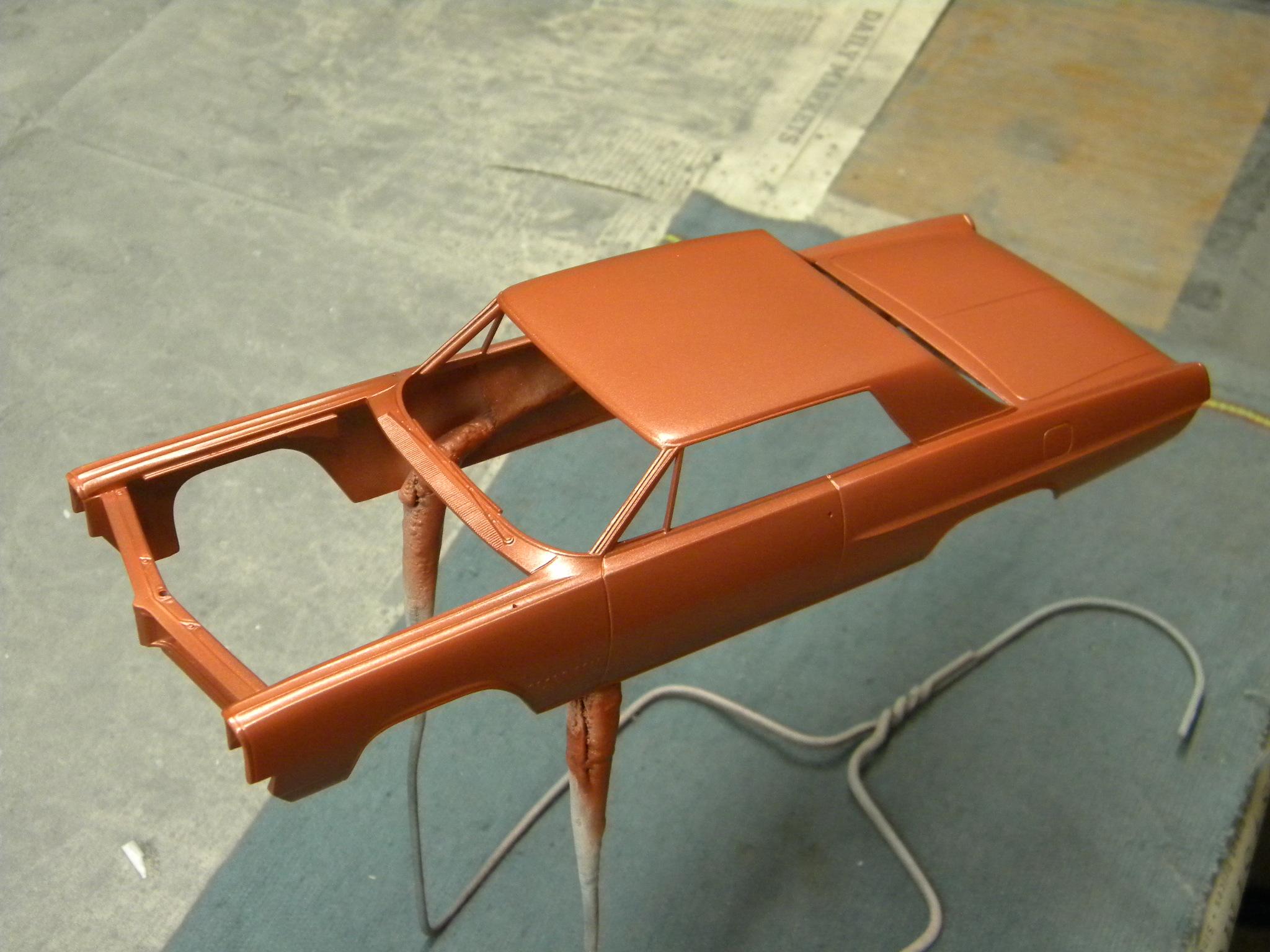

Final color coats were applied today, as well as finishing the scripts. At this point, no splotches or stripes are evident in the paint, but then again, I hadn't noticed any in the first attempt either. The true test will come with the completion of the first clear coat, which will hopefully take place this evening. I'm keeping my fingers crossed! Steve
