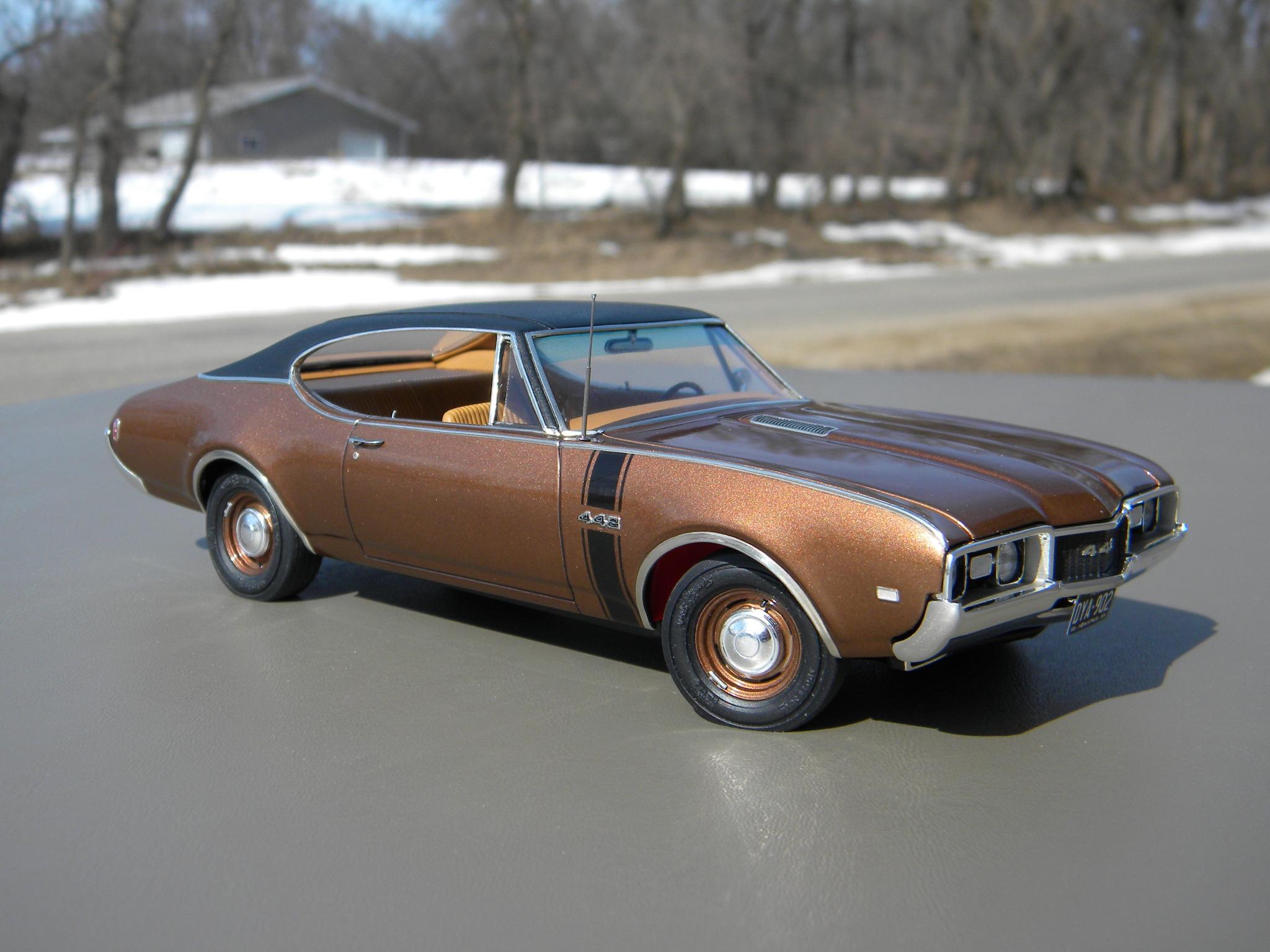

My good friend Bob Spedding printed up a bunch of '68 442 air cleaner decals for me for my last project. He addressed this issue by printing them on clear decal paper allowing the chrome to show through. There is enough of a contrast created by the clear film to make it look pretty close to accurate. Steve -

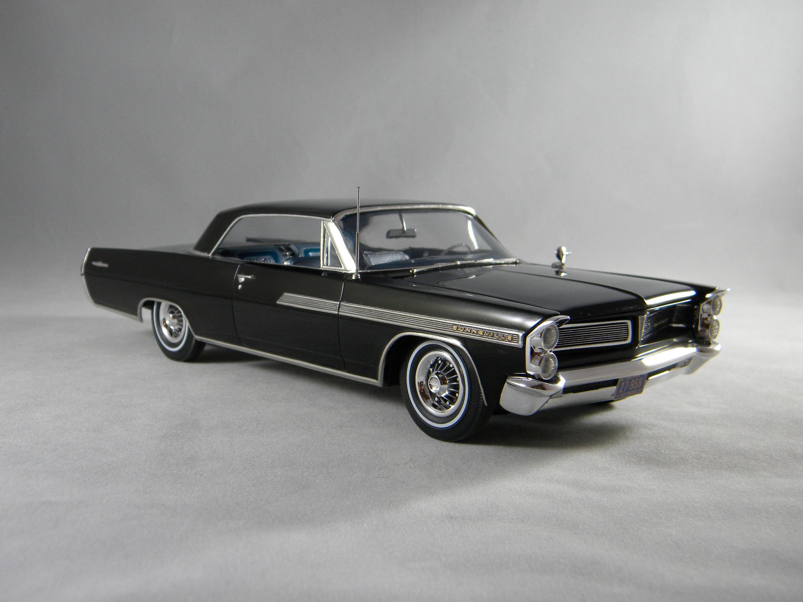

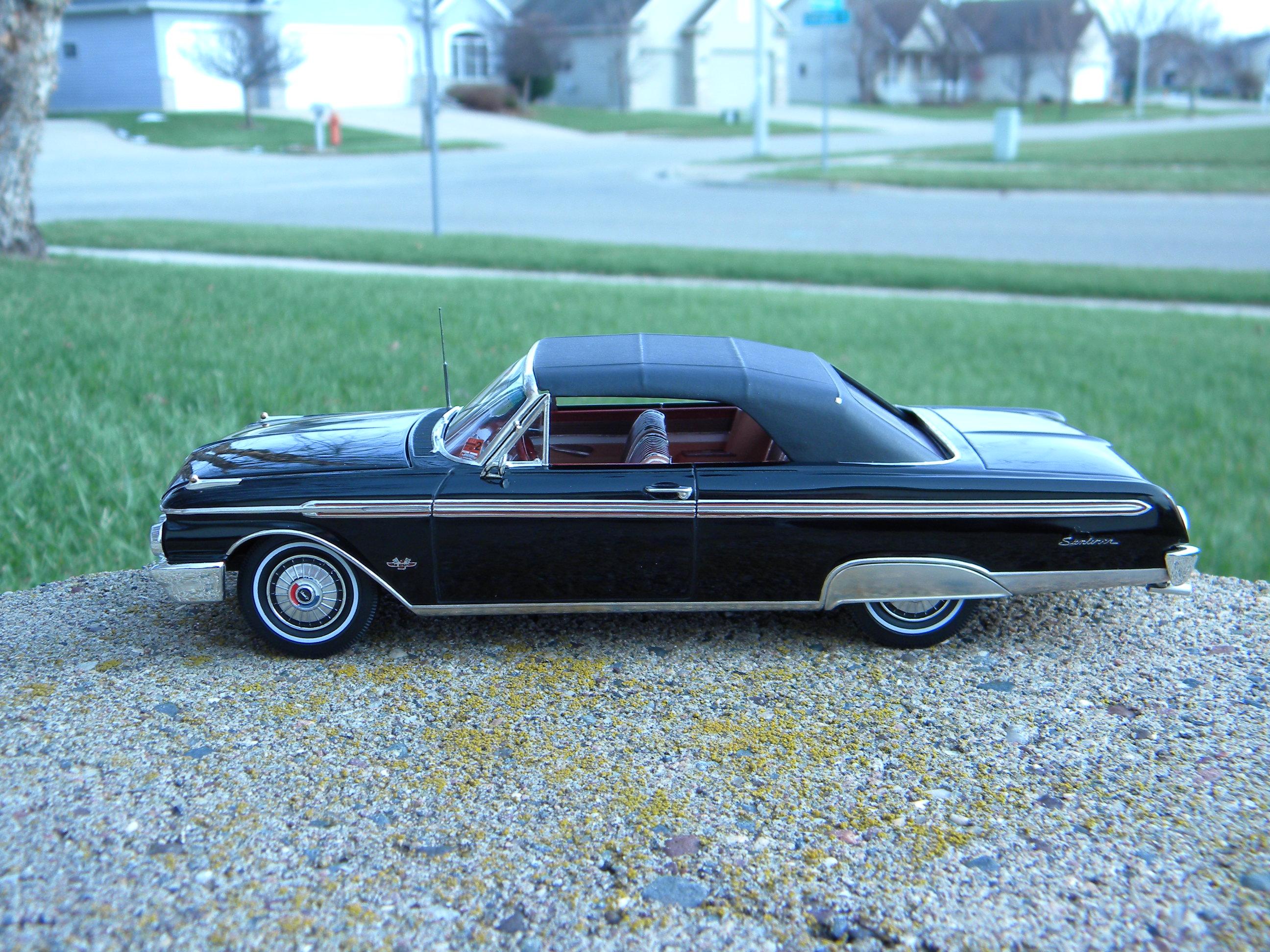

I've built a few. All with Duplicolor "Universal Black" and Duplicolor clear lacquer. 1960 Mercury Parklane Convertible 1962 Ford Sunliner Convertible 1963 Pontiac Bonneville Hardtop Steve -
