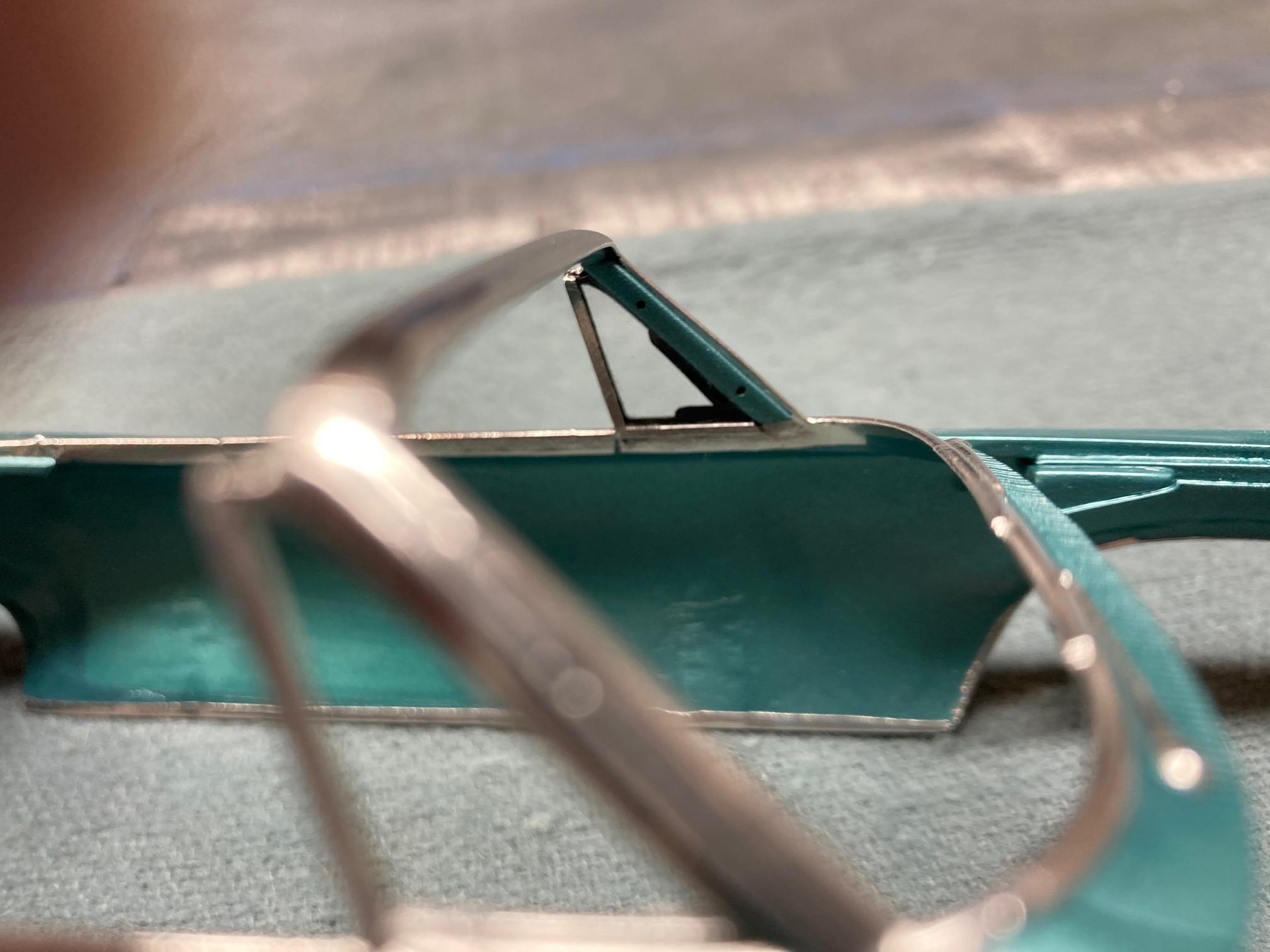

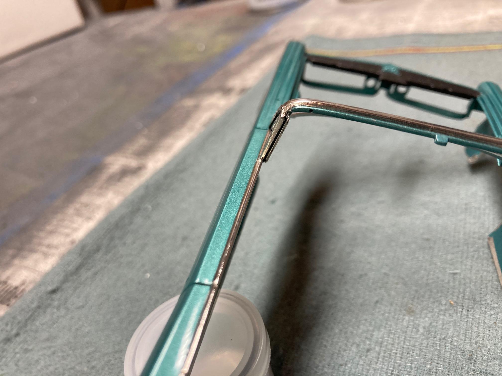

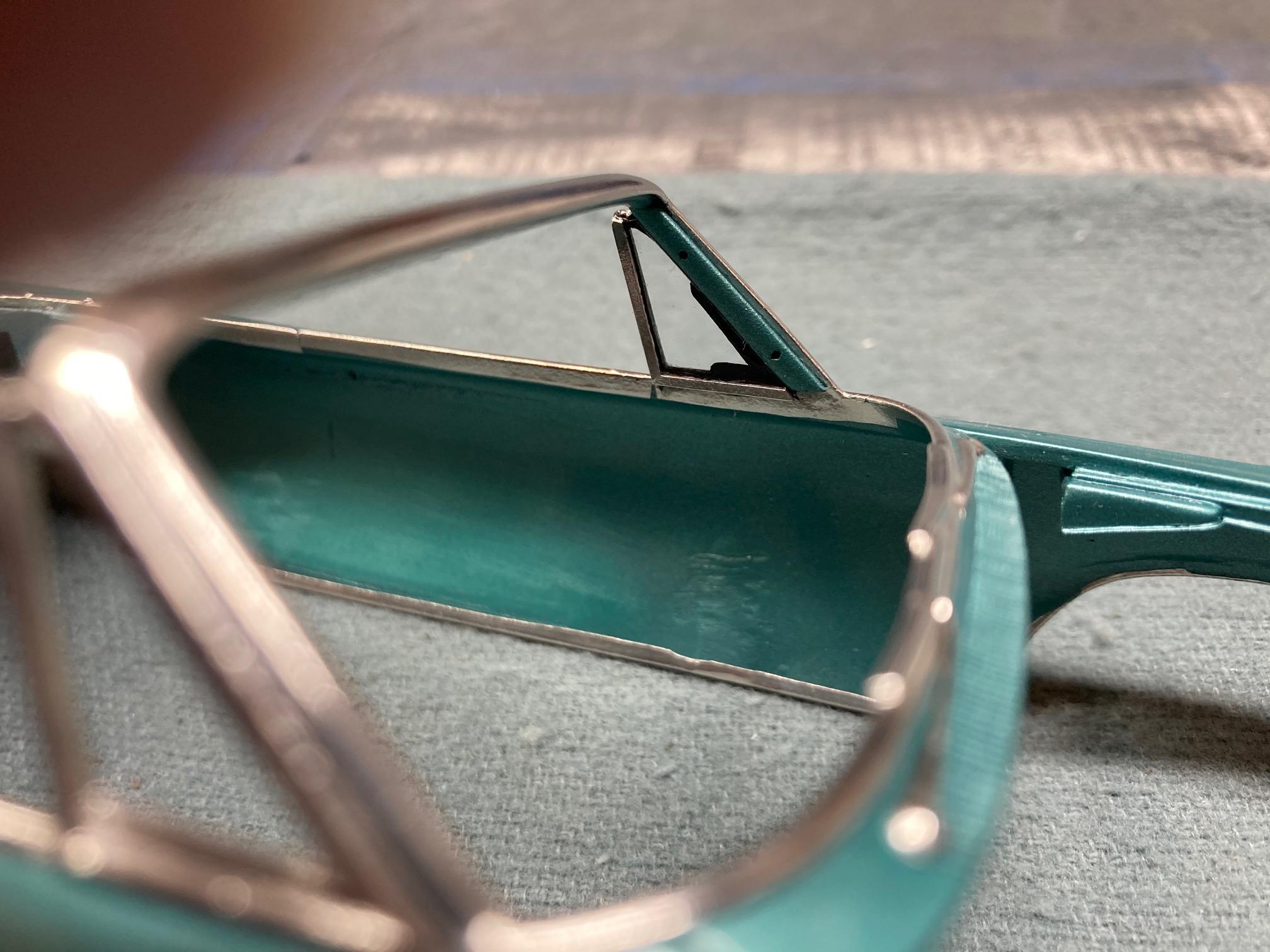

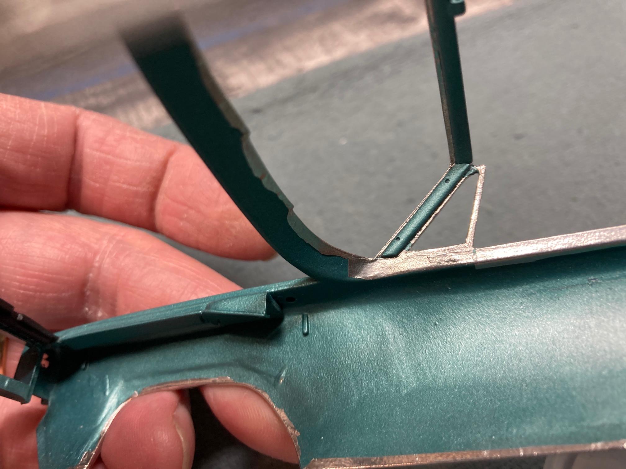

I've finished up the foiling on the body, and now I've moved on the a few remaining body details that I wanted to address. Being as this is a convertible, and the inside of the window areas will be readily visible, I decided to see what I could do about adding a little more realism to the inside of the vent windows. There's nothing that says "model" or "toy" more than thick kit glass just glued to the inside of the body. So first I used a similar technique as in recent past builds, and added inside A-Pillar covers, as well as windshield header trim. The glass is made of .007 "Clear Lay Film", and the windshield will be a "friction fit" configuration. The trim covers were added before paint, so now I could begin adding the rubber seals, glass and interior trim pieces in a sandwich fashion. First the seals, then glass, then trim. Rubber seals were made from the same clear film as the glass, and the chrome trim is just foiled lengths of .010 x .030 styrene strip. This also helped add the affect of side window channels in the back of the vent window. Everything seems to have turned out pretty well, so I can now finish the other side. Just a couple of comparison shots of the unmodified side. (with the added A-pillar cover of course) Steve -
