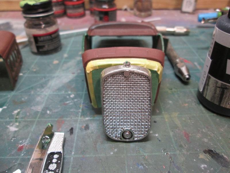

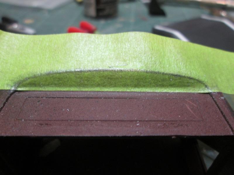

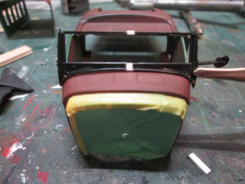

  6. Thanks Eric. The following will negate your good impressions. On how do to things backward. I masked the flanks of the car and painted the grey. Two mistakes. I should have painted the flanks first, then masked, then paint the grey. Then I forgot to mask the sides of the hood.

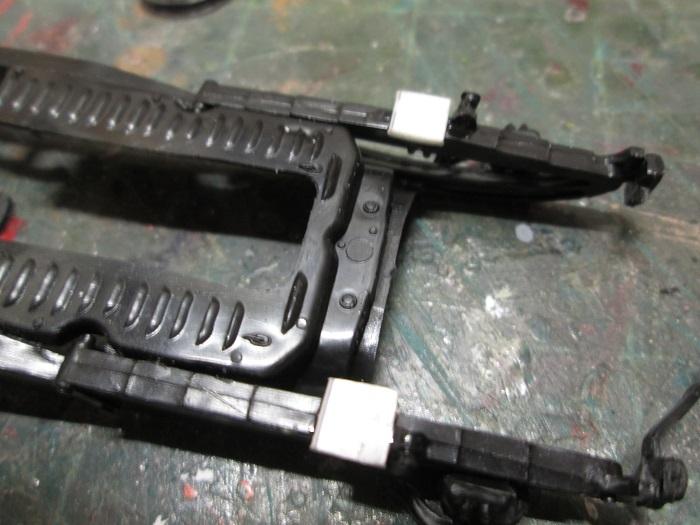

  8. Made a new base for the shifter & "stole" the handbrake from the Packard kit. Continued shaping the door caps and the little fillers at the end of the dash.

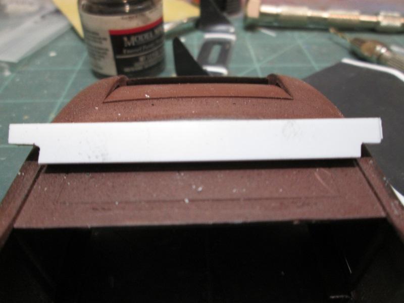

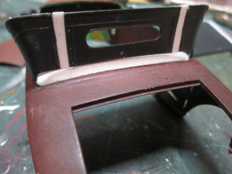

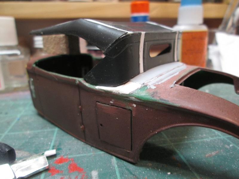

  14. Did the running boards. Paint over BMF. Added a hidem molding to the front corners and rear of the roof using half round styrene. Worked on the door caps. I have to do something with the dash ends where they meet the cowl above the front of the door.

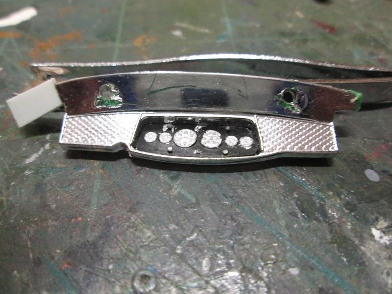

  18. While looking up the door caps I realized that the instruments were black faced on a silver insert. I had them backwards. I think I'll add more black to the faces.

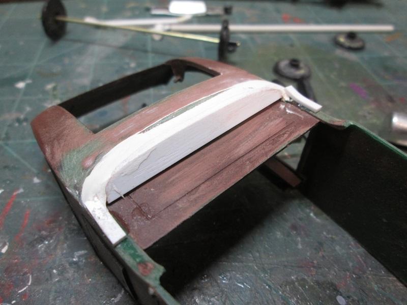

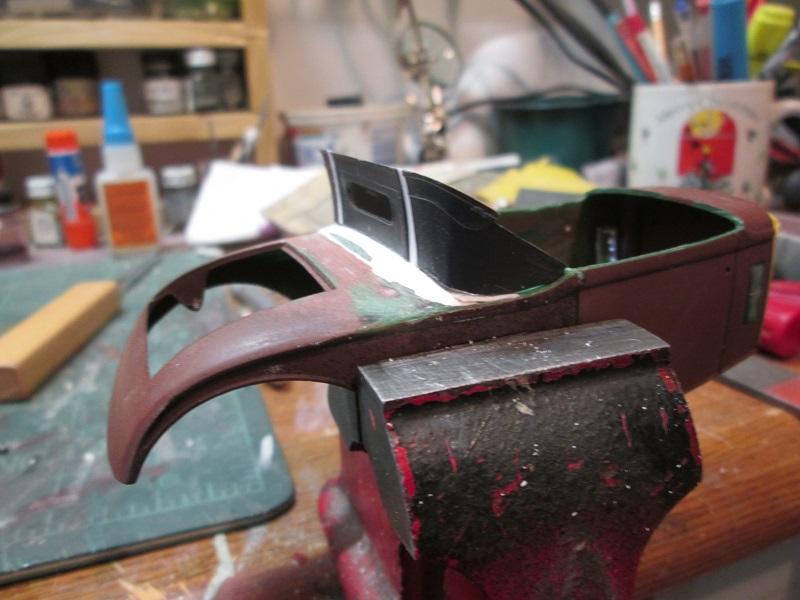

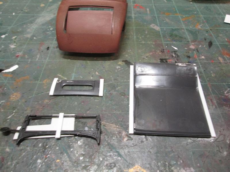

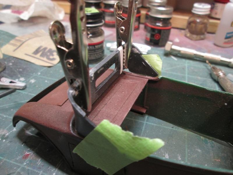

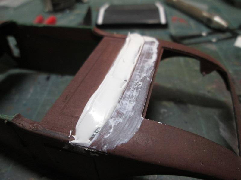

  19. Cutting down the upper door moldings revealed the top of the door inners. And the dash sticks up now that it isn't hidden by the base of the windshield. Lowered the dash, cut down the tub and used the cutoffs to fill the gap between the inner & outer door panels where the "glass" would have been. Now I have to make some door caps. I'll try to copy these using styrene angle. This is a bit outside of my comfort zone.

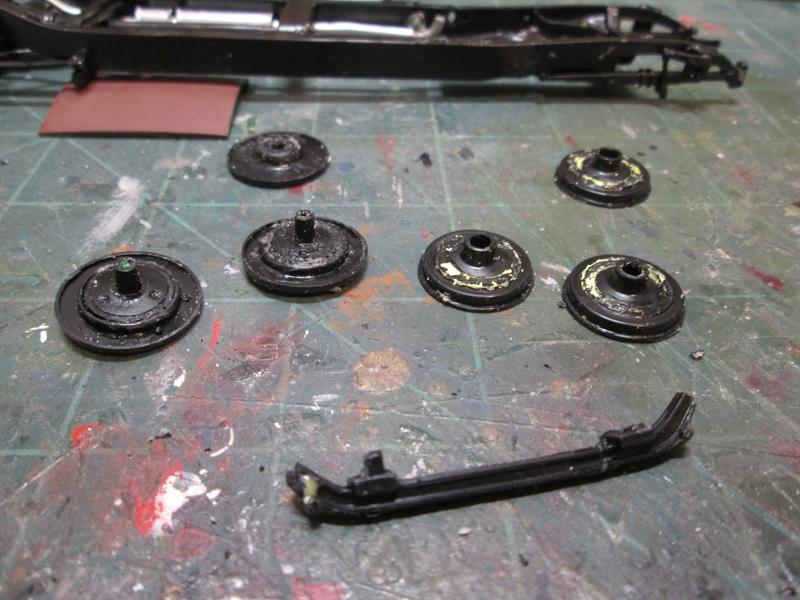

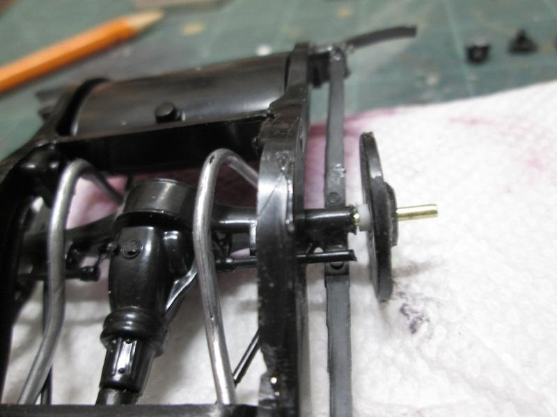

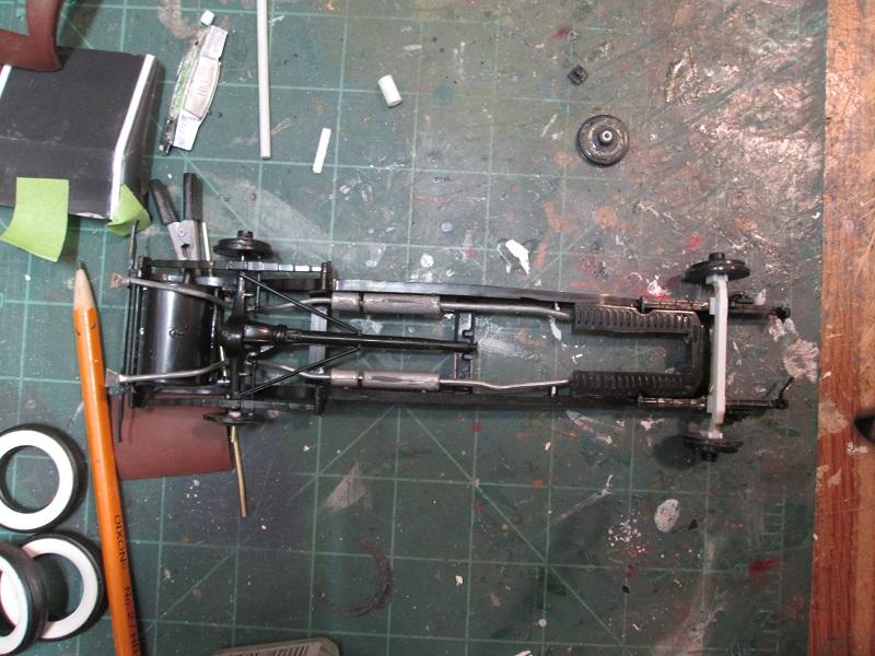

  22. No Eric, the wheels don't steer anymore. Do your light steer with the wheels or are they poseable? The dollies are from Shapeways.

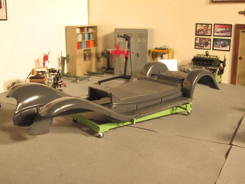

  24. Added more signs. Mostly engine rebuilders associations. Hung the new logo above the door. I wish I knew a graphic designer. Installed the newly received wheel dollies. those things are fully functional. The rollers roll, one set of casters swivel, You can adjust the width and that little pedal lever actually locks in it place.

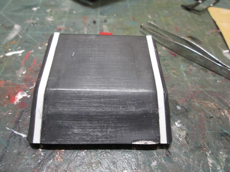

  25. Painted the roof. Those strips I added almost look like they belong there. Body is in primer. Is that the roadster look you were looking for Eric? How do you guys like my wheel dollies/
