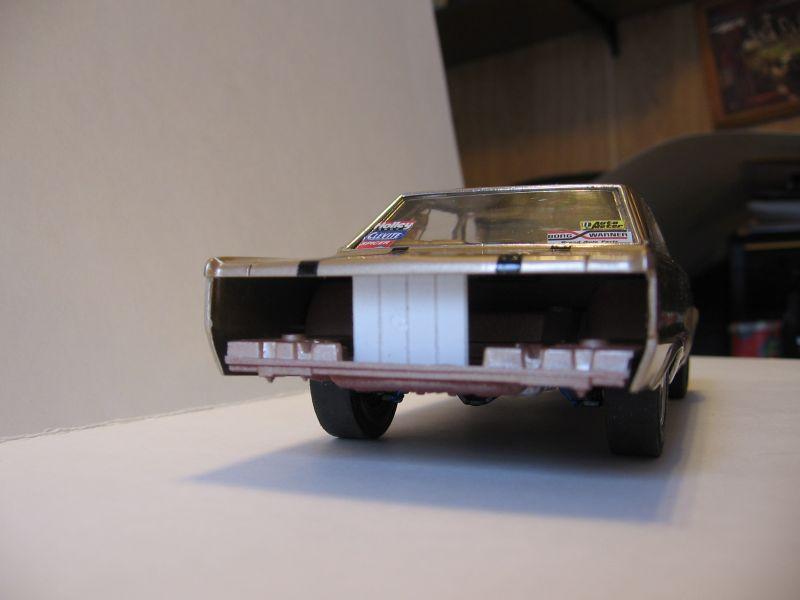

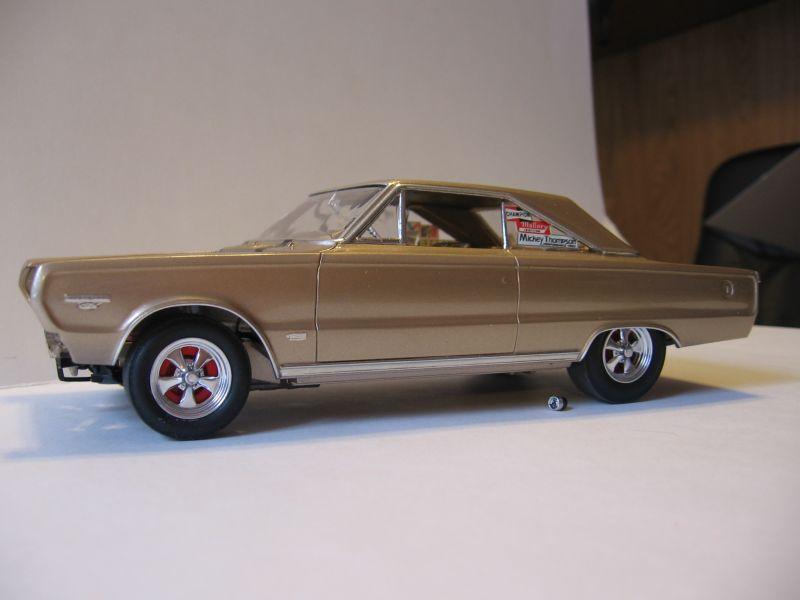

My version of a life-long strip warrior... a car that made it to the track early in it's life and stayed there. A nice kit to build, this one had a lot of scratches on the windows and the chrome was completely trashed, like someone had sprayed it with Windex. Detailing the grill and rear taillight panel was tricky - had to cover the Alclad with Future before anything else could be done. No wash on this one... Duplicolor Gold covered with over-thinned ProSpray real car clear. I put the stripes on top of the clear, wish I'd put them under but they weren't part of the original plan. This is the most detail I've ever put into a model and most of it was fun. Pinned the wipers, mirror and door handles, another first for me. I'm pretty happy with how it turned out. Never could find the hood ornament...

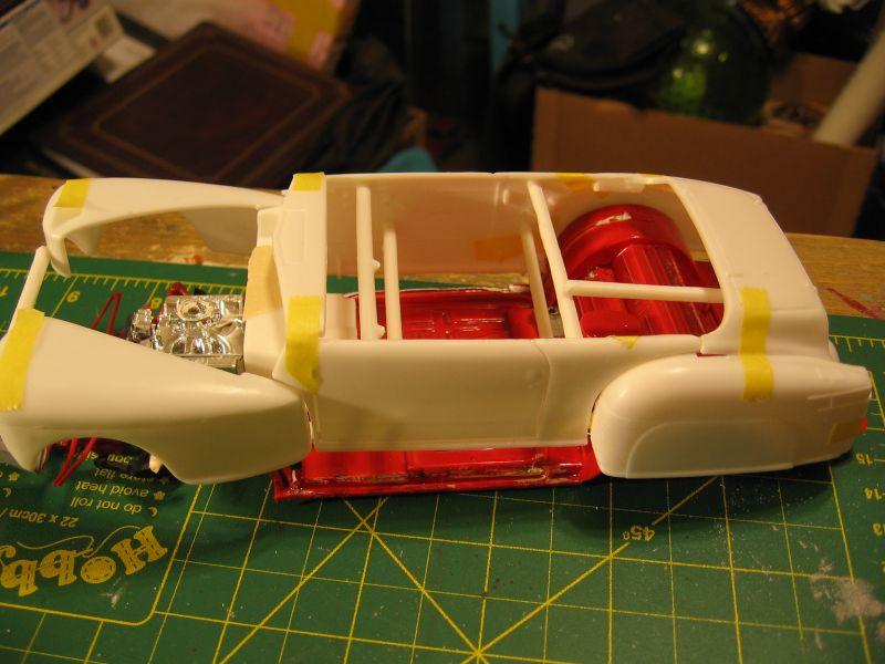

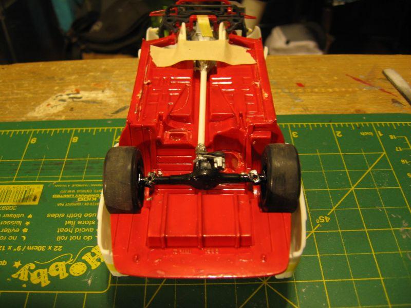

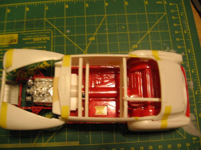

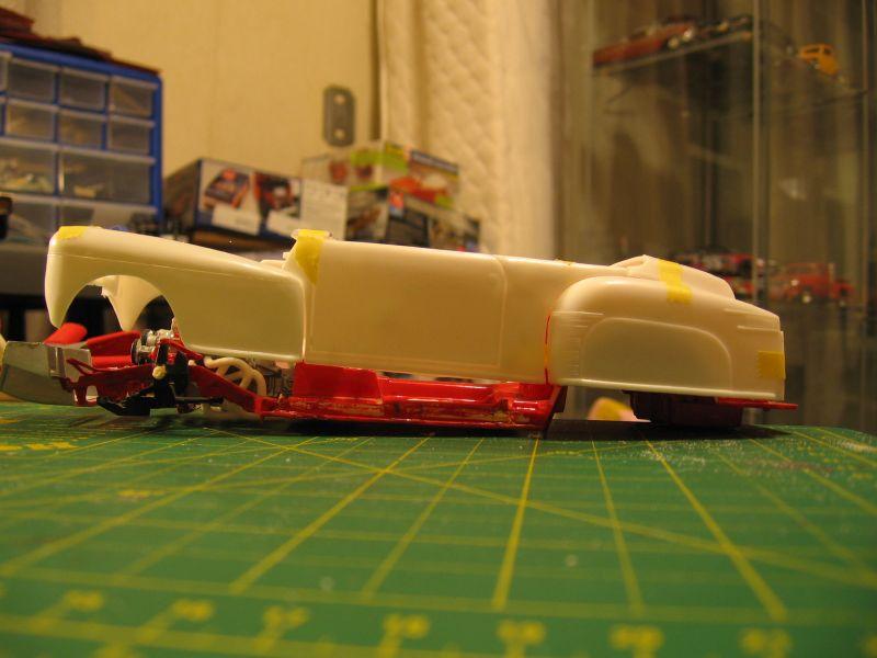

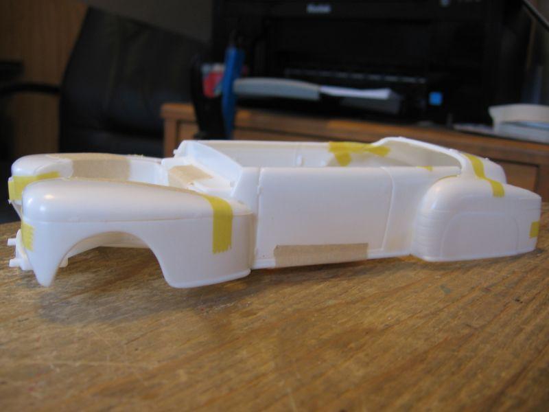

The front inner fender aprons will be custom built, so no problems there... I like your idea of extending the front frame... that takes care of several minor issues and if I slide the engine back a bit I should have ample room for rad clearance, I can get away with the stock driveshaft and the the tunnel and firewall won't need drastic work. Thanks. I've got two more built Nascar cars - one Ford and one Pontiac - and a '57 Cameo that is dying for some chassis work.
That's a possibility too... I'm limited on forward engine clearance though and no matter where I seem to place the body, it looks as if i'll have to either alter the wheel openings and/or move the suspension OR lengthen the frame as you say and slide the engine rearward. I like that idea... 1/8" on the rear is about as much as I planned. The tires are fairly tight against the fender skirts, so they'd need to be thinned quite a bit. Thanks for the comments!
This might work... I'll need to either move the front wheel openings rearward or move the chassis' front suspension forward to get the wheels in a good place. Moving the wheel openings is much easier and that will give me enough room on the chassis for the radiator. Relocating the suspension might interfere with the rad space, but it would keep the stock-ish body look I'm going for... Decisions, decisions, decisions... Have to narrow the chassis to fit inside the body so I think I'll try to just section the floorpan lengthwise and move the outer frame rails in. That still leaves enough interior space for the Corvette bucket seats I found. Splicing the Nascar firewall into the Lincoln's should gain me transmission clearance. The rear axle will need to be narrowed slightly. The wheels fit inside the body now, but there is no sidewall clearance. I thought about widening the rear fenders a touch but I want to be able to keep the stock chrome rear bumper. I'm worried those Goodyear Racing Eagles are going to look HUGE on this car, so getting it to sit low is a must...

Yeah, the more I look at it, the more I think I could shorten and narrow the Nascar chassis to fit under there... that would certainly be less work.

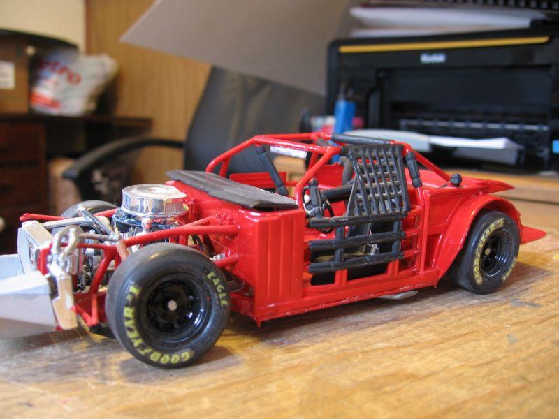

I bought a couple built Nascar racers a while back and have been wondering what to do with them. They're 1/24 scale, most every other kit i have is 1/25... I've got this '48 Lincoln in my stash. Possibly big enough to not look like Baby Hughie in a diaper... I'd like to use the whole Nascar front clip, engine and drivetrain and rear suspension. Think I'll have to build a frame from the cowl back or come up with some bastardization of both car's chassis'. I'm thinking along the lines of an interior that looks like a race car, yet has some luxury to it. The interior in the Lindberg kit is pretty iffy. Maybe a single roll bar, not a cage as I'd like to try and keep the Lincoln-look as much as possible. Maybe even keep the skirts... ? Comments?
Slow progress, but still progress... Had a tough time getting the interior tub to fit nicely - the side glass and windshield added to much bulk, keeping the tub from fitting properly. Instead of pitching the whole thing against the wall in frustration, I put it aside for a week. Popped the glass out, trimmed the bottom edges quite a bit and got things better... Then found the chassis is malformed a bit, requiring an added member to hold the rear in place while the front was clamped and glued into place. Knocked the tach off of the dash while the clamping was going on... going to be tough getting it back into place. The stance looks just about perfect to me. Just what a strip warrior should sit like.
