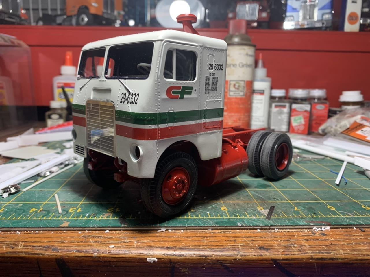

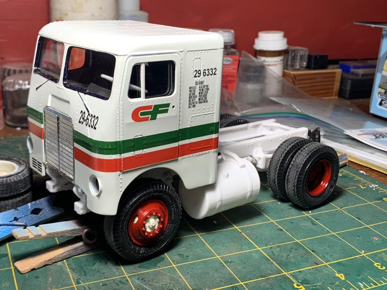

Thanks! I didn’t take any pictures during the process. It probably isn’t the best way, but this is how I did it. First: I sanded of the passenger side headlight mount and filled in the recessed area. Using reference pictures of the real truck and the passenger front lower vent for a reference point on both the real truck and the model. I drew the circle for where the headlight was to be. When I was satisfied with where the headlight would be, I drilled the center. I then measured the location of the center in reference to the grille location and the bottom of the cab. Using that measurement, I drilled the other side to match. I then cut two very short sections of 3/8” styrene pipe (Evergreen #232) for headlight buckets. I then drilled the passenger side out slowly, one bit size at a time, so that the pipe would fit recessed on the grille side slightly. I then sanded and filled the driver’s side and drilled it as well. I then glued the pipe in from the back slightly recessing the grille side of the buckets. I have some bezels from the parts box that fit nicely into the buckets made from the pipe. I pretty happy with how it turned out. I used super glue and styrene as filler.

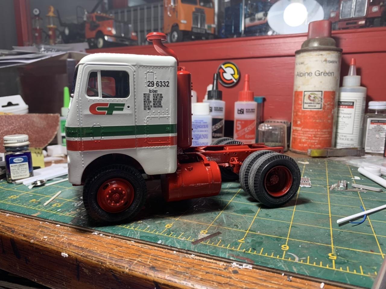

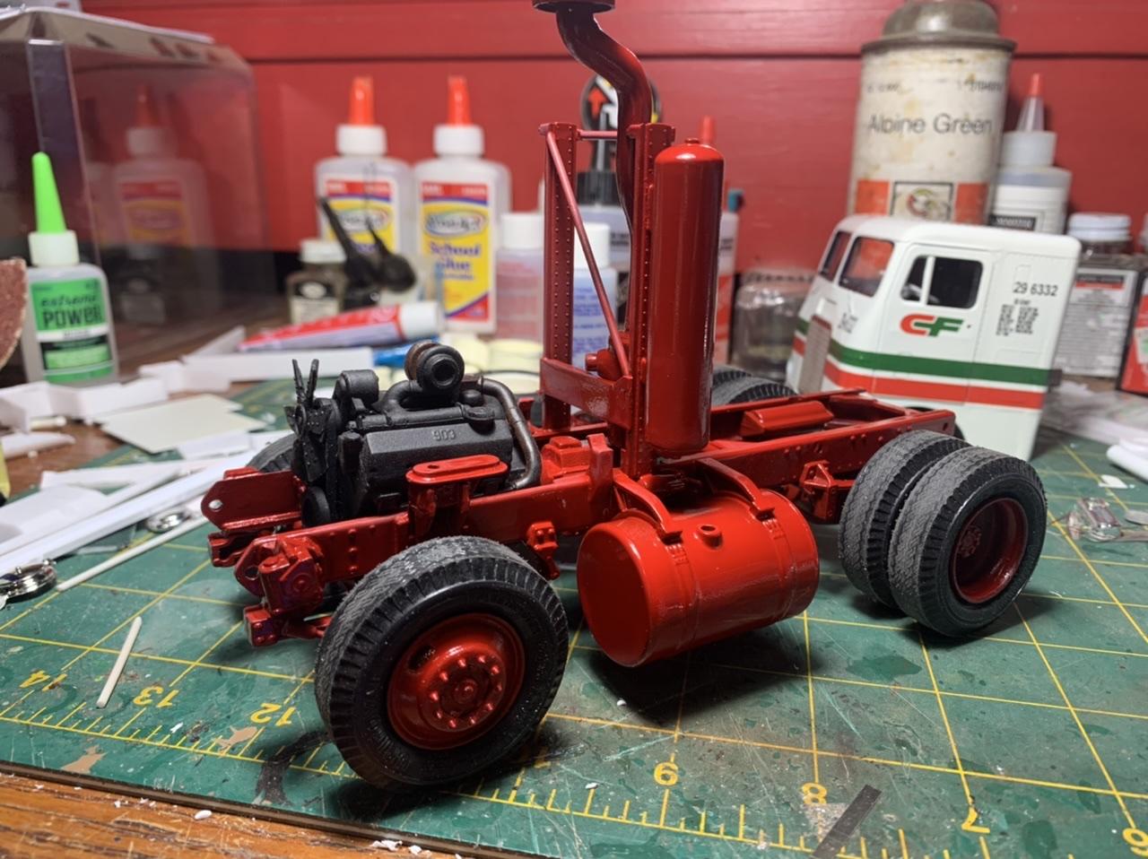

Thanks Tommy, I didn’t catch that detail until I went to put the front numbers on. Also, the earlier cab, at least the one in reference, is a low mount cab and doesn’t have the right front vent, and less metal under the headlights l. Since this was a Johnny Cash type truck anyway, and I wanted to make sure that I had room for the 903, I left it a high cab. Hopefully it will make a decent representation when it is finished though.
It is not perfect by no means, but it is coming along. With very limited reference pictures, I can’t make an exact replica of the reference truck, so I am attempting to create a truck that CF could have had. This truck will have a different number. I tried to make the interior as base looking as possible, I removed most of the gauges. It took every stick of butter that we had, but I was able to squeeze in a VT 903 Cummins (which I understand that CF liked) backed by a 5 speed Spicer.
