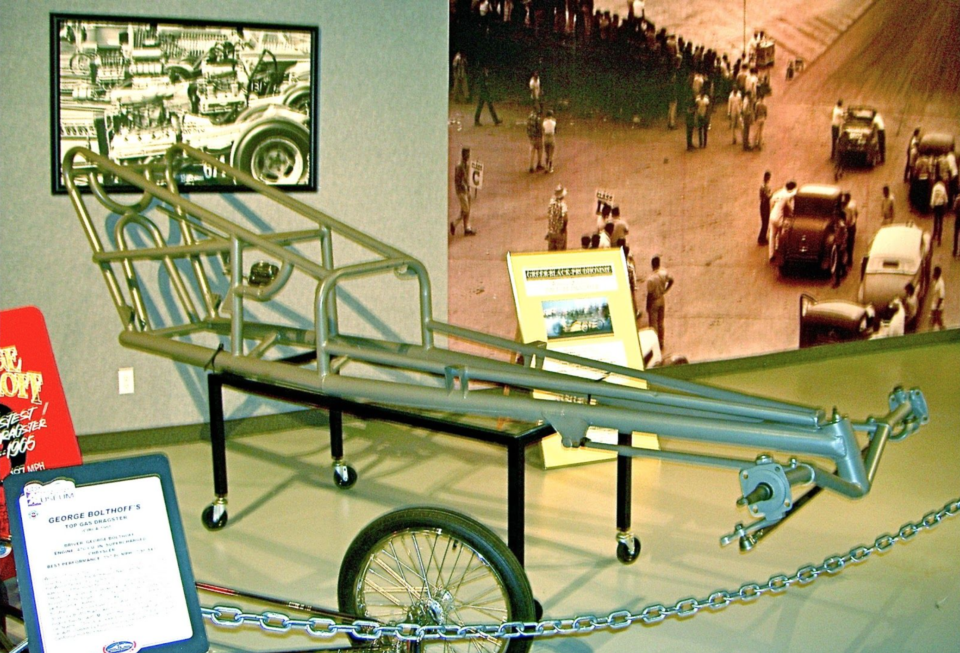

... and a Chassis Research TE-440 with the "pillion" front end (basically a hollow steel tube filled with "rubber doughnuts", rumored to be radiator support bushings for GM X-frame cars). The NHRA took a dim view to this feature, as they felt it was too close, functionally speaking, to a solidly mounted front axle. This is very much like a real one that I owned as a roller in the early 90's, but that one had been updated to a Ford style buggy spring per NHRA mandate
The DD frame seems to be somewhat of a composite between the Fuller and Fenn designs. The x-brace behind the driver and the more upright angle of the "dogsled" hoops are pure Fuller, but the main frame rails made from one large diameter tube and much smaller diameter trusswork is Chassis Research style all the way. The dogsled tubes are considerably more laid down on the Chassis Research cars (causing lots of future NHRA safety concerns), and the back brace tubing was configured unusually as well. I'm not certain that an accurate Chassis TE-440 or TE-448 has ever been produced in scale. Picture of a 1960 TE-448 for comparison
I'm very happy to finally see the "dogsled" style Parts Pack dragster frame being properly identified properly as a Kent Fuller chassis, and not a (Scotty Fenn) Chassis Research chassis. Tommy Ivo was a steady customer for Fuller from 1958 onward. Ivo's second, 1959 era, Chrysler powered, single engined car (the first Buick single engine car being sold to Prudhomme) is pictured below. This car is probably the most representative of the Parts Pack frame, though I would bet not many were built with the Ford buggy spring style front end. Fuller was an early proponent of the single VW torsion bar front suspension that would grace some of the most beautiful open wheel drag cars of the 1960's and 1970's. The absolute best donor kit to reach for pretty much all the chassis bits is the 22jr Model T bodied dragster in the Tony Nancy Double Dragster set, as that was a Fuller car built in 1963. Though you would have to scratch-build a torsion tube to mount to the front to accommodate the front end bits.
