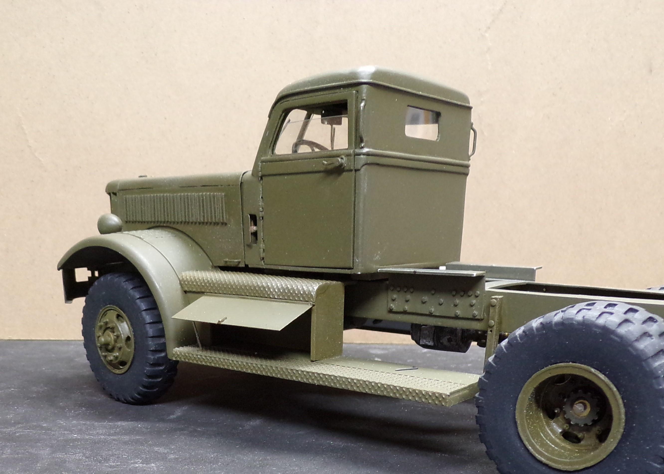

  1. Work has started on building the trailer for the M-20 Prime Mover. First thing up is to do all of the tires and wheels that are needed. 24 in all. 8 in the front steering section and 16 under the rear of the trailer. I'm using 1/32 scale metal castings for the wheel masters and a set of Goodyear rubber kit tires for the tire master. They work out to be about right for 8:25 x 15 tires that were used on the M-9. IN the background is a mold for the wheels and with the rubber tire masters set up on a pair of the cast wheels that came from the rear mold. In the foreground is the tire mold with the cured resin tire castings still to be removed. All 24 tires and 12 wheels have been cast. The wheels are sufficient to mount two tires on. The backs won't be seen at all once they are mounted on the axles. The wheel centers need to be drilled out for brass bushings. That will come a little later once I have figured out how each axle is going to be made. The frame has been started. The Tankograd photo publication has some specs with it for the overall length and width of the trailer. The towbar is an additional 6 scale feet above and beyond the full trailer length of 290 scale inches. There is an additional scale 40" in length to be added to the front of the trailer side beams. All of the work so far has been done with 0.030" Evergreen sheet plastic and 0.030" and 0.020" Evergreen strip stock. A look at the side view with the wheel placement. The front 8 tires will pivot with a separate plate that the axles are mounted on. It is a box type detail that fits under what is shown beyond the side frame. Here's the bottom side. Still incomplete but well on its way. The two open sections are where the spare tires will be stored. Additional longitudinal bracing has to be added as well. All of this work is held together with CA glue. It was very flimsy to start with but it got stronger with every added piece of plastic stock. The two driving surface plates on top really made a difference. The two raised sections on the left are the stops which keep a tank or other piece of equipment from rolling off the front of the trailer. There will be plenty more to come before this build is finished.

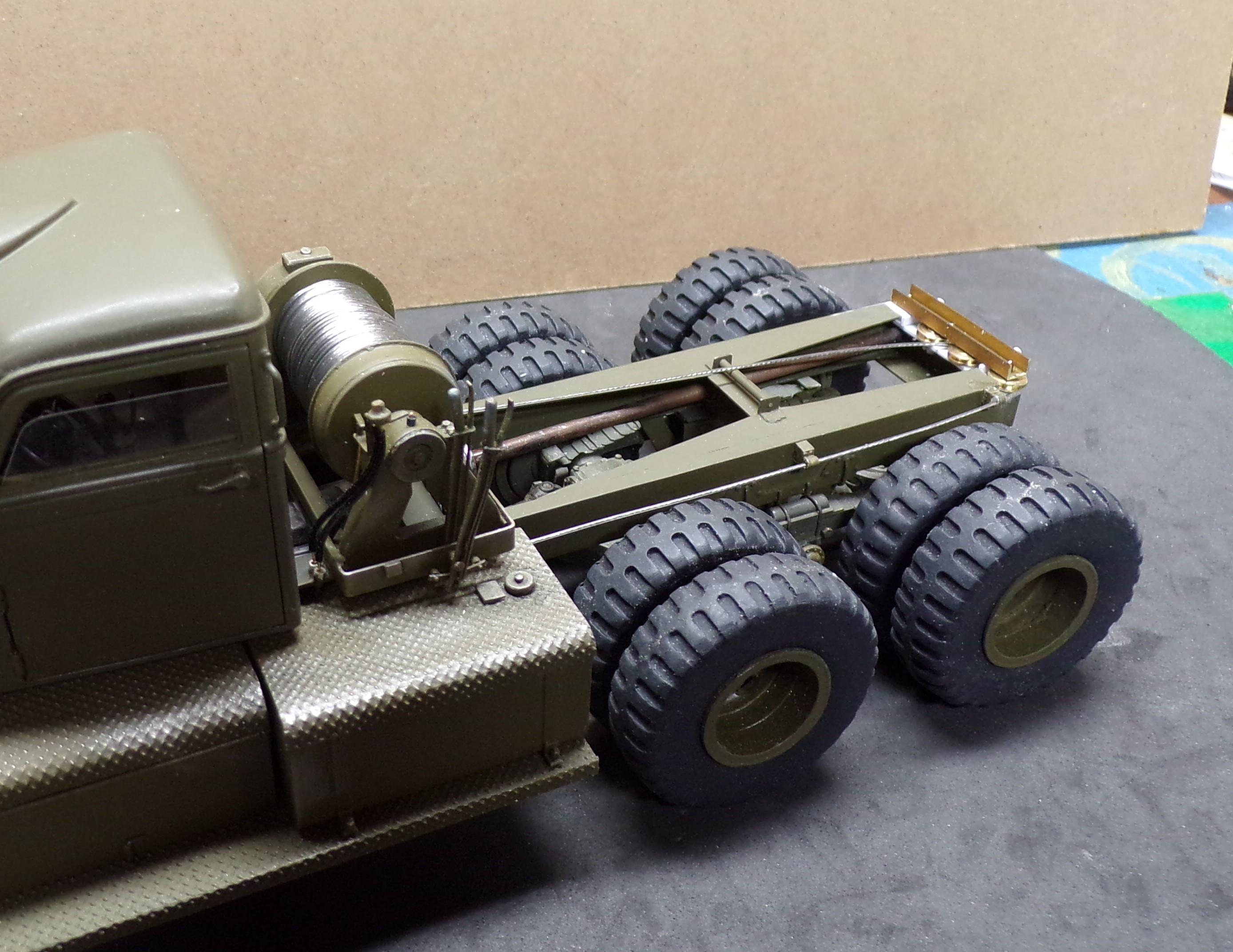

  5. Interesting that the frame rails are photoetched brass. I've made them from strip brass and channel sections before but never PE. How were the cross members attached?
