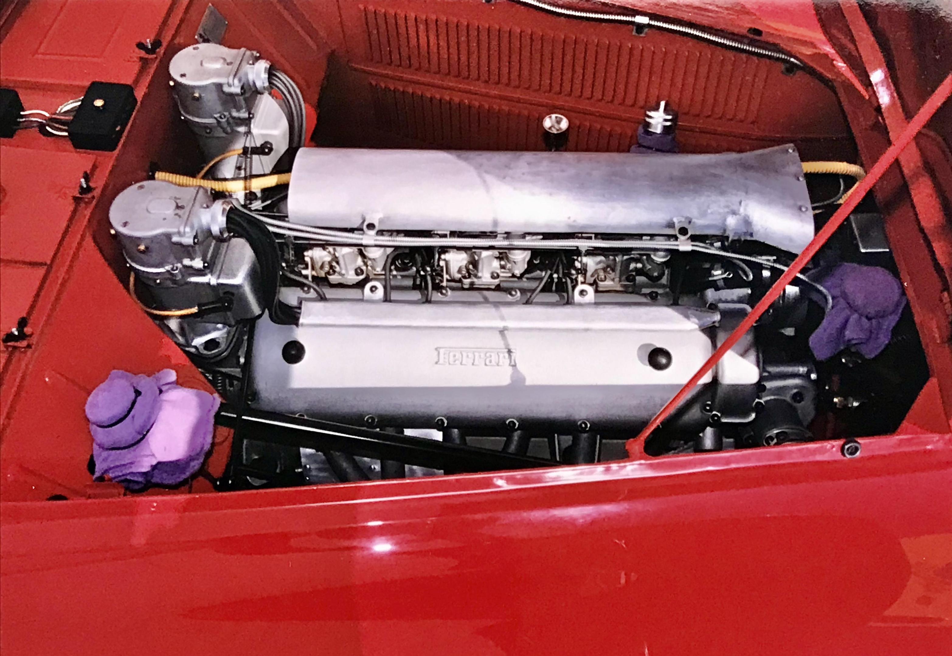

Here’s a better shot of the Columbo 12 in the Barchetta …. Notice the absence of ribs on the cam cover - one change from the GTO engine - but there are other changes at the base of the engine ..

2 cars but same engine ... this is an early Columbo V12 the photo in the sports car eng bay is from the Spa winning Ferrari Barchetta that I am building in the Other Racing WIP section - an Umi kit that I am building as a tribute to the late Mike Quarterman - he produced this kit in 1993 ... the other photo is of the Collier family owned 166 that is displayed at the Rev's Museum in Naples this photo was taken at an Amelia event a few years ago ... It is one of the first Ferraris - and was built about a year before the Barchetta.
